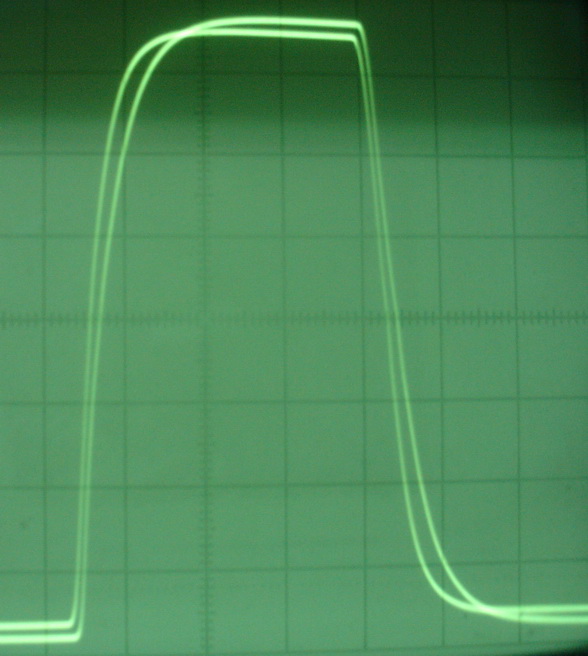

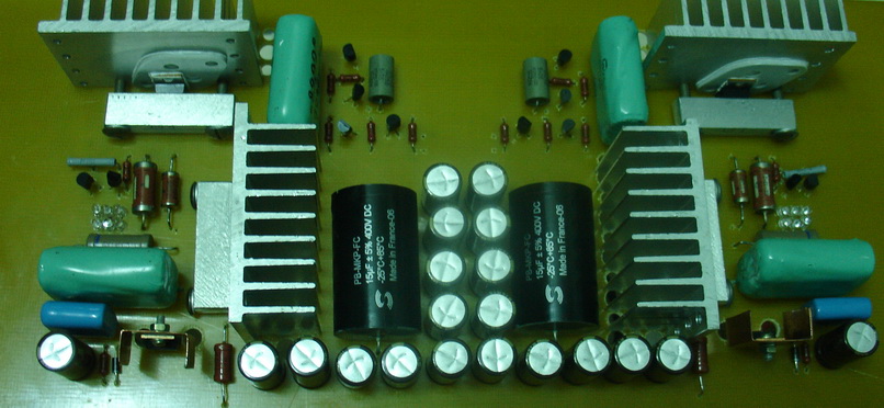

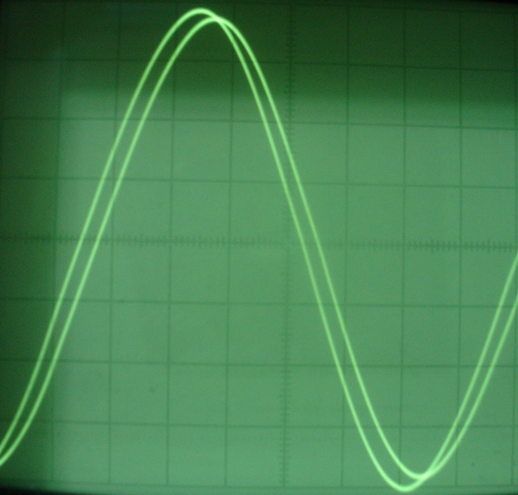

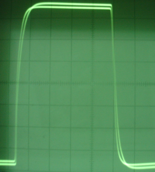

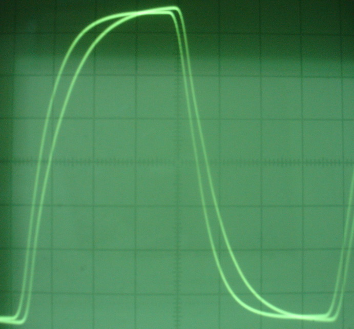

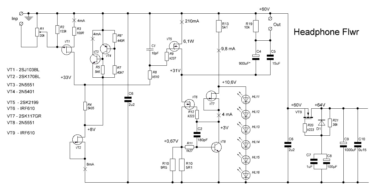

This is a modified Follower-99 based schematics, with the front amplification stage (Ku=11) and output impedance 1,5 Ohms. Almost perfect reproduce 500kHz square wave signal, time delay between input and output sine signal is 34ns (0,034us).
Output capacitor is made of 9pcsx100uFx63V Elna Silmic II + 15uFx400V Solen Polypropylene cap.
Separate shunt power supply is used for the front stage.
Signal pictures (input and output signals) are 200kHz, 500kHz , 1MHz square wave, and 1MHz sine wave.

It should also good serve as a preamp, with more than 20dB voltage amplification and 50V peak-to-peak undistorted voltage swing, with 1,5Ohms output impedance it is capable to drive any "difficult" power amp or output stage.
More definitely, after testing of this version, I plan to extend it to an integrated class A amplifier, by removing output capacitors and adding an output stage, based on 2SK1529 matched transistors, similar to the present second stage.

Why are you avoiding feedback?
As per my listening experience, amps based on NFB designs, all other parameters being perfect, they colorate sound a little bit, in a kind of slight "sandy" color, if the amp is transparent enough (for instance, I consider Yamaha B-2x as one of the best NFB amps, it is very transparent, but slight "sandy" taste is there). If an amp is not transparent, like majority of Hi-Fi examples, then it does not matter with or without NFB an amp is. My principle, take the best parts for a given application, and achieve good parameters without NFB.

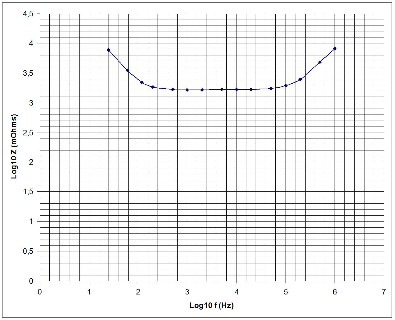

I just have measured the impedance modulus curve, plotted in double logariphmic scale.
900uF of output cap is actually not enough (gives 7,6Ohms at 25Hz), for 32Ohms headphones I would add another 900uF. Impedance value at the flat region is nearly 1660mOhms. Above 100kHz impedance goes up due to parasitic inductances.

Have you think about using OT instead of output capacitors? imho capacitors are great for low power signal but once we are talking about 1W or more OT might work better.
Output transformer can be done very good, but cluster-like solutions for output capacitor with big high quality shunts also lead to perfect result. For experimenting with various output cap solutions, I have bought expensive and high quality SE 300B based tube amp, for having top reference point. Very definite conclusion I made is, no output signal current through PS rails give so big and firm positive result, that output cap danger really disappear, in comparison tests, including best SS and tube disigns.
Interesting observations, Vladimir. On my 28W SE mosfet/tube hybrid I used 1800uF, which was fine with speakers to 4R. I did NOT use Ciuffoli's method; I am confident it would sound better because ripple is not coupled to the signal path.
However, I do have some doubts about the mosfet series regulator. In my experience cap multipliers add the transfer function of the active device to the output, but in Ciuffoli's case since ripple is no longer relevant at that point because of the blocking effect of the CCS this issue may not be important. Nevertheless, a comparison with CLC would be interesting, typically 22,000uF/15mH/22,000uF.
Hugh
However, I do have some doubts about the mosfet series regulator. In my experience cap multipliers add the transfer function of the active device to the output, but in Ciuffoli's case since ripple is no longer relevant at that point because of the blocking effect of the CCS this issue may not be important. Nevertheless, a comparison with CLC would be interesting, typically 22,000uF/15mH/22,000uF. Hugh
Yes, Hugh, one always should compare variants. Since I tend to have PS ripples+HF constituents (mainly HF noise-like distortions of the rail voltage) under load less than 0,1mV peak-to-peak, cap multiplier gives an economic solution. Also, to me, active device in series with active schematics makes less "sound losses" than e-cap in series. Anyway, one should be careful with PS.
I have added all kind of connectors to the prototype, connected temporary power supply, and now can report first listening impressions.
I tested it as a preamp in the system with the modified follower HF transistors
I listened via Sennheiser HD595 headphones
I listened it as a small power amp (0,1W out power) with Castle Acoustics Pembroke speakers (surprisingly sound is quite loud and allows to get main impressions)
I can say, sounds very clear, very direct, nothing from "sandy" flavour, excellent 3D scene, sounds similar to that from the modified follower.
Gives the best sound that I heard via headphones.
