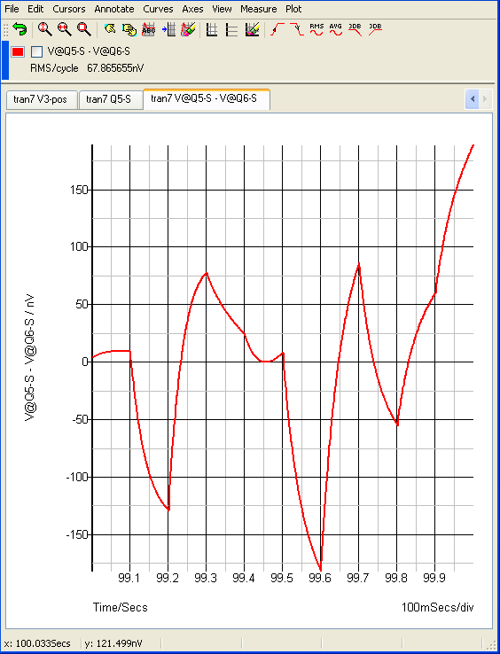

I've found a filter combination that sims well. This is the sims prediction of the differential output noise at the 8 ohm speaker:
This is the differential noise going to your speakers with no input?
Whole lot of nothin' much at about 100nV!!
Seems to accur at 0.1sec - looks a bit like diode rectifier bleed noise (Shottky?) - maybe can dump this too with diode snubberS? The sims are marvellous tools to play with!

I'm simming with MUR810 diodes, and have the amp's input signal turned off. With the output noise being this low, I'm not to concerned about snubbers other than an exercise in absolute perfection.
Perhaps I'll take you up on your suggestion.... just for kicks.
Aren't simulators a blast?! Best learning tool I've ever used.

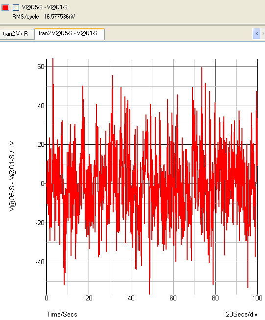

In my sim I use a transformer and bridge to energize the amp I'm designing. The sim does a good job of displaying the various ripple and noise distortions.
No big deal, yes, but I discovered that I can get an even cleaner output (than the pic posted in my earlier post) if I use the sim's perfect voltage source for bias voltage.
The idea being that perhaps bias voltage should be highly regulated vs. using raw voltage from the amp's PS.
I've posted a pic of the differential voltage output (zero volts at input) using this concept. It's ridiculously low in noise, no real world supply would be this perfect, but it demonstrates that the output can be even cleaner than the last pic I posted in post 166...
femto: le -15 or: 0.0000000000000175 VRMS

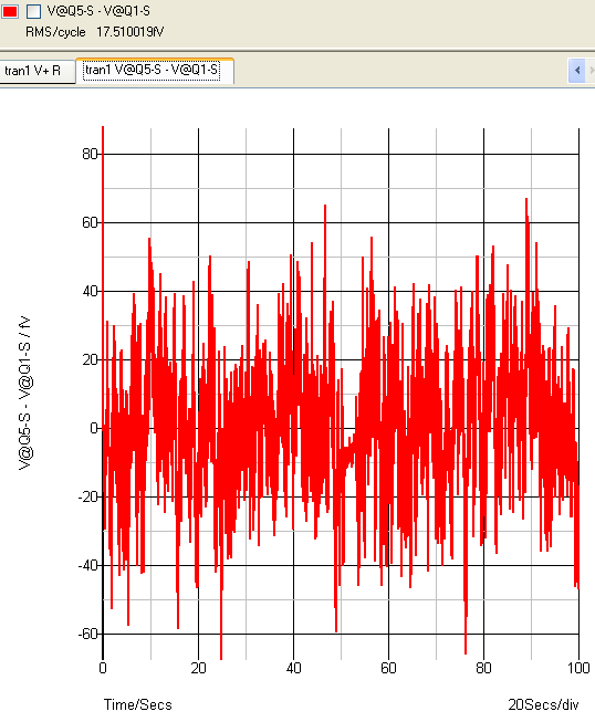

I just discovered that the new sim I sat up for the previous post didn't have the "real time noise" button box checked. This meant I was comparing apples to oranges. The results were misleading--sorry!
With the "real time noise" enabled, I have more accurate information. There is still a definite improvement in noise reduction with a cleaner (highly regulated) bias voltage source:

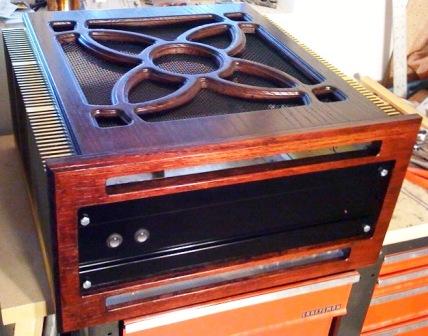

If that beautiful boat anchor weighs anywhere near what I suspect it does, you're going to need some serious handles. Something like Papa uses on his amps.
I have a thought about your inductors, why not put them in an oil bath? This is what the power companies do with many of their transformers and phase correction chokes. Unless the oil is contaminated, it's not electrically conductive, and it does help dissipate heat. Use an enclosure for the transformer/oil well that is made from aluminum, with some heatsink material attached to the outside. You might be able to get away with using a smaller gauge wire, thus lowering the mass. Just a thought.
