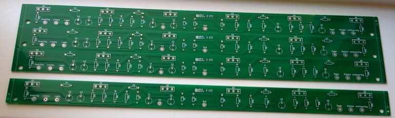

I've ordered pcbs for the new third (output) stage. It's going to be interesting in that there's a built-in voltage regulator. This should assist the CLC filter tremendously--not to mention, I've added a bit of circuitry to allow me to modulate it, which allows me to shift it out of the way and allow the output voltage to climb above the power supply voltage.
This is relevant because the primary mosfet (IRFP044N) only sees 6 volts and that isn't much room to swing a signal. This being a low wattage amp, I can get away with a low voltage swing.
Though it doesn't move a lot of voltage, it does swing amperage. The sim shows it capable of driving a 1 ohm load without the power curve getting too ugly.
The open baffle bass/midbass section of my test speaker system is loaded with 8--16ohm drivers configured for an 8 ohm load. It sounds terrific. This little amp drives them with authority in my little lab.
I have iTunes on my computer and have the computer connected the the amplifier. I downloaded Bass Mechanic's test tones. The speakers play fairly even down to 30hz. I haven't taken the speakers any lower for fear of damaging them. I should mention that I boosted the EQ a smidge in the bass region. Still, it's impressive considering I'm use a bifilar choke with only 41mH inductance. This is too small a value, but it works. I'm going to follow Magura's lead and have it bumped to 80+ mH.
