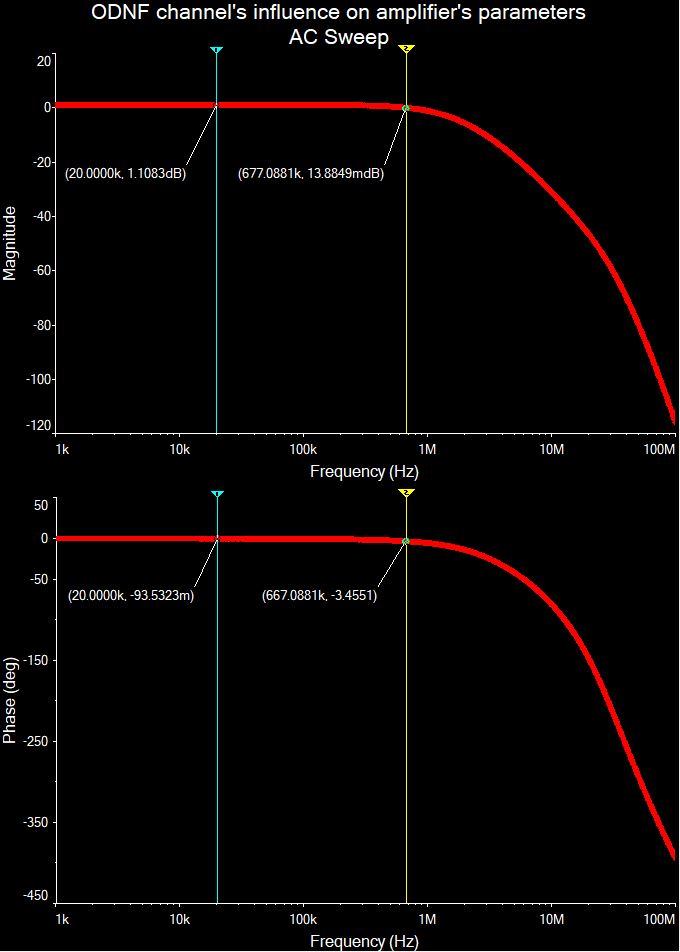

Looking at the schematic in post #49, a quick calculation (always a mistake!) gives me KB = 8.4 or 18dB. Do you get the same figure?
Absolutely right, and it would influence the main amp's gain at this rate if the "+" input of the opamp would be grounded.
But as it is connected to the input signal, we have KB / (1 + KB).
Exactly what we see in the simulation below.
Main gain stage's input is grounded, the opamp's "+" input is connected to the signal source, used for injection into the feedback. No error cancellation in this case, but the gain/phase are as shown.
The reason applying ODNF does not change the global gain is because the NFB target is the same global gain. But 18dB of NFB has been applied.

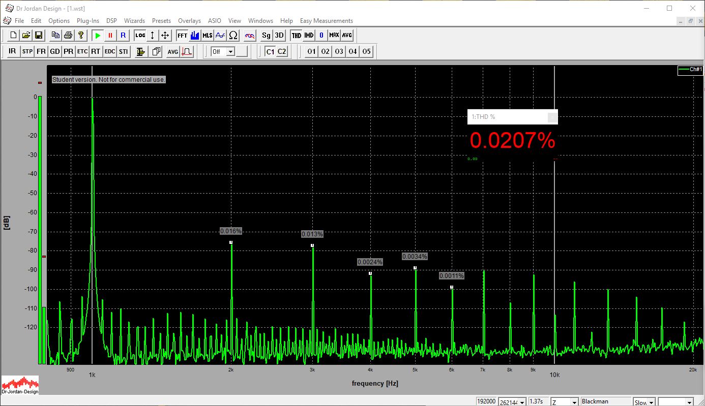

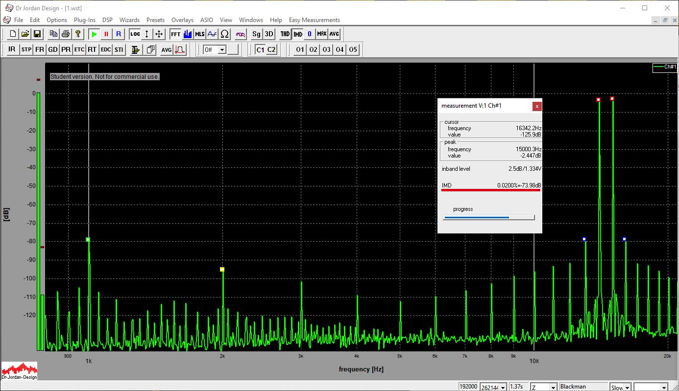

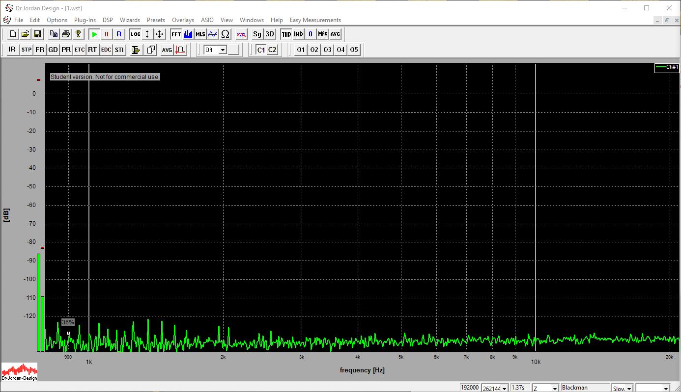

Better spectrum measurements

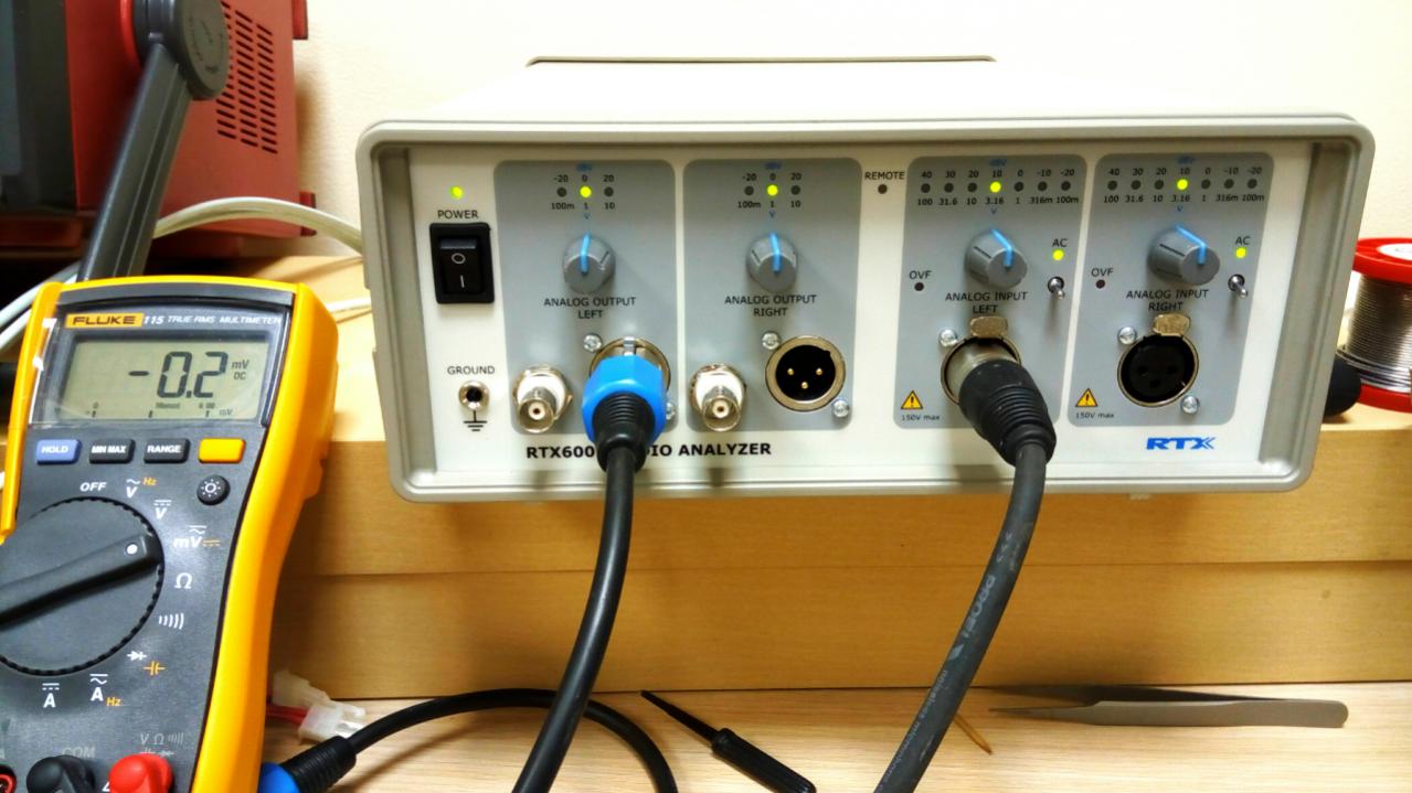

I've set up my recently received RTX audio analyzer in the lab - now I can show better measurements.

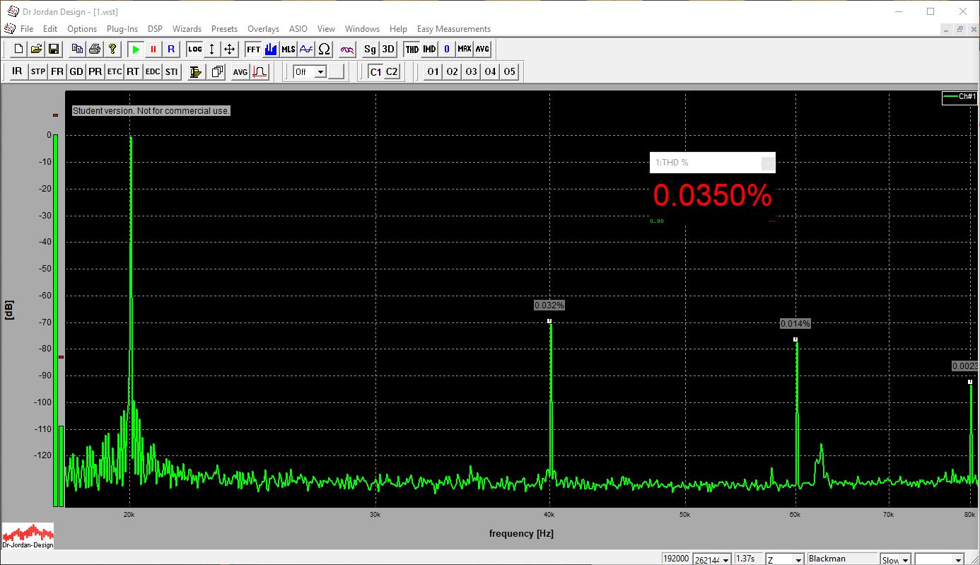

The first picture - note the noise floor with no signal - no noise / hum components above -120db line. Then THD for 1KHz and 20KHz, and IMD 14+15KHz go.
Listening to the amp - also through the analyzer's DAC - I would characterize the sound as "smooth and delicate" - no highlighting of anything, very comfortable listening in the near field (speakers are placed on the corners of a big table).

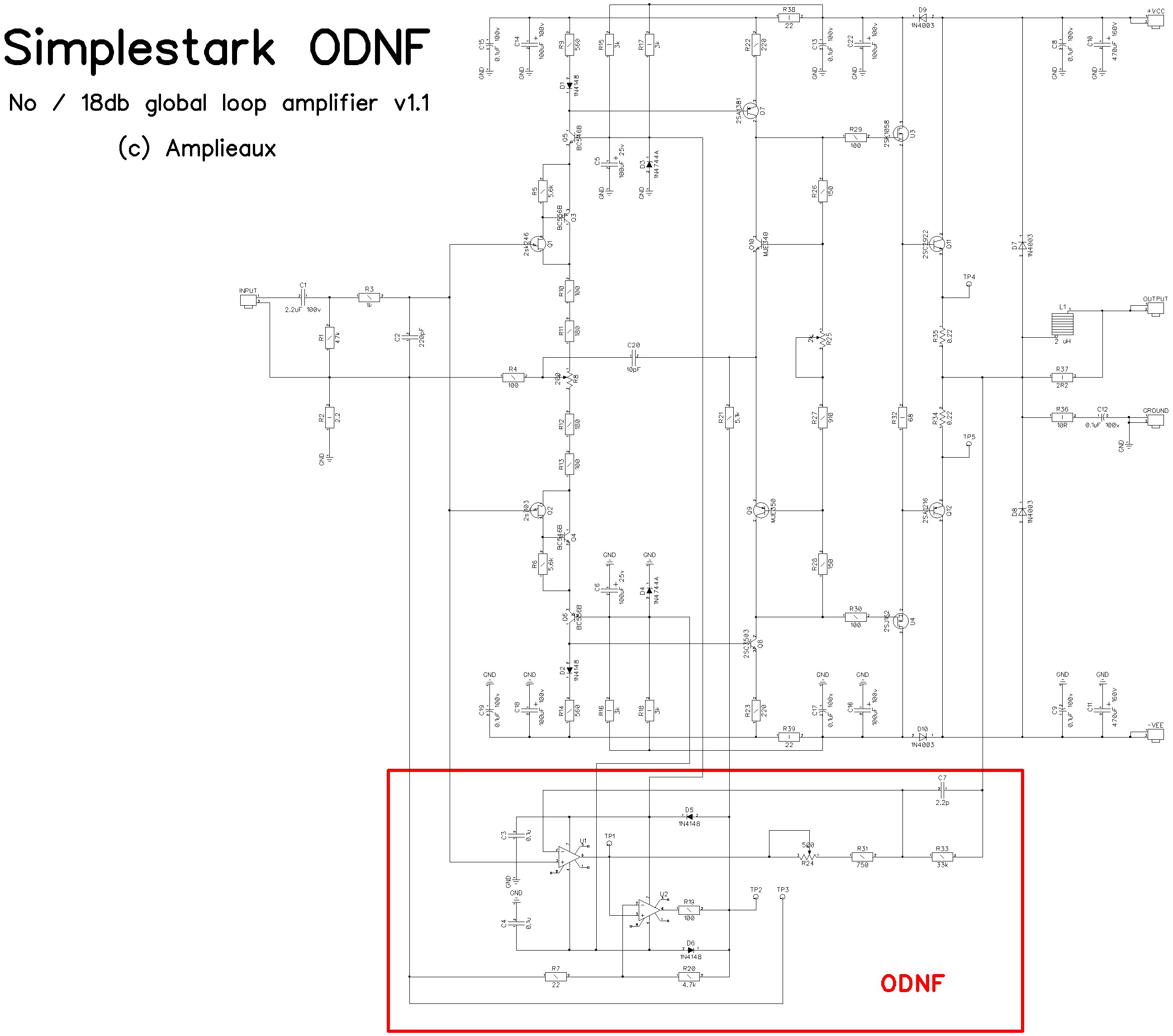

One 10pF bandwidth-limiting capacitor is added to prevent possible "ringing" when touching the input with something not grounded.
The design is rather mature now - easy to reproduce.
I'm thinking about a servo option for those who like rock solid zero offset, although right now possible fluctuations don't exceed +/-10mV.
V1.1
The one I have added is C20 (10pF). It closes the loop around the front-end at HF, preventing possible local oscillation when the input is touched with no ground reference.

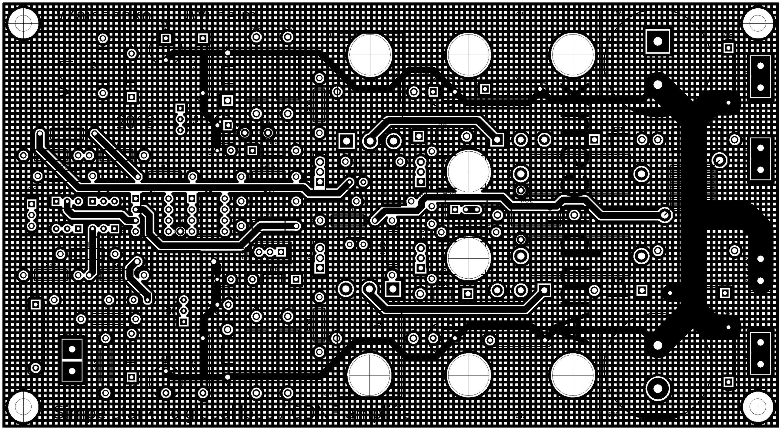

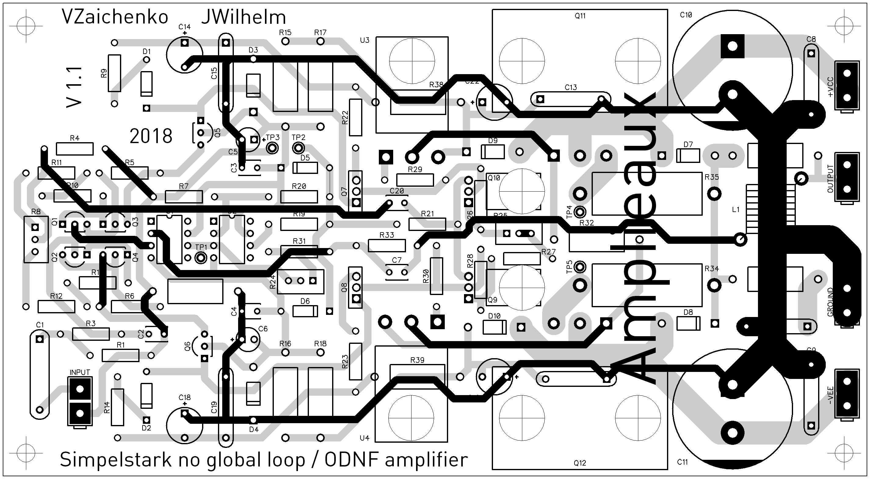

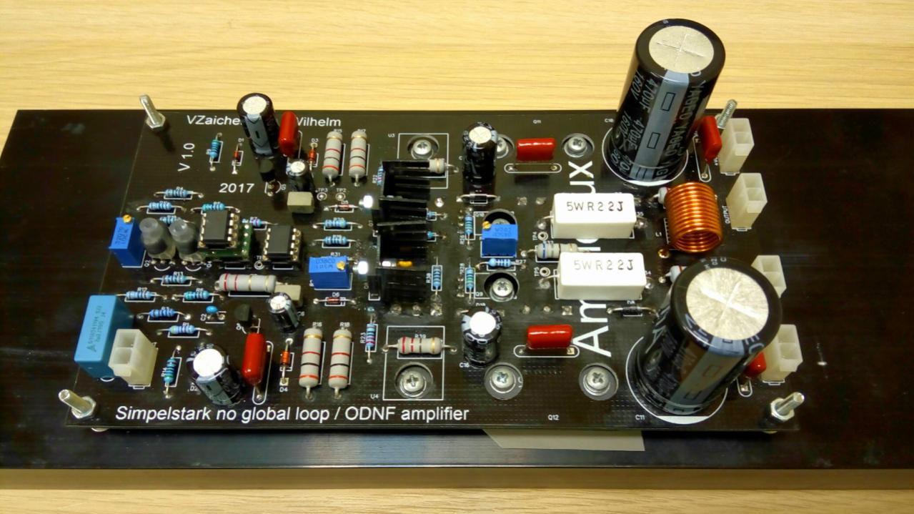

The 2-nd picture shows the real board view from the top (ground plane), the 3-rd picture - the ground plane is shown transparent to see the routing.
I have stayed with 18db loop gain in ODNF mode. If somebody wants to use the circuit in a pure no-global-loop mode - he can drop all the components within the red box, shorting TP2 and TP3 with a wire.

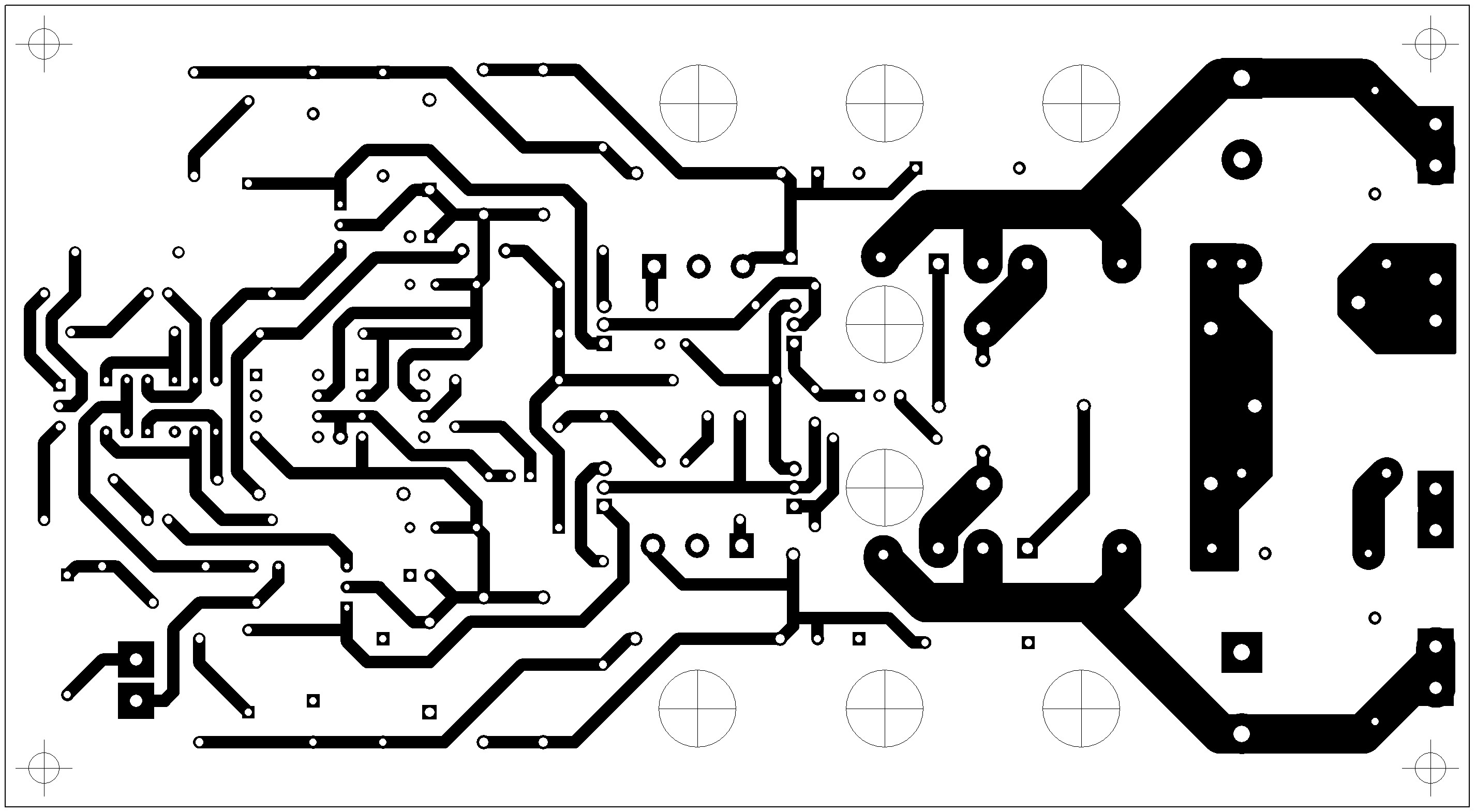

P.S. Added the bottom view of the board with the proper copper pours.
