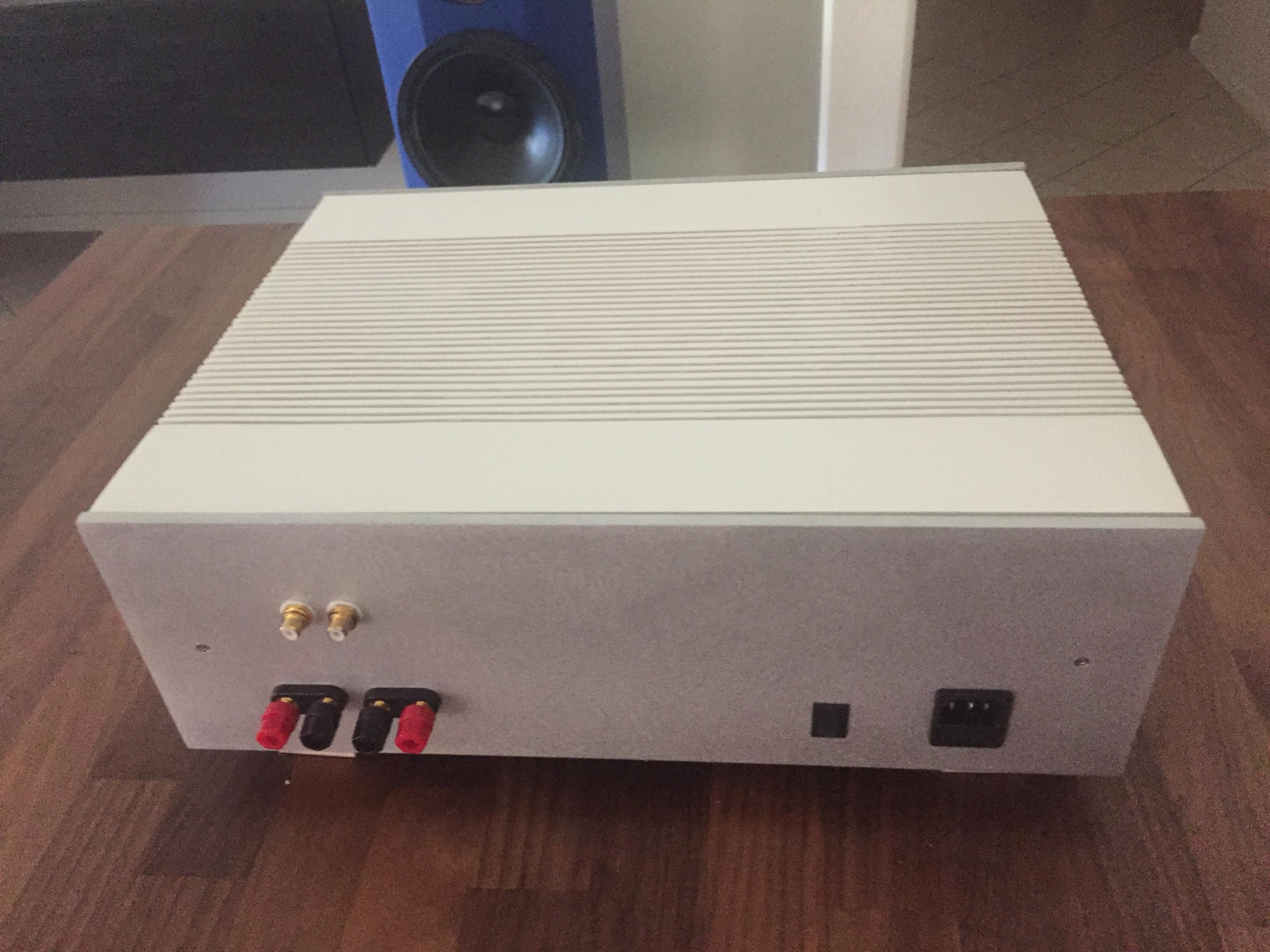

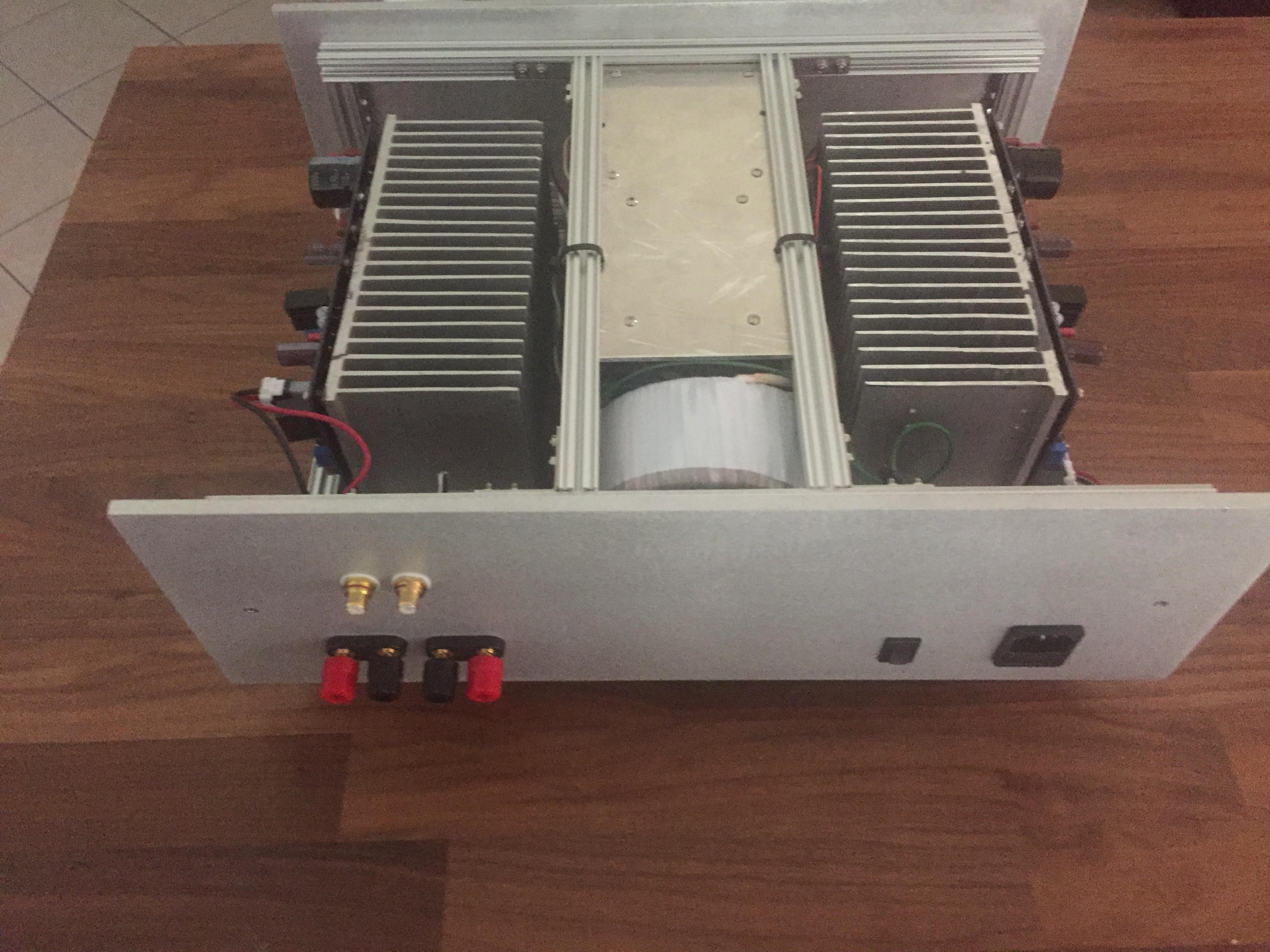

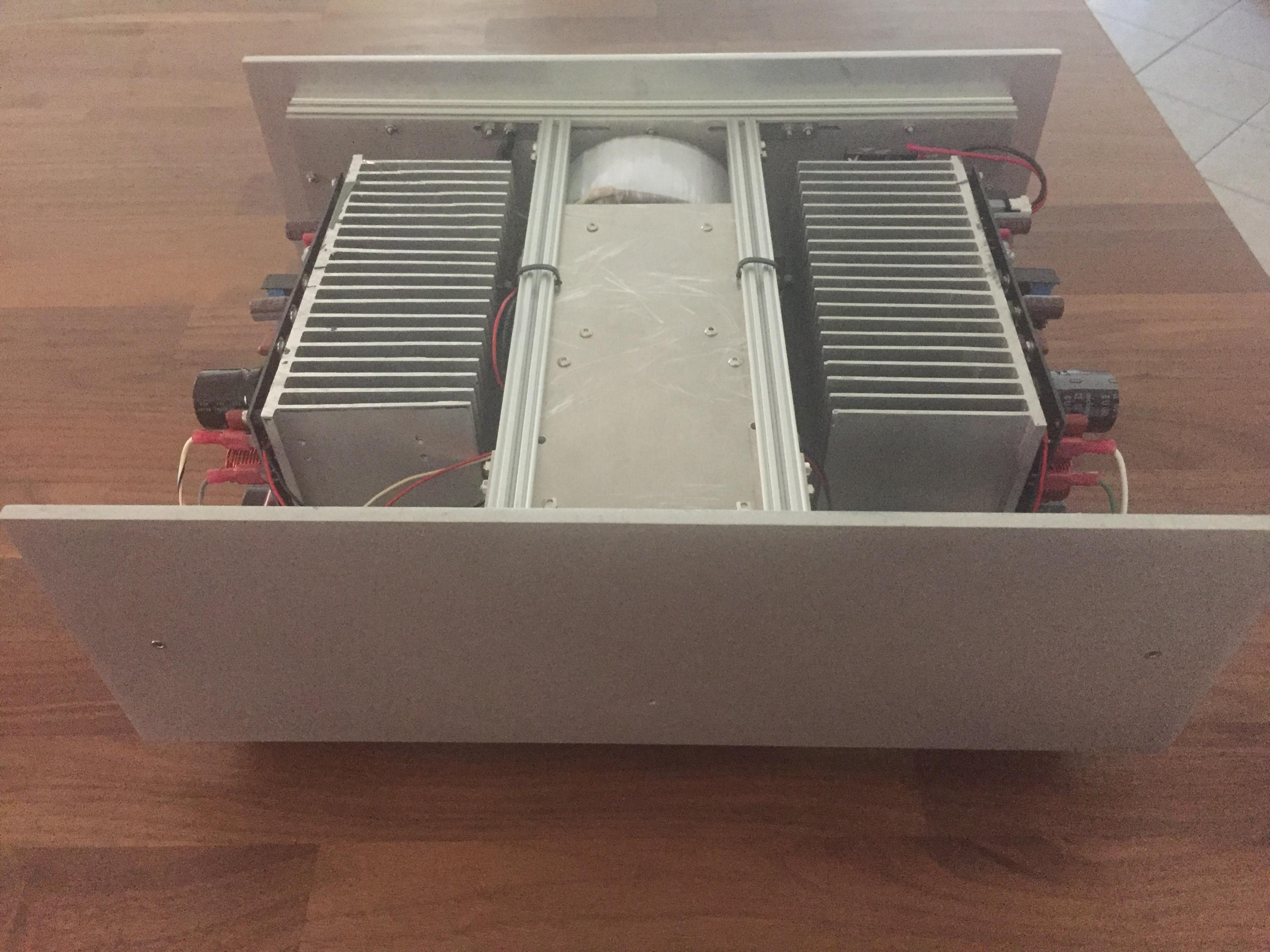

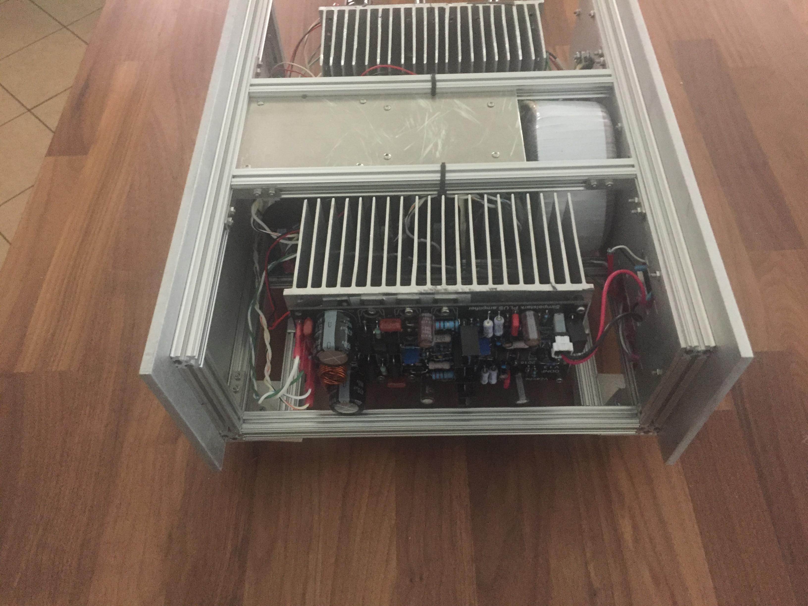

Simpelstark V1.3
Not quite done but now I have to go to work for a week.
These Simpelstark boards are quick and easy to set up.
I'll post impressions in a couple weeks. I'm very optimistic.;-)

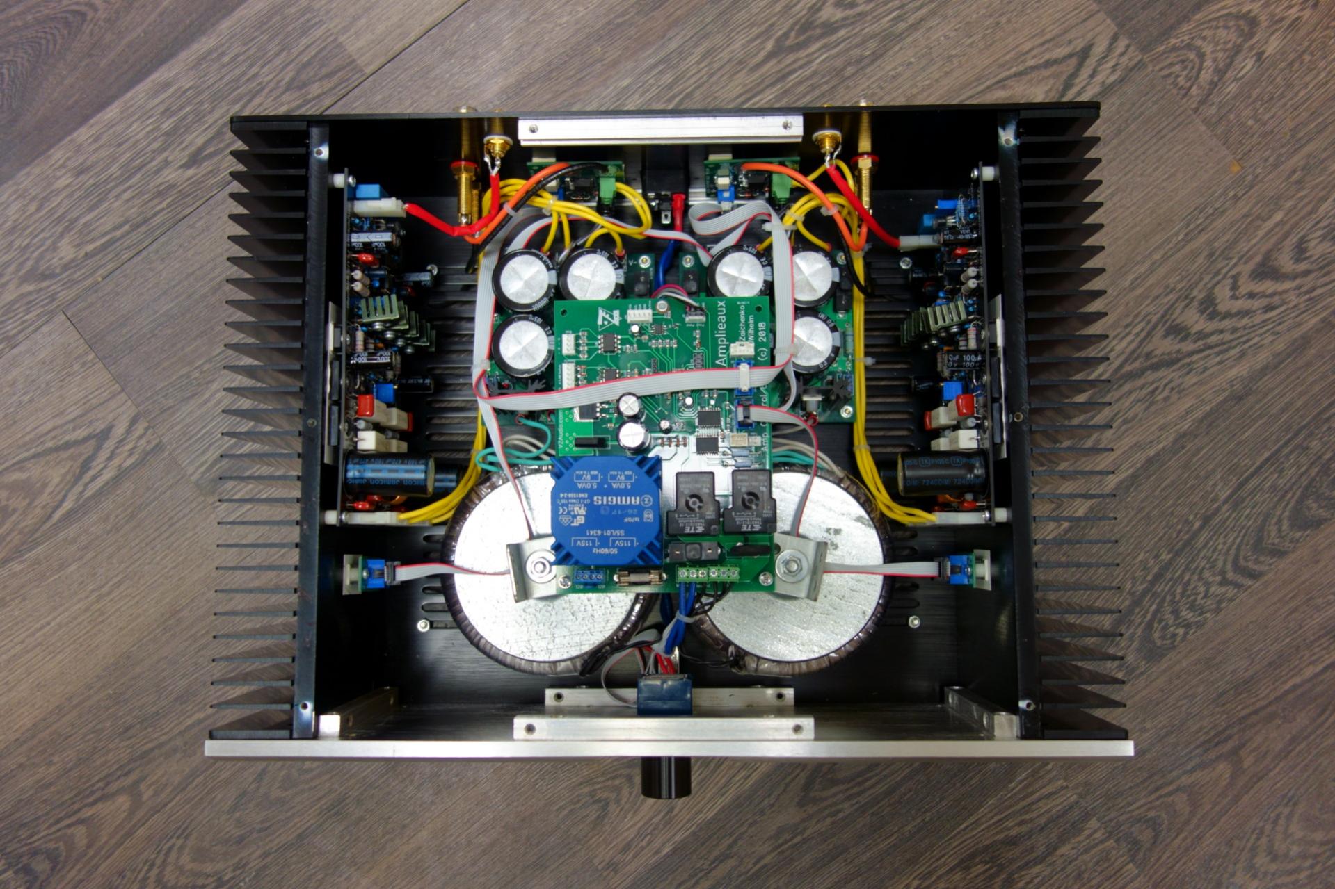

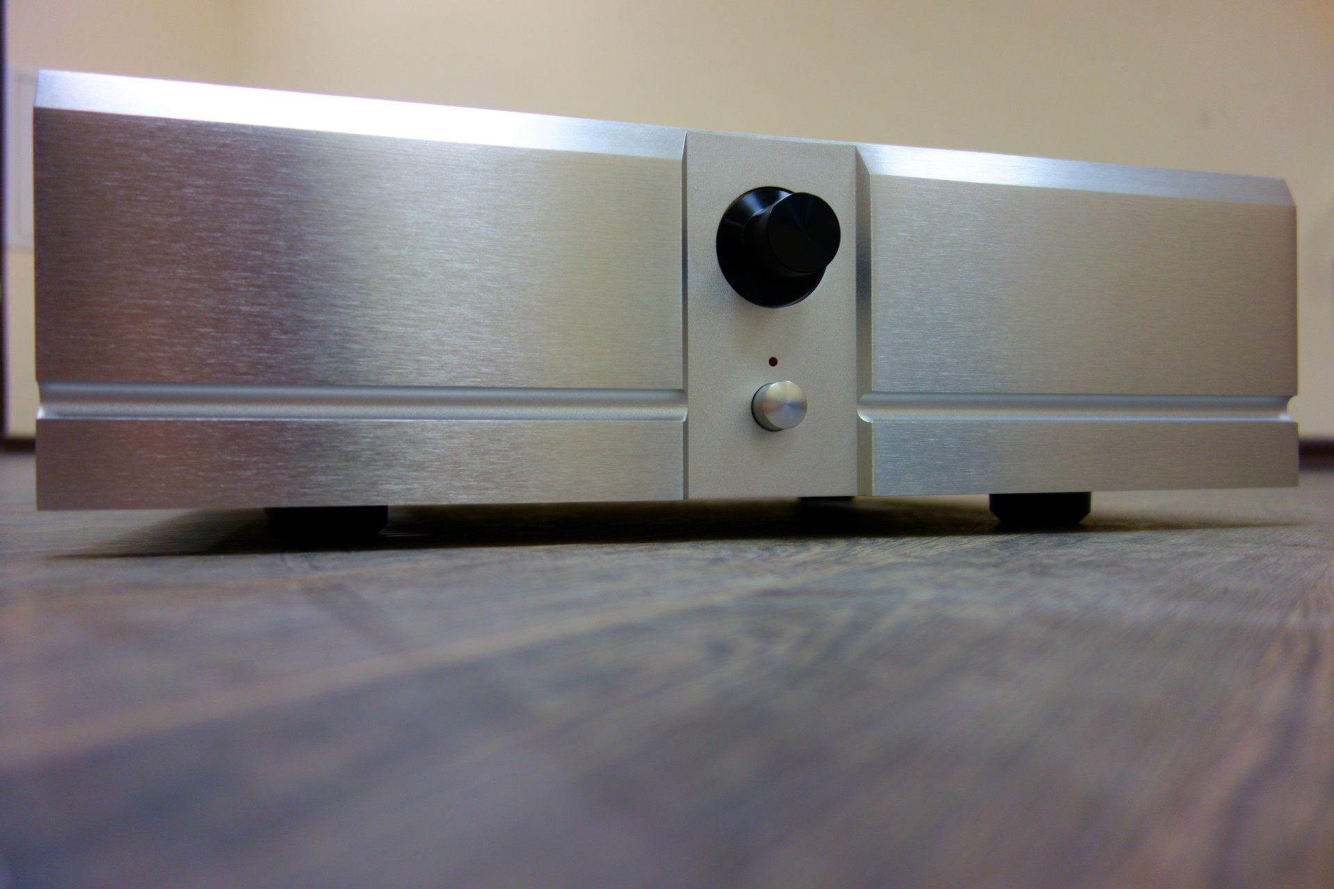

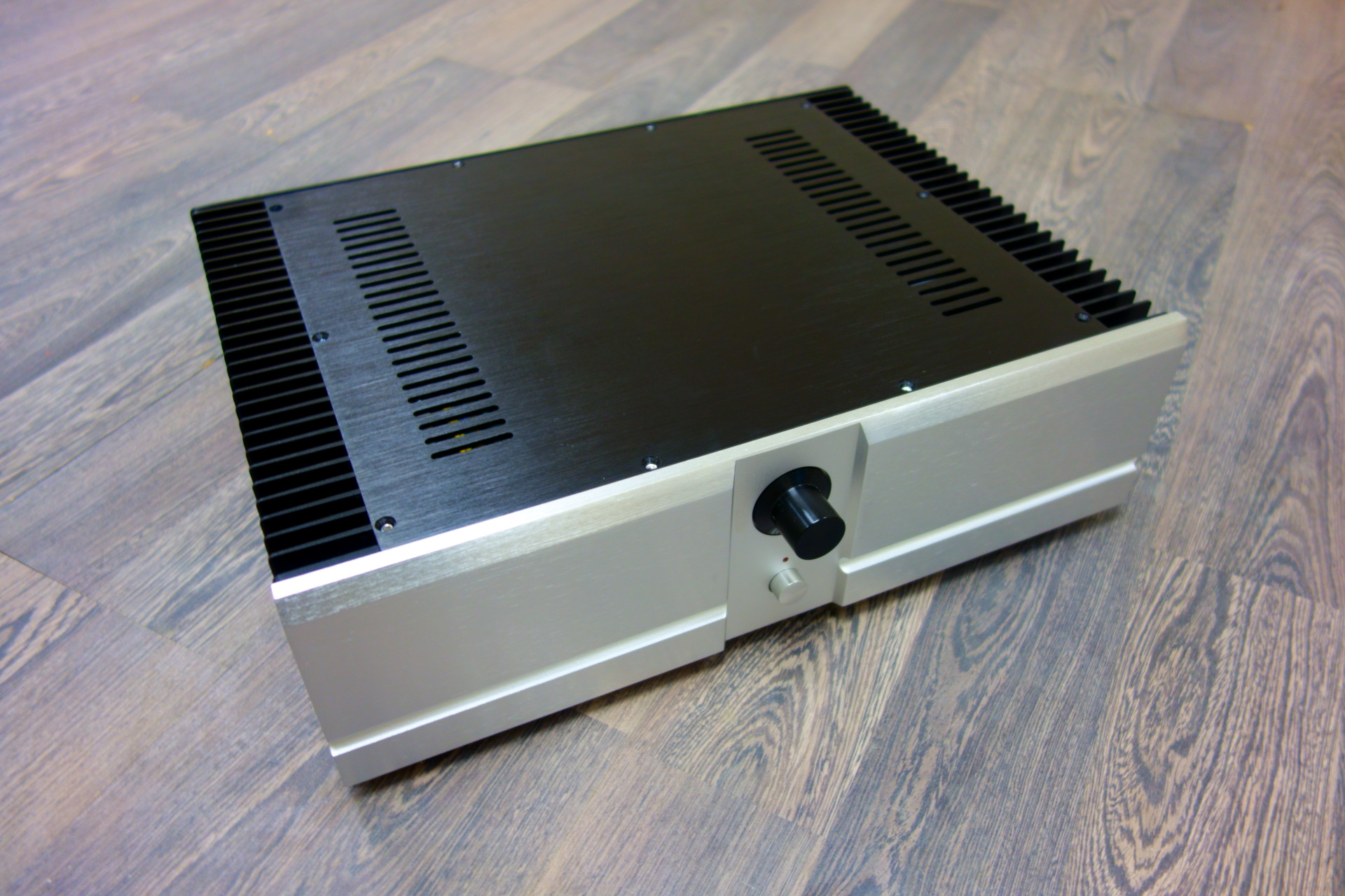

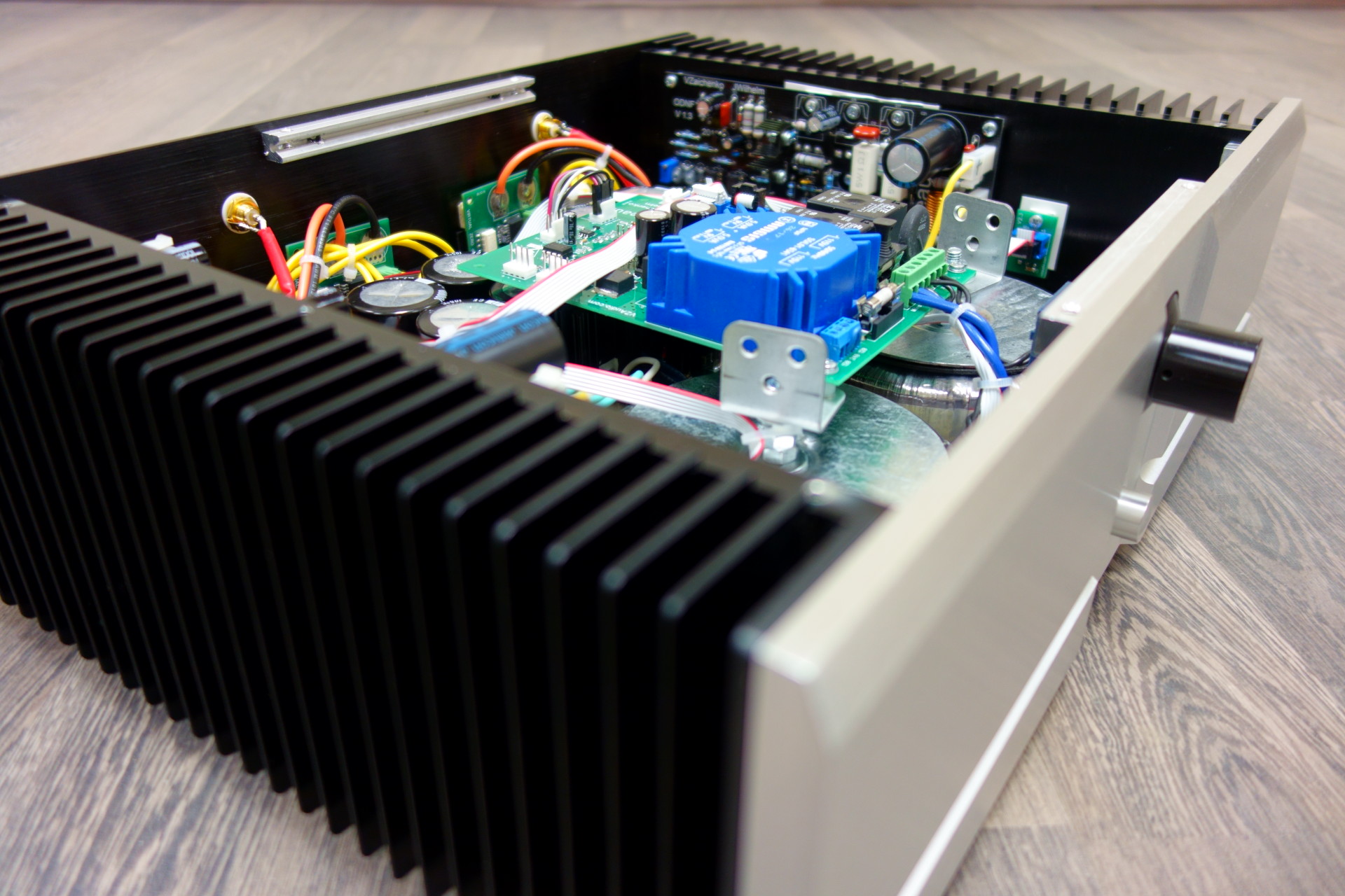

My Simpelstark+ V1.3
Hello All,
Here is my home build of Simpelstark.
More detailed post - in the Solid State Pics Thread.
I've got a fully dual mono configuration - separate transformers, separate PSUs, optocoupled protection.
Very happy about this build - I'm going to use it as my main amp at home for a while 🙂

Hi Valery,
Nice measurements for a no global feedback amplifier !
What's the recommended rail voltage and transformer VA for 3-4 ohm speakers ?
Regards
Hi Danny,
Simpelstark V1.3 can drive 4 ohm speakers up to 160W as is.
However, if you need less power, it will feel more comfortable running at some lower rails voltage with those low-Z loads.
What kind of power rating do you have in mind?
Valery
P.S. Nice speakers by the way :up: 😀
Hi Valery,
They're about 93db sensitive.
I once tested my speakers and with 1.5V I get 91-92dbc at listening position.
I don't need the high voltage just more current.
I've just finished with a redesign of my speakers, with the new crossover they're now a little easier load, dip is 3.2ohm (100-200Hz)
I enjoy your threads about your different amplifiers, very nice concepts.
Danny

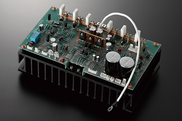

Luxman L-507 uXII
After reading this thread: I went from Class D to Luxman A/AB - And most of what you think is wrong | Audiogon Discussion Forum
I searched for info about Luxman 507
L-507uXII | INTEGRATED AMPLIFIERS | PRODUCTS | LUXMAN | Seeking higher sound quality
ODNF* Version 4.0 innovative amplification feedback circuit
An integral part of the design of the L-507uXII is LUXMAN’s original ODNF amplification feedback circuit. This features a fast-primary slew rate and an ultra-wide bandwidth that is achieved through the feedback of distortion components only from the amplification output circuit.
The latest version of ODNF–Version 4.0–is used, resulting in a dramatic enhancement of accuracy in distortion detection, lower impedance and a higher S/N ratio due to a parallel first stage and Darlington connected second stage of the amplification circuit, as well as a 3-parallel first stage error detection circuit.
A 3-parallel push-pull structure output stage achieves complete output linearity of 110W+110W (8Ω) and 210W+210W (4Ω). This type of circuit can achieve high power ratings that are comparable to a separate amplifier and has the force to drive various speaker systems to deliver high grade sound reproduction.
