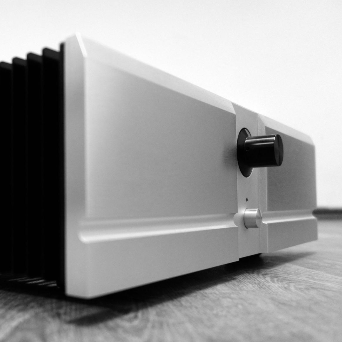

Hi Hugh,
Thank you 🙂 It's really the best-sounding amplifier I have.
My prototype is in France now, being tested with Davis Acoustics speakers with very good results.
Valery

BTW, what volume control do you use on the picture above? Is there a preamp in there? Looks really nice!
Let's keep +/-39V - no problem. Certain disbalance in the IPS is not related to the rails voltage, although we have never experienced this kind of issue before.
No problem - let's just try to move the trimming range, shorting the 100R resistor on one side and adding it to the other side - I think in this case you'll be able to zero-out the offset.
The volume pot on my prototype is not connected to anything right now - it's just covering the hole in the front panel 😀😀😀
However, I plan to add it as a simple passive attenuator in the future - it's an ALPS 50K audio pot at the input.
