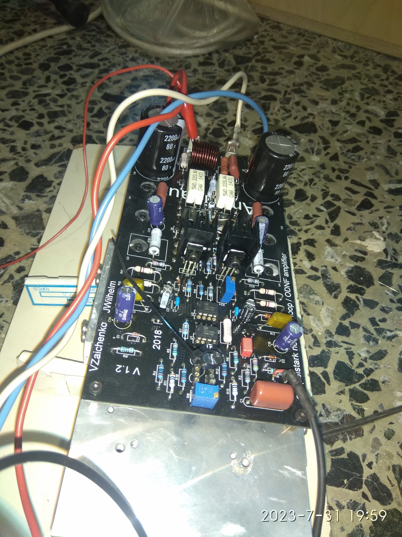

I have an older ver.pcb 1.2
This version use Latterals as drivers for BJT.
As i had most of parts in home,i did not resist to assemble this.

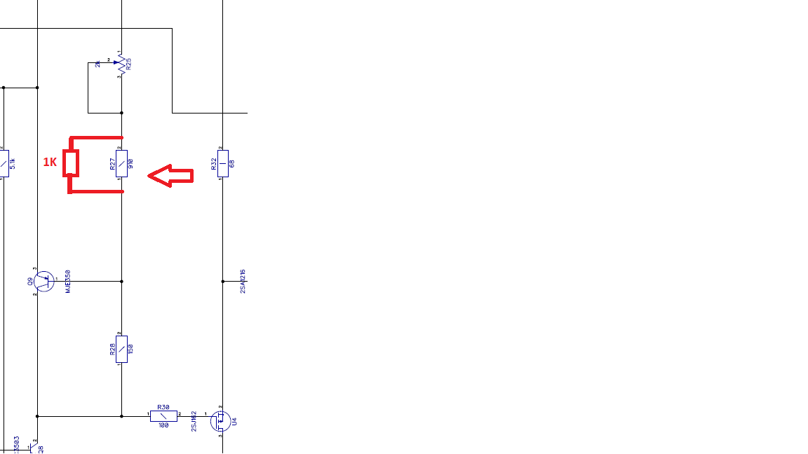

Using the design values bias was zero.
I placed a 1k resistor parallel to R27=910ohm

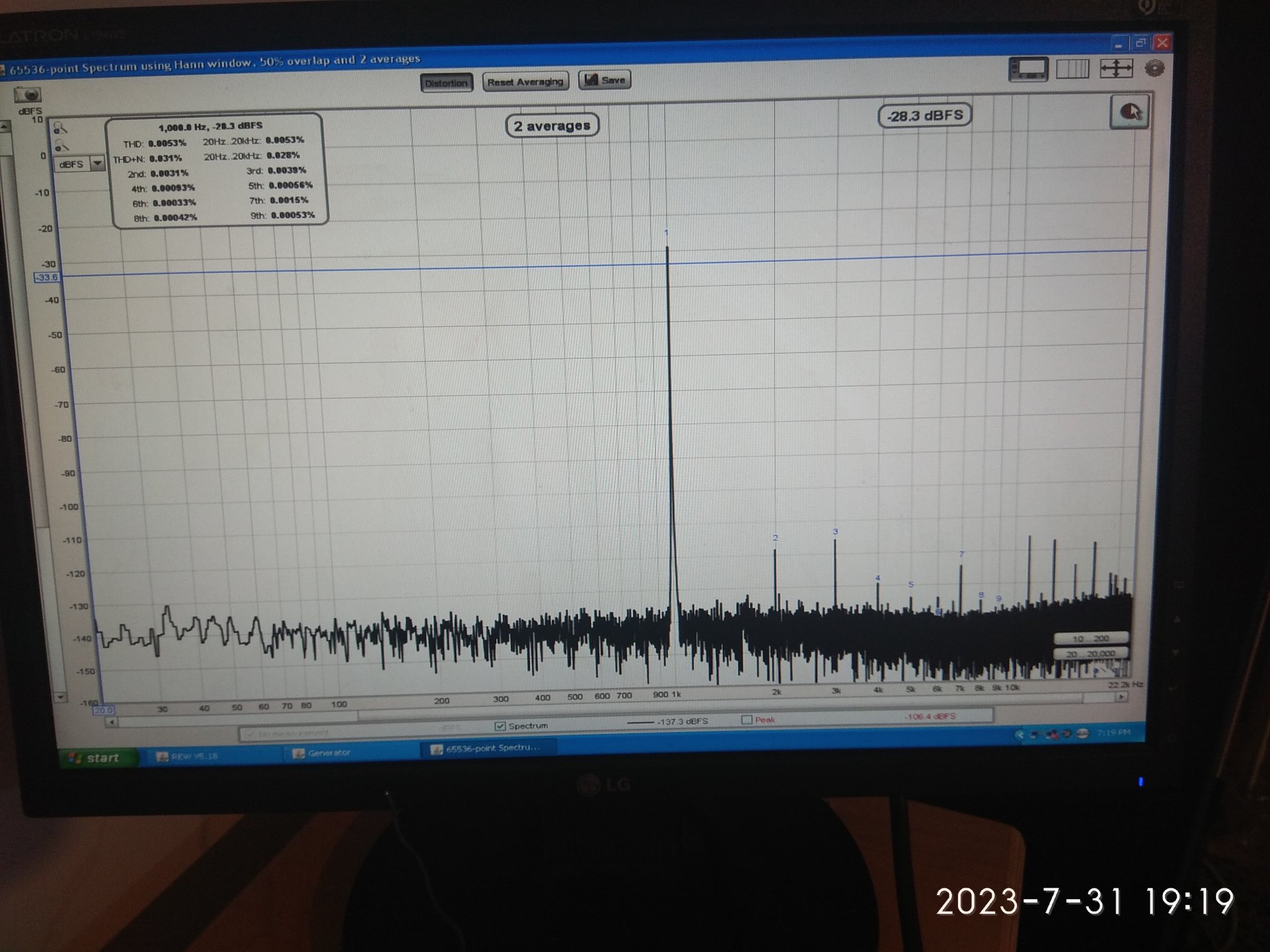

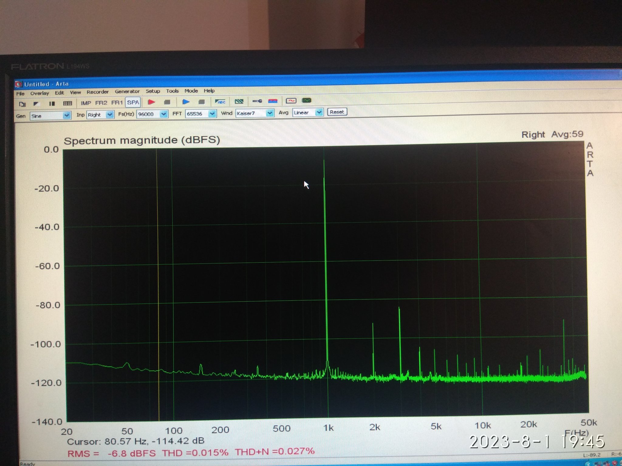

Amplifier is death silent,as you can see on the grapf.
Sound is awaysome BUT up to 10v RMS.
Power supply is +/-45v.
Increacing volume even farther,distortion becomes huge 5-10%.
Please any sugestion?
I have an mp3 recording ,using an UMIK1 micropfone and the audacity software.
Room acoustic is terrible but i hope that you can hear amplifier character.

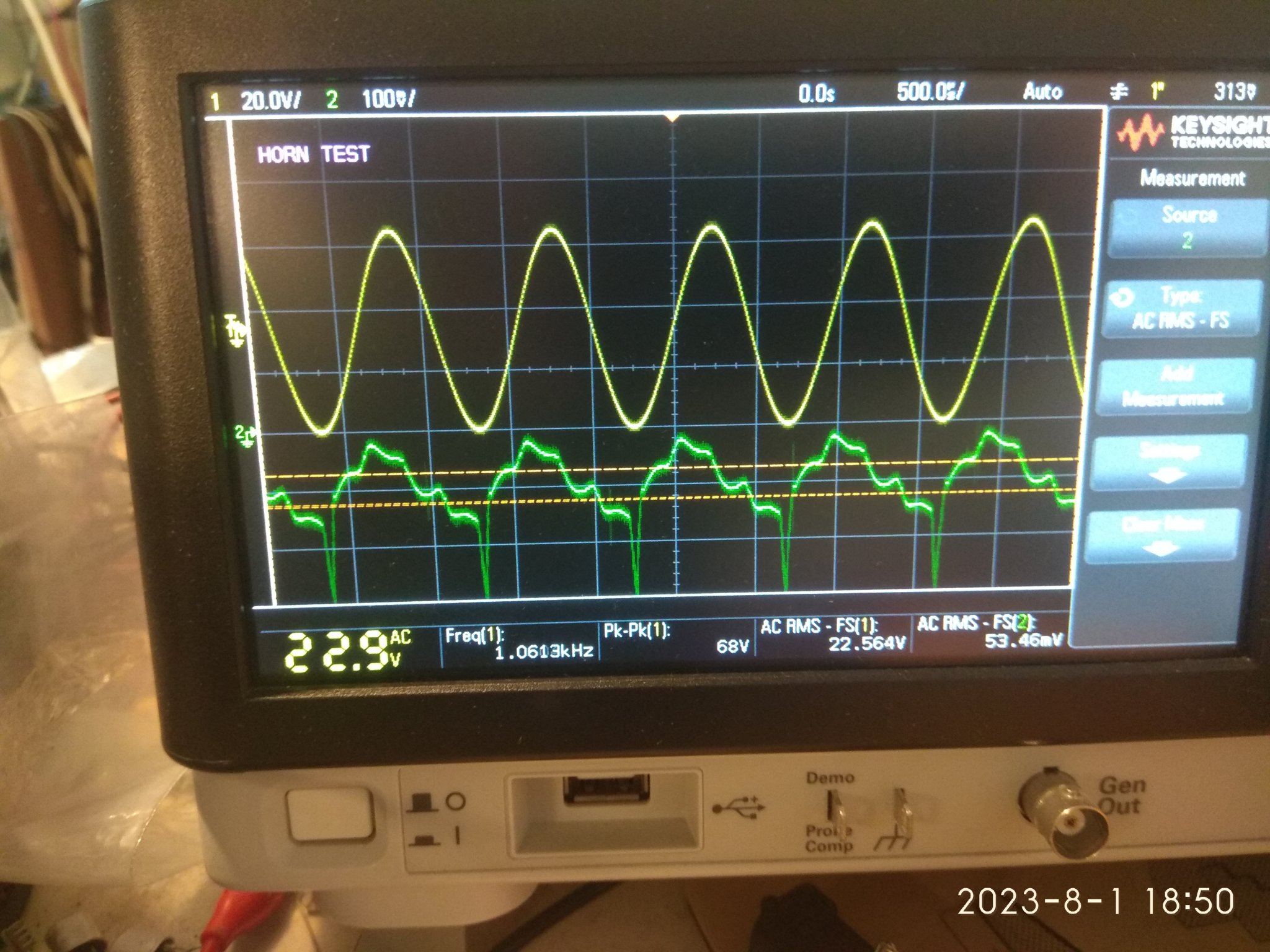

Mystery solved.
You can't use the feedback components R40 2K7 ,C21 10pf AND the error correction in the same time.
Here is the scope measurement when output is max unclipped and the error correction signal in the same time.
That actually makes sense. Both feedback and the ODNF circuit would be trying to correct the error in the output at the same time but the feedback circuit would be attenuating the output as well causing the ODNF circuit to try to boost the output. I wonder if Valery added the feedback expecting to use one or the other?
Reactions: Svetoklik
Resuming,using the printed circuit ver.1.2 we have 3 different options.
1 usege of the error correction circuit.Install U1,U2 and the periferals.NOT install R40,C21.
2 usege of the negative feedback network.Install R40,C21.NOT install U1,U2
3 without feedback,NOT install NOITHER U1,U2 NOT R40,C21.Connect TP2 to TP3.
I will post THD measurements for 3nd option soon.
