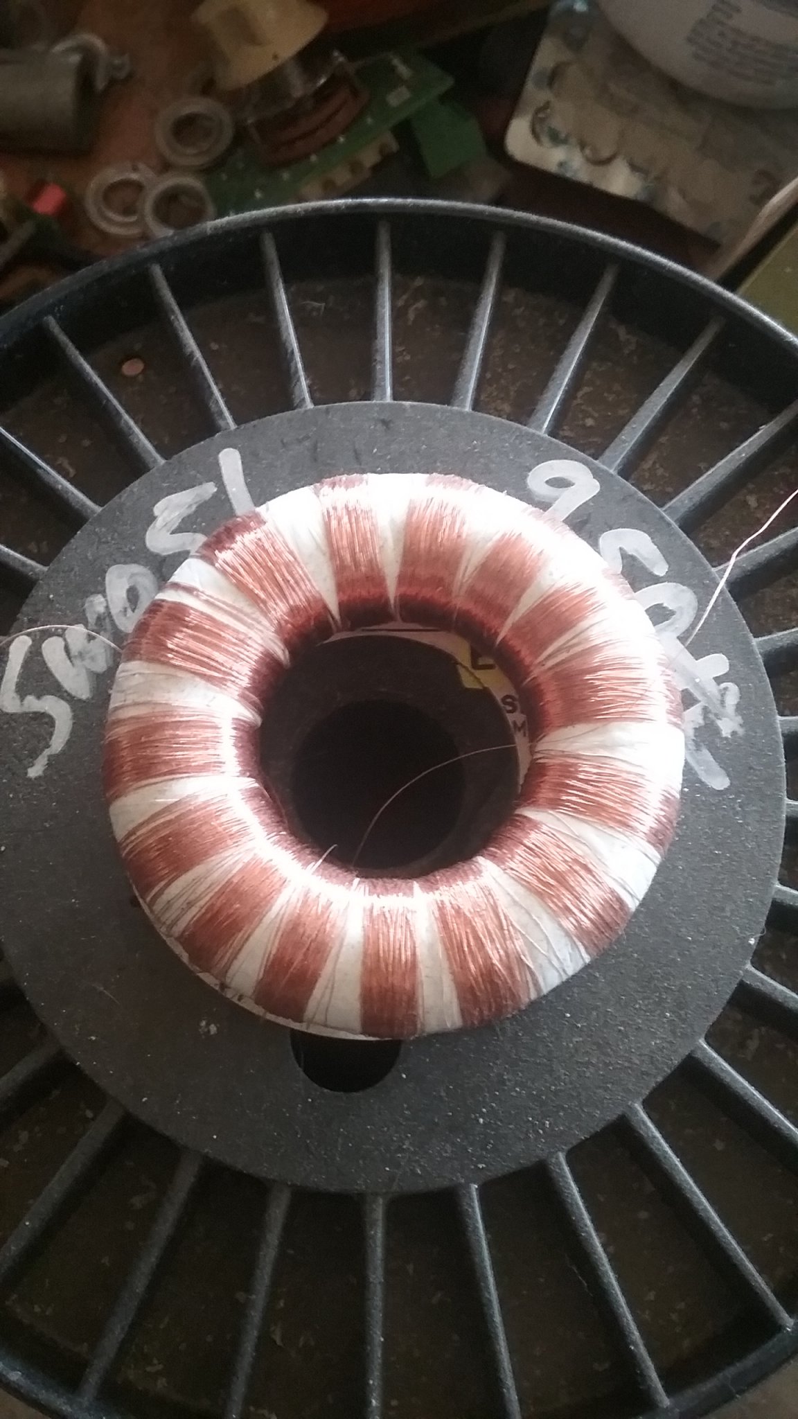

The world needs a low cost source of progressive wound toroid OTs.
Like this one on fig. b? What is the benefit? Thanks in advance.
Only takes a few resisters to fix transformer distortion. (Patent US4614914 ) The problem with transformers (good ones) is cost and weight. But I'll take them over OTL. Mosfet followers are fine too. The world needs a low cost source of progressive wound toroid OTs.

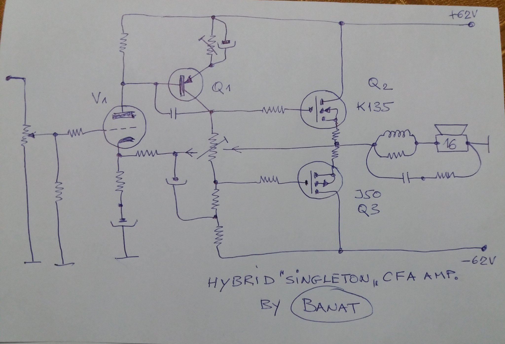

Working on couple different Hybrid amps , there`s my first very simple one Singleton CFA amp, it is DC coupled and consist from one small triode at input , one BJT as VAS ,and known couple of Hitachi power latfets as OPS , it is around 50W /16 ohm AB class with around 10W out working in pure A class , simulation says , it is very stable with very wide bandwidth , THD= 0,007% @ 1W , perfect square wave @ 20Khz , SNR 113dB/1Khz ,excellent PSRR ,and with THD spectra similar to some SE amp,
and there`s no any output transformer.
Similar to fig. B. The scheme uses "chevron" shaped winding motions. The idea is to keep turns with similar voltage together so as to minimize distributed capacitance and to do that in a uniform way (no gaps or notches) so as to avoid any local flux loops that would cause leakage inductance. Since there are toroid winding machines that will do this automatically, it is logical to use them for OTs. But they are more expensive (require accurate control of toroid angular position and digital control) than the simpler "random" wind machines.
Power toroids are actually wound in the "random" way to maximize distributed capacitance so as to improve the power factor (cancel some of the inductance), completely opposite to what you want for an OT.

Thanks smoking-amp! If I understand correctly, with a similarity with triode capacitance, having turns with similar voltage close to each other will minimize the "Miller" effect: you still have a capacitance, but being the two "faces" of the capacitor at similar voltage, the effect is minimized.
Yes. Also important to avoid any notches or gaps in the wind to minimize leakage inductance.
It is also important that each half of a conventional center tapped primary cover the whole toroid (with good insulation between them) so as avoid big time leakage inductance. A progressive single layer Circlotron wind (1/2 the turns) would solve that well. Some comments I've seen favor doing interleaved partial primary and secondary winding layers, but it seems to me that just doubles distr. C and maybe reduces leakage L a little. It certainly would increase the cost.

But this is an amplifier with global NFB...

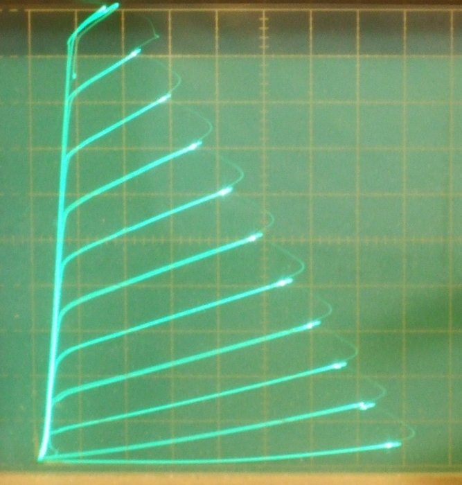

With a no Fdbk pentode you get an output impedance (Rp) that varies as 1/Sqrt(current) and a forward gm that varies as 3/2 to 2 power law.
Class A P-P could clear some of that up. Another alternative would be Crazy Drive, pic below. Constant gm but still 1/Sqrt(I) Rp.
A 6V6 would get you 70K to 80K Ohm Rp. Could also use a cascode circuit to get high Rp, could be used with Crazy Drive too ( bottom tube ) for constant gm as well.

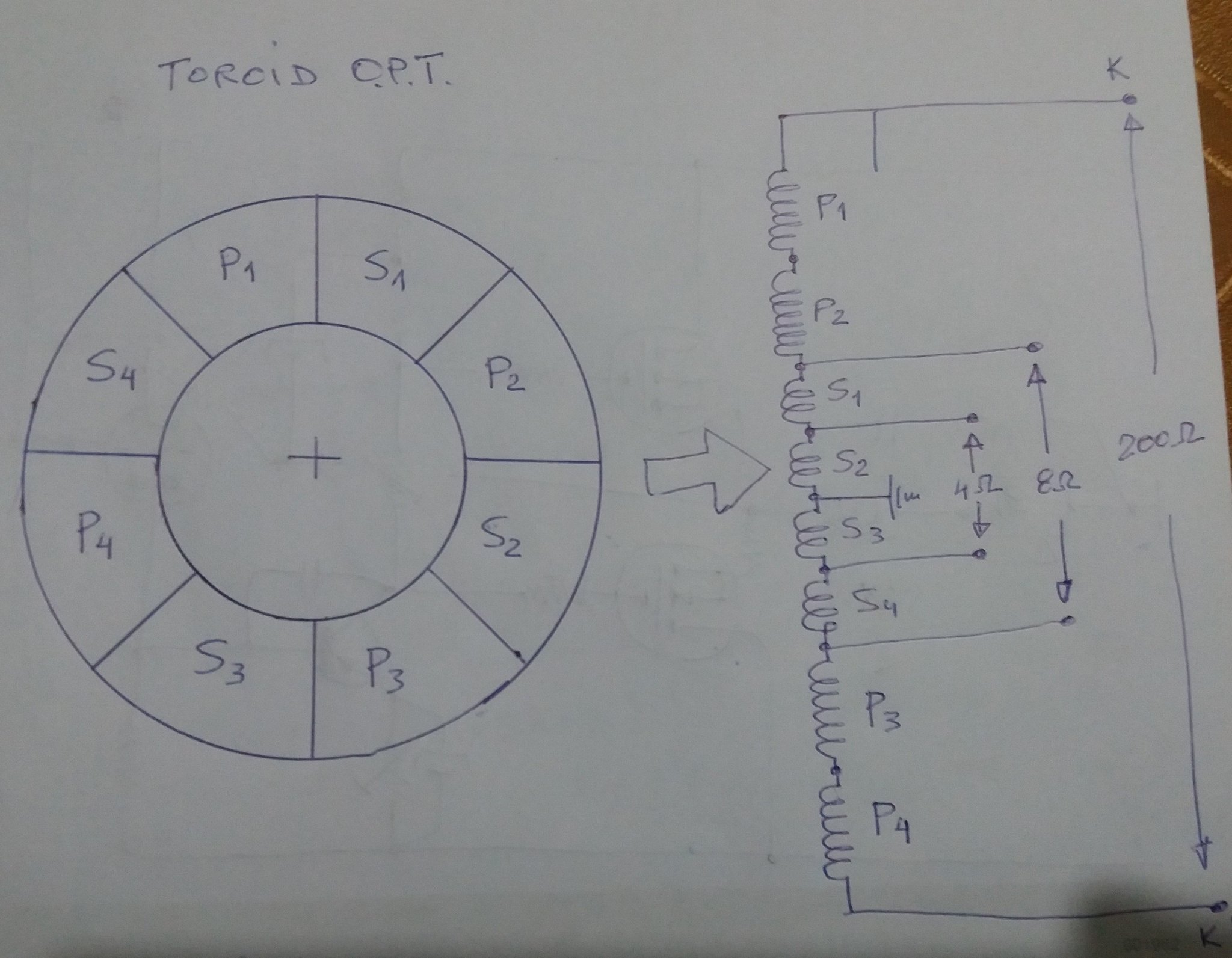

IMO the simplest & best way to use toroid OPT for GNFB-free amp with power pentodes is to use Circlotron based OPS ,
but for best results that OPT have to be connected as symetrical autoformer with center tap earthed ,
for example if you use 8 x PL36 (EL36) you can get around 120W out. , in that case total OPT impedance can be around of only 200 ohm , I think such toroid OPT can be done manually (DIY) very easy ,
Philips AG9007 OTL Circlotron amp can be very good starting& reference point for you , just ignore complete front end section altogether with those two independent GNFB loops ,on that Philips amp I like very elegant PSU where is aranged that EL36 plates work with +300V and screen grids with only 150V , that ensure to EL36` relative long lives ,and all that operating in pure pentode mode ,
here`s my idea how you can try to wind such simple autoformer OPT , at least that will be way if I DIY such toroid output power autoformer for me , there`s no layers of wires , if possible every section is made just wire by wire side by side ,in the same way as you show in post #47, but on the end I must point that I`m not very big expert for OPT`s !

Thanks! A very interesting OTL with no nfb (if one doesn't count the speaker autoformer). Perhaps will benefit from lower Rp pentodes such as 6Y6 or 25L6, and adding more output tubes in parallel. A drawback, though, is a need for high value output capacitor.
