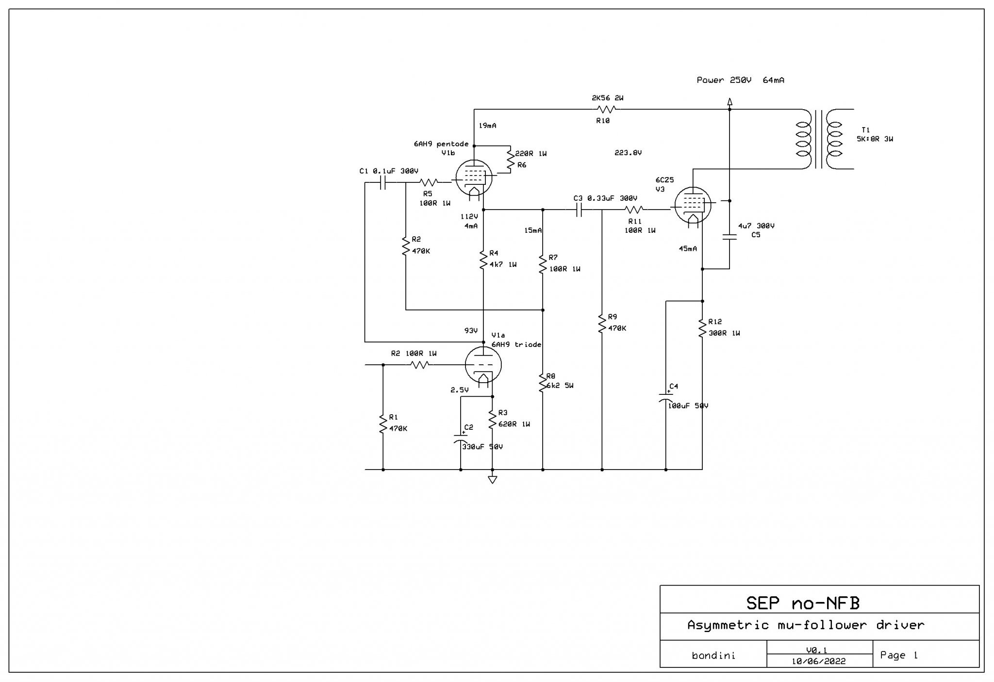

To keep it simple, I will recycle an old prototype amp circuit over the coming months. Input and drive will be via 6AH9 compactron configured as an asymmetric mu stage. The triode section is much like half a 6CG7 (mu=20). The pentode section is the 12HL7 (configured as the "triode from hell").
The output device will be a 6CZ5, working into a cheap 5K:8R single-ended transformer. I am expecting an output impedance in the order of 50 Ohms, and 2% to 3% THD at 1W. I may swap in EL84s - the Mullard data shows there will be nothing special for the measuring equipment. 🙂

Example? Schematic? It'd be nice to see what you mean, if unfortunately one isnt in a position to actually hear it ;')I discovered that when properly done a SE amplifier with CFB

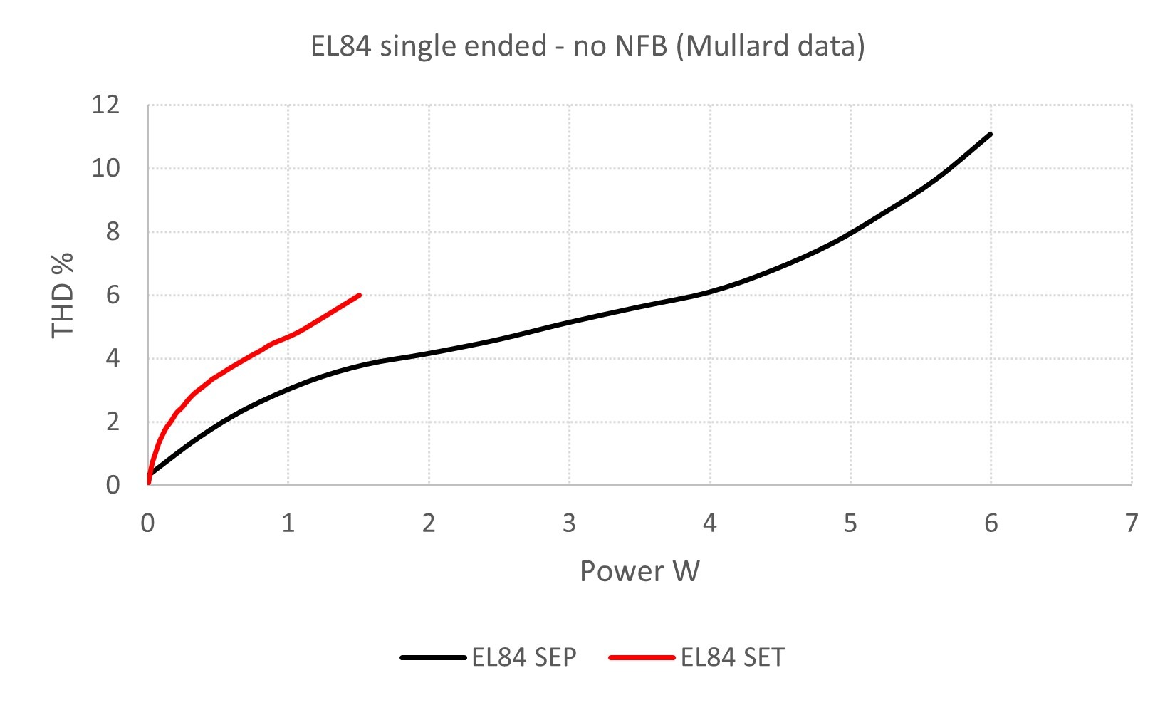

The distortion vs. power graph is interesting - pentode connection having less distortion than triode connection. Defies conventional wisdom.To keep it simple, I will recycle an old prototype amp circuit over the coming months. Input and drive will be via 6AH9 compactron configured as an asymmetric mu stage. The triode section is much like half a 6CG7 (mu=20). The pentode section is the 12HL7 (configured as the "triode from hell").

I'm not too surprised that pentode has less distortion. EL84 doesn't make a terribly linear triode, and you have to bias at a higher voltage and lower current to get a symmetric optimized operating point (unless you are going for A2). With pentode connection, you can set the operating point at a lower voltage and higher current where the pentode curves are more linear.
