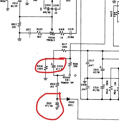

If both channels are affected then I still keep coming back to that FET mute circuitry. That could also cause distortion if the FET's were in an indeterminate state (neither fully on or off).
These two caps derive the voltages needed for the mute so definitely worth replacing them.

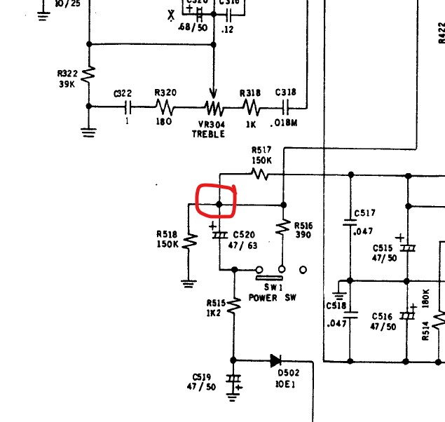

First have a measure of the DC voltage on C520 as shown here. The voltage at this point is the control voltage for the FET's and should be a positive voltage.
The actual voltage you see should be one half of the value of the supply rail produced by regulator Q501 and that looks like it will be in the positive 20 to 24 volt region. It will be one half because of the two 150k resistors forming a simple voltage divider.
So you should be seeing around positive 10 to 12 volts on C520. We need to know that voltage... but remember if the amp is variable in its fault (sometimes working and sometimes not) then this voltage may seem to alter.
This positive voltage biases the FET's on fully and allows them to pass the audio.
The above condition is the normal state of play in normal operation.
Now look at C519 and D502 on the circuit diagram. These derive a negative voltage supply that can be used to over ride the FET's normal control voltage.
When we take the control voltage lower toward zero volts and then pass through to a negative voltage then the FET's turn OFF and mute the audio.
The control voltage can be taken lower by the action of C520 'charging up' for a brief moment and also by the action of that third contact on the mains switch.
There are three realistic scenarios for problems here.
1/ Those two electrolytic caps. They are actually quite highly stressed and C519 in particular a prime candidate for deterioration and failure. You can't second guess or easily test them. Caps fail in subtle ways that a quick check of value and even E.S.R. will not always show.
2/ The mains switch itself could be an issue. If the third contact has leakage between the poles or sometimes sticks then it will apply this negative voltage to the FET's and cause them to mute.
3/ Finally the 150k resistors. High value resistors used across high voltage rails (although thb the voltages here aren't really high but still...) can fail by going high in value. This happens even though the resistor is well within its dissipation limits. If R517 was high then the FET control voltage would be lower than it should be which would cause the FET's not to be fully on.
If the control voltage for the FET is to low then the behaves in a non linear way and it will create distortion, a distortion that varies with the amplitude of the signal.
