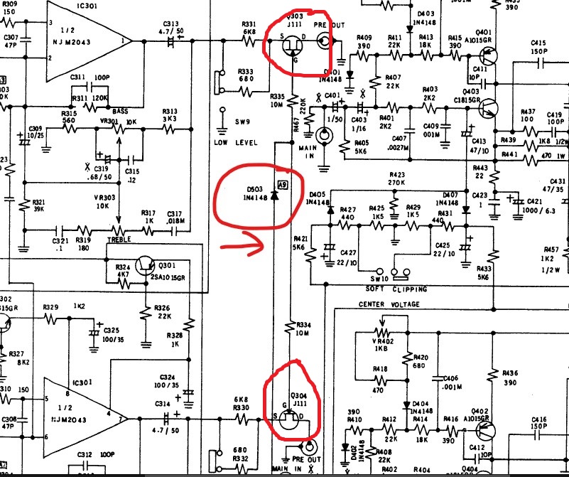

My NAD 3130 has developed a fault where there is no bass, (extreme treble). My speakers are the Bose acoustimass 5 and only getting sound from the tweeters. I initially thought that I had speaker problems but found this not to be the case after trying a different amp. Anyone experienced this problem that can suggest the cause?

Two technical causes come to mind.
1/ If both channels are affected then this sounds like an 'open circuit' in the signal path whereby coupling of the signal occurs capacitively across the break.
Does the amp have preout and power in links on the rear panel that are missing???
If it doesn't have those then cracked PCB print is a possibility. Even having the wrong input selected can also give this symptom.
2/ The only components that can fail and give 'no bass' are capacitors (usually electrolytic types), however if both channels are affected then its not going to be this.

Both links are in place
So your fault symptoms are pointing toward a break in the print somewhere. Bits that stick out (controls and switches) are favourite damage points.

Another possibility is the dual opamp in the preamp section might have lost one/both of its power rails - this would affect both channels and permit degraded signals to pass through the feedback networks, possibly accounting for bass attenuation.
Are the phono inputs working? - they would be affected by the same power supply rails I think.

So I've finally looked at the circuit diagram 😱 and see it uses JFET series muting in the preamp output. I have an idea.
Can you measure the DC voltage on D503 anode (the end without the stripe) and report what you get.
You can also try shorting out Drain and Source of either of the FET's and see if the audio then appears normally.
Remember to have the volume turned right down first.

Actually the volume control is before the FET's and so that advice is no good. If you short the FET's as a test then do it with the amp OFF and only then power up and test. Remember not to have the speaker wired directly... use a series resistor.

Thanks for taking the time to helping me out here, it's appreciated.So I've finally looked at the circuit diagram 😱 and see it uses JFET series muting in the preamp output. I have an idea.
Though I have learnt quite a bit on this subject recently, I've yet to get to the stage of shorting a FET, so understably I don't want to get ahead of myself.
I intend hooking up a separate preamplifier and will let you know the results that this produces. Then I need to learn more about what you suggested.
My line of thought was this...
The FET is used as a simple on/off device in this application, a bit like a relay, and its function is to be 'open' circuit or more technically for a FET we say 'pinched off' meaning it is non conductive between Drain and Source.
In that off state is is used as a mute which prevents switch on and switch off thumps and noises from the preamp from passing to the power amp input, however in the off state it would also couple capacitively a tiny bit between the pins and the print which would possibly give your symptom. It's a bit like the signal jumping the gap but only the higher frequencies stand a chance of doing that.
We can easily prove/disprove the theory by simply shorting the appropriate pins together (D and S) thus linking this FET switch out.
If by chance it were related to this then the fault could actually be the mains switch, which sounds strange but it has a third contact for muting... but we would look at that depending on what you found.
Without actually hearing your fault we can only generalise, and this line of thinking of an 'open' condition somewhere would be like listening to a typical good and working amplifer fed with a loud CD disc for example, but you then turn the input selector to something else (such as tuner) and you then turn the volume and treble full up. That faint residual tinny audio you then might hear is how I'm interpreting your description of the fault.
