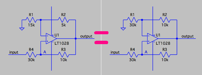

Background:
A negative impedance converter (NIC) is an opamp circuit that synthesizes a negative input impedance. In the diagram point A is the where the negative impedance is created.
the input impedance formula is: - R1 * R3 / R2
Here that's - 15k x 10k / 5k = -30k
So I add +30k as R4 to this, creating zero impedance at input - or put another way a current-mode input. With this circuit each milliamp of current at the input gives 40V at the output, and the opamp magically keeps the input at virtual ground.
Note that the opamp inputs are at 30V when the output is hypothetically at 40V - in other words if we can bootstrap or float the opamp supply suitably this circuit only sees a differential of 10V across its terminals for each mA of input current.
Given a real opamp capable of running at +/- 18V, and able to drive to within 3V of each rail, we have 30V of voltage differential available, so this circuit with 3mA input would see point A at 90V and the output at 120V (and similarly for negative swings).

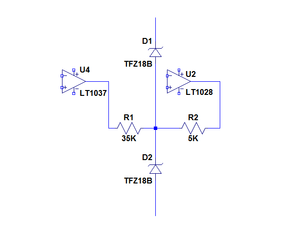

I split R3 into two equal parts to provide a bootstrap voltage that's midpoint between the inputs and output of the opamp, and use zeners and BJTs to bootstrap the supply so it can swing up and down with the signal.
The left hand opamp does the input and loop feedback, the right hand one is the NIC.
Note that the bootstrapping takes a small amount of current from the network, distorting the behaviour slightly. However the first opamp closes a feedback loop around the whole circuit (its the input stage in effect) which re-linearizes this. Driving the current into the negative impedance converter effectively boosts the open loop gain as this integrates the input opamp's voltage signal.
I fiddled around with compensation in an ad-hoc manner, to get the simulation stable and not too horrid on clipping or square waves, but there's lots more fun to be had working on compensation on a breadboarded version I think 🙂
The ratio R1+R2 : R2 sets the voltage swing magnification factor of the circuit. This can be tailored to the voltage rails - here 120V = 4 x 30V (where 30V is my opamp signal swing range), so I've used a ratio of 4, ie R1 = 3 * R2.
I've added rudimentary diode input and output protection to the opamp stages, and the high value of the inter-stage resistor allows this to limit currents to safe levels - again experimentation with a breadboarded circuit as to the robustness of the scheme is needed.

Background:

Cyan is the supposed virtual ground point, which isn't quite ground due to the bootstrap circuit's interference, but is well within the output range of the first opamp. Green and blue are point A and output of the NIC, magenta and grey are bootstrapped supply voltages for the NIC opamp.
Detail of the cyan plot:
One last thing, its DC coupled as the bootstrapping doesn't use capacitors, although you could swap current sources for a capacitive bootstrap if you wanted.

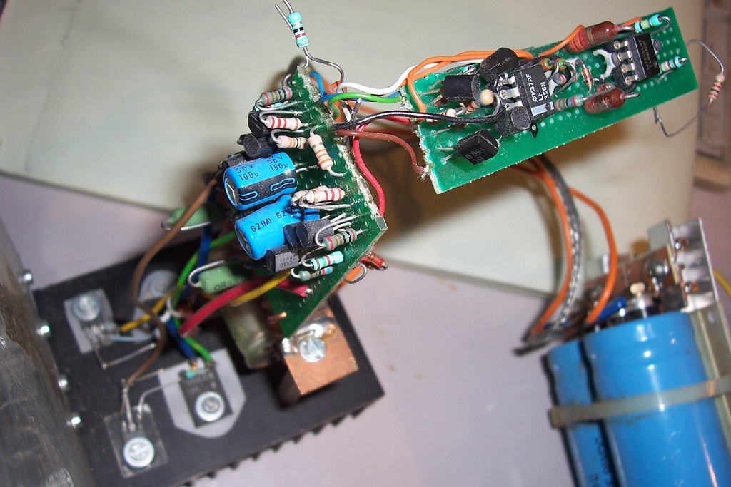

I have some experience with the scheme, and not only with EZdump.
This is a prototype I tested 10 or 15 years ago:
It does work, and has unmeasurable THD, thanks to the gain of the two opamps and a non-switching OP stage which is already extremely linear, but it can be temperamental.
I even made real public-address amplifiers based on the principle, but the performance standard was much lower, which eased matters considerably.
The behavior of opamps with bootstrapped supplies is always a little unpredictable, probably because of the reason given by Steveu: it changes the compensation behavior.
Some opamps could tolerate it better than others.
Deriving the bootstrap reference from a divider could have advantages, but I would use a dedicated divider, completely separate from the FB path: it only costs two additional resistors and removes a possibly problematic layer of entanglement from the equation.
I would also question the philosophy of completely cancelling the input resistance of the second stage: I do not see obvious benefits, but I see obvious risks.
For example, what would happen if R7 is 0.5% too high?
Even if the cancellation is exact, the first stage might see an awkward impedance to drive.

Proper prototyping style that!I have some experience with the scheme, and not only with EZdump.
Yes I was wondering about that - the internal capacitors can be referenced to one of the rails for instance, rather than just being internal to the signal path, and internal transistor capacitances to the rails is also an issue.It does work, and has unmeasurable THD, thanks to the gain of the two opamps and a non-switching OP stage which is already extremely linear, but it can be temperamental.
One thing I noticed was capacitively loading the bases of the bootstrap transistors could destabilize it if overdone, although it ought make the behaviour closer to non-bootstrapped setup which is at least predictable.
With a dual opamp package the second opamp can do this. Though it could also be used for bias circuitry too.Deriving the bootstrap reference from a divider could have advantages, but I would use a dedicated divider, completely separate from the FB path: it only costs two additional resistors and removes a possibly problematic layer of entanglement from the equation.
Well it actually sees a 30k resistor at the highest frequencies, dropping at lower frequencies where the NIC opamp's feedback is powerful enough to work well - I think this means that its basically OK - it certainly simulates OK with the resistor larger or smaller - the first opamp's output can be inverted at signal frequencies quite happily it seems. In this case I suspect the actual impedance with frequency plot sneaks around from +ve to -ve via a reactive impedance at some frequency such that Nyquist criterion is avoided. By luck perhaps!I would also question the philosophy of completely cancelling the input resistance of the second stage: I do not see obvious benefits, but I see obvious risks.
I add some capacitance across R7 too to reduce phase shifts along the chain, which is probably doing quite complicated things but seems to work in simulation and real life.

....A negative impedance converter ....the input impedance formula is: - R1 * R3 / R2 ... Here that's - 15k x 10k / 5k = -30k....
Well, yeah, all true.... but an insignificantly different set of values makes a plain ordinary everyday no-negative Differential Amplifier.
Setting the reference input to the output of a differential amp is quite a change though.
Note the topology of these circuits has infinite noise gain, whereas a differential amp doesn't.
I'm back working on this topology, combining it with lateral FET output stage, and simplifying the opamp bootstrapping to avoid the transistors, just capacitively bootstrapping direct from the output with some attenuation. The only discrete transistors are the output FETs in fact.
The circuit:

The breadboarded prototype is pretty close to this circuit, and seems to work (albeit rather temperamentally) I've not been able to load it at high power but it handles 8 ohm dummy load at lower powers and no-load also. Here's a band-limited square wave test on no-load:
The cyan and purple are the bootstrapped opamp rails, green is input at 500mV/div, yellow is output at 10V/div
