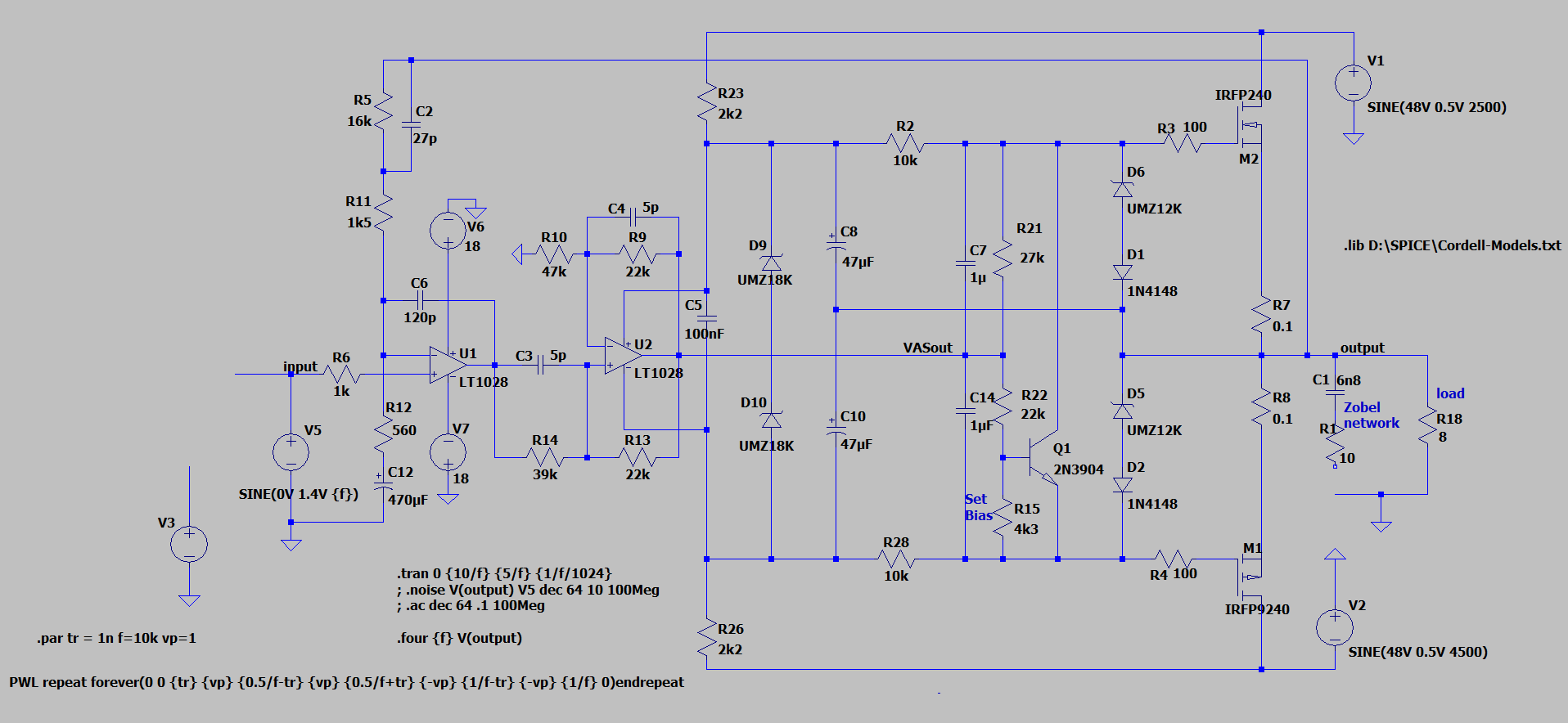

I played with this and found that the reason your simulation file does not latch up is, that it clips at 38V /48V, probably because of the latfets. If you reduce the load to 100 Ohms, your circuit latches up. The ratio of the feedback on U2 would be safer if a 48V output was reduces to less than the op-amp rail, so the inputs remain between the rails. I replaced the FETs with VFets and it just latched up until I changed R9/R10 and R13/R14.
And infinity gain at U2 is probably a bad idea, so I changed R14/R13 so that the gain is finite. I fiddled with it some more and the attached is where I'm at at the moment.

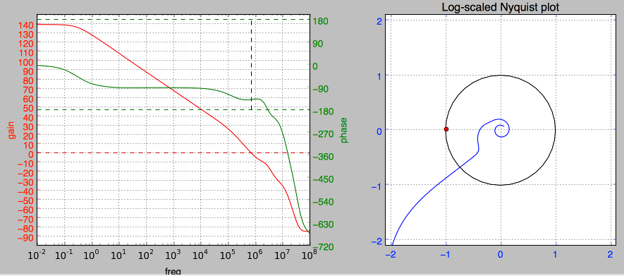

I've been looking at Nyquist plots in simulations of this and convinced myself that R14>R10 or R14<R10 makes no great difference to the stability, even though in one case the open loop DC gain is negative and in the other positive - or even if its infinite.
I note the distortion seems lowest with R14>R10, where the output of U1 is inverted, although this worsens the recovery time from clipping.
So I figured out a way to get Nyquist plots with logarithmic scaling (by exporting from LTSpice and processing in Python), so here are the plots for the two cases:
The black circle is the unit circle, and the red dot the point (-1, 0) for the Nyquist criterion. Outside the unit circle the magnitude of the response in the plot is scaled to ln(x)+1, and inside to -1/(ln(x)-1) - the angle/phase is unaffected.
The lack of clockwise encirclement in each case indicates stability...
And its clear the response at higher frequencies tends to the same behaviour in and around the unit circle (presumably the capacitors in the NIC network ensure this). And thus the low frequency response is not affecting stability (even the reversal of DC gain's sign, or presumably it going to infinity).
In otherwords the low frequency gain of the open loop is not actually interesting to closed-loop behaviour/stability, so long as its magnitude is large.

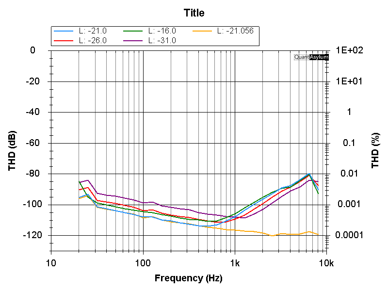

And distortion v. frequency at -5dBV input level:
The glitch at the end is the third harmonic going out of range - this mode of measurement seems not to allow setting a measurement BW.
Clearly distortion would be rising from 6kHz or so. I'm running the QA403 at 192kSPS BTW. The low frequency rise may be inadequately sized bootstrap caps?
FYI the amp gain is 30dB, so -5dBV in means 25dBV out (18Vrms). The amp clips unloaded at about -1 to 0 dBV input.

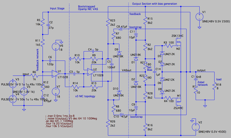

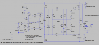

And here's the as-build circuit (or close to it) I believe:
The opamps are actually NE5534A's (I couldn't get the simulation to run with those models alas), and the outputs are Exicon's, not Hitachi. I believe the input network is a bit more complex on the PCB, and the first opamp supply is zener based, I can dig out the actual PCB schematics too if interested.
I've tested the amp again with 8 ohm dummy load, and alas distortion pops up - presumably from the output stage asymmetry (investigations show its predominately even harmonics):
(The orange plot is unloaded)
Clearly the global loop is running out of gain to correct the OS distortion quite early - its about 12dB per octave.
Not in my simulations nor in the real circuit - U2 is bootstrapped to follow the output with a little attenuation, keeping its input and output pins within its supply range. It the outputs are 45V or so the inputs are 15V or so - remember this is really an NE5534A with +/- 18V supplies
