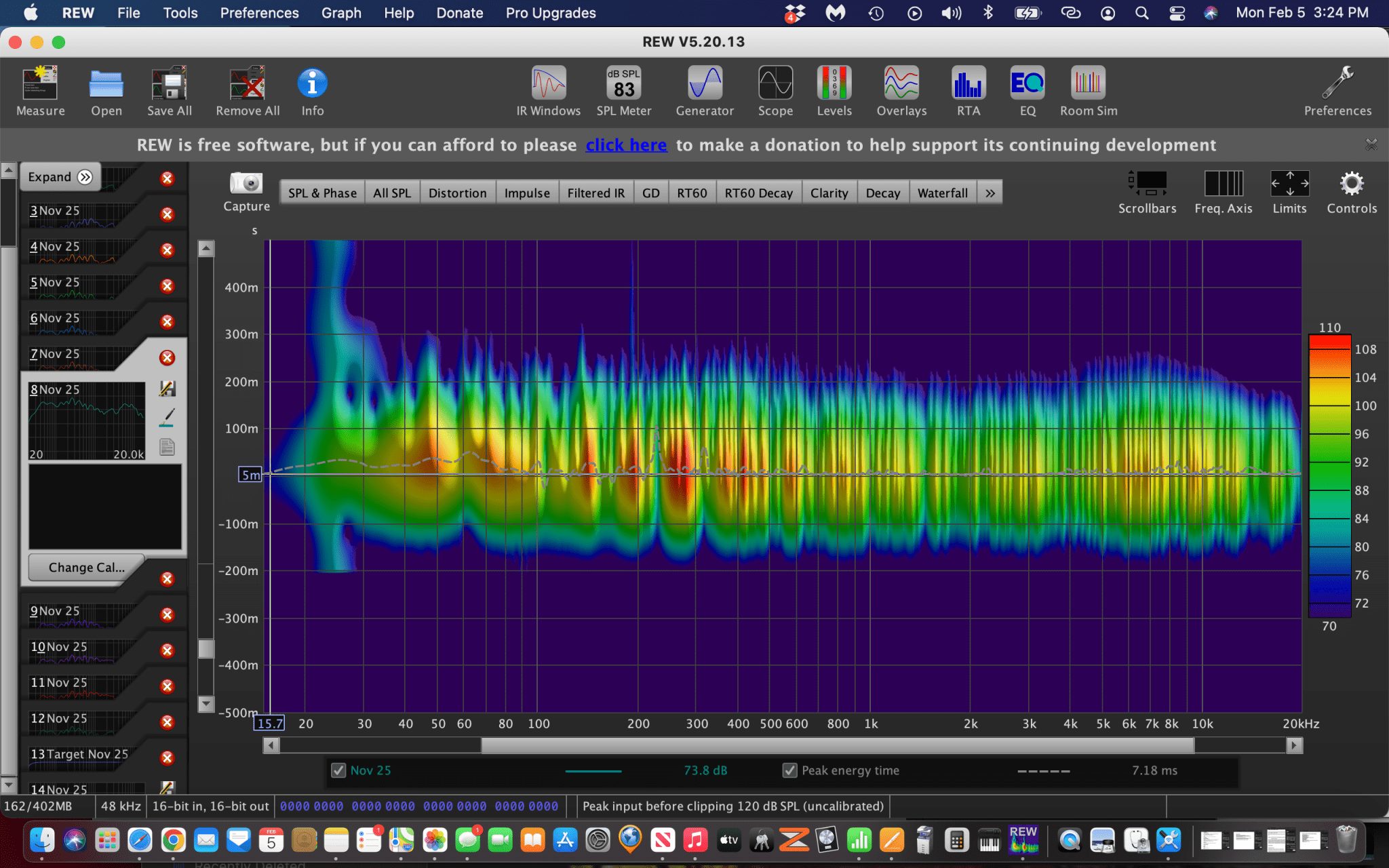

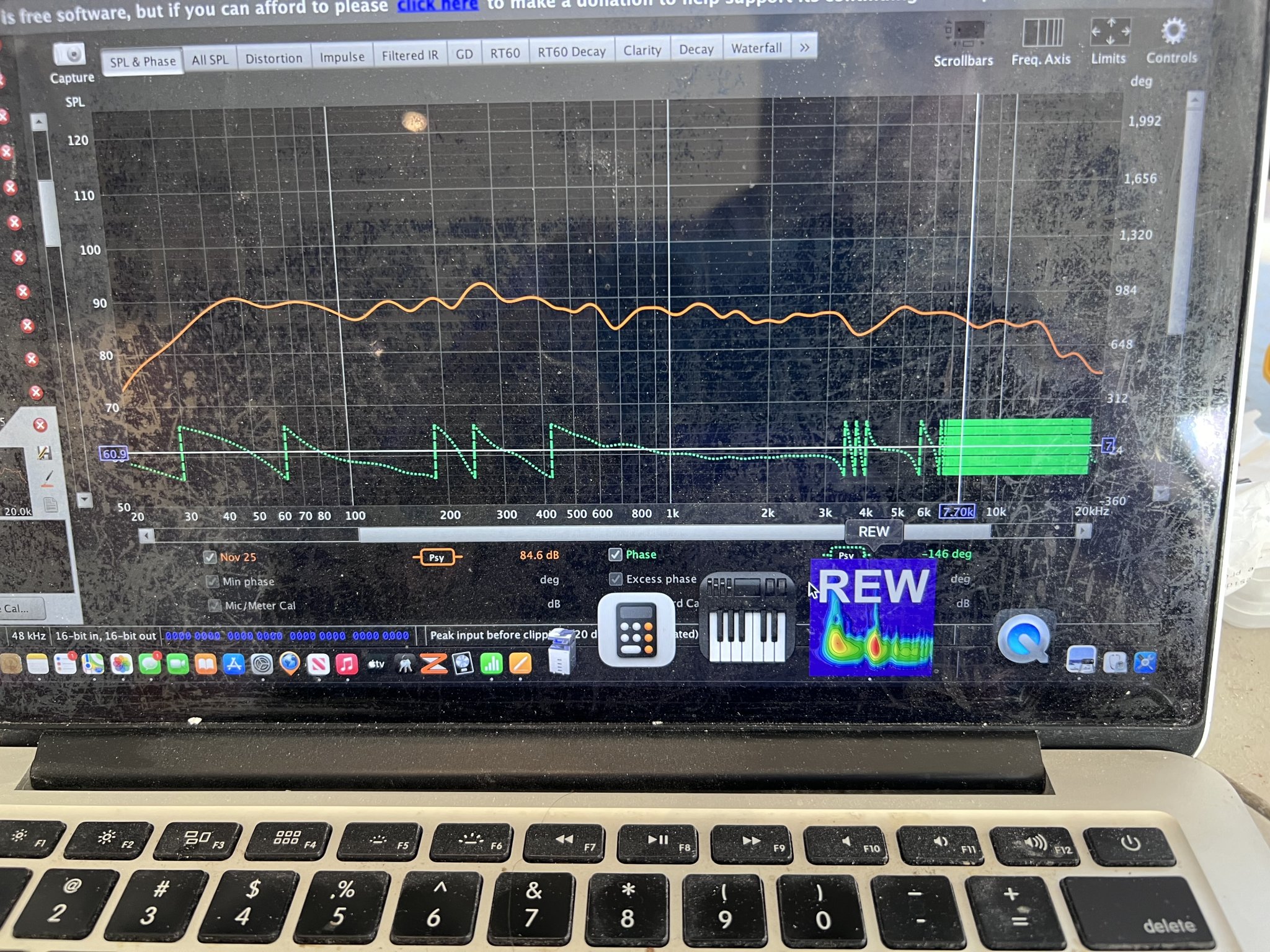

here's the Phase Response & SPL. I don't think I have it formatted correctly, it's a bit of a mess:gigantic, what is the phase response of your system ? Would you post a screen shot from REW of spl with the phase.
The reason I ask is that phase response is historicly ignored in horn loaded Klipsch speakers due (I believe) to the difficulty of driver time alignment with passive crossovers.
ChrisA (Cask05) brought phase response into focus here https://community.klipsch.com/index...y-effects-of-quasi-linear-phase-loudspeakers/
Here's the spectrogram:

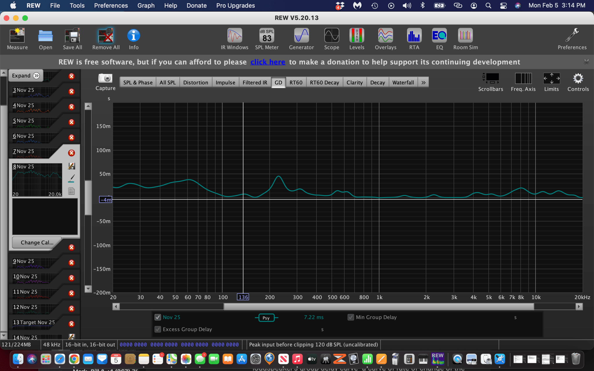

and finally, group delay:
there's a little room for improvement, but it's lot better than passive. I'm still a bit of a novice with REW and don't find the interface to be particularly intuitive.
That phase looks like you need to zero the "IR delay" from the actions menu on the upper right, then select "shift IR". If you have prior versions of REW than the last couple of months, that menu item can be found on the "Controls" menu instead.
Additionally, I'd recommend putting a lot of absorption on the floor between the microphone and the loudspeaker (and I hope you're taking measurements from 1m in front of the loudspeaker--no farther away), with the width of the absorption about 6 feet wide. Point the microphone at the loudspeaker--not at the ceiling, and make sure you're using the correct microphone calibration file for pointing at the loudspeaker if you're using a UMIK-1.
All these things will clean up the phase response within REW considerably.

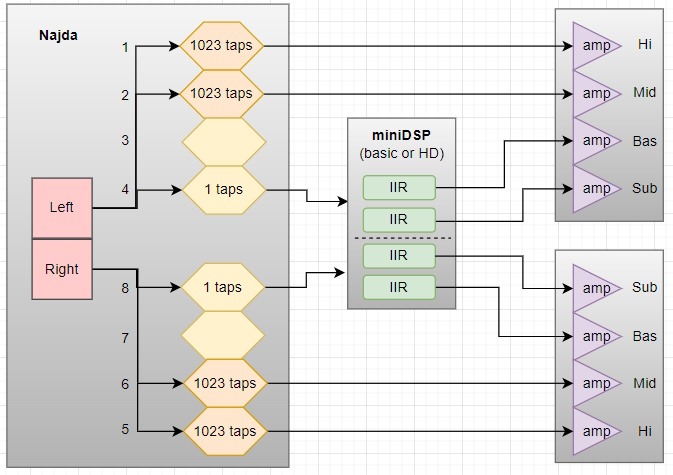

I have a Najda preamp/signal processor / DAC. This is a very nice processor with analogue, Toshlink, USB input 8 channel DAC output etc. Najda is also very quiet. It can do IIR or FIR processing. Not very powerful but see my solution to this in the attached picture.
The biggest advantage is that it is easy to use for anyone in the family. I think that this is the biggest challenge that is often forgotten in threads like the one we have here. I feel that this is the level of usability we need to demand and seek for. I know that it is a challenge with the offering that is available today.
Najda is sadly not any more available as Nick the developer has been declared lost somewhere in South America on a motorcycle holiday. Used or even never-used boards do show up now and then. They are not expensive typically under 500€.
My interest here is to find a solution to be able to use longer FIR filters. Mini DSP, Hypex FusionAmp and others like my Najda do seldom support more than 1000-2000 taps. This is only enough to EQ over 800z. I however am stretching it a little and also use FIR filters for my midrange drivers 170Hz to 1000Hz but this demands some compromises. The base or sub can not be touched with FIR and these processors.
So now we get to the question how about using a Raspberry with Motu Mk5. Wirrunna suggested this and it is tempting. CamillaDSP, jRiver comvolution and also Accurate Sound Hang Loose Convolver support this. But my problem is that I think that Raspberry is expensive. I paid 100€ + the SSD for my music PC a Lenovo M92p - Intel i5-3470T 2.90GHz - 8Gb RAM - Windows 10Pro - SSD 500Gb. This is in a nice box with several USB ports and can convolve any filter I have made. Raspberry seems to cost much more.
Here is a Hang Loose test that also tests how Raspberry manages FIR convolution. It seems to work but will it also do all other tasks like streaming etc?

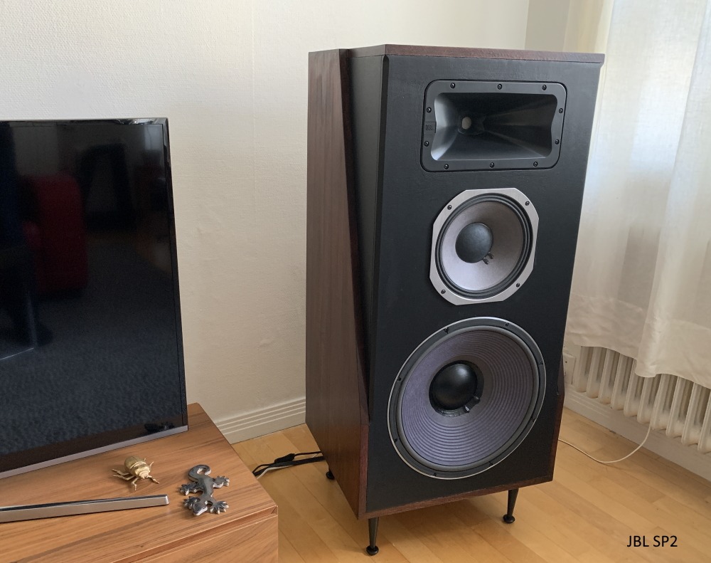

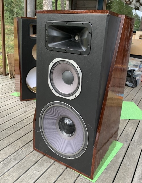

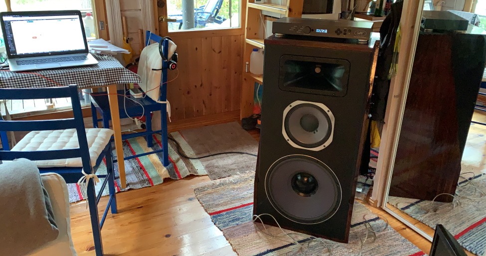

Here are some pictures of my speaker project. The goal with these was to build classic JBL speakers to be able to learn how to measure speakers and build FIR filter XO and EQ. I was working as a professional with PA systems in the 70s and 80s. Then we did only have golden ears. Now we have REW. It is almost like having heaven. I hope you all can understand this.
Speaker drivers are 15" JBL 2234 closed box, 10" JBL 2123 and horn JBL lense #5006815 with driver JBL 2408H-2 or SB Audience Rosso-65CND-T.
Yep, the quest for longer FIR filters, in a way we can use them, becomes a common goal.
How many taps per channel, at what sampling rate are you looking for?
Spalmgre has mentioned Acourate already and there is also Audiolense. These will give you more taps than you know what to do with 😉

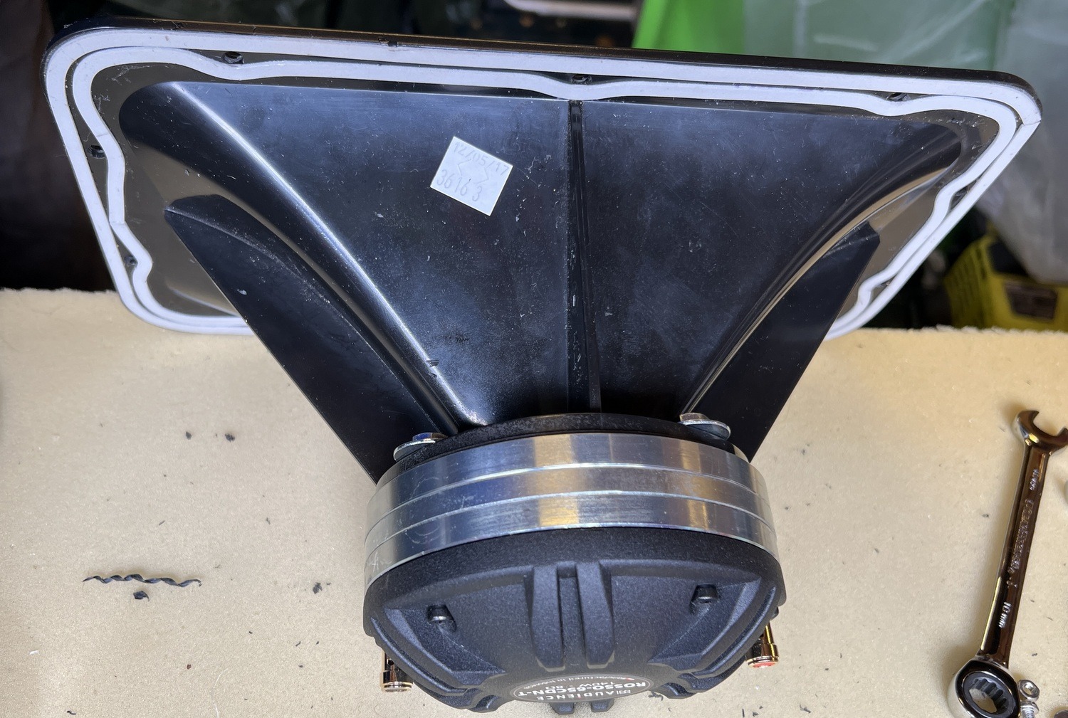

My modified K-Horns have an Eliptrac mid/hi horn with B&C DCX464 111db@1W sensitivity and I can't hear any hiss with my head in the horn mouth. The Motu UL5 feeds a pair of SMSL SH-9 headphone amps for mid and hi.Ultralite Mk5 has higher residual noise than the Okto, about 7 uV vs 3.5 uV which may be more noticeable with higher sensitivity drivers and/or higher gain amplifiers.

Previous posts in this thread have been given some advice about how to measure to be able to configure filters. I have done at least 1000 measurements with REW during about seven years. I have all the time had difficulty to be able to measure the same change in the reproduction curve as the simulation in REW or rPhase implies.
I did the standard one-meter measurement to linearise the drivers. Then moved to the listening area and measured to do some room correction.
Only two months ago did I finally understand how to do it right. At least so that I get a consistent result that can be repeated.
1) I did move loose chairs tables and pillows away from the listening area. I even moved the sofa when it was possible. This is to minimise reflections. These will of course return to the sound once in normal listening mode. But it helps to get better understandable measurement results.
2) All measurements were made at the listening area witch in my case is a 3-person sofa.
3) Hi and mid drivers are measured separately without XO and EQ.
4) Base drivers were measured together as mono. This is as I assume that the base in music is mixed as mono. This approach takes out a lot of wariables getting the base sound right.
5) All drivers were measured with the microphone moved to 7 different spots. This adds up to 35 measurements ((Hi L/R+ Mid L/R + Base mono) *7) . If you want to make it easy for you then take a look at Impala free measurement software. It measured as REW but it is very nice to work with when measuring in several spots. The Impala measurements can then be imported to REW.
I have not found much gain from doing more measurements. All measurements are "time aligned" in REW and then "vector average" to produce e good understanding of how the driver behaves in the room. Several measurements will minimise reflections so doing this further away from the speaker does not seem to harm the result.
6) Then I EQ in REW and export the filter settings and the measurement to rePhase. I have also tried the "Convolution with Inversion" method.
7) Then I listen for several days to find the right volume level between the drivers. I also produced several Hi driver FIR filters with different room curves. Switching between these not only determines how the hi-end will sound. The base level is much a product of how hot the Hi end is.
8) I have iterated the 1 to 7 steps at least 3 times during the last year after moving into our recent flat. And now I am pretty sure that I can't do better. But I will do one more try once I get hungry again. Each iteration is quite a lot of work and takes several hours.
9) Yesterday I started to think could I do something more without starting all over again? I got inspired after reading this thread.
So I tied some MMM (moving microphone measurement) with noise and RTA measurement. This is fast and easy to do. But doesn't produce the phase curve.
So this gave me a good understanding of where I'm at now. And you guess it right if you have been there. It is never perfect so now I am planning for my next EQ session.
