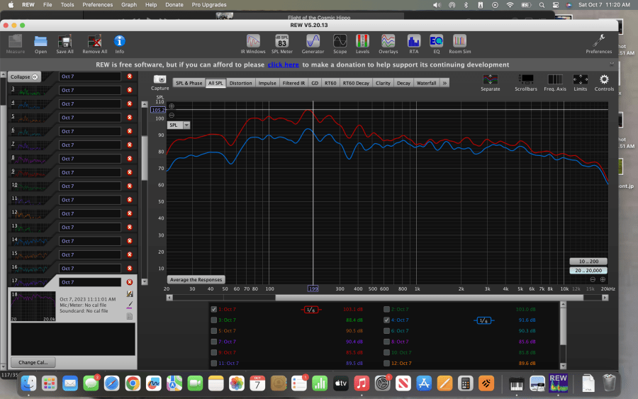

I'm not sure that you've been paying attention, so I'll try to lay it out more clearly: My system consists of the following:
Denon DP-37F turntable -> Schiit Mani 2
Oppo BDP-103 -> Schiit Bifrost 2
MacBook Pro -> Schiit Bifrost 2
Apple TV -> Schiit Bifrost 2
All sources are fed into a Schiit Freya +, -> DSP Crossover -> Tweeters, x2 Schiit Rekkr 4 W Class A mono blocks,
DSP Crossover -> Mid horns are fed into a modded Glow Audio Amp Two 15 WPC P/P EL84 amp
DSP Crossover -> Bass horns are driven by a pair of Alesis RA-150 150 watt bridged mono amps.
they are then fed into a pair of heavily modded, 105 dB sensitive LaScala clones.
despite my mods, which allow an improved frequency response from 23Hz to 20Khz, the speakers still exhibit many of the same peaks and nulls inherent in the original LaScala design. They sound better than decent, but the frequency curves show that there is considerable room for improvement. This curve in blue, shows the passive crossover, with crossover points at 400 Hz and 6000 Hz, with 12db Linkwitz Riley filters:
note the nulls at 55Hz & 350 Hz and a resonant peak at 175 Hz.
utilizing 24dB Linkwitz Riley filters and parametric eq in the Dayton Audio DSP 408, I'm able to tune the response to +/- 3dB across the frequency spectrum:
the difference is noticeable and a marked improvement over passive. It is not possible, nor is it desirable to go route analog signals to a passive crossover and keep digital signals digital, nor would I want to if I could. The flaws with the DSP-408, notably single-ended inputs and a nominal amount of treble hiss are negligible and something that I can live with, however, for me, the gist of the hobby is building a better mousetrap, gradually improving the system, learning the why's and how's along the way, until a nebulously defined endgame has been reached. To that end, the most obvious point of improvement is in the DSP crossover, followed by the amps driving the tweeters, phono pre and perhaps the amps driving the woofers, in that order, affecting what are likely single digit percentages of improvement.
To reach that hair-splitting level of improvement, I would like balanced connections, better sample rates and 8-10 bands of parametric eq per channel and above all, no added noise.

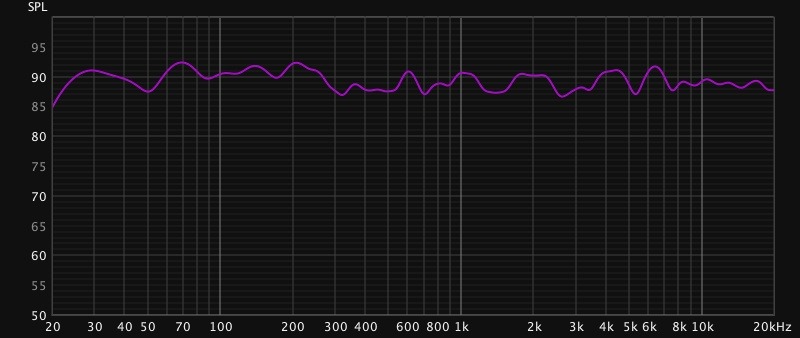

Fast forward to 2011--when I took the time to fiddle with REW, a small "mixer", and a measurement microphone: an ECM8000, which required phantom power and microphone calibration, which I didn't have at the time. It was a disaster--since I was using the sound card in the laptop in the measurement loop. Nothing worked right. I dropped the effort and just used Roy's settings. By then, I had added DIY Cloned SPUD tapped horn subwoofers behind the Jubs (fc 14.5 Hz). Integration of the subs with the Jubs was by ear and a guess. I acquired a First Watt F3 for the TADs, then I punted--I didn't have the time or energy, holding down a full-time job and an adjunct teaching position (developing all my own curricula from scratch because there were no books on the subject). Time was at a premium.
Fast forward again to 2014: I was "retired" (i.e., looking for the next thing to do but not having to work for a living). I started in earnest working with REW daily and developing a feel and a familiarity for it-experimenting to find the limits of what it and the Dx38 could do. I started to develop my own settings for the Dx38 crossover--and things were a LOT better. I was learning now at about triple or quadruple the pace as before. Things were better, but not really good (sound quality-wise).
I started demastering my music using Audacity in 2015, to fix the sound quality of really dear recordings--that sounded really bad. Whole cloth stuff, again. I met with success and failure--in largely equal doses. (I still demaster all my CDs that come in--as required.) I experimented with MEHs, and developed the K-402-MEH, which exceeded my wildest expectations (and still does, even today). Then I got a Xilica XP crossover and a USB microphone (self calibrated) about two years later. Now sound reproduction started to take on a life of its own. Learning gobs weekly, sharing what I could online (some people on forums don't like to see others learning and advancing in their hi-fi experiences, I think).
And then April of 2019 came around: I discovered the effects of phase flattening (the link I post just above). I was floored. Not only did I have to completely redo all of DSP settings for the entire setup, but I also had to redo all of my demastered music files on external hard drive (about 20,000 tracks) because the phase-flattening discovery caused all of my music to sound like it had 3-6 dB more bass than it did before flattening the phase response.
_________________________________________________________________
Why the long-winded story? I listen to music now, and try to help others get their systems dialed in. Especially without them having to spend thousands of bucks (or tens of thousands, as the case may be now) to achieve relative success--their 99% solutions. So it took me only 15 years to figure out how to do it, and perhaps another few thousand bucks of gear (the software was shareware/freeware at no required cost). That's why I share what I do. I don't want others to have to learn it the hard way--like I did. Fifteen years of effort, starting and stopping, is too long.
You can see that the DSP crossover and REW/calibrated microphone was the ticket to real learning and success--and much deeper understanding. I'm still learning, but not quite at the rate I was over the past 10 years or so. It's still fun.
