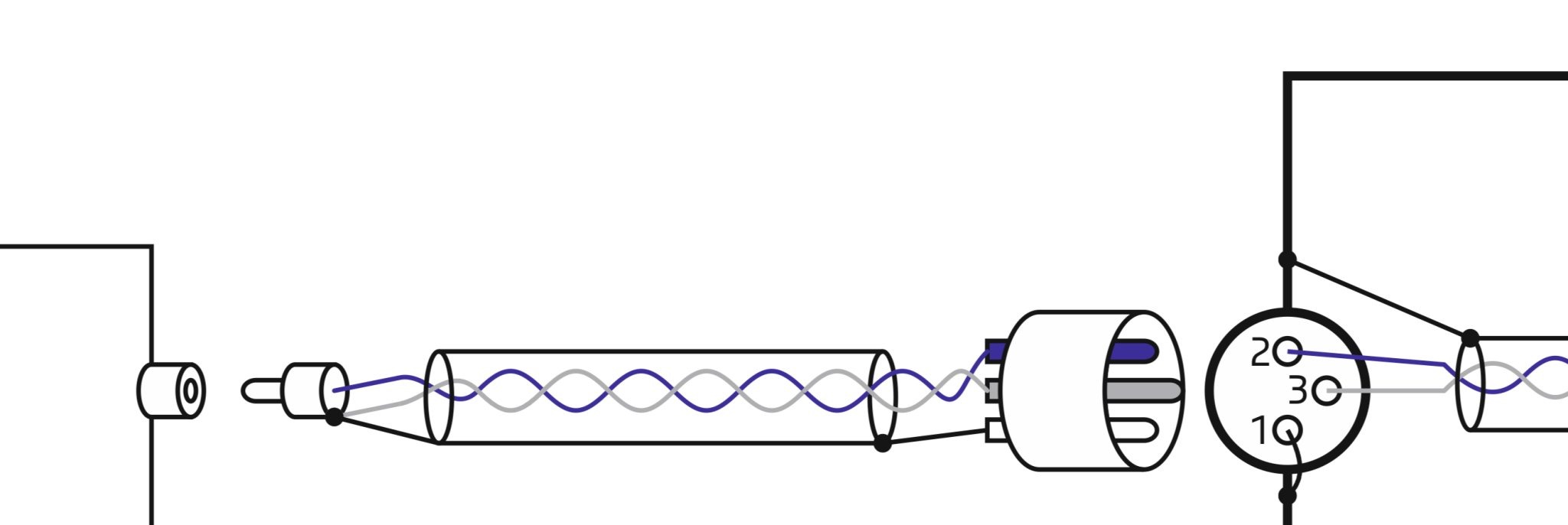

You will want to add 47 - 100R resistors in line with xlr pins 2 and 3 to reduce common mode noise.Before you buy something else, have you tried using balanced conductors?
Even though your DSP has single ended outputs, I have had to do this because all my amps require XLR inputs.
I find them quite effective at rejecting noise. I don’t have horns but my midrange is 100+ dB/2.83V.
These easiest way to do this is to buy pre-made long XLR cables, snip then in half, and attach RCA connectors of your choice to each end.
See attached wiring scheme.

so, regarding this, over the weekend, I did play with the gain string, turning down the input gain on the DSP, which helps quite a bit. There was still a nominal amount of hiss, but it was barely noticeable.I've found gain staging to be the culprit behind hiss or hum, far more often than ADC or DAC quality.

That won't do anything in that instance. The source is unbalanced to begin with, and adding a small resistor to each leg of the destination will just increase the already high input resistance by a negligible factor.You will want to add 47 - 100R resistors in line with xlr pins 2 and 3 to reduce common mode noise.
No performance improvement at all.
