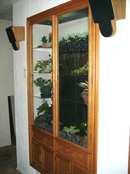

I'm working on a pair of Maelstrom subs (340 L tuned to 20Hz) in a somewhat boring Sono-Tube, but I'll do something to make them a little different, and try to post some pictures soon. Also thinking about buying a couple of Ultra-Drive DCX2496 speaker management systems to take the place of my Marchand Active crossover and help integrate the subs into this room which is quite small (14’X14.5’).
Pic of Rear speakers and home made waterfall.
Sorry I don't have any construction pictures of these TL 2-ways, I do have many more pictures of the finished product but they are all too large to post.
Glad to see Andy chime in here, I was just thinking how much MCH's beautiful speakers look a lot like some of Andy's work, was there some influence here?

I think you missed the overall gist of my post. I executed a vision. Am very pleased with the visual and sonic outcome. Are they for everyone, of course not. Danny (GR Research) feels he has improved the design to his liking, that's his choice and ears.
If my build has inspired anyone else, great. In the spirit of diy I've just shown here is another possibility for a speaker look. That's it.
