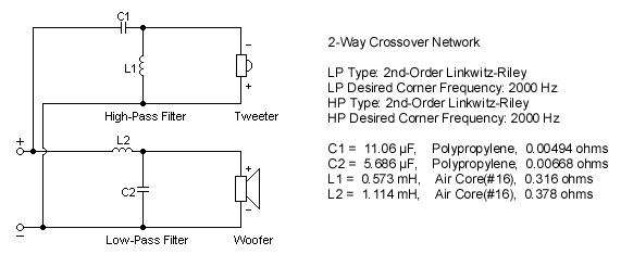

Yes, I only looked at it for a minute or two but it seems straightforward. The upper coil is in series with the woofer. The tweeter has a second order arrangement (capacitor and coil) followed by two resistors (the pot branches two ways). The tweeter is connected with reverse polarity.

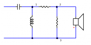

Your crossover circuit is as in the first attachment, but without C2 in parallel with the woofer. (Ignore the component values shown.)

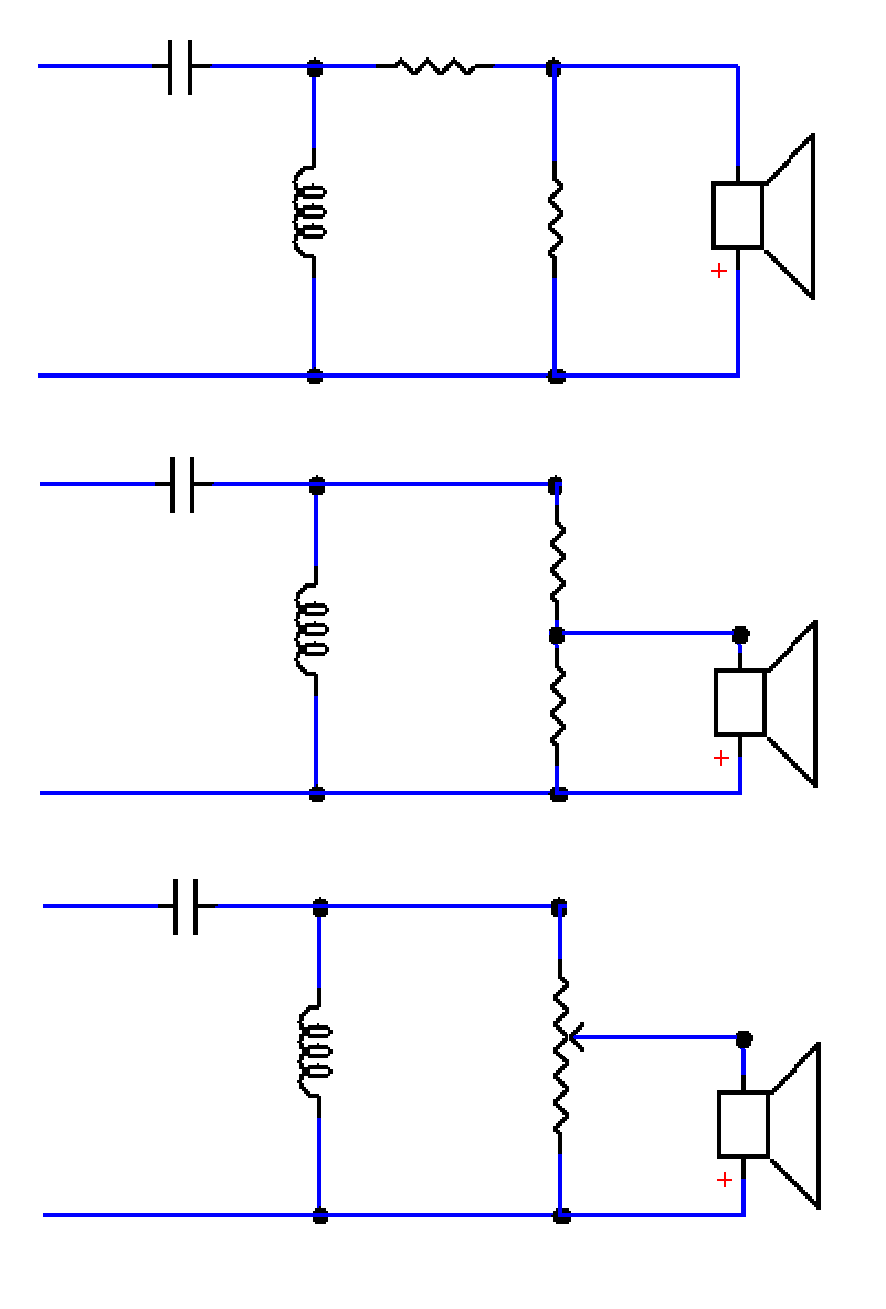

How to add an L pad to the tweeter is shown in the second attachment.

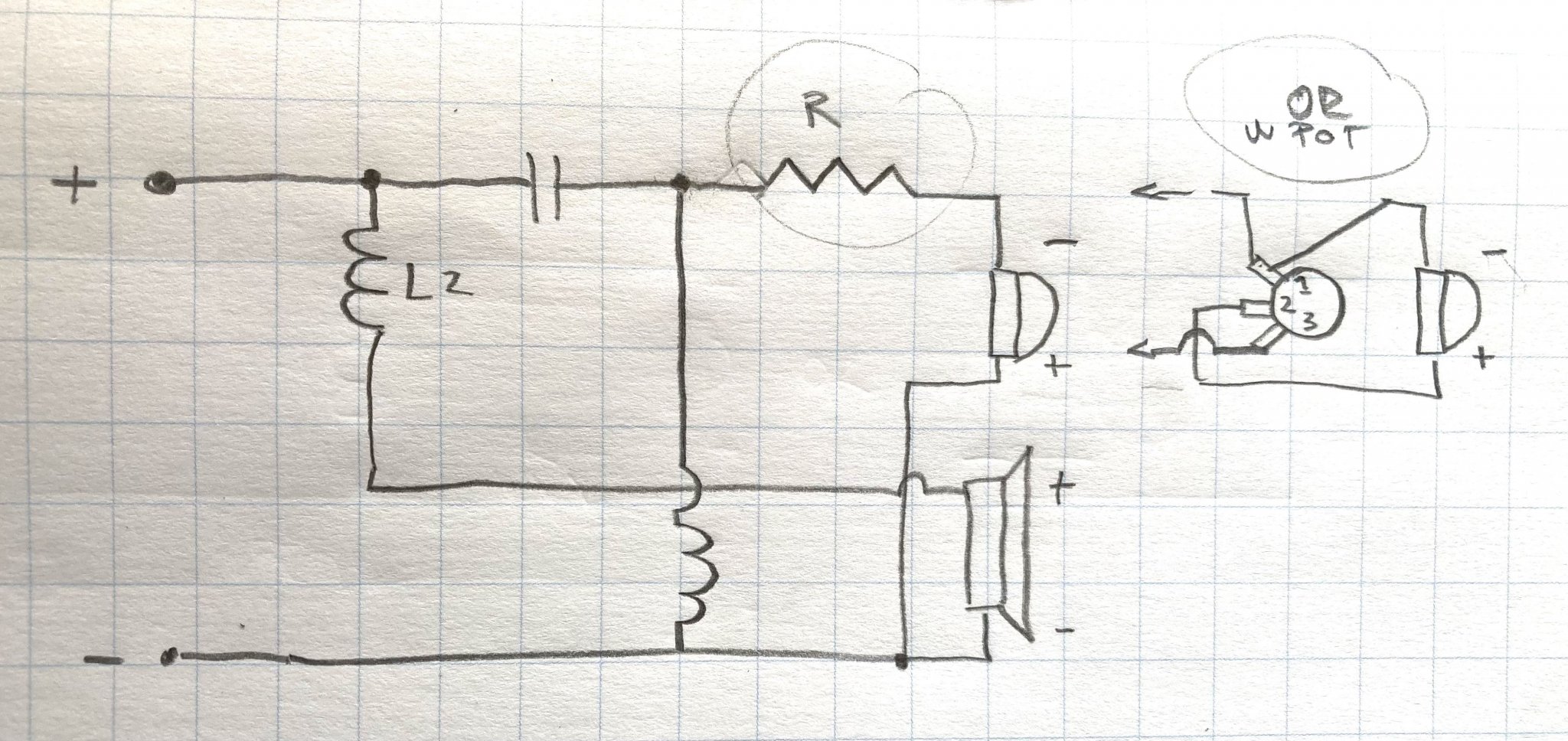

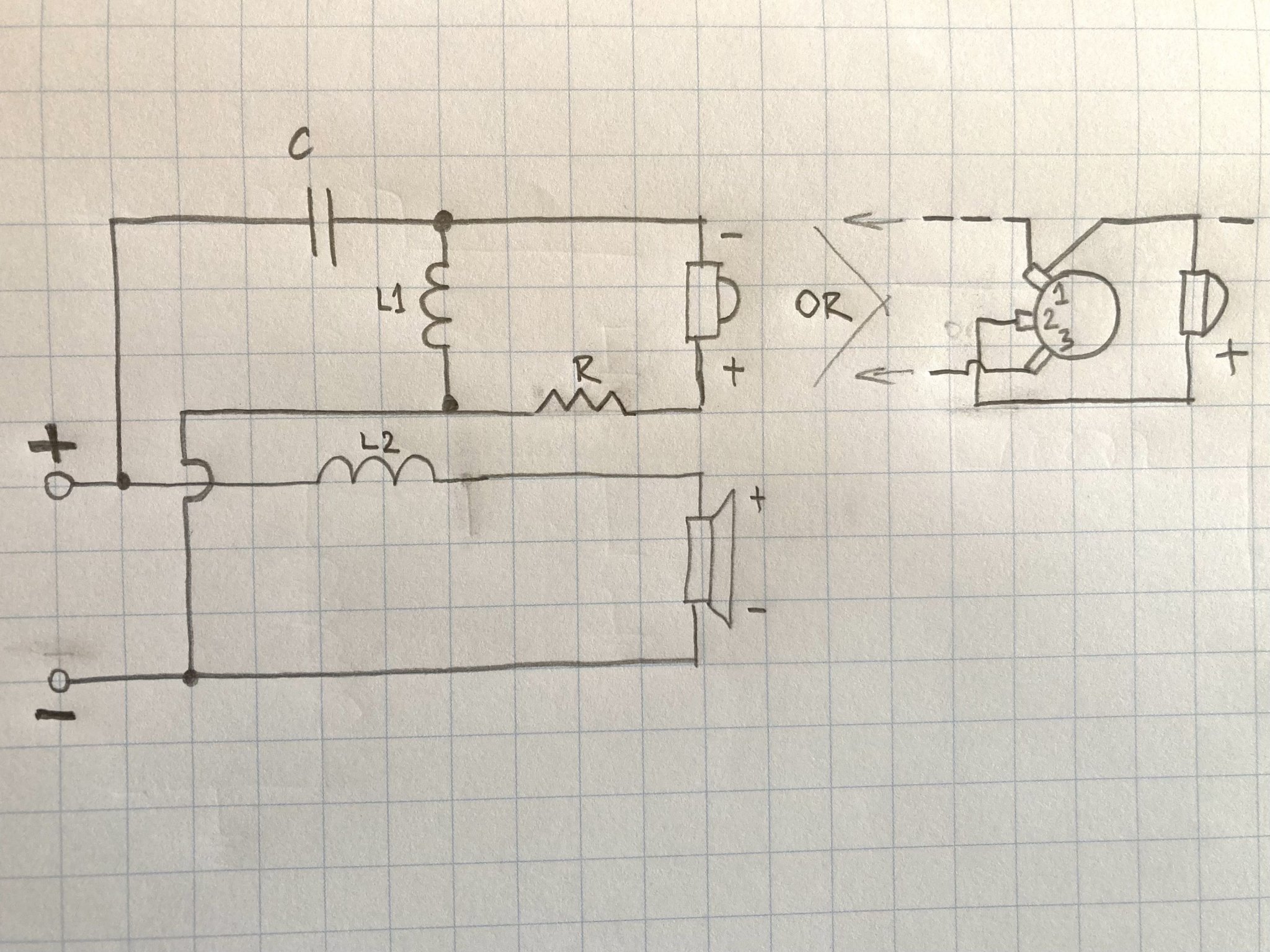

Thank you for your replies! I'll report back re. the coils. For now, I'll start with the capacitors and the L-pad. Doesn't the pod influence the signal? My plan is to find a setting on the potentiometer I like most, measure its resistance at that setting with a multimeter, and find a resistor that equals that value with a 10 Watt rating. The green wire wound resistors like Lynk should be a step up over the potentiometer. (25ohm was just my guess at the Pot is 50 Ohm). I'm attaching my version of the schematic based on what you Galu sent. Does that make sense / is this the way to wire the resistor if I would want to replace the Pot with one? *and if you say replace the pot with the pot / why 8-16 Ohm as opposed to 50?
Your first schematic in post #46 is correct.
However, if you want to dispense with the 50 ohm pot, and want the tweeter at maximum level, you could omit R entirely.
If the tweeter is too loud you can include R, but it need only have a low value e.g. 2 or 3 ohms - exact value to be decided by listening.
R would actually be better placed to the left of C where it won't affect the crossover frequency.

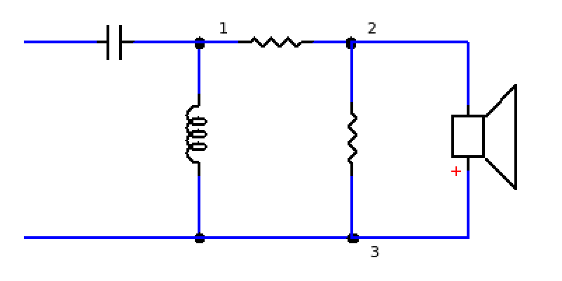

The schematic in post #46 does not appear to be correct if I'm not mistaken. The tweeter should connect to 2 and 3, not 1 and 2.Your first schematic in post #46 is correct.
I am referring to the basic schematic on the left, which is correct.
I am disregarding the 50 ohm pot as the OP wants rid of it!

It is certainly an option for Zeitler, if explained clearly to him, perhaps by relating to the physical layout in the photo of his crossover.

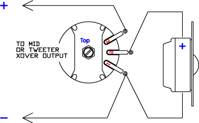

Referring to the attached photo, you would first disconnect the wires going to the pot, noting carefully to which terminals they went.
Then measure the resistance between the centre terminal of the pot and its upper terminal to find the appropriate value of the upper fixed resistor to put across the connecting wires instead of the pot - then measure the resistance between the centre terminal and the lower terminal to establish the value of the lower resistor to put across the connecting wires instead of the pot.
