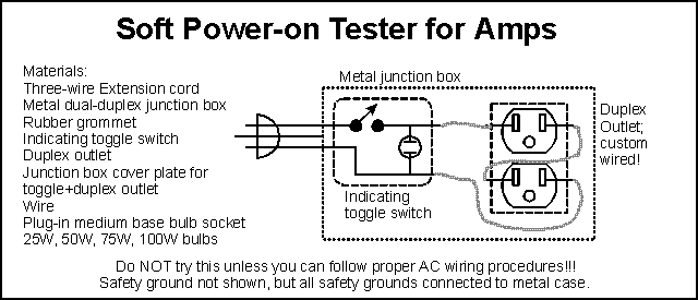

The bulb tester is pretty easy. I just used this picture as a guide. I bought a bulb socket holder thingy from home depot and cut open a power cord and wired it up. A power cord has the three wires in it so when you cut it open wire the live wire into the bulb then out. I can take a photo of it later and post it to show how easy it is.
It saved me once from frying my amp and I've used it multiple times since.

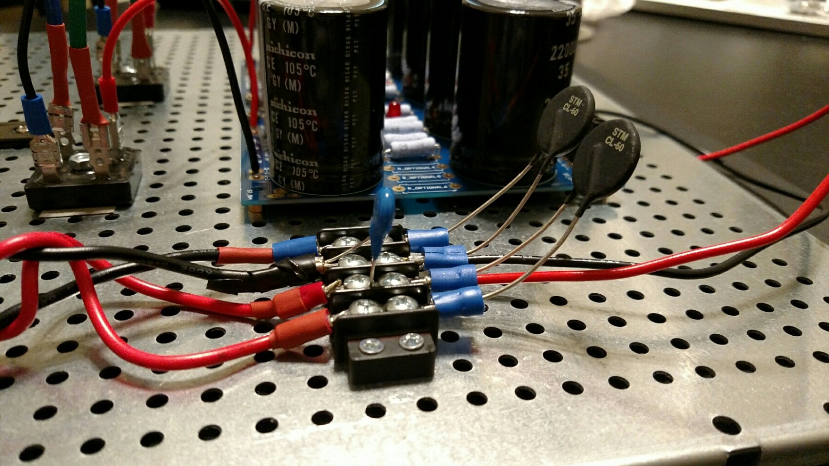

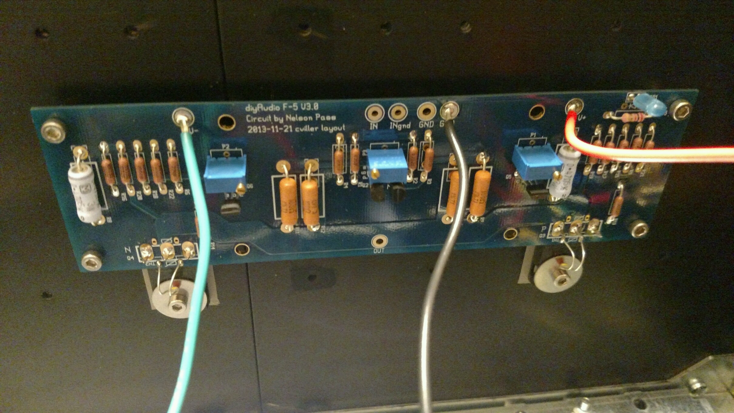

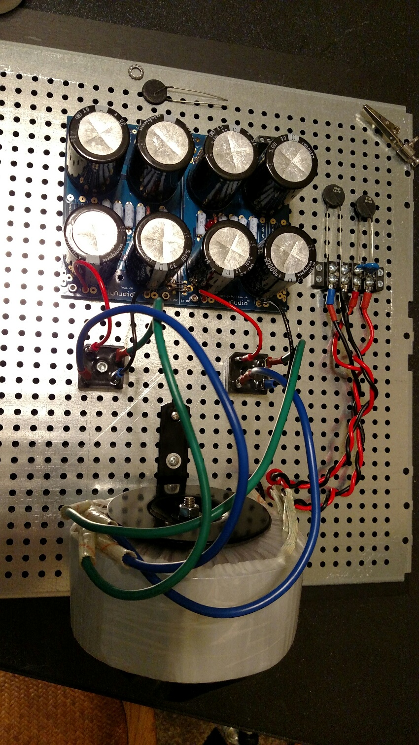

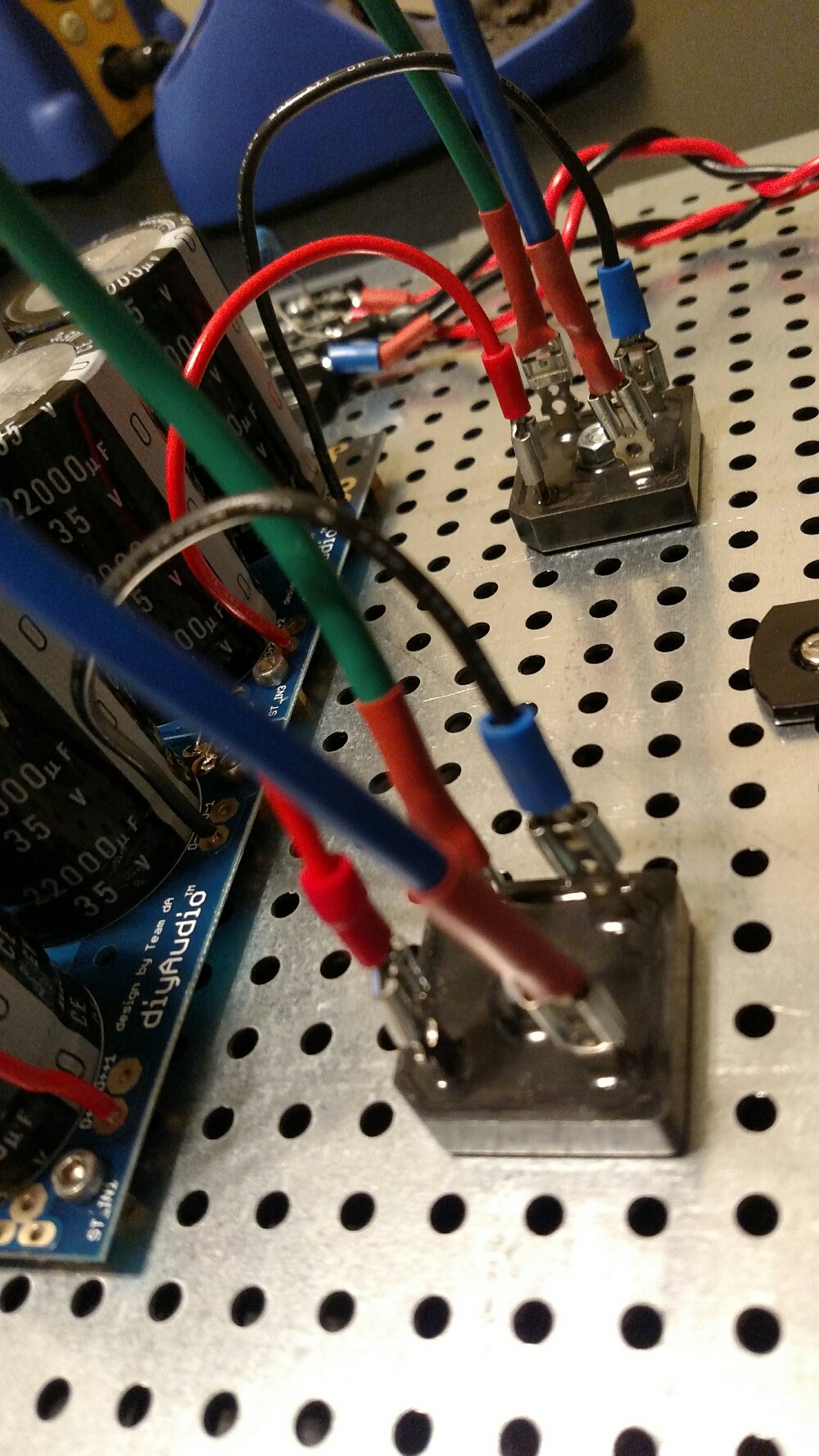

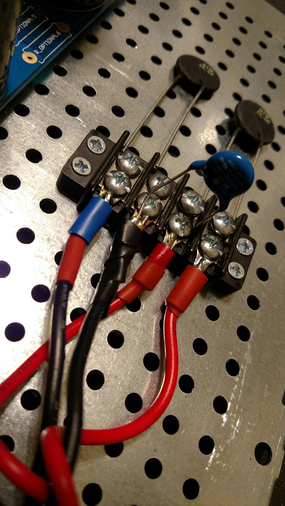

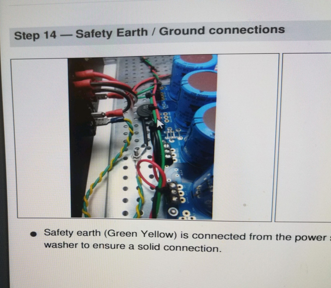

Not entirely sure about the wiring to the vishay blocks but it seems to emulate the F5 build thread although different wire colors.
Not sure what to do with the purple wire- maybe chassis ground?
1/2 way on the terminal block ...
The terminal connects in the last photo on the PCB near the star ground - what connections do these accept - perhaps the bullet connects I have in an assorted Box?
Thanks again for the info on the bulb tester. I guess I have time to explore these possible routes:)

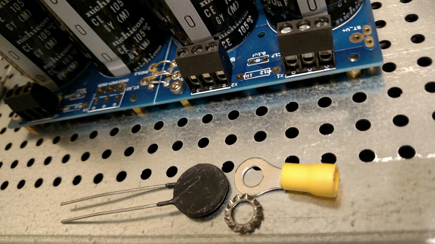

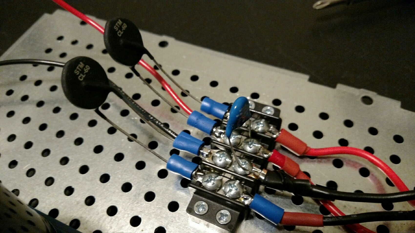

That was some unfinished work, sorry :eek:
How would you apply insulation after things are soldered?
If you mean to thermistor legs, easy. Unscrew the orings loose, slide over oring end, apply heat and reattach. Use the smallest heatshrink that will fit over o ring. You can cheat a little by temporarily expanding the heatsshrink by inserting needle nose pliers in and stretching a bit.
Or, use electrical tape. Better yet, since you left plenty of length on legs, cut off oring and re do them.

I'm using silicone isolation for NTC legs ; if you don't have any , go to local store , buy some 1.5 to 2.5sqmm wire with silicone isolation , and take what you need .....
PL is usually mounting them with bare legs , but they're on pcb and well away from anything , so even bent they can't touch anything critical

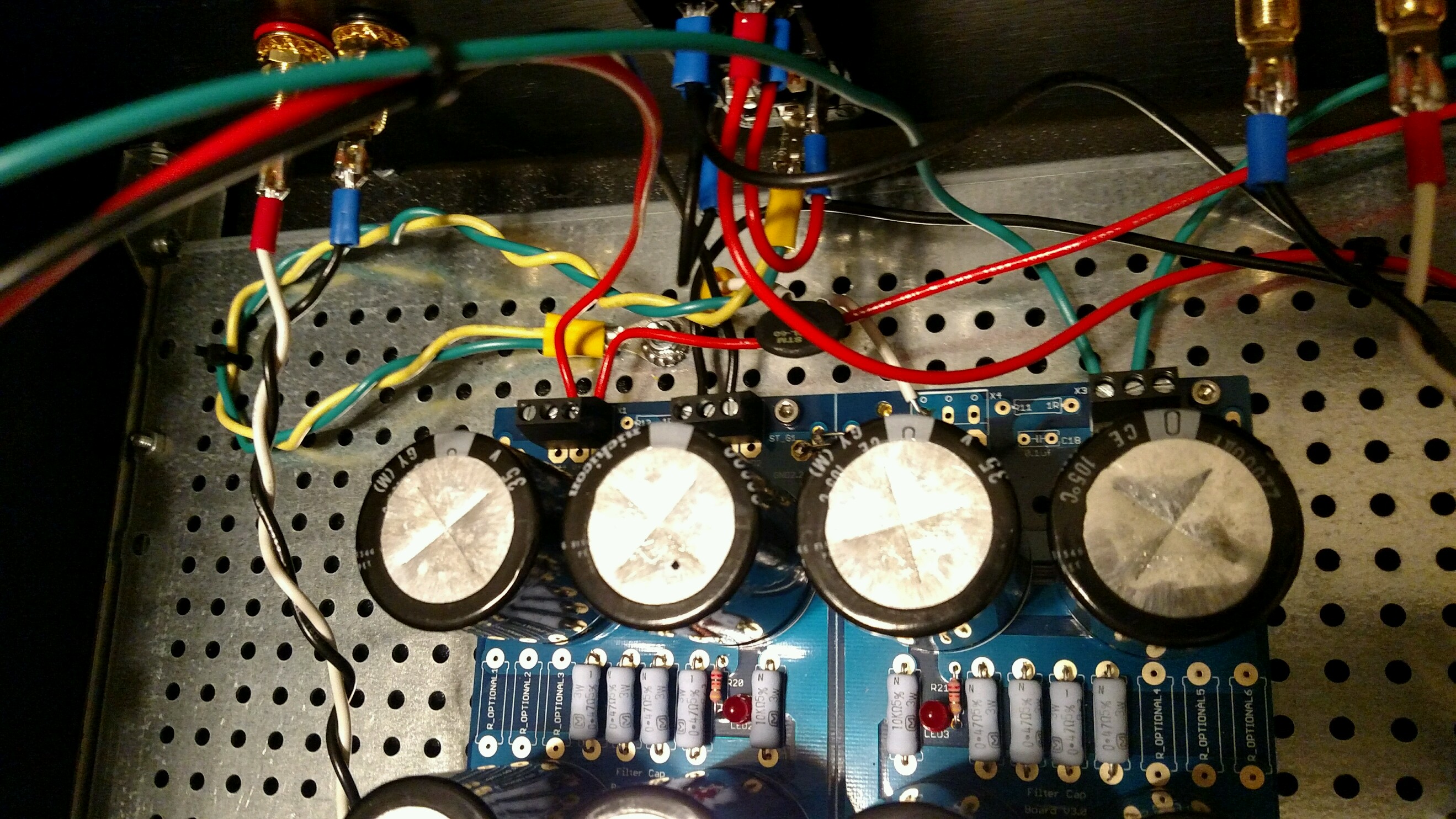

The store guide photo in f5v3 is a little busy here at the terminal blocks of the ups pcb. Can someone post a simplified diagram for dummies please?

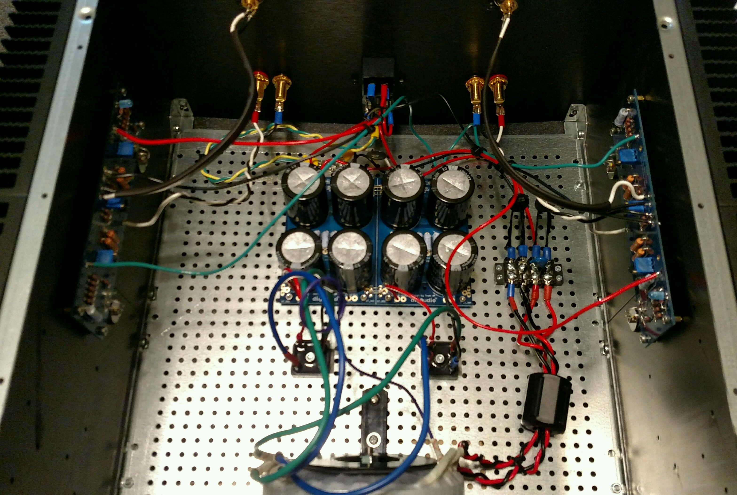

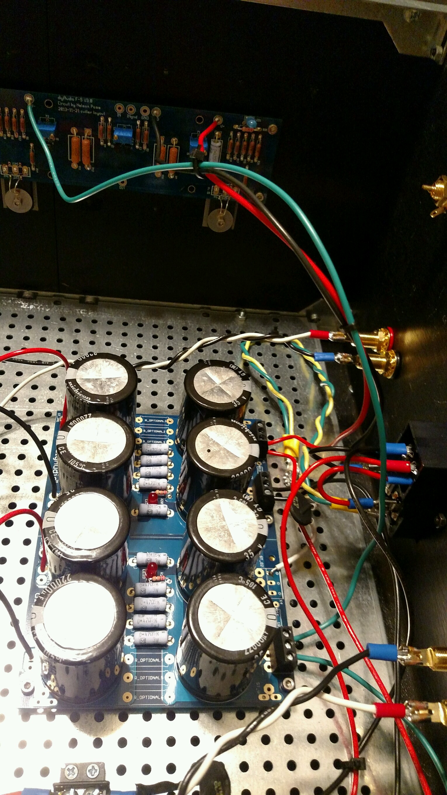

Now for the hardest part: firing it up. All 4 pots were zeroed on the multimeter. With W502 facing me right side up, it was full clockwise.
Where can I find power up and bias directions for a newbie using a cheap variac.

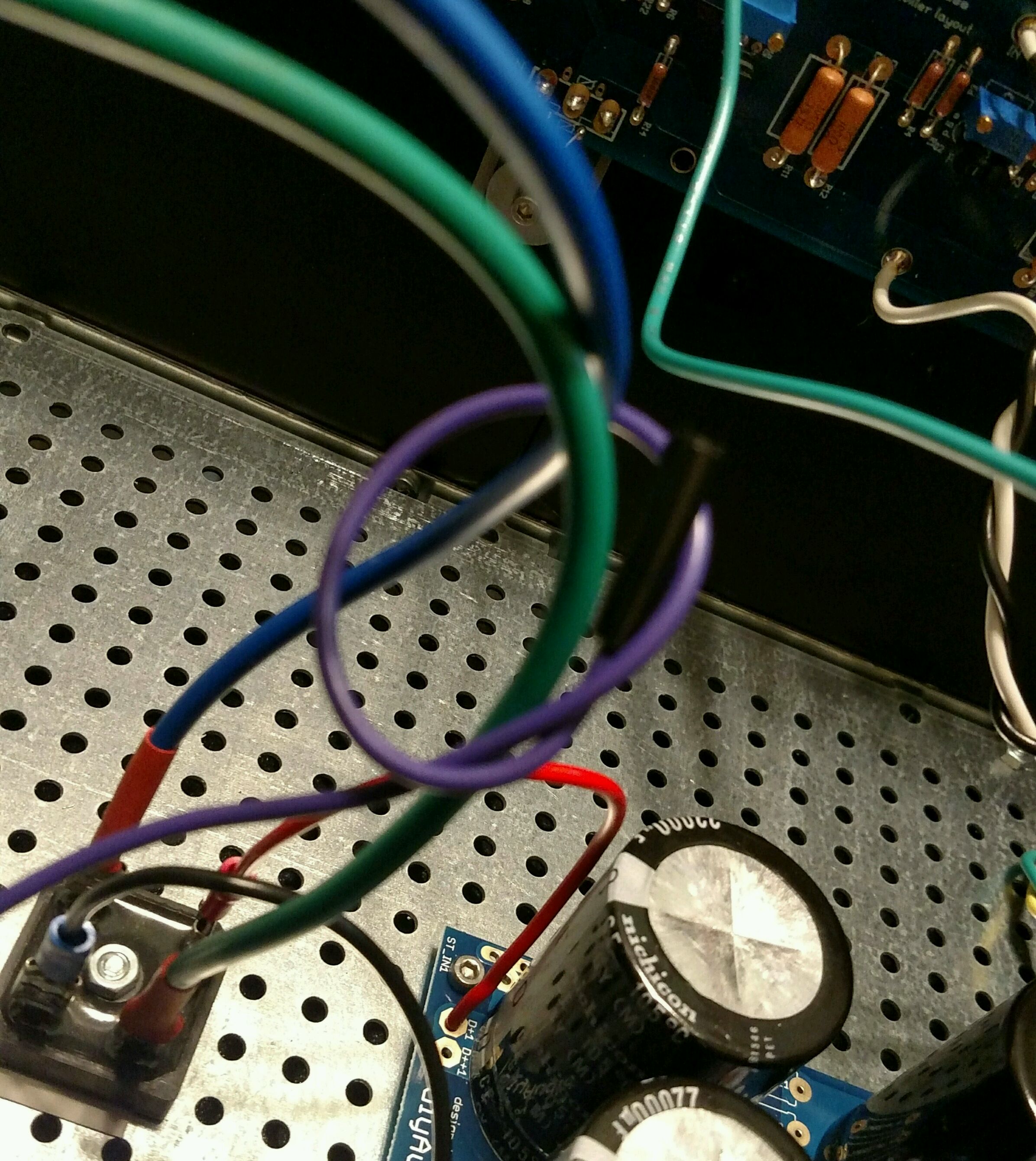

What should be done with this purple wire?

Purple wire to chassis ground.
Use a bulb tester, not a variac. The bulb tester will save you from almost all faults automatically, where the variac needs a much deeper understanding of what’s going on and what to look for and how.
