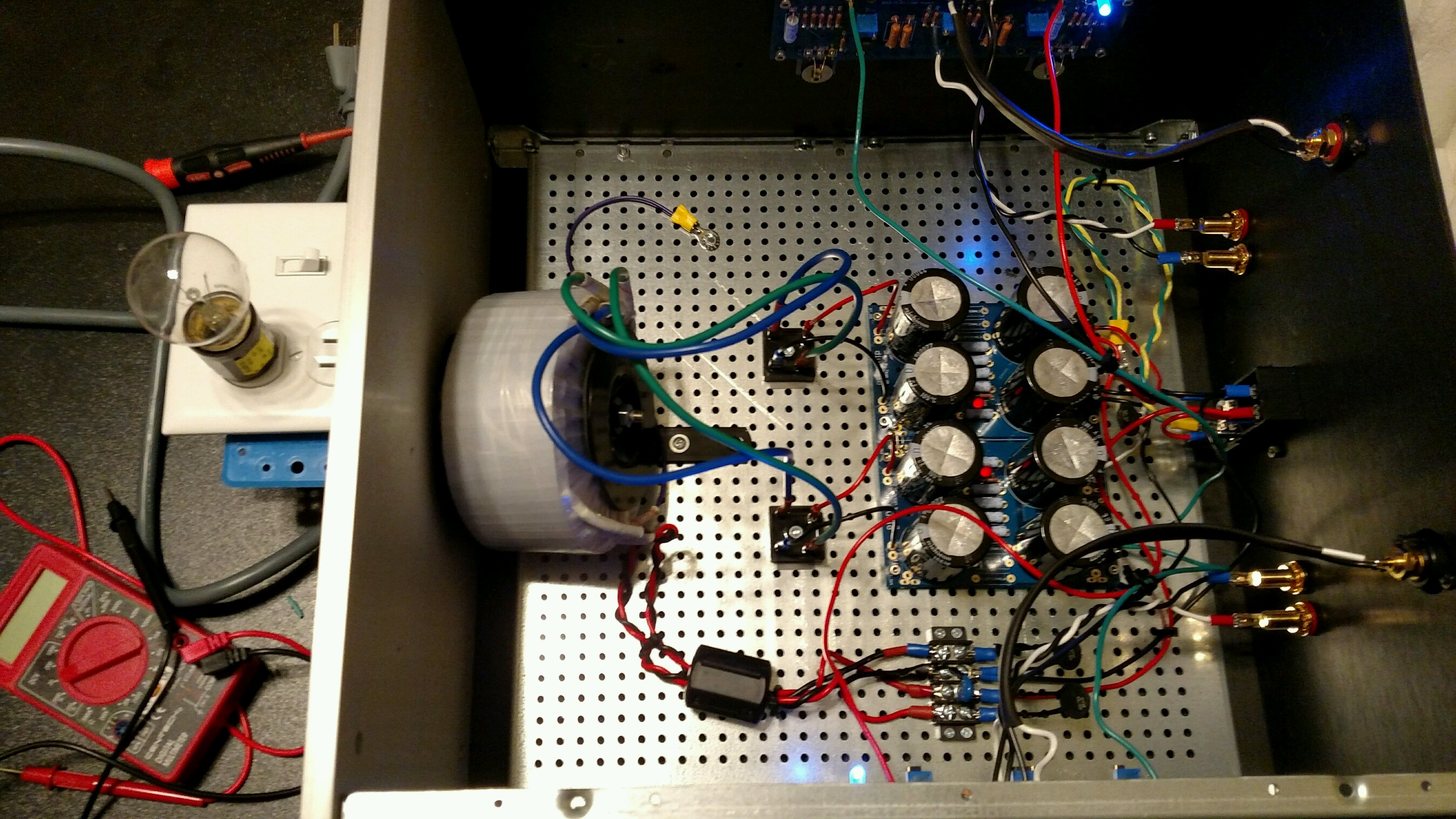

Purple wire to chassis ground.
Use a bulb tester, not a variac. The bulb tester will save you from almost all faults automatically, where the variac needs a much deeper understanding of what’s going on and what to look for and how.
Thanks, I will need to build one then.
So the purple wire from the transformer goes to chassis ground. Can I just pin it anywhere on the chassis? Is the main chassis ground you refer to the star washer-cl60 combo near the PSU and power cord connections?

Also, please verifying the zero-ing out of P1 and P2 by actually measuring the
resistance across R5 and R6. They should be close to zero.
Dennis
The 4 pots were zeroed; the multimeter was lowest and clicks were heard across the resistors.
Will have to work on the middle pots😮 I think the link describes 12 or 5 turns from one end of the dial?

Almost finished! All DBT's were successful. And initial bias going pretty good, about test again after warm up. 0.6 is the final bias with zero offset, if I remember correctly.
Thanks to all those who chimed in with help🙂🙂

Good point, the L bracket is pretty solid but the transformer is “soggy”, just held by a bolt that doesn’t grab the transformer with enough surface area. Could not find a good alternative solution at the time. There are rubber gasket pads on both sides of the bolt and hexnut.
ZenMod, is it the faceplate and some unexpected conducting connection to the transformer that could be a problem. The faceplate is I think aluminum and attached to the aluminum chassis floor grid , and the chassis floor is connected by ground to the purpl transformer the foil which covers the transformer.
thanks for everyone’s input. this amp sounds ******* incredible. I am floored by the sound quality and listened to it nonstop for hours yesterday. Also, there is no need for more power it is plenty loud without a turbo. It is all about the firat watt - right , and the F5 succeeds wonderfully.
@Tuberoller
if the bolt, bracket, baseplate and frontplate form a closed loop (i.e. conducting)
then you get a welding machine.
even if the loop is not tight closed (small gap) you will notice hum and rapid warming
I did it once - its no fun
cheers
A.

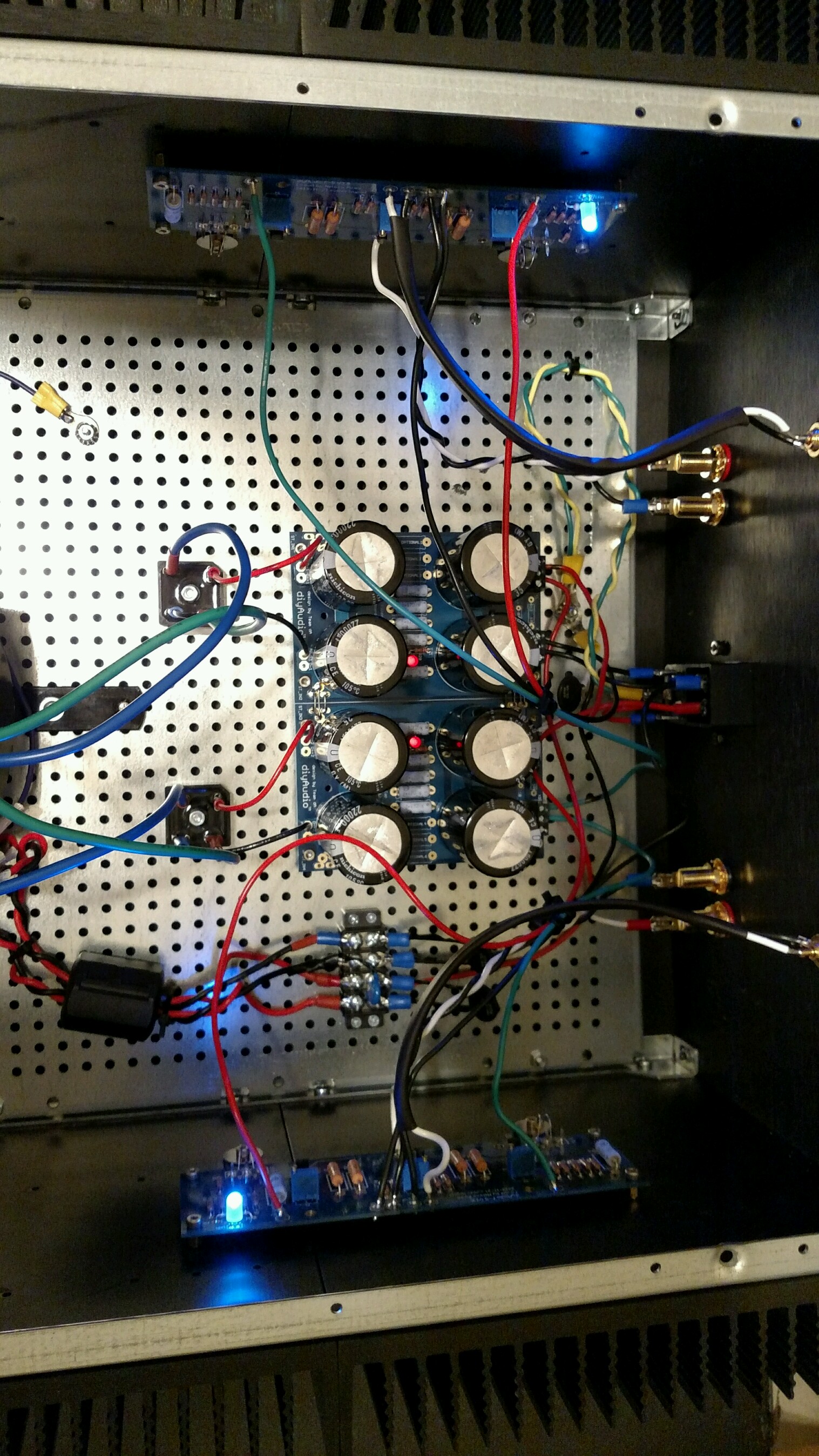

I am building the F5 right now and have mostly the same questions as anyone who isn't an electronician.
Are the LED on the PSU compulsory ? I don't see the necessity to light up the amp's inside so for the time being I haven't planned to put any.
In return I bought LED and 15K resistor for the F5 boards and will place these LED through the front plate, ACA style.
Would these be adequate ?
- for the 15K resistor N° Mouser : 71-CPF3-F-15K
- for the LED N° Mouser : 78-TLHG6405
On PSU are not necessary. They fall into the "nice to have" category, but you may omit them.
Your selected parts are perfect.

Here is where I stand with the boards
Hope you can open these pictures.
