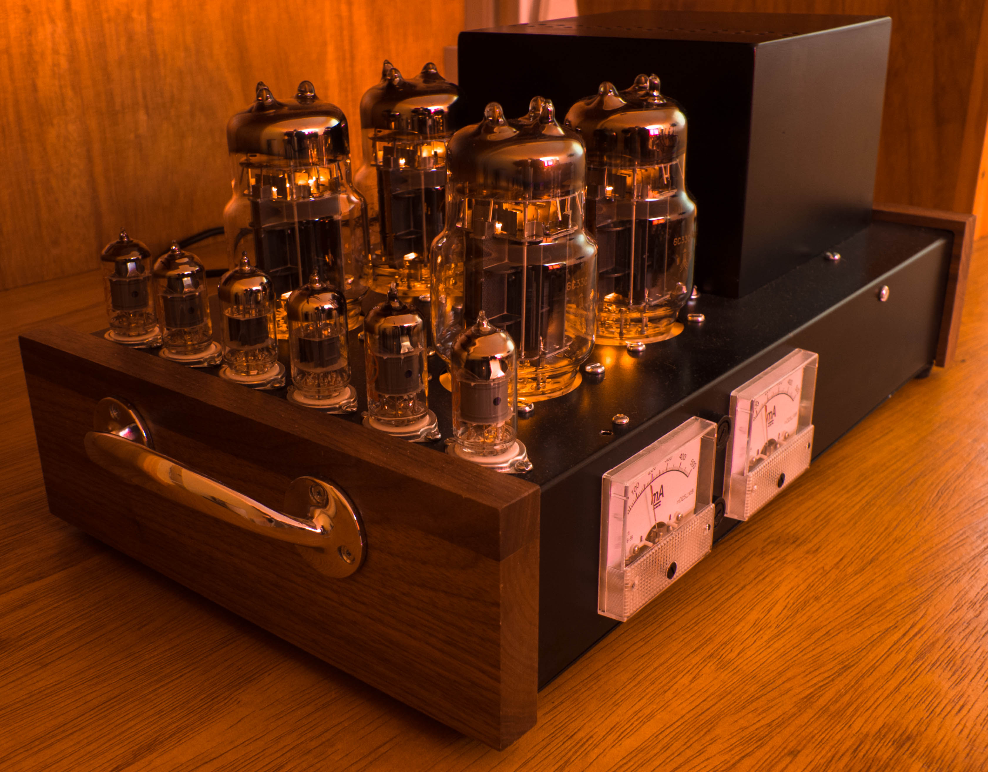

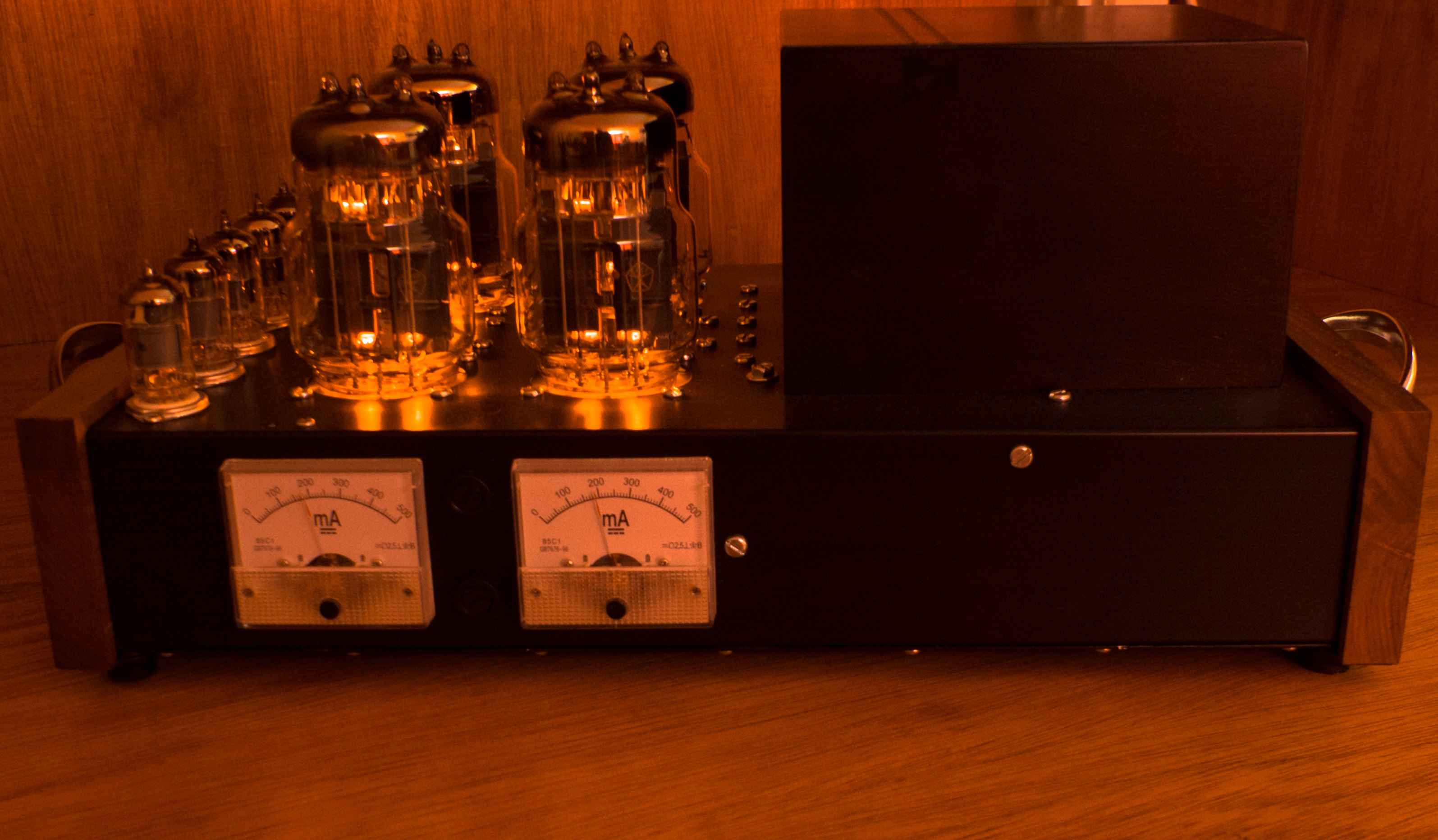

i used 2mm thick aluminum for my chassis...
the owner wants wood on the sides, i may have to argue with him over this,
not a good idea imho....
I went for rosewood for the sides with chrome handles. I also used an alum chassis.i used 2mm thick aluminum for my chassis...

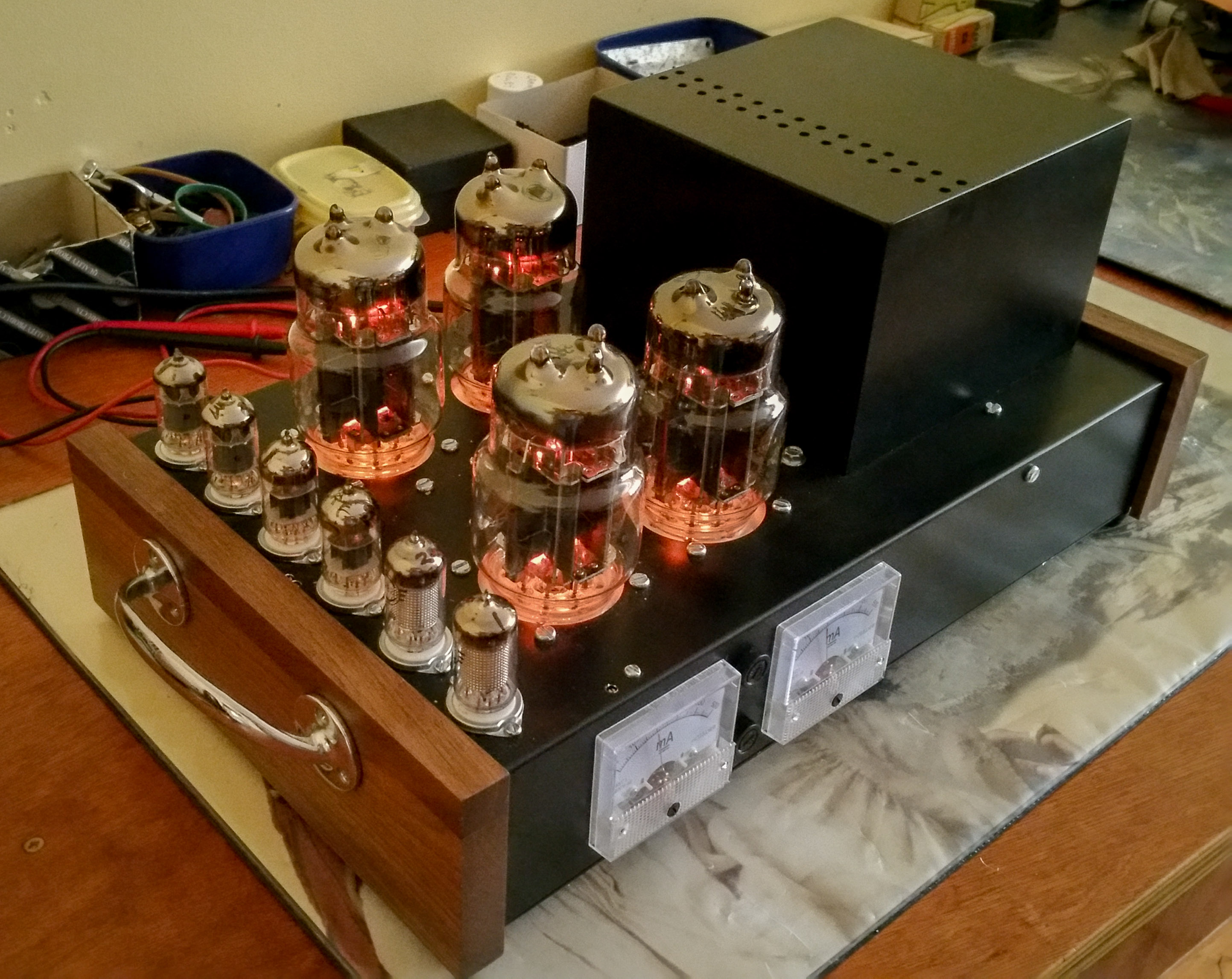

I think this shot gives a better idea of how the amp looks. Here I'm trying out some Svetlana 6J32Ps. I'm going to cook the heaters of all 18 for 24 hours before I match them into pairs. BTW, I think the rosewood side panels and chromed handles look well together.

Great looking chassis, but I see no ventilation holes. How do you keep
the internals from baking? It looks like an oven - with no ventilation.
The ventilation is through the 6 mm gaps above the tops of the tube bases. A large slow-turning fan, mounted on the inside of the bottom cover, blows lots of air up through these gaps and up the sides of the 6C33Cs. I tried it with no fan at first but as you say, the inside bakes without it, so it's essential. The fan also takes the temperature of the chassis surface down a full 20 degrees Centigrade. Thanks for the complimentary remarks about the chassis.Great looking chassis, but I see no ventilation holes. How do you keep
