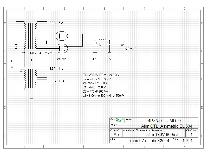

If the output supplies are fed by a common transformer, you might find it more prudent to fuse the primary rather than the secondaries. The reason is if only one of the secondary fuses blows, the amp is able to make a lot of DC.
If you have fuses for each power tube (a really good idea) then there is less need for a speaker protection fuse unless you plan to operate really low power speakers like vintage Lowthers.

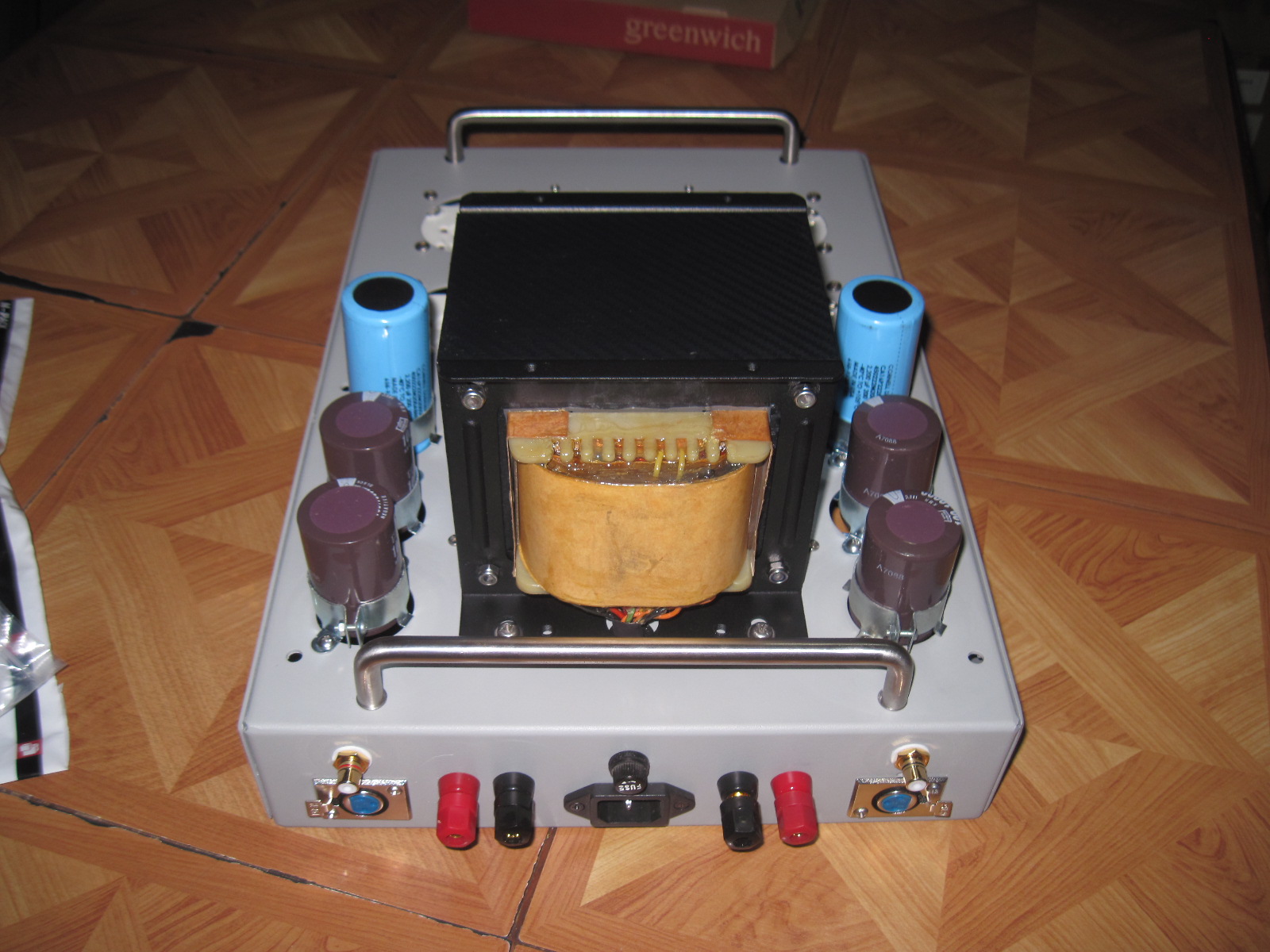

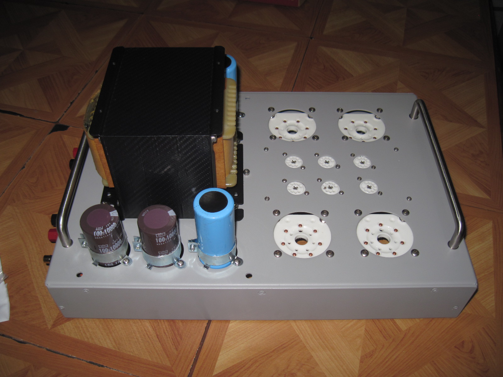

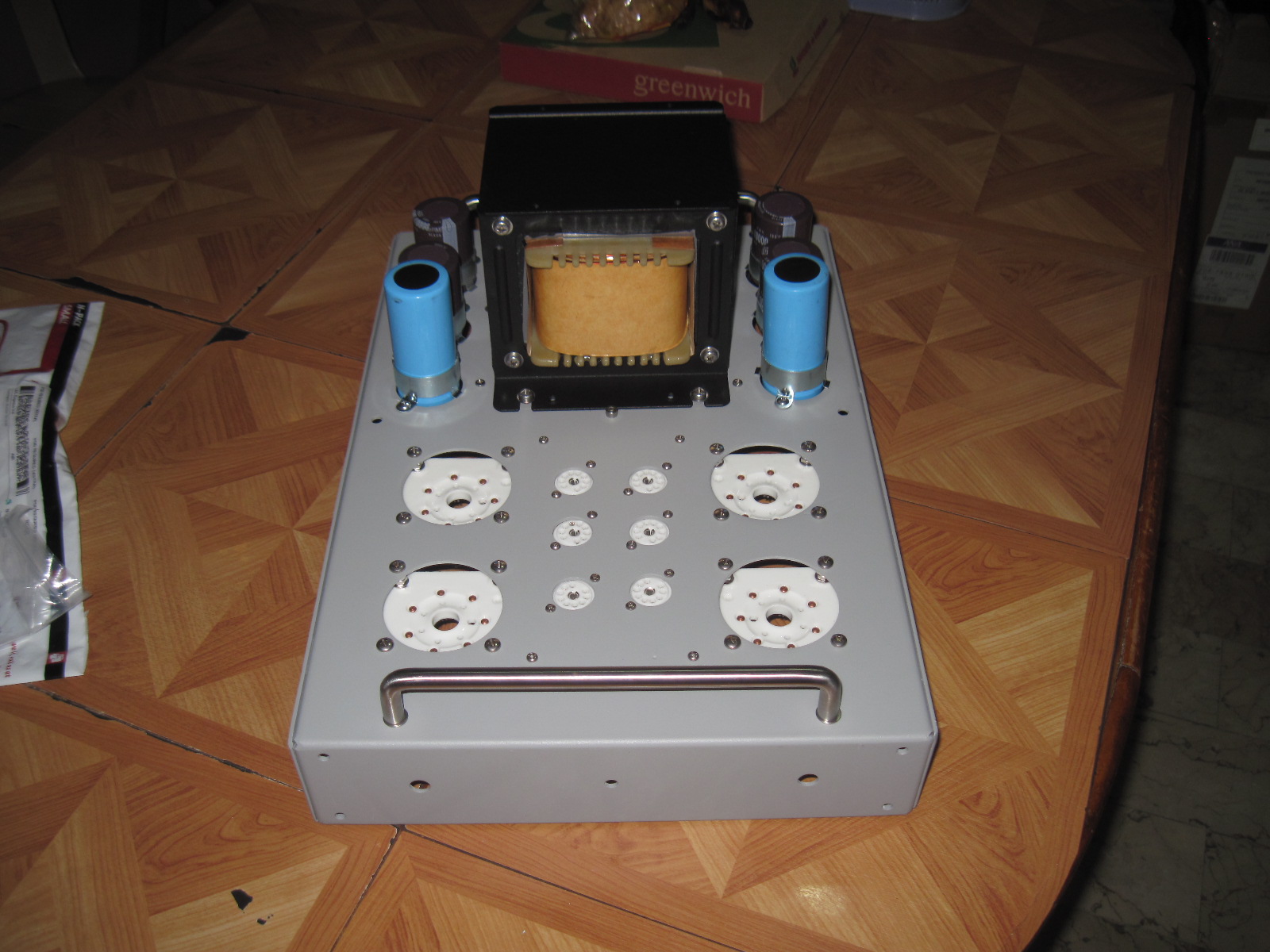

Nearing completion.
I'm coming towards the end of construction now; next week should see it finished and then the real fun starts.

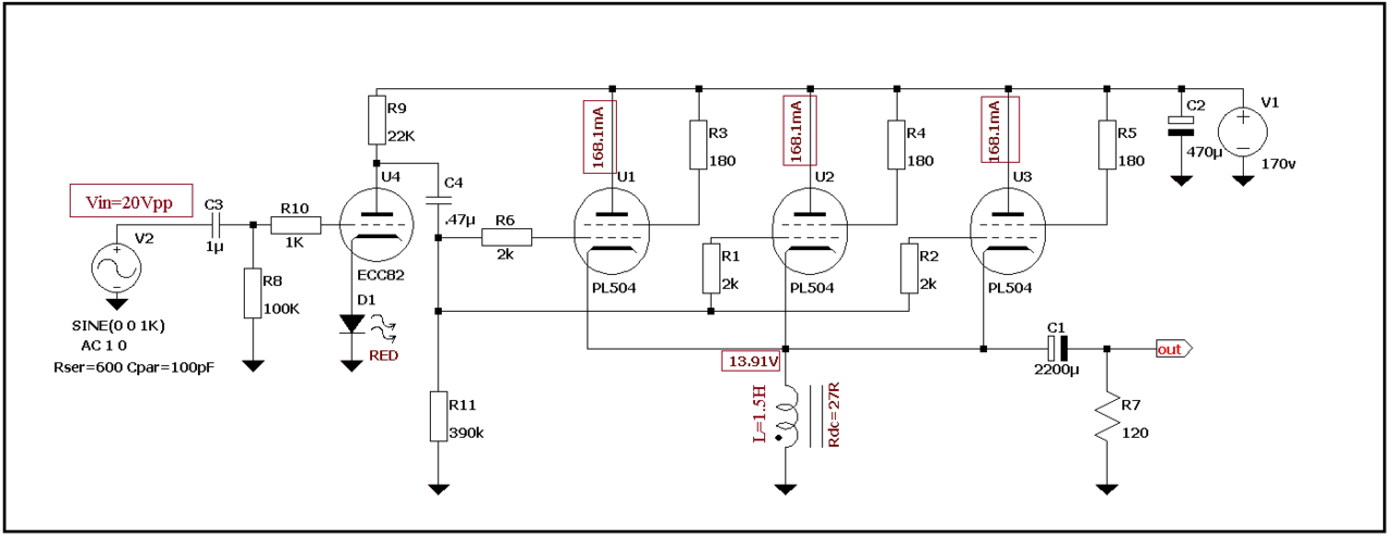

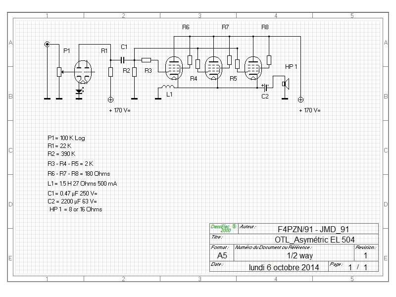

Nice concept except coupling cap which can alter the sound. The firs stage what valve it is ? how does it sound ?
Are you referring to the C2 capacitor in series with the loudspeaker, in the amplifier schematic? It is really no more, or less, in the signal path than the smoothing capacitor C2 that appears in the power supply schematic. And it is hard to avoid capacitors in the signal path in the power supply!
Chris
Chris
I know this theory and I agree. Nevertheless in practice there are limitations.

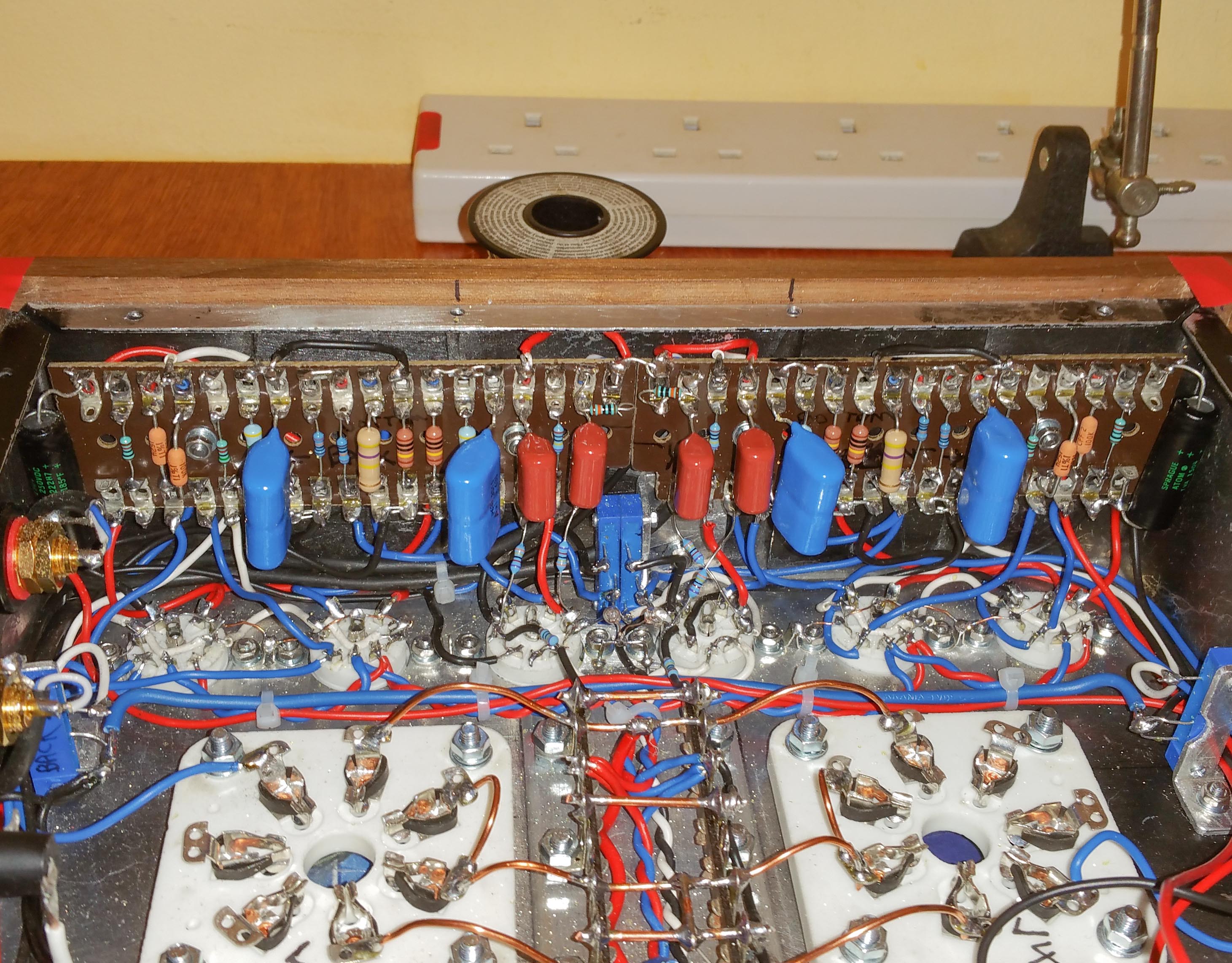

Right channel wired.
The right channel driver wiring is complete. It looks a bit untidy but I suppose that's the nature of tag-strips. RV2 L+R are accessible from the top of the chassis for adjustment.

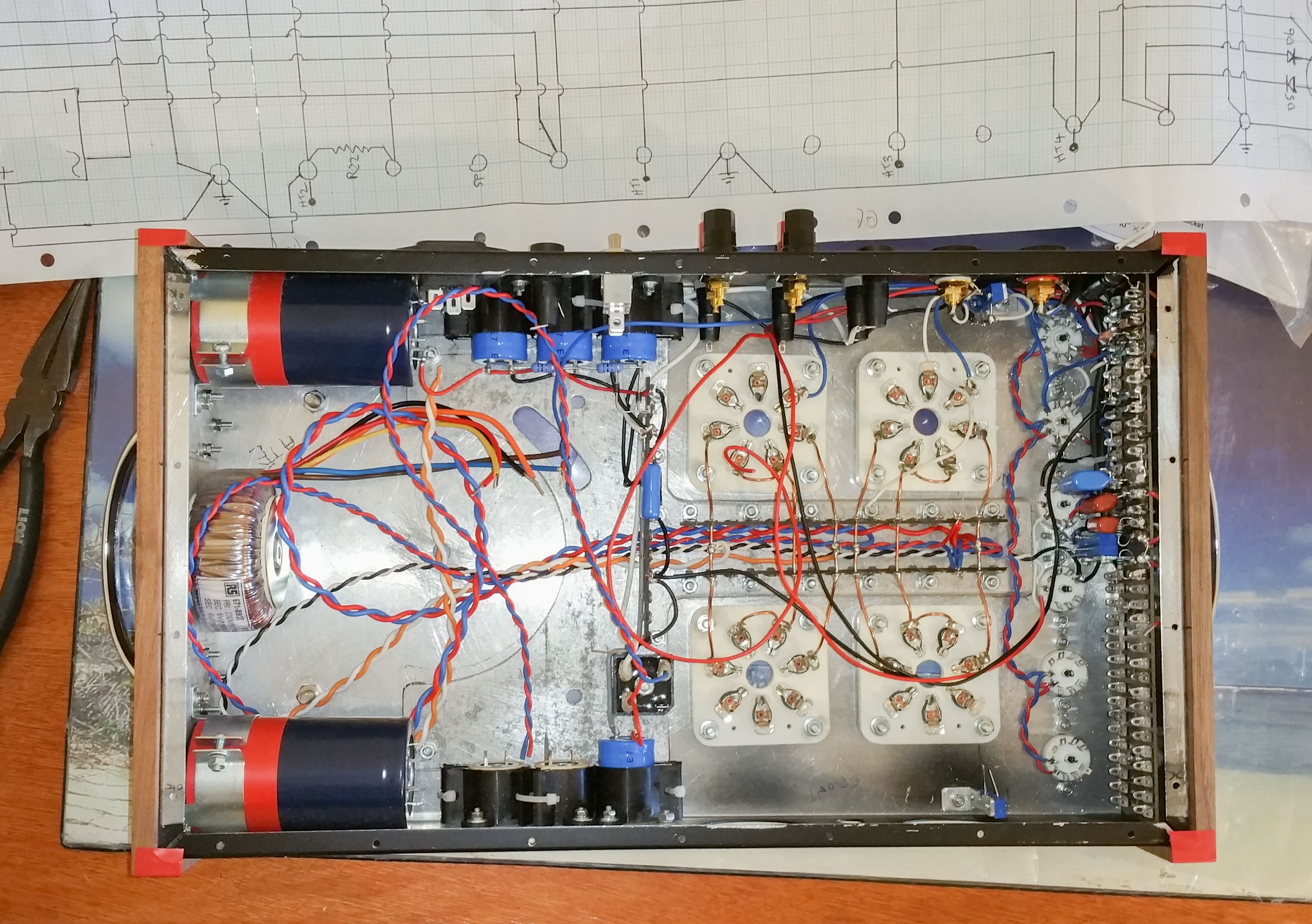

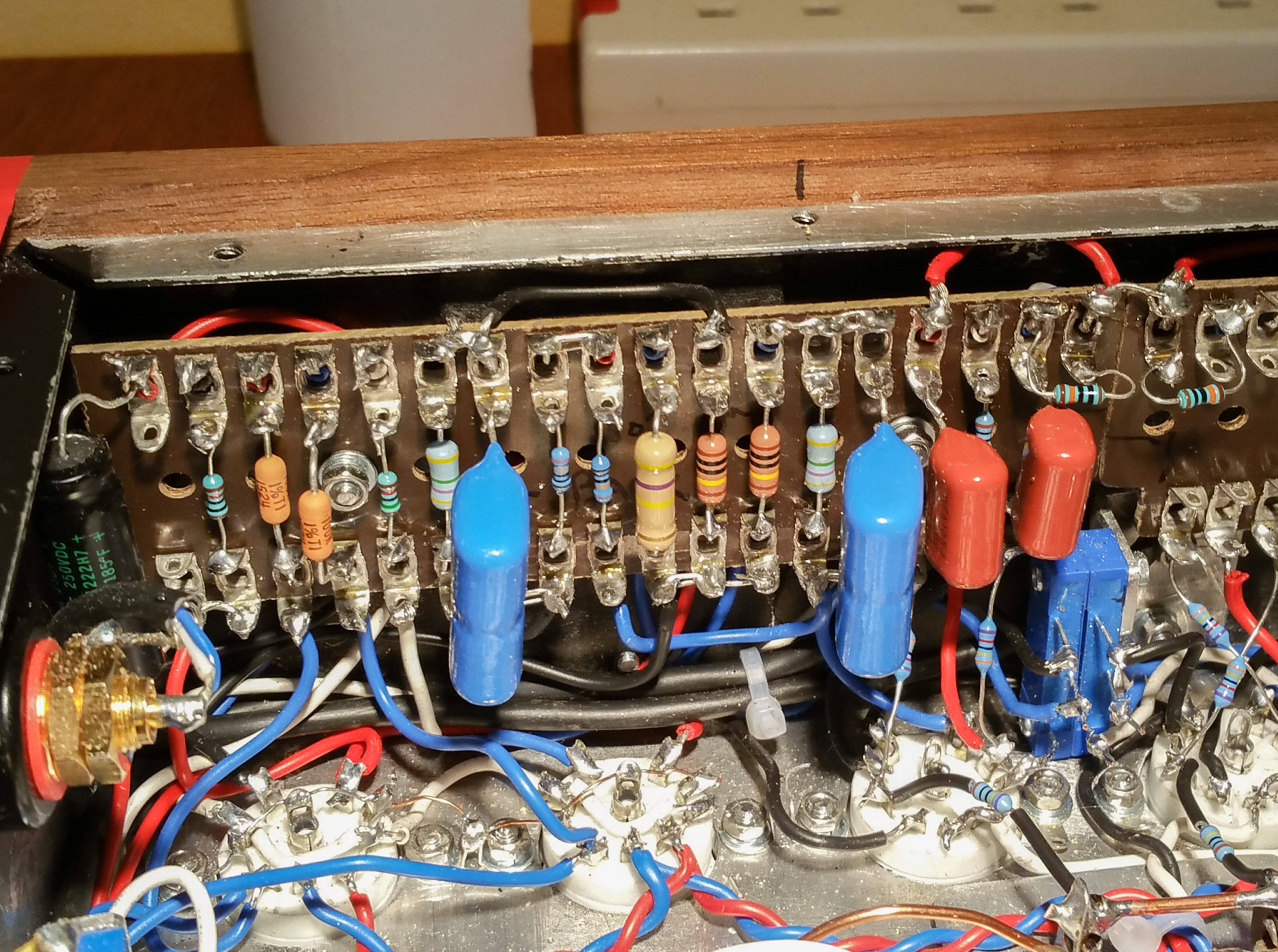

Left and Right
The left and right channel pre-amps and driver sections are wired now. There's no doubt that tag-strips are a messy business. BTW the photo was taken with my new Samsung Galaxy Note 4, with which I'm very pleased. The incredible detail is achieved by the device automatically capturing 5 or 6 different exposures and combining them into one image, all in the space of a few milliseconds.
