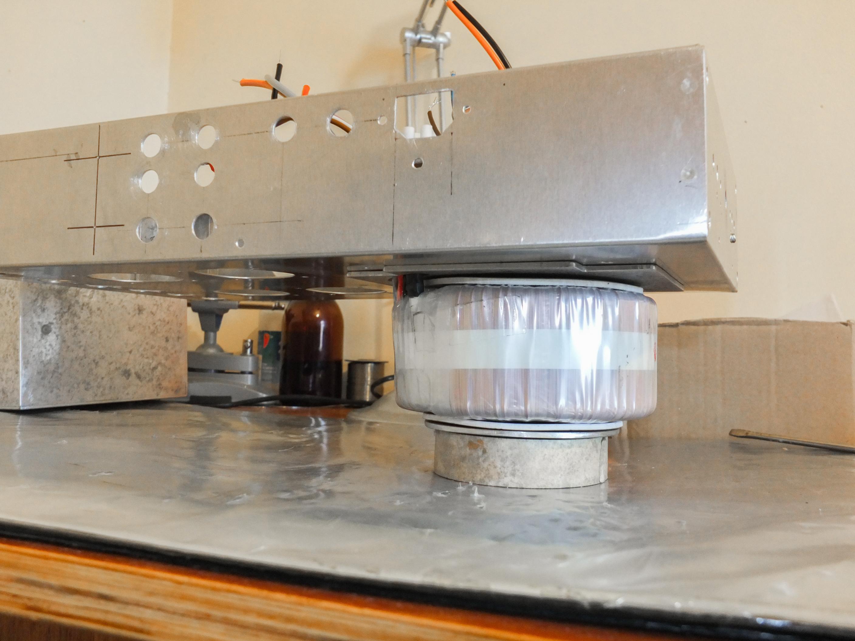

I'm mounting T2 and T3 concentrically each side of the top surface and T1 at the side of the chassis. All three transformers will be terminated on two connection blocks which sit over (under) a custom mounting plate for T2.

I'm just back from Berlin and I brought 3 "non-magnetic" bolts in my carry-on luggage. There was a small problem with security but the German police eventually OKed them for boarding. I had tested them in the bolt suppliers with a magnetic clasp on my belt and they showed no magnetism but when I used a more powerful magnet on arrival home, I found them to be about 10% as magnetic as ordinary mild steel bolts. I reckon that 10% magnetic will still fit the bill, so one of them will be used to secure the two larger concentrically mounted transformers.

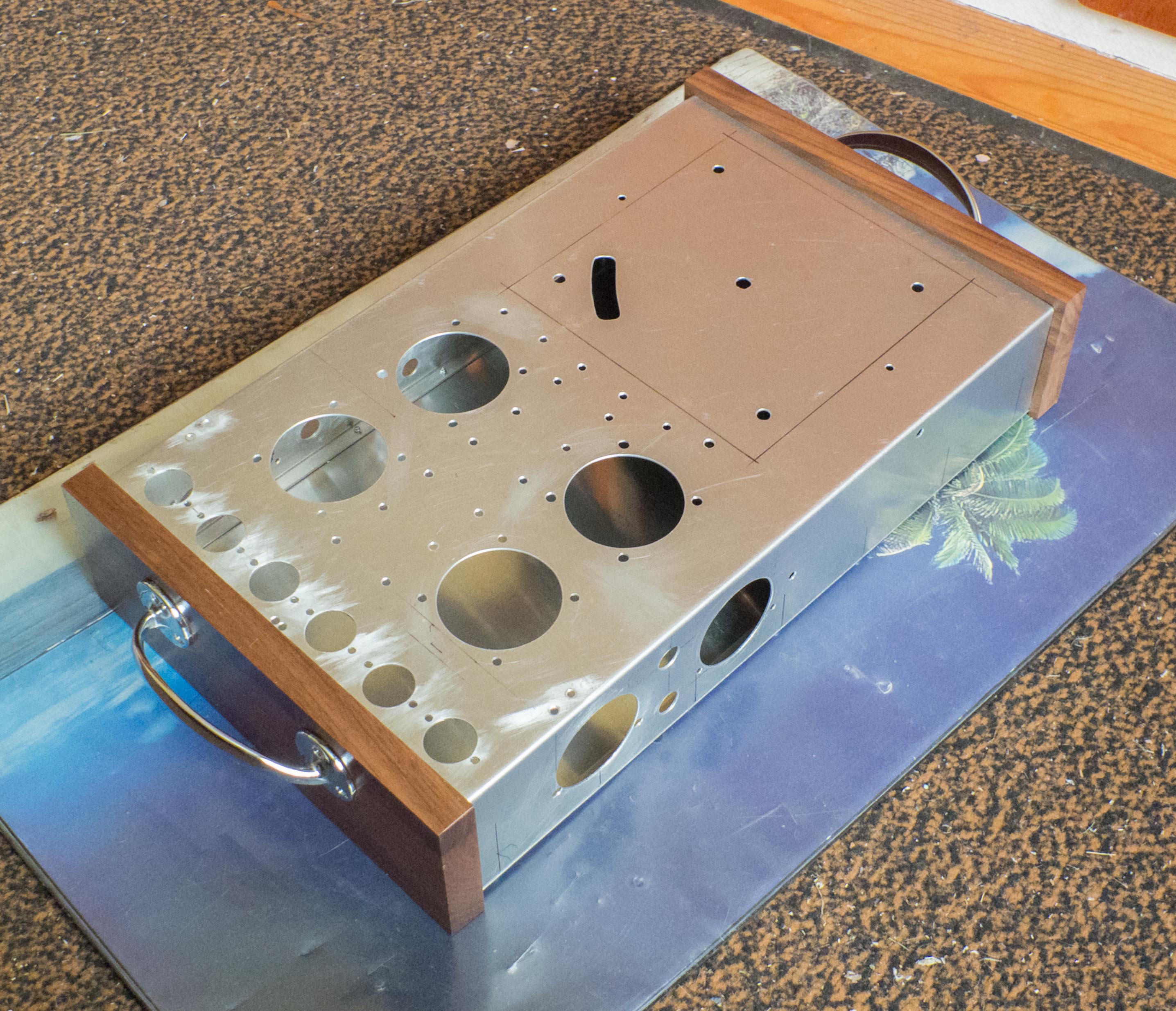

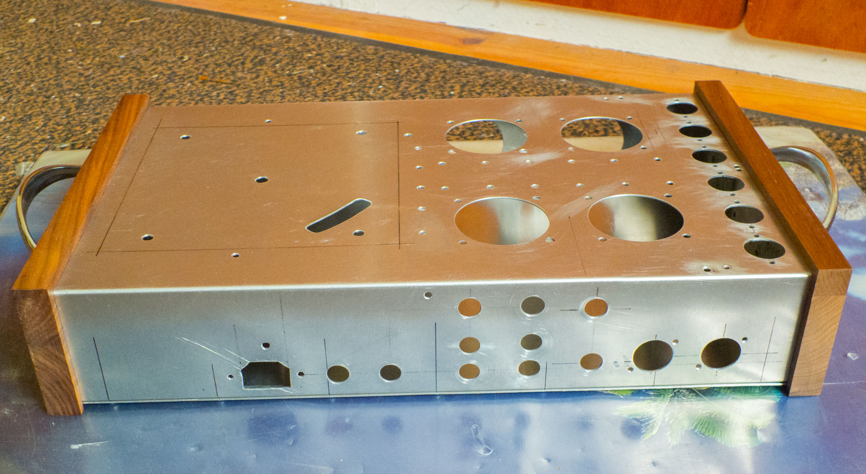

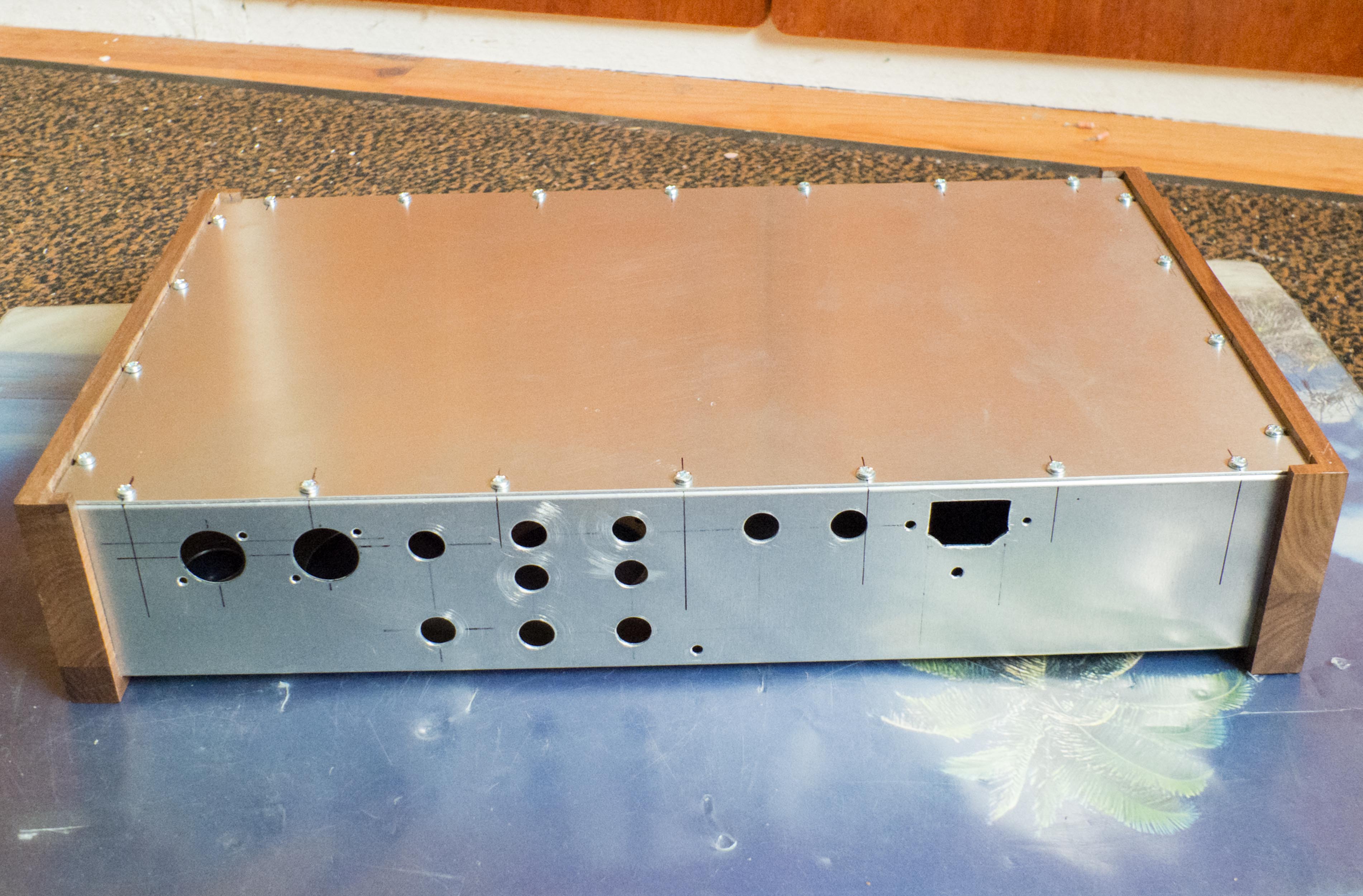

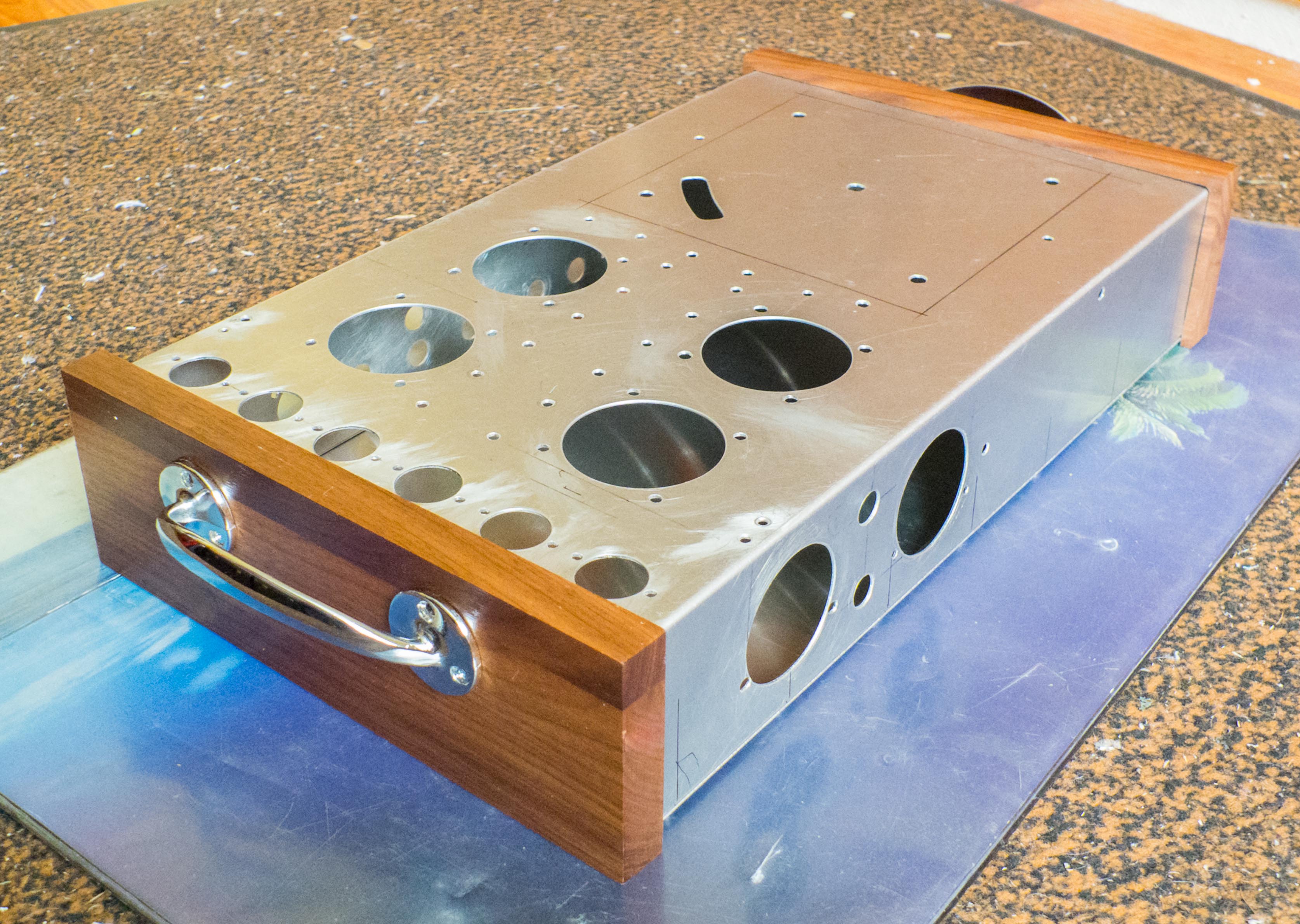

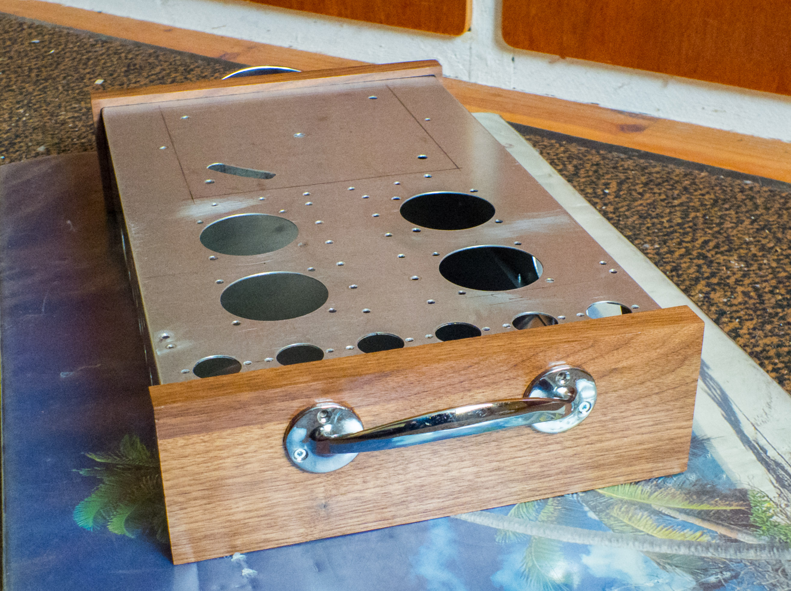

All holes are now drilled and I'm ready to spray the chassis satin black. I have noticed in the past that ordinary cheap spray paint from the hardware store is just not durable. Can anyone suggest a good brand?
Why not use aluminum furnace powder coating, such services are popular. The paint would be scratched proof and not expensive. Usually it's difficult to paint aluminum, you have to scratch the surface or it would stick properly, the coating service should be able to do surface treatment if necessary.
I eventually found a tough acrylic auto paint in an auto parts shop. It's called "Hycote Satin Black". The photos are of a mock-up only with protective tape temporarily on the wood. I should be in a position to start the wiring in about a week.

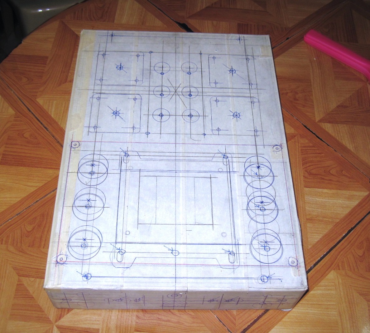

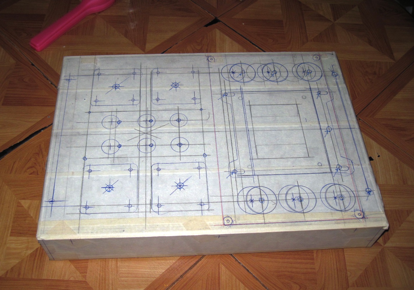

thanks, i used wide masking tapes....layout on it as you can see the tentativeness...
the chassis will be powder coated textured light grey.....

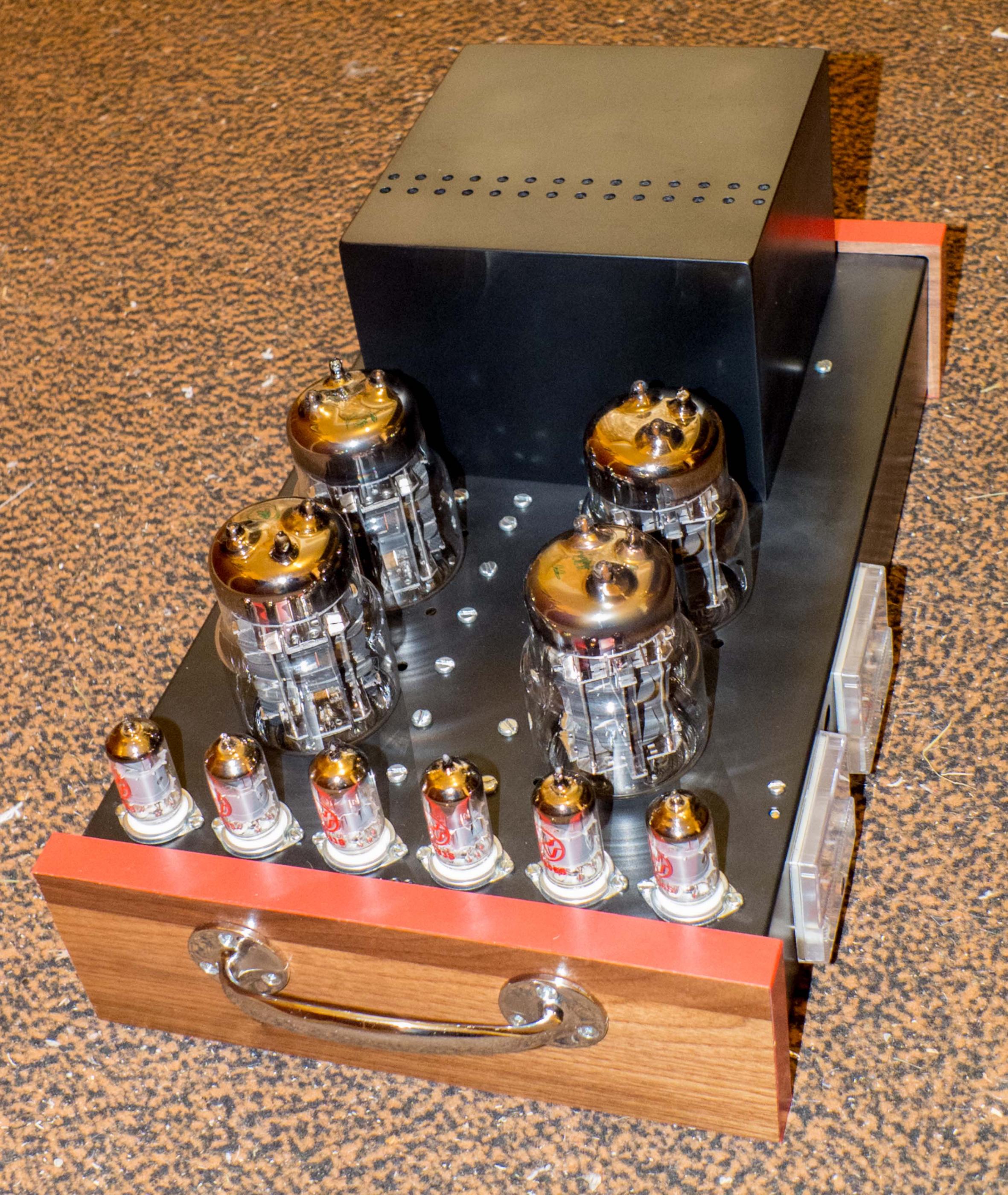

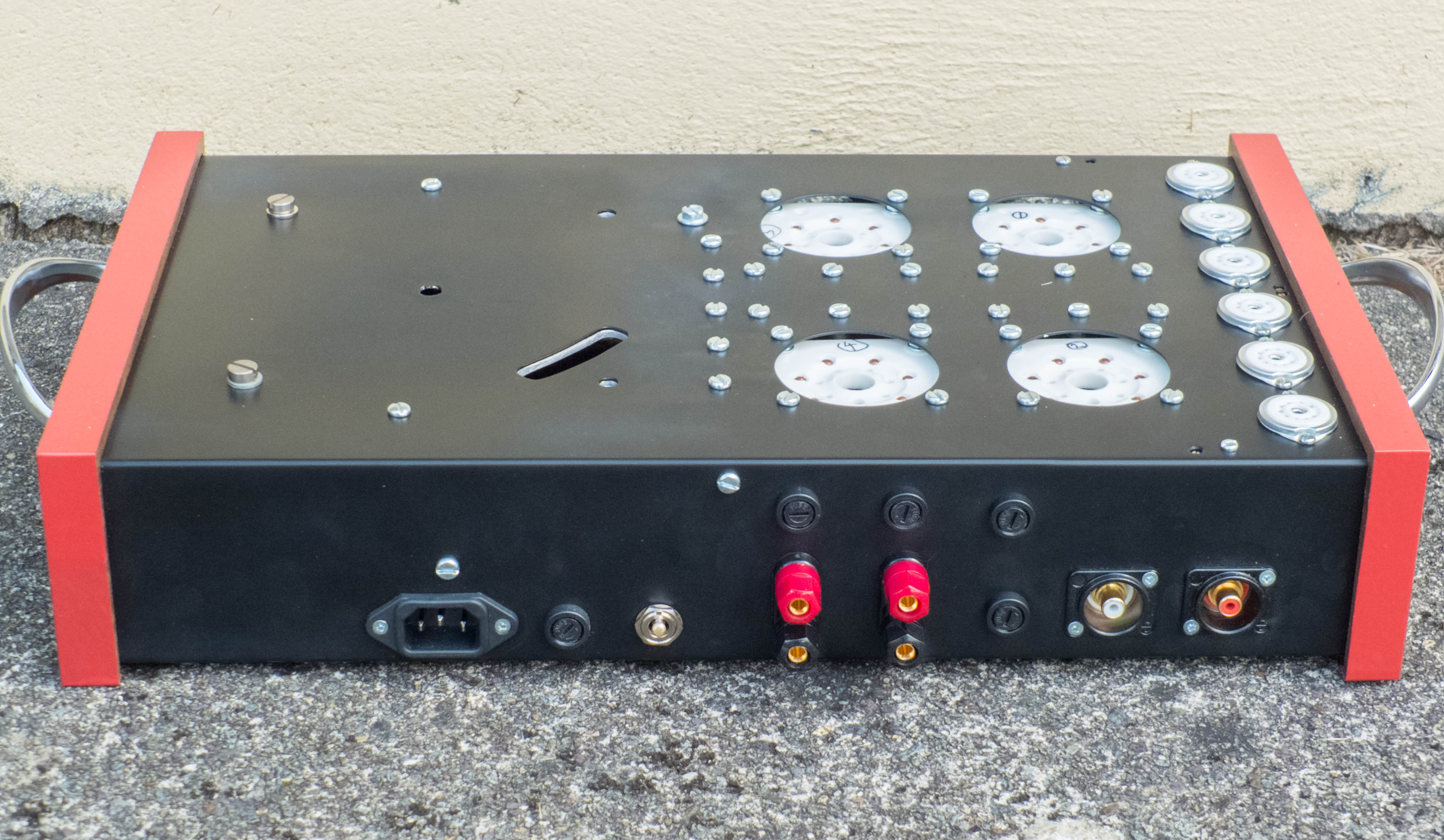

Assembly

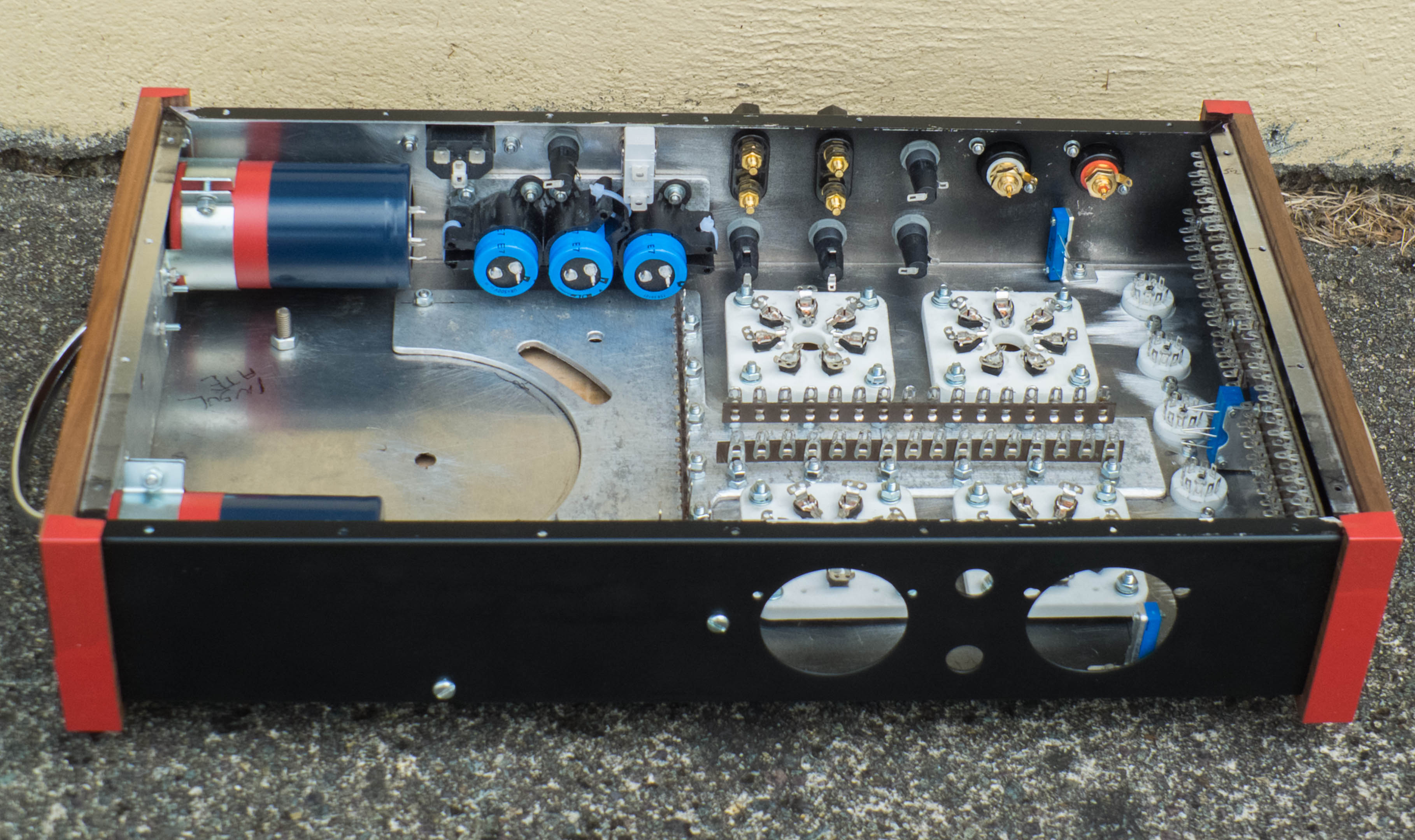

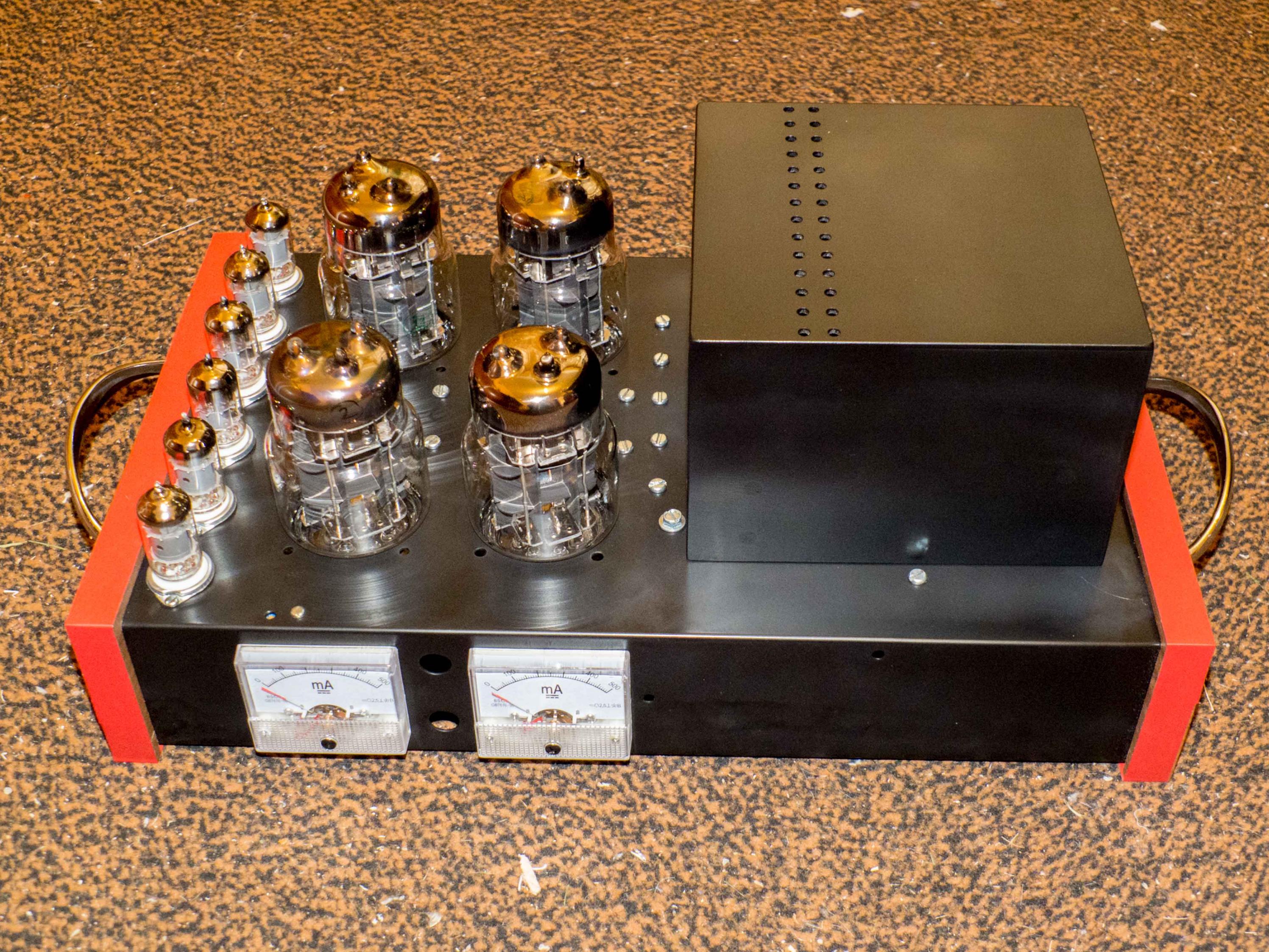

The assembly is almost done. All that remains are the 3 transformers, 2 fuse-holders and the 2 meters. I have a fuse in each of the 2 supplies for both the left and right channels, 4 in all. There is a fuse in the left and right loudspeaker outputs as well as a mains fuse, 7 fuses in total; overkill some might say but I have read all the posts on the two Mellows OTL threads and decided to be on the cautious side, particularly in the light of all that cnpope had to say about catastrophic failures.
The two long strings of capacitors for HT2 and HT4 have been combined into just two Panasonic 4,300 uF 250 Volt units (part number ECE-P2EA432HA) and all other psu capacitors are mounted on two sub plates. All connections to the tube-socket terminals will be taken to two rows of tag-strips and any associated components will be mounted there. The 4 trim-pots for the bias are accessible from the top of the chassis, so during operation there will be no need to remove the bottom cover.
Due to the weight of the two largest transformers, I had to strengthen the base underside with a 3mm alum plate and spine because of a considerable sag. Wiring will commence in the next day or so.
