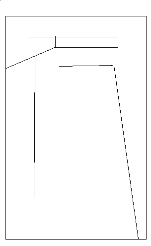

OFFICIAL "SIMPLE KARLFLEX" (bi-chamber) SKETCH WITH DETAILS
RESPECTABLE GENTLEMAN AND ACOUSTIC BRAINIACS OF DIYAUDIO
I present my sketch for your review.
It is a humble 2d sketch made in Microsoft paint but provides enough detail to allow almost anyone with basic woodworking skills, basic tools and easily obtainable materials such as birch plywood, PL adhesive, and poly-fiberfil (or fiberglass, or wool) to build one or more of these cabinets.
AN ELEGANT ACOUSTIC CONTRAPTION
BE CHIC AND UNIQUE BY BUILDING THE FIRST SET IN YOUR TOWN!😎
Operating principle is a 6th order series-tuned design but the aperture/mouth geometry allows for extended operating bandwidth. This is made possible by strategically placed stubs, offsets, mass loading, damping materials and taking advantage of the longer wavelengths of bass frequencies which are conducive to coupling between the front chamber and the front of the driver's cone because the driver is somewhat recessed into a mouth which is also fed and shared by the front chamber's vent, all being in extremely close proximity.... However at higher frequencies the front of the cone will begin to decouple from the front chamber, this is a gradual, graceful and reasonably seamless transition...... At 1khz and above the front of the cone becomes almost entirely decoupled from the front chamber (with only a small amount of loading added by the mouth area's depth) and behaves much like a direct radiating system at those higher frequencies in regards to frequency/amplitude response and polar response patterns, so a builder has the convenience of referring to the driver manufacturer's published graphs to predict what the performance above 1khz will be like. 🙂
(more pros/cons and notes will be listed below the sketch)
FAR MORE MOJO THAN YOUR AVERAGE SPEAKER BOX!😱

I know that this post and even the sketch are all very wordy to the point of being bizarre, sort of like a Dr Bronner's soap bottle! hehehe (ever see one of those? if not you should check one out for fun), I swear that i really do have a reason for the rambling tedium and run-on sentences! I just wanted to make sure that any enthusiast who was considering this project would be well informed because it is the responsible thing for me to do...
Big thanks to everyone on DIY audio who got involved and helped me develop this! IT TAKES A VILLAINAGE! 😉

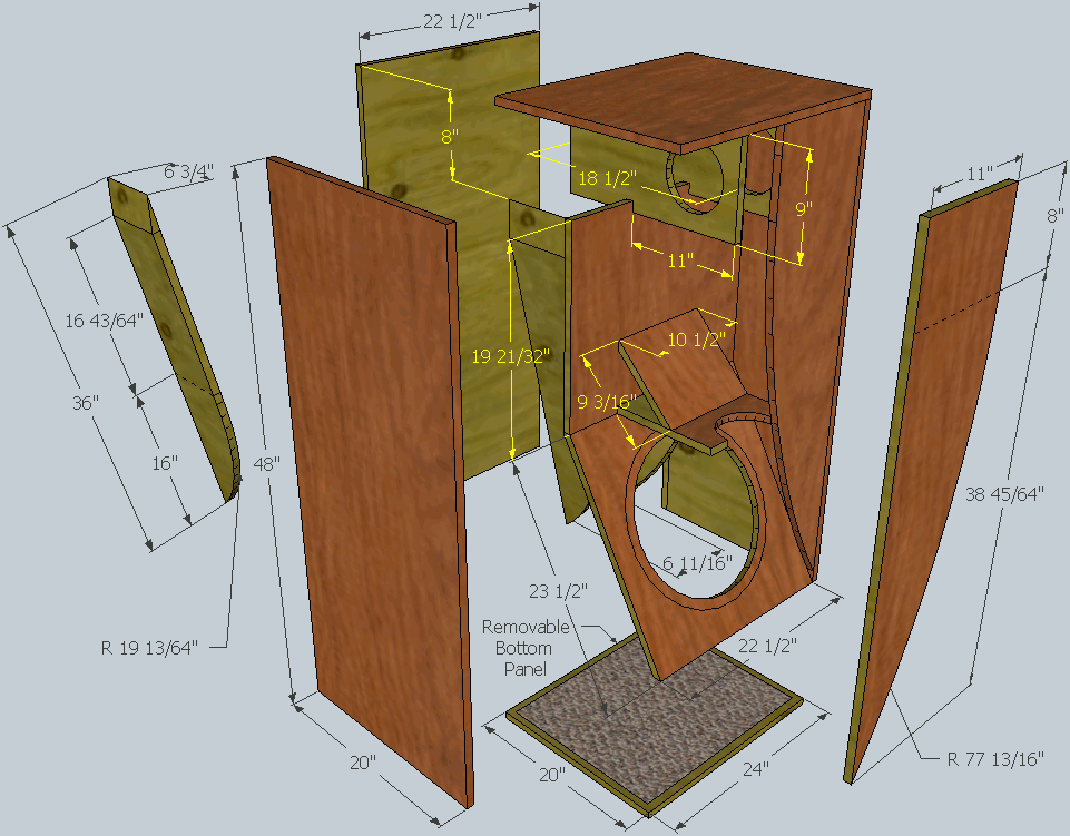

If you build Karlflex with a traditional exponential cut (for dispersion),
plan some way you can remove those wings. Cause looks impossible
to install your driver into that design from any vantage but the front.
I went bottom access non-removable in my above plan. Cause all my
removable wing experiences have been want for some extra bracing
that just wasn't practical. Figure all bracing should have function, and
all function should provide bracing. Only two small panels in mine
(serve as bracing only) fail to meet the dual purpose criteria.
You could jam a pillow sideways through the two holes in the braces
and claim a function. But wan't part of the plan, just afterthought.
Was really thinking, "what if it needs to breath there for the slot to
work properly?"
Not saying with any certainty that its even an issue. But right where
proper breathing K slot can usually blow out a candle. I worry a bit,
what obstruction those braces might inadvertently become.
At 48" tall, would not expect to need an extra Freddi stub to fake it.

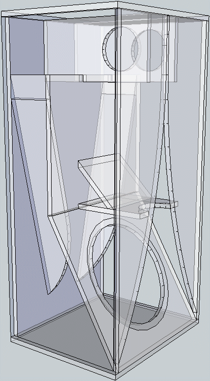

Very nice K-variant! There are some resemblances, offset driver, nice long path length and such...
Looks about right for an 18 🙂

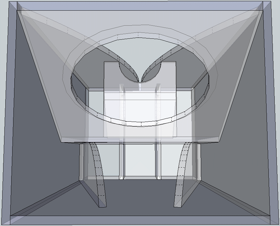

So about the front aperture, would it be counterproductive to bracing it to much, making it to rigid?
with regular Karlson playing a higher levels, the wings and back panel need bracing - bass tautness suffers and wing deflection makes a "shimmering" modulation sound - similar can happen with poorly braced horn mouths, thin direct radiator baffles.
- look at Guits' 2nd video to see a K15's 18mm plywood wings deflecting quite a bit
