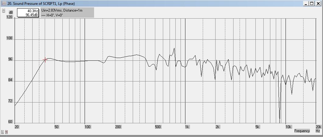

Hi Matthew, I tried to add a parasitic chamber in the bottom of the cabinet.
First I added a small duct "P5" attached to enclosure V1 (20L). It extended the response, but did not limit x-max :worried: Here is the sim: hope I did it right😛

FR:
The next thing I will try, is to make the parasitic chamber you did in post 1292 with a vent...........if I can🙄
Fun toying around in Akabak, when you have taken a couple of steps on the mile high learning latter🙂

Oh yes , Akabak is really fun and useful for experiments like this 🙂
Sebastian , what you have made here is the Clements/PAS style parasitic chamber.. You can also try connecting this chamber at other places such as node=2 , or node=4 , or even node=5 ..... The original Clements/PAS concept connected at the equivalent of node=5 ...... You may find that this style of chamber shifts the box tuning down , so you will have to shorten the interchamber vent in order to maintain the same FB ...
If the mission is to control excursion you will want to make the chamber large enough (or adjust it's vent size/length) in order to allow it's resonance to move into the 1.5x to 2x fundamental range (classic DCR/ABC cabinets go with a tuning almost exactly an octave above FB, or just below) in order to achieve additional control over the driver's cone, because in theory it begins to have an suppression affect upon the bump in excursion that is normally present above tuning (although Akabak may only show the result as a dip or notch in the excursion bump, accompanied by a dip in impedance at the para-chamber resonance, as well as a wiggle in response and phase)...
You can also try adding a little bit of stuffing the chamber to change the resonance's Q , spread it out , soften it etc ...
The vented parasitic chamber (Weems/Augsperger style from which my Labyrinthine para-chamber was a spinoff) is what i ended up building so i have more real-world experience with it ..... Since it is vented there is an upward shift in FB that can be compensated for by extending the interchamber vent Duct-P2 if necessary...
The vented para-chamber that i built was composed of three ducts (all full width , 12.5" in this case) , the first which connected to the equivalent of node=2 or node=51 and was 1" tall , followed by a 3" tall duct , and then the final vent was 1" tall (and then a radiator as Akabak requires) ......... So in essence it is a pipe section which is intended to develop it's own personal resonance while also acting as an additional vent for the main system all at the same time!! Cool eh? 😎
Now here is the problem that i ran into:
Even though my labyrinthine experiment's duct ratio was only 3:1 (something that i would hope would control the sharp nature of the resonance) i still ended up with an abrupt spike shaped resonance at around 70hz which was exactly where Akabak predicted it would be located (so that part is good) , but i was really hoping for a resonance that would have more of a wide damped hump shape because that would be more effective at controlling the cone and less disruptive to the frequency response of the cabinet ...
The Labyrinth did not leave much room within it's folds to place any significant amount of damping fiber without choking the path and ruining efficiency , and the small amount of poly-fiberfill i was able to put in there wasn't nearly enough to damp the sharp resonance ... So it was obvious that my para-chamber needed to be redesigned ... :sigh:
Perhaps the duct ratios could have been reduced to 2:1 and made longer to bring it's parasitic resonance back down to 70hz blah blah blah blah , BUT I SOON FIGURED OUT A BETTER SOLUTION!! :idea:
:bulb:
After some more dabbling around in Akabak i realized that i could add a stub section within the para-chamber , and the stub could be stuffed with fiber for damping without choking the path !!! :happy2: This would soften up the resonance enough to knock down the sharp peak and spread things out (at least more effectively than my previous designs ever could have) , hopefully this method would result in the measurable improvement that i was striving for but i never got around to building it .... I only simulated it .................... If i remember correctly i think it ended up being a duct , followed by the stuffed stub, followed by a wider duct, then the smaller duct/vent , and then the radiator of course ...
Essentially we are already using two stuffed stubs in the Karlflex cabinet , and the above idea would add a third stuffed stub ...

I did some more sims. Increased your standart 99 Freddiditech with 5 cm at F0, F1 and aperture F2 plus added a parasitic chamber. Think I got the nodes and such right this time 🙂
Got a little more sensitivity and low end, without sacrificing the x-max, nice. Could problably refine it, but wanted you to see it before moving on.

I have your script loaded into Akabak right now and hey, this looks really good ! You definitely have the right idea about this :checked:. You must be eating the fatty coldwater fish (and their eggs) and seaweed up there in Denmark and all of the other good brain foods because you learn fast! :up:
You can temporarily set your para-stub's VISC=1 in order to get a clear indication of exactly where the Parasitic resonance is tuned ... Shoot for an octave over FB (or just under 1 octave) , it looks like you were a little over the target but not by much , so i reduced the height of Duct p5 to 2.6cm , and I left the other para-ducts alone, so you basically have a 1" duct, a 3" para-stub, and then the final 1" duct. The change shifts the para-frequency down and gets us closer to our target of around 80hz .. Increasing the height of the para-stub can shift it even lower :wrench:....

I loaded the script into Akabak and it looks great to me so far, I am not seeing any problems with it :magnify: ...
You may have nailed it! :bullseye:
Keep in mind that even though the simulated response graph shows a minor sag around the parasitic resonance frequency but in reality you may actually end up with a bump there instead (as i measured on this end) 🙂.....
Something else just came to mind and this is about the para-chamber's vent ratios: it is generally considered good policy to keep ducts/vents/ports (in their typical role) at less than a 1:10 height-to-width ratio because the port's behavior will be more accurately predicted with our software as long as the ratio isn't too high (and there can be issues with port compression or non-linearity when the system is played at high volume) ... I barely exceeded the vent ratio in my build (1" x 12.5" ) and i got away with it, but a 1:19 ratio is pushing our luck ...... OTOH since these ducts are not the cabinet's main vent it may not be quite as critical, perhaps nothing to get concerned about (the para-chamber's vents do not have to carry as much air flow.... The velocity is verifiable with Akabak), so you could still be fine in this regard .....

I was wondering about the ragged response from 300 hz. The more I close the front chamber section, the more smooth it gets. So the ? is when is too much. Closed in heavily like this:

The FR gets smoother, but now the exit is only 1.3 cm, to small I recon... or maybe I am too worried and the ragged response will not be so prominent in "real life".
This also introduces other problems like tuning Fb too low, combined with too low sensitivity 🙄
I did this sim, it smoothes the HF by making front chamber smaller. Then I increased the PARA chamber. I also reduced lenght of P2, P3.

If this could work, it would be nice. A bit of a saddle in LF, but a little raised response at Fb only gives a bit more grunt.

The front chamber's vent (F2's hth= figure) should not really be made any smaller than the interchamber duct's height (P2's HD= figure , about 6.3cm) because that (in conjunction with these cabinet width slot ducts) is already at the limit of how much we can constrict the path without running into problems with air particle velocity...
Unfortunately the dip at 300hz does show up in real life just like it does in simulations , but I think you will be happy to know that using the para-chamber somehow reduces that dip ... Take a look at this 🙂
With the Karlflex there are many different resonances supporting the output almost all across it's effective range .... They don't always exactly meet or play nicely together if they overlap , and this is the case at 300hz .. ... The hump in response that you see centered around 200hz (extending from 180hz to 250hz) is created from the upper harmonics (5th and 7th) and is a product of the main path .... The Freddi-mod cavity's job is taming that range .... Then above that the resonance of the front chamber picks up at around 400hz and extends out to almost 1khz , which leaves a gap between resonant ranges right at around 300hz ....
So the entire accompaniment of resonances for the Karlflex is as follows:

| regards to bass frequencies but not in the upper frequencies allowing
|6th order performance without the bandpass cutoff limitations in bandwidth.
|  The front chamber section (above the driver), nodes reversed for tapered shape.
Waveguide 'F2'
    Node=18=5
    wth=48.3cm hth=6.3cm
    wmo=48.3cm hmo=9cm
    Len=31cm
    Conical
|  The dimensions and depth of the mouth/aperture(technically also part
|  of the front chamber).
Duct 'P4' Node=18=6
WD=48.3cm
HD=40.6cm
Len=2.6cm
VISC=1
Radiator 'Radiator' DEF='P4' Node=6 |Radiator or mouth dimensions defined by P4
It narrows the gab at 300 and pushes it up to 400-500 and less severe, which is nice, but at the same time makes a "rollercoaster" from 100-200hz. Like you said, it is a balancing act 🙄
