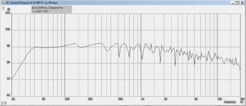

Hi Matthew, I came up with this in Acabak. It is basically your script, I just adjusted some values, so my internal box will be 72cm tall. I also slimmed F0 to 6 cm and increased P0 and F1 accordingly.
The FR looks nice without any severe nulls (steep holes). Maybe you could take a quick look, and see if it is flawed, thanx 😎

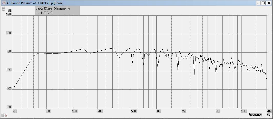

Mr Sebastian ,
It seems to me like you have the right idea, You learn fast! 🙂
The graph is great, smooth, and as you can see you have 96db @ 1w/1m efficiency on the bottom end which matches the midrange on that driver almost perfectly 😀 It should have a well balanced sound.
I went over the script and it works as far as i can tell , i haven't noticed any major problems with it yet .... Your S1 is more slender but that is fine , and the bottom of your S1 looks like it will extend down to about 7cm above the top face of your bottom panel, which is also totally fine...
Your F1 (S3) length is 29.5cm but i calculated that it should be more like 32cm, nevertheless it is close enough
, i think it is awesome that you figured out how this script works (not to mention the Akabak software) practically overnight! GOOD WORK!
Ok , here are a few more ideas to think about:

If anyone is curious: here (below) is a graph showing how the vented Para-chamber affected my response measurements ... This para-chamber was actually undersized but i was still able to make it work, notice the peak at the para-frequency instead of a dip (not typical for a DCR/ABC) ...
I called this box the "Tri-Chamber" Karlflex ... The extra complication of the build was inconvenient, but it worked 😀
