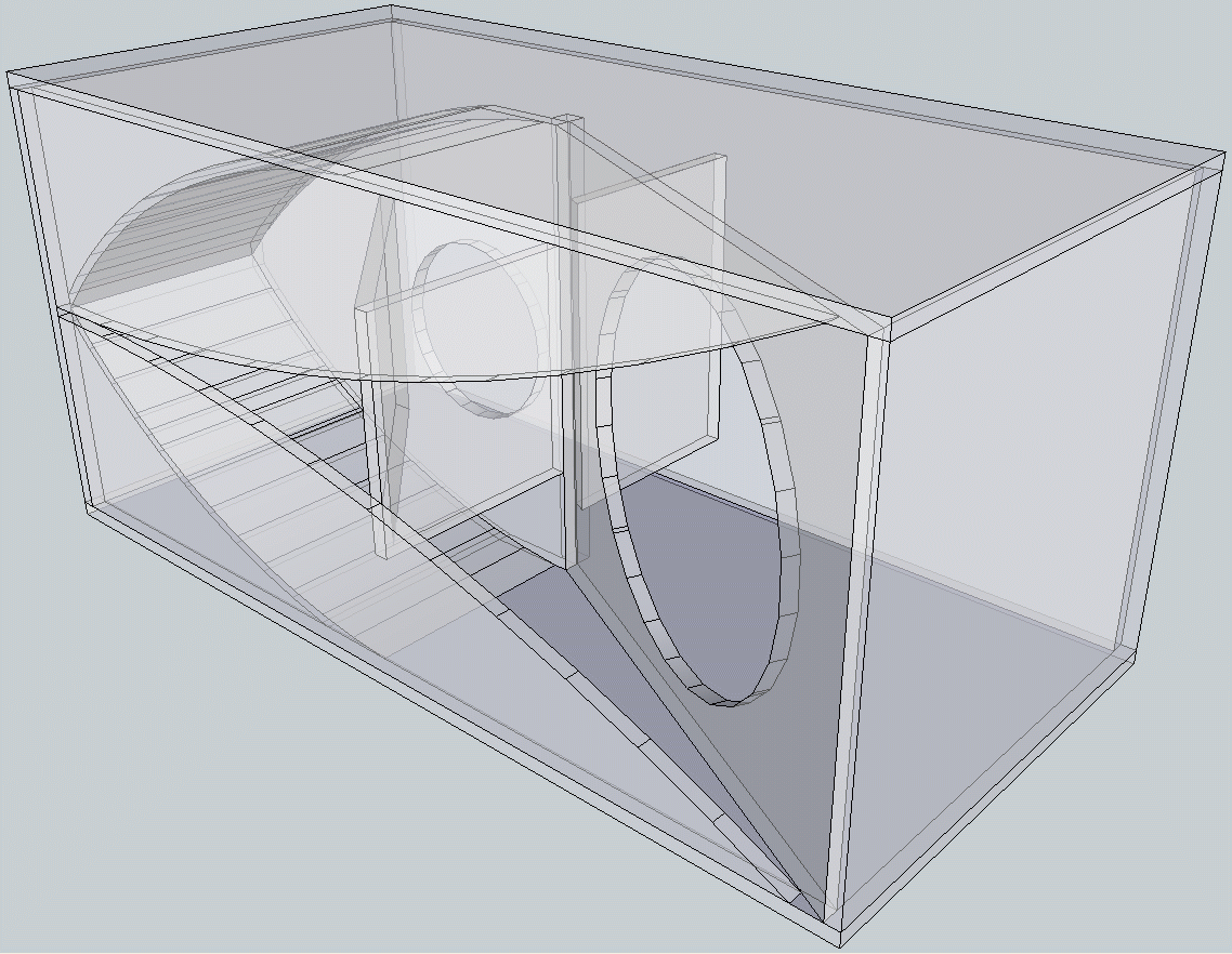

I have no clue if my drawing is properly tuned or has even
the slightest practical merit. Its just a drawing, noodling,
daydreaming. You should see the Kuckoo clock fig666...
If you build Karlflex with a traditional exponential cut (for dispersion),
plan some way you can remove those wings. Cause looks impossible
to install your driver into that design from any vantage but the front.
I went bottom access non-removable in my above plan. Cause all my
removable wing experiences have been want for some extra bracing
that just wasn't practical. Figure all bracing should have function, and
all function should provide bracing. Only two small panels in mine
(serve as bracing only) fail to meet the dual purpose criteria.

Silly plan to focus the upper chamber action to a vertical stripe
directly behind the slot and bounce the echos out in the fewest
possible passes. Alternative to lossy damping with stuffing.
Karlson had drawn a "Fig 6", ask Freddi. But its curved panel
focus is a horizontal stripe. Makes no sense how this is going
to exit a vertical slot. John's drawing is just whack. I fixed...
Not transflex or simple or a subwoofer, doesn't belong here.
Crosley chamber / Kuckoo clock / Fig 666 / Go figure...

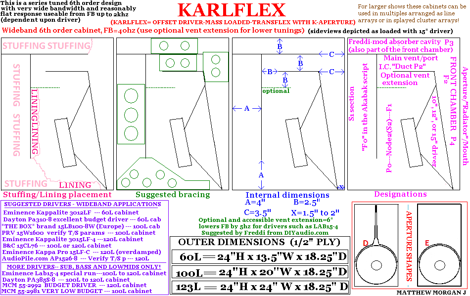

Freddy: I like the look of the tapers in this new design. Have you tried both profiles and which do you prefer and why? Thanks Moray James.
PS: you may recall that I used a horn of plenty style profile where I had the tapers go horizontal just at the top of the driver and I felt that did away with most all the echo effect they can make. I like this even more because it keep air load over more of the woofer than what I was doing yet it achieves the same results I expect.

I zipped up some files for the Karlflex to a zip file and uploaded it to "zeta-uploader" you can download it until it becomes unavailable (in four or five days) .....
I also attached the main full size sketch (from #1611) using DIYaudio's file hosting, it may work better for some ...

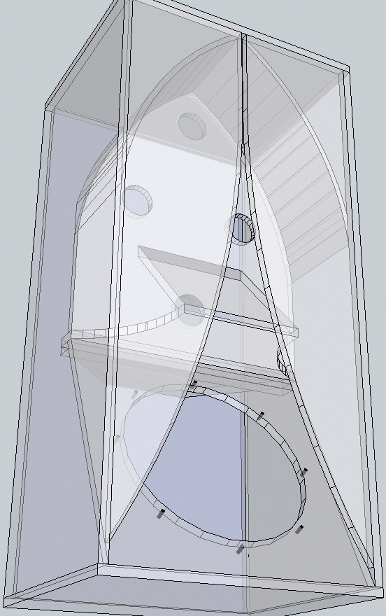

Figure 666
Kenpeter,

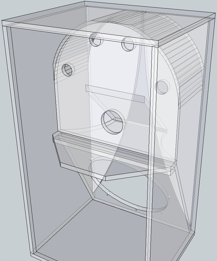

Thank you for posting the Kuckoo clock figure 666... What a fun variant , and still retains so many of the classic Karlson features... The big internal panel with the 4 holes is what divides the front chamber from the back chamber on the Kuckoo , the front:back ratio also looks to be along the lines of what the classic K-boxes used🙂 (instead of an undersized front chamber like the Karlflex uses)....... The panel/brace just above the driver in the back chamber forms "low pass choke" (as it was referred to in some of the K diagrams posted by Freddi, or other drawings i have seen around) , but could also be said to form a compression chamber .......................... Then there is also the K-slot wing brace that doubles as mass loading just above the driver in the front chamber ..... If these extra mass loading & choke/duct features are truly acoustically relevant (each with it's own corresponding useful resonance/purpose) then it would make this box more than just a 6th order design, possibly 8th order, or even 10th order because we get 2 additional orders for every chamber & vent set if everything is actually acoustically functional ....
I have on a few occasions tried adding the "low pass choke" (small vented rear compression chamber) feature to some of my Akabak scripts but so far i have not had any luck seeing that particular constriction do anything positive for my simulations, so i am either doing it wrong, or i have to think that Akabak doesn't predict all of the benefits of that feature properly or perhaps it just doesn't really do much of anything for you and simply happened to be a convenient place to put a brace in the old K-cabs *shrug* 😛 ....
On the other hand that brace holding the K-wings steady which also doubles as a Mass Loading duct is interesting and gives me an idea:bulb: about using something like it as a second ML-vent in a series of three chambers & two vents (plus a third if you consider the mouth a vent) in some form of a modified Tapped Pipe or ML-Transflex sort of cabinet, i might try dabbling with that idea a little bit in order to make an 8th order series-tuned variant of the ML-Transflex (or maybe some sort of 8th order Karlflex) ......:scratch2:
I can draw a sketch if anyone wants to see but of course determining whether or not it can be made to work in Akabak will let me know if it is an arrangement worth pursuing ...
