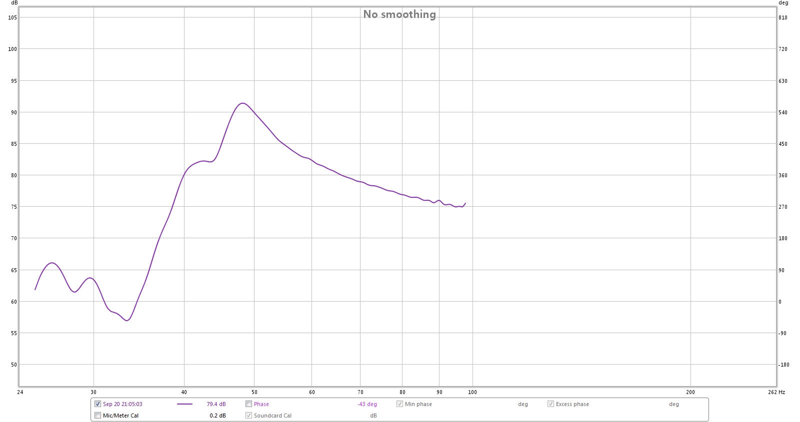

Glued driver cone, flipped it around (driver in throat). Having severe frequency response issues. Doesn't play below 38 Hz like at all, should be down at 32 Hz in corner... Yes I've varied placement...
Measurements will come.
Behaves a lot like a 42 Hz tune instead of 38.

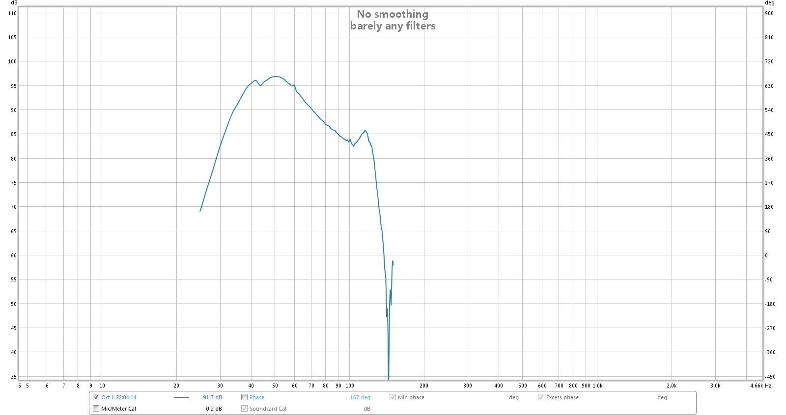

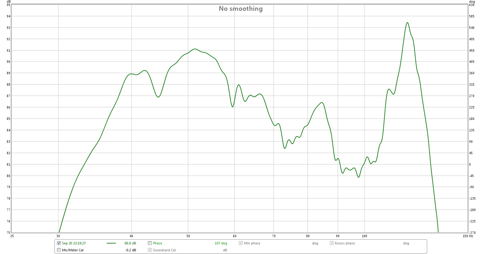

Measurement done in middle of room measured in extreme nearfield. Tested T60 (same electronics setup, my reference sub which still measures pretty flat) and it backed up what my ears were telling me --> the really peaky measurement was actually what it, this 2x12 sounded like 🙁

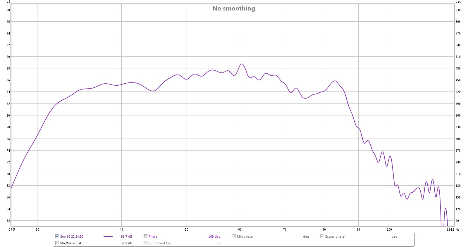

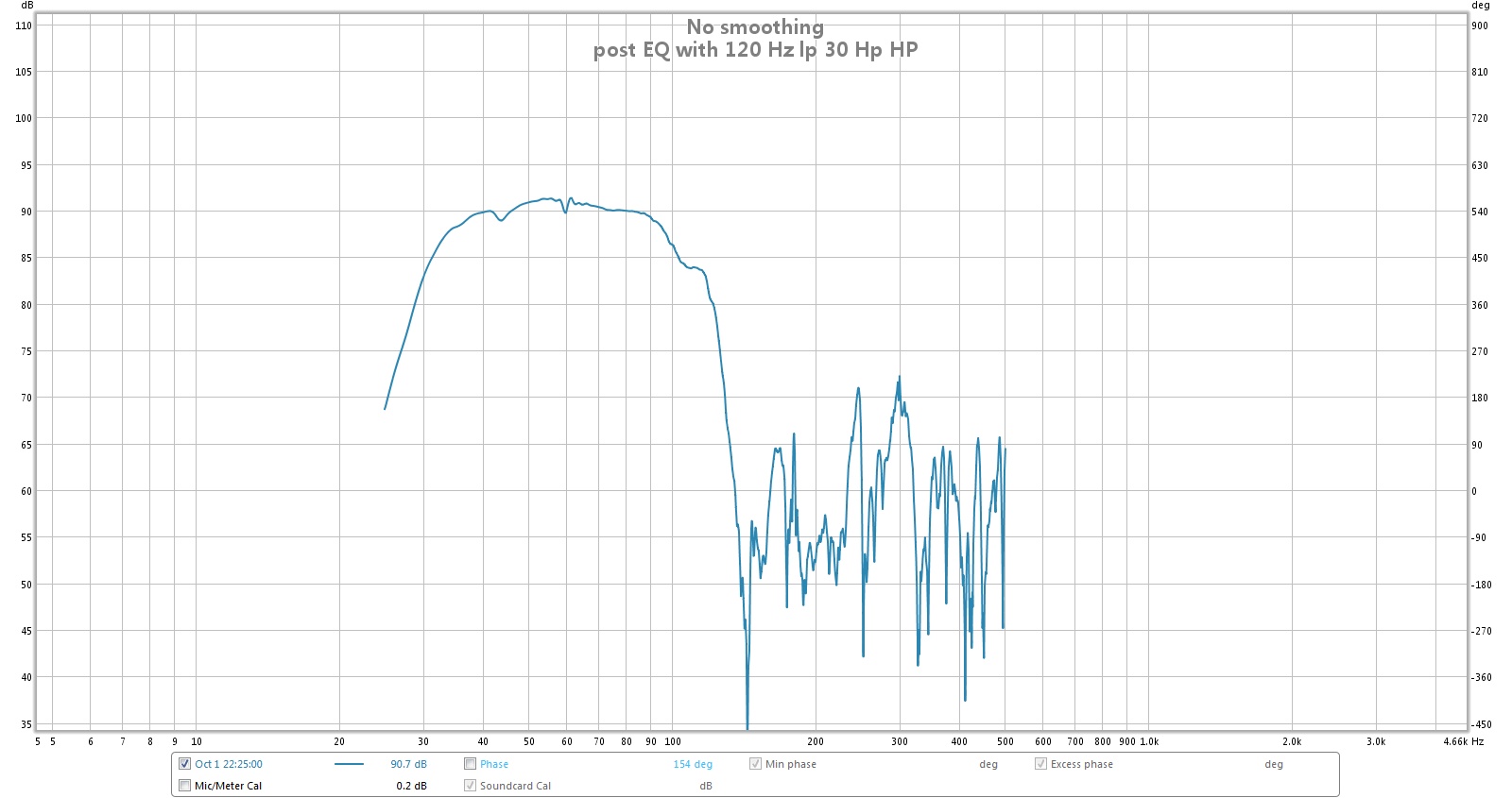

Ok much better once I wire up 2nd driver. This is response after some EQ vs no EQ. It's evident which is which.
