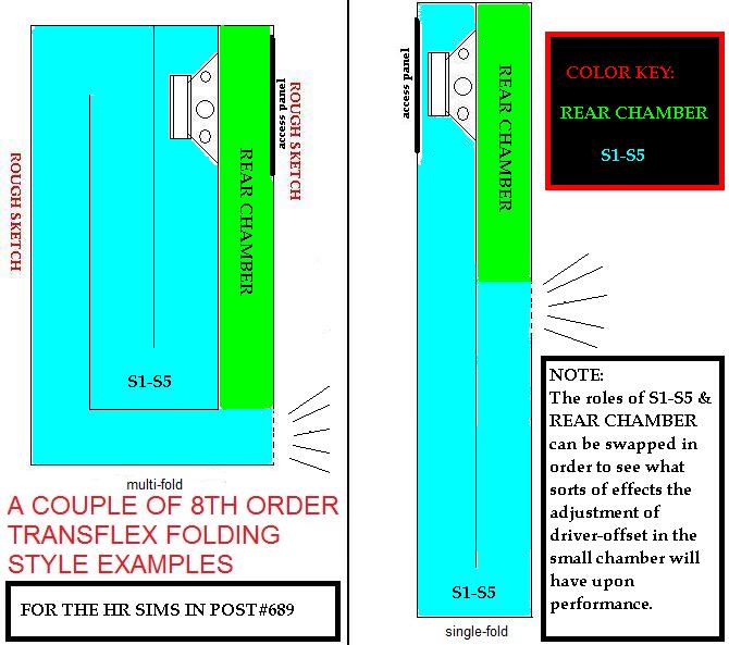

It would be much easier to follow your description, and maybe to help, if you would add Hornresp reference lables to you sketches (S1/S2...Vtc...Vrc...). Also, by Hornresp convention the sound has to pass from S1 past S2 and S3, and also by S4 on its way to S5, I don't think that is the case in Post #691.
Just interested, and trying to understand.
Hi there TB46 ,
The sketches in #691 are just different ways to fold the sims in #689 ... In those examples the long section of the pipe (the one tuned low) are S1-S5 in HR, and the short section is the rear chamber, but i am finding that there are alternative ways to arrange basically the same thing in HR using the different chambers and S1-S5....David's software is totally ingenious..... Since we aren't using any taper or expansion it is all pretty flexible as long as you keep in mind that the chambers don't support driver offsets..🙂
I can color code one of the sketches for you...

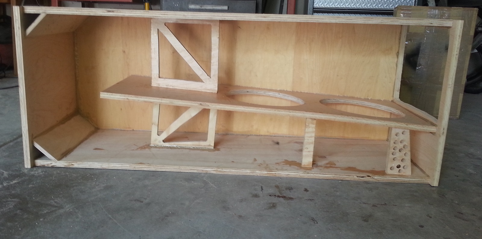

Braces in and mouth is rough cut, baffle flush cut to come after final side is in (after my 2nd driver and speakon terminals show up shipped cross country).
What's left to do in the order I plan to do it:
- Cut handle near bottom mouth
- Paint all visible interior parts of the cab and draw lines to paint final side (where visible)
- 'drill speaker wire hole and cut/install speakons near the driver end of the throat (making Absolute sure it seals)
- Install wiring to speakon's/prepping the daisy chain of the two drivers.
- Install final side
- (slight) bondo/roundover every edge, Paint External, then screw in speakon terminals, wait a while to dry
- Driver Mount/Leak/Seal test, Epoxy as needed
Hi Matthew Morgan J,
TB46,
Here is a color coded key 🙂
Thank you for the color coded key.
You are welcome Sir, it was no problem, MS paint is fun! 🙂

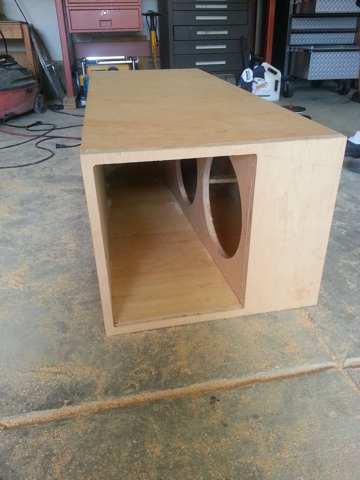

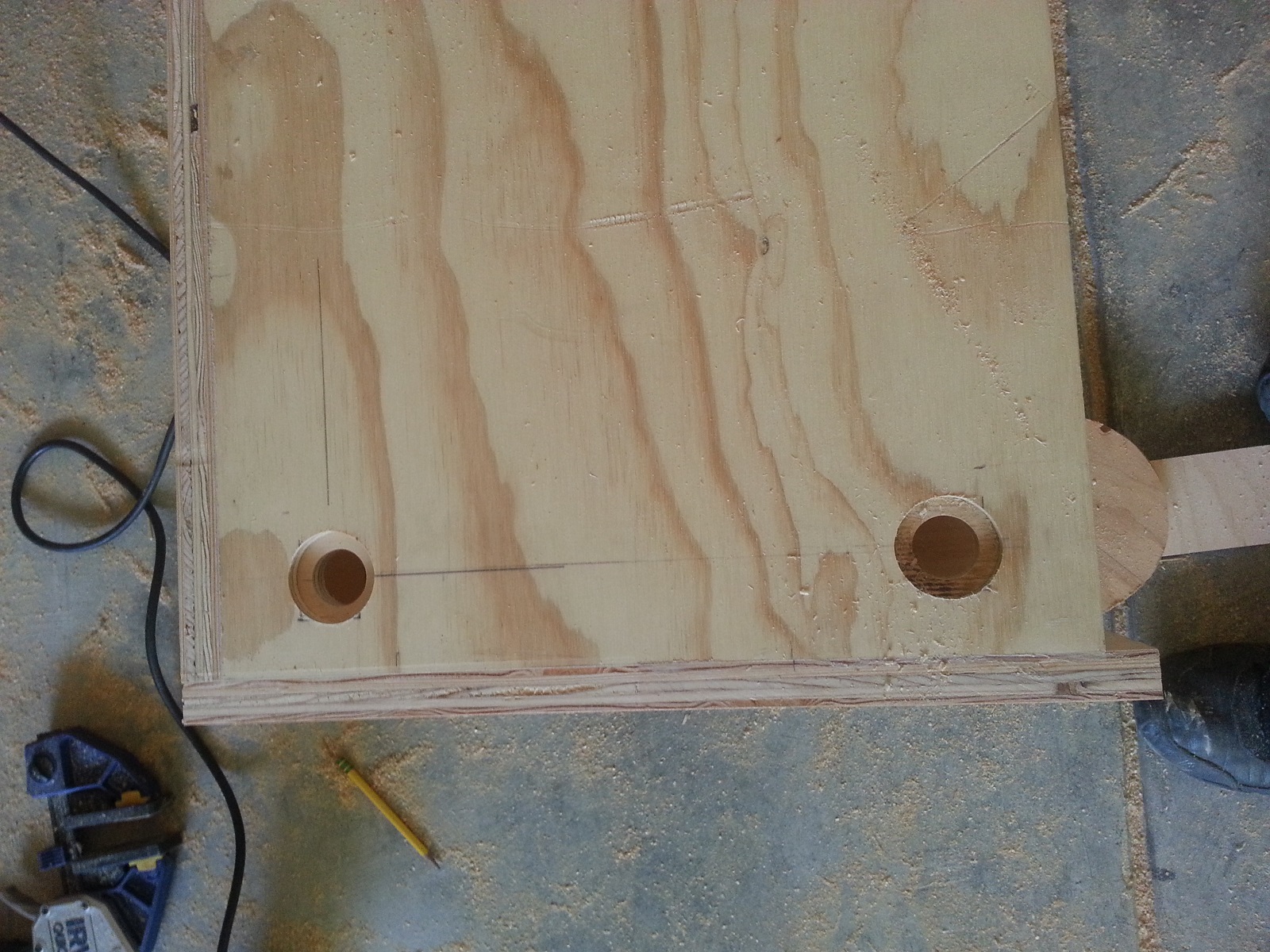

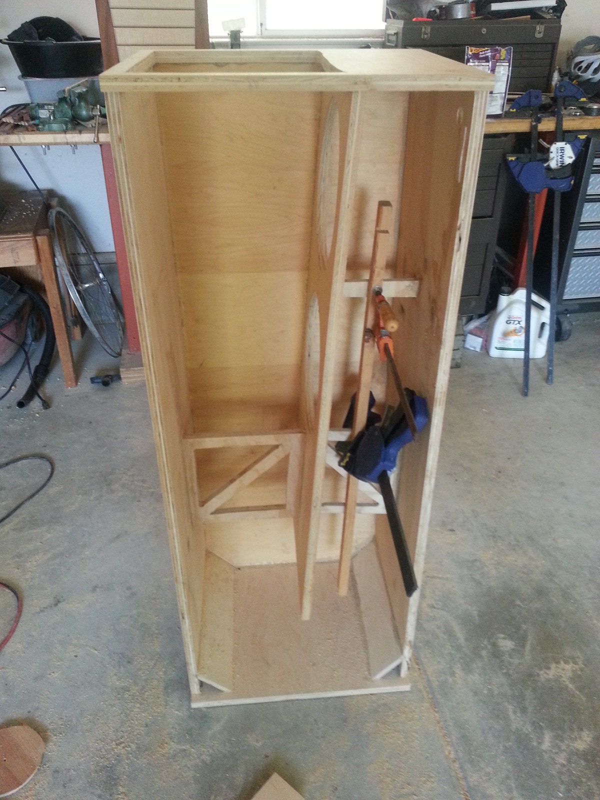

Got a hold of him, turns out I'm going to have to find another buyer. Tapped horn will be painted tomorrow or if the mail comes too late Wednesday (duratex has to ship cross country -> we need a california distributor!!!).
Driver 2 comes in wednesday, hardware (speakons) are supposed to arrive Tuesday (seperate shipment than duratex). Not much new to show you guys besides this really sweet routing. Note that my dad had me knock out the two stick braces due to bow issues and the one that we replaced it with is much more aptly placed, right at the point of stress, cut a little short to relieve PL pressure strain. Yes I cut those speakon recesses by hand (meaning not cnc) with a homeade jig and a not-quite-a-plunge-router. The last view is just what it will look like buttoned up, last side doesn't go on until after paint is done.
Yes that end panel is one solid piece, and I love the way it looks.
Spent a whole day prepping with bondo, painting, last panel glueing (difficult and time consuming), Probably 10 hours split up throughout the day (dry times). Will post pictures once paint dries. Does anyone know the best way to seal the nl4mp-st speakon chassis mount connector? Those are the ones with the screw down terminals rather than the spade lugs. I realized it isn't airtight (major air leakage potential, that's what I get for being lazy and not wanting to deal with lugs/terminals that ultimately make a mess) and have been debating between PL: messy and permanent, vs Hot glue:Less pain in the neck, dries fast, removable. These are right in the throat so they need to be bulletproof. Open to ideas. I have: PL, Hot glue, some epoxy...those are the main adhesives I have at the moment.
