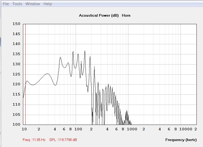

Anyone wanting to make a more powerful Housewrecker can use 4 swr's like so
I mean 140 dB at 11 Hz after corner and typical room gain accounting for 5 dB of driver headroom , if that doesn't induce an earthquake I don't know what will.

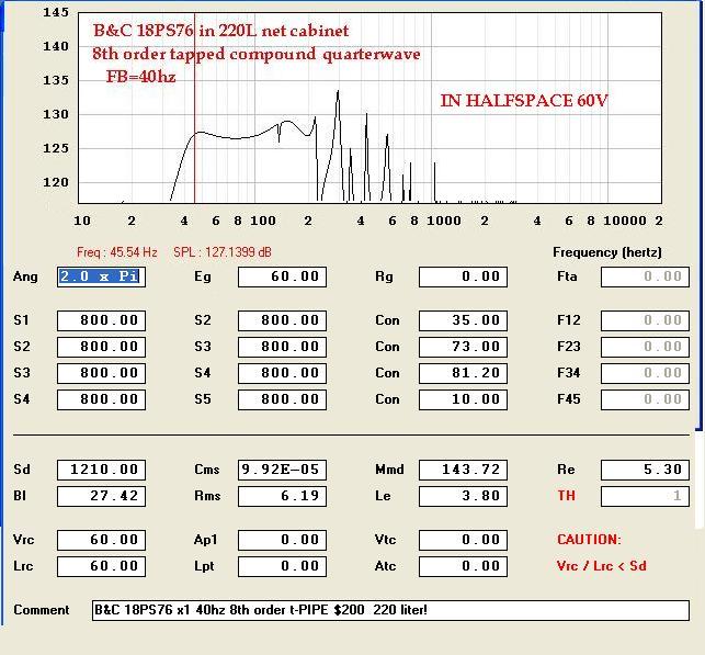

UPDATE .... WIDE BANDWIDTH AND HIGH OUTPUT POSSIBLE-- 8TH ORDER
FULLY THRILLING AND THOUGHT-PROVOKING UPDATE! :

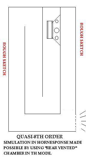

I have been doing some more work with these 8th order concepts using Hornresponse and i had suspected that using a driver with different parameters might extend the bandwidth and make this "8th order Transflex" more competitive with other popular Pro Audio bass horn designs ...
INITIAL RESULTS LOOK EXTREMELY PROMISING! (in sim at least)😀

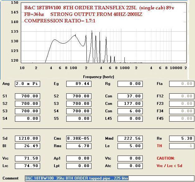

Great output and bandwidth in a relatively small package if you use drivers with high motor strength ..
Compression ratio is very low on these designs, seems like so far i am getting ratios in the range of 1.3:1 to 1.7:1 range which means that drivers are less likely to suffer from physical failures like cone folding/tearing/shredding or the distortions & power-compression losses associated with cone stress or BL insufficiency.
These particular sims were aiming for useable extension to 40hz keeping the cabs compact for portable PA usage ..... I am sure these sims could be fine-tuned a little further, but i just wanted to demonstrate the potential .... I also posted one additional sketch as an example of a folding option for this type of 8th order Transflex ... 🙂
note: Hornresponse does give me a warning in red on the inputs page about the sq cm area of the smaller chamber/pipe (rear chamber) being less than the driver's SD , but you can look at the diagram and see that it is only smaller by a minor degree so i am not concerned .

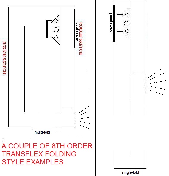

Those designs are interesting, but definitely take longer to build, also it appears that access panel is a must here and that it may require 2 seeing as you need access to both sides of the driver mount... Intriguing technically though.

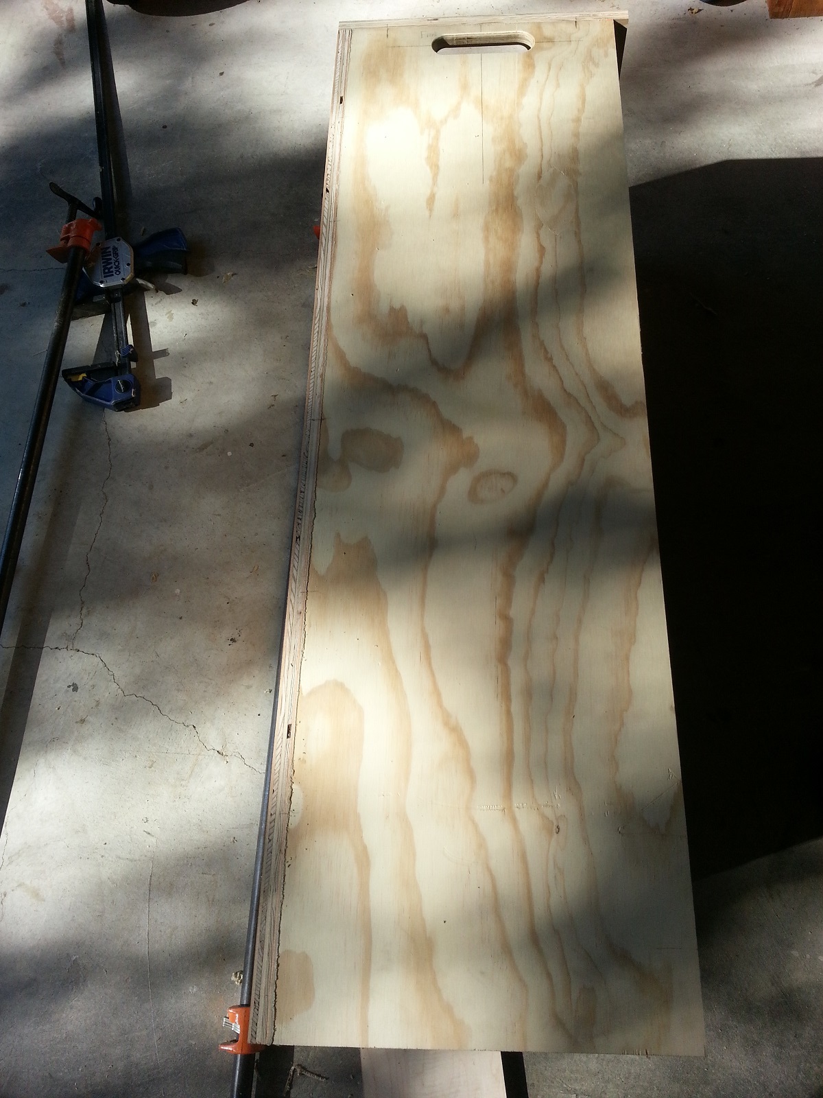

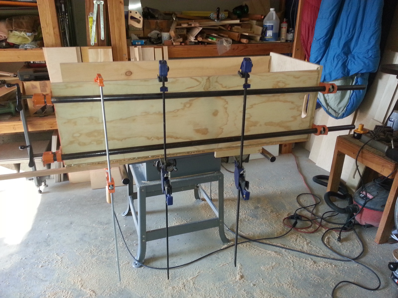

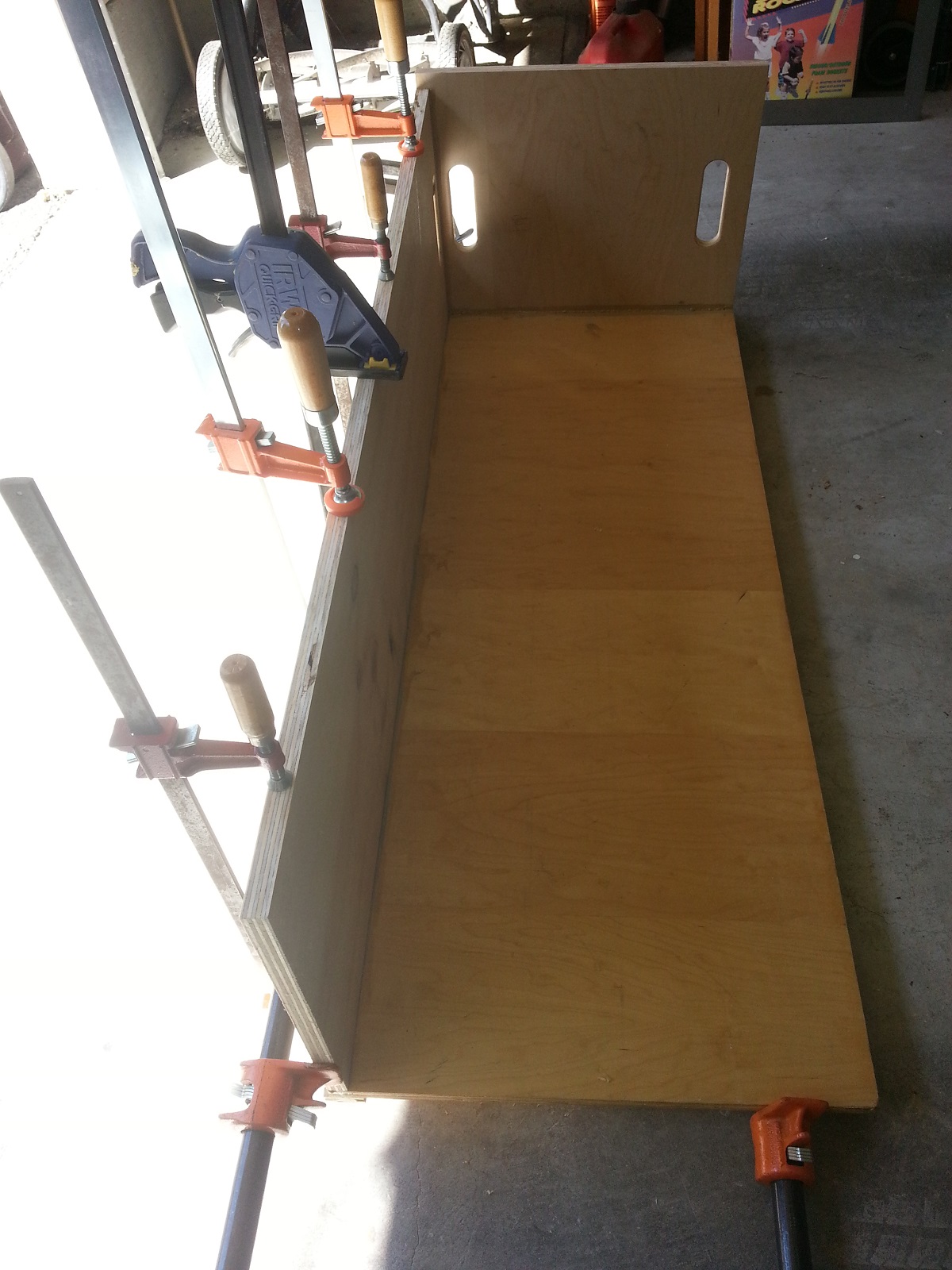

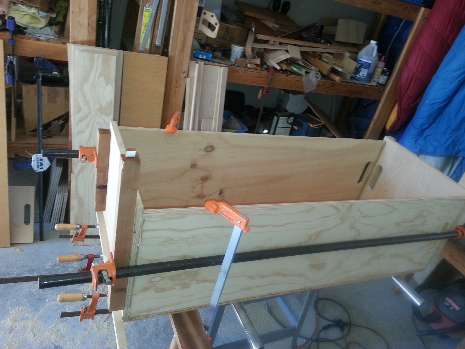

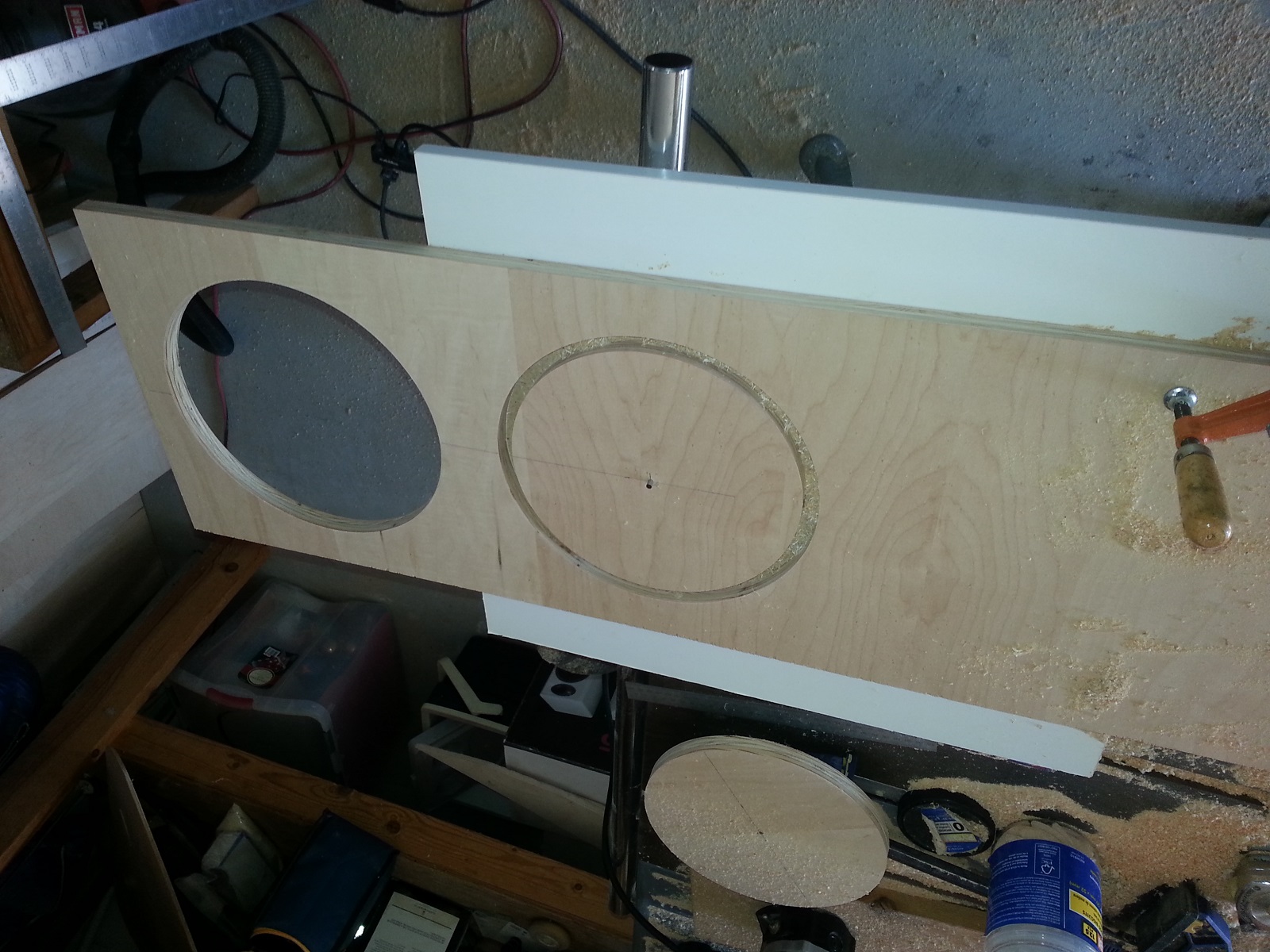

Ok onto the good stuff: progress update.

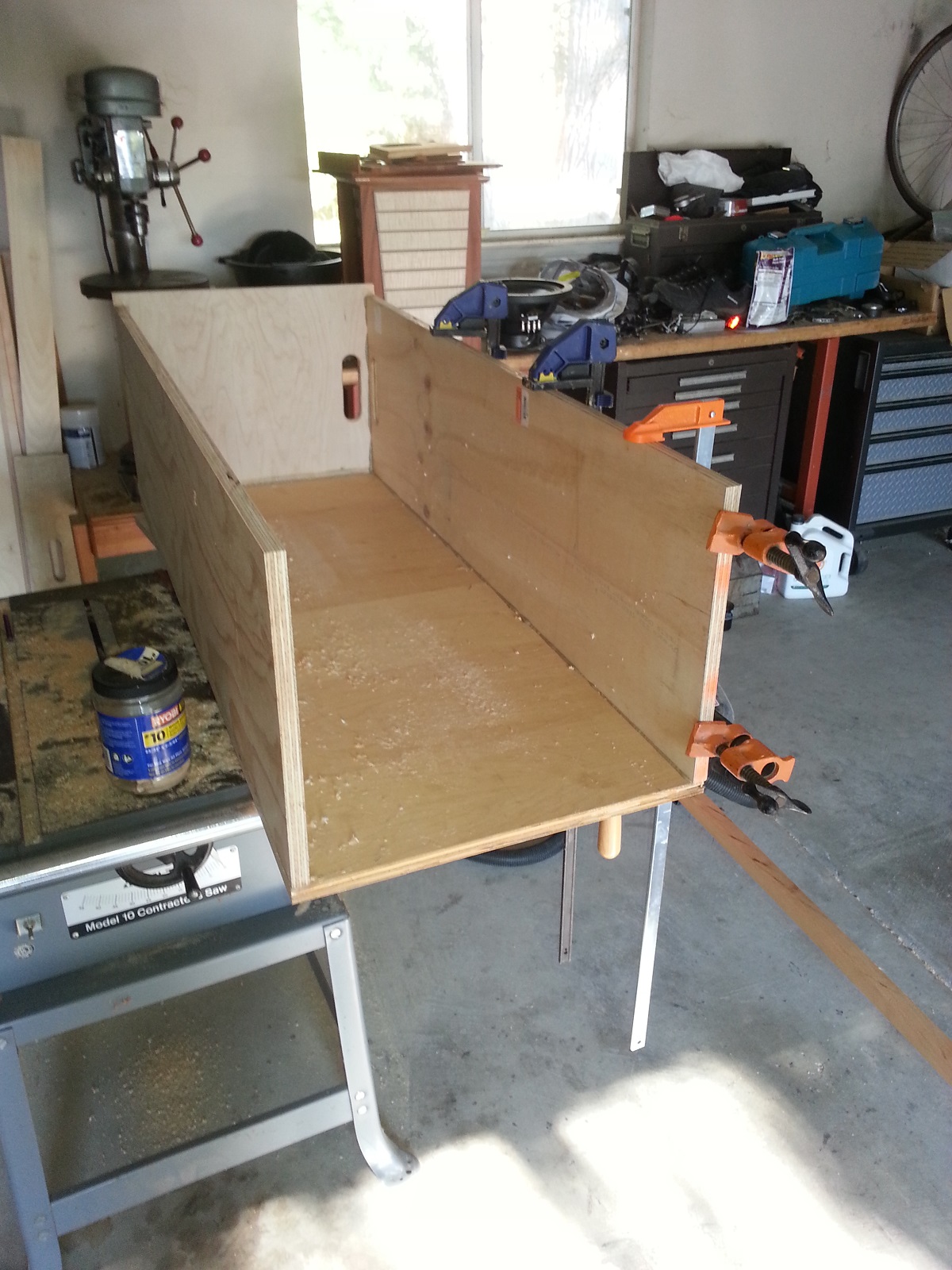

Flush cut the sides to the height of my other pieces of wood (47 7/8 for all 4 sides now)
2 Glue joints done (see pics) and baffle holes cut + t-nuts in. Expecting to do corner reflectors where you see handles in the pictures and in the bottom corner for speakon connectors with (lucky i kept it around) previous speaker port material that is pre-cut to 45's and the perfect size, lucky me right?
You can see said 45 degree cut port material -- reflector material -- in the back of some of these pictures with the other spare wood.
Anyways you can tell I'm excited and it is partly due to the fact that I have access to many more clamps so these first two glue-ups (all of mine use biscuit joints) have been a breeze. Yes I am using PL premium, I am happy to say that there are 0 possible airleaks so far, you can tell I like my joints square and airtight?
The sketch for the 8th order Transflex shown in post #689 was a multi-fold, but it can be done as a single fold too, it just creates a cabinet with very tall & skinny aspect ratio and very small footprint so that could be desirable in some scenarios ... Only a single access panel is required as long as you run the wire internally before gluing the last parts of the box together, which is common practice anyhow with traditional designs...
I would like to be able to eliminate the need for an access panel altogether but it would require quite a large offset of the driver in the rear chamber to get it close to the mouth and i don't know if HR can sim that sort of thing (at least i haven't figured out how yet)

The sketch for the 8th order Transflex was a multi-fold, but it can be done as a single fold too, it just creates a cabinet with very tall & skinny aspect ratio and very small footprint so that could be desirable in some scenarios ... Only a single access panel is required as long as you run the wire internally before gluing the last parts of the box together, which is common practice anyhow with traditional designs...
but it would require quite a large offset of the driver in the rear chamber to get it close to the mouth and i don't know if HR can sim that sort of thing (at least i haven't figured out how yet)... Interchamber driver offset is actually one of the things i was going to ask David about ..

You and me both, probably finish the wood working this week, doing some tricky fine work here like routing out the end cap and some fine alignment, don't have second driver money until my first subs sell 🙁.

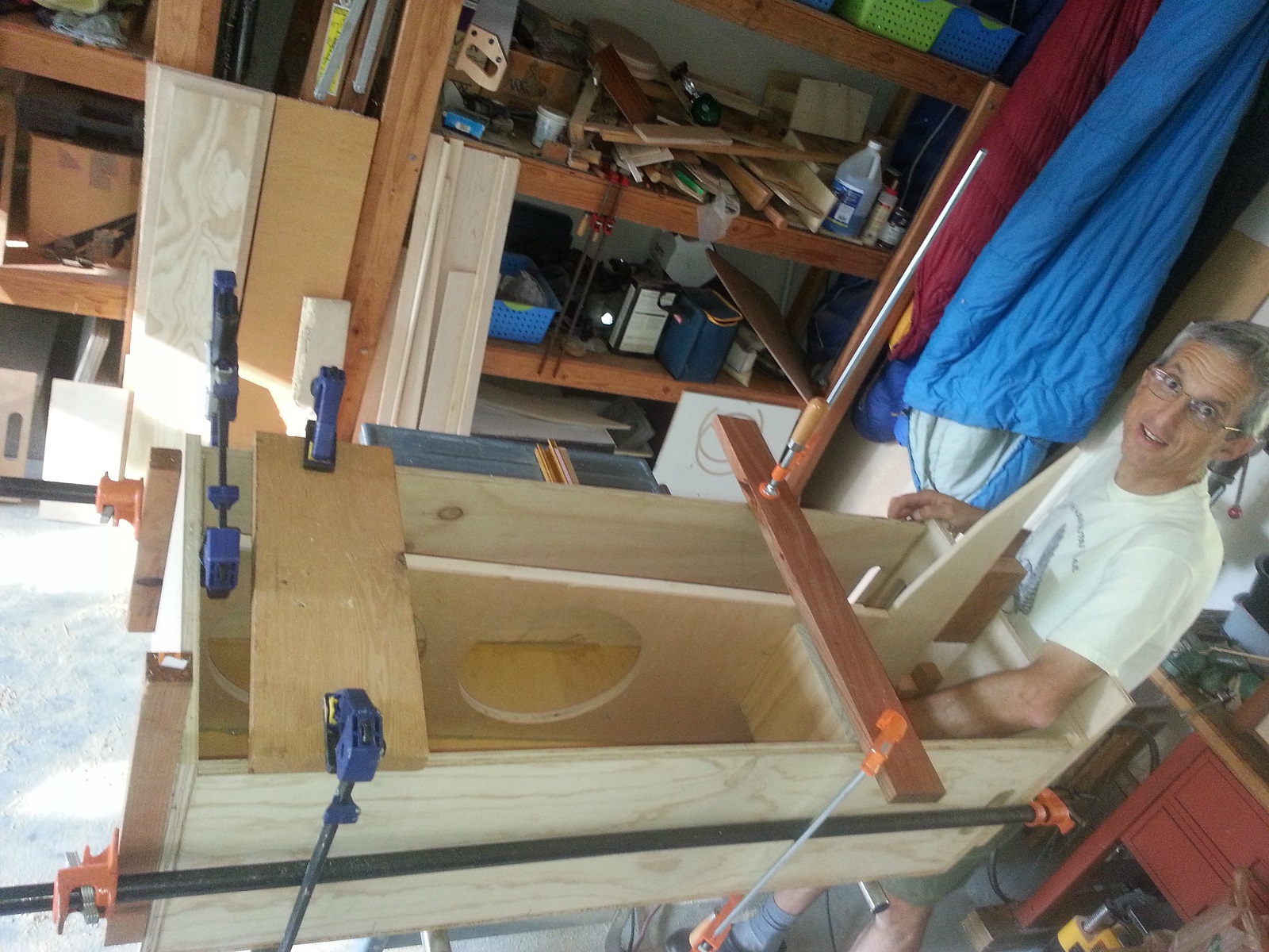

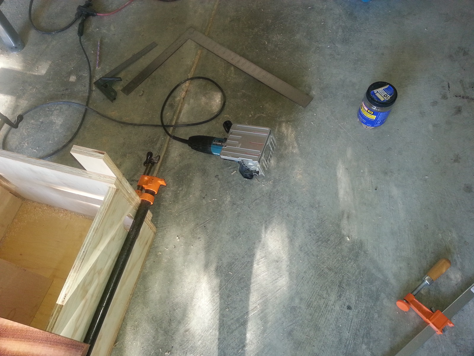

Status update: bottom and baffle are in. Before you scream at me and say well you screwed up because there is no hole in the bottom at the mouth I'll explain to you what I chose to do with that part. -> Instead of having an uneven base (just a piece connecting the front to the baffle and not having the rear side extend all the way down (limited to 48 inch material) I chose to make the bottom endcap out of a solid piece and route out the hole with a flush cut bit.
Look at all the jigs and clamps I'm using to make sure the baffle is square, at the correct angle, and 100% flush in every way! The spacing of the baffle is within a 1/16 of an inch in every direction of where it is modeled and has a constant expanding path of 8 -8 3/4 as it rounds the bend. The pictures will show some of the (many) biscuit joints I used for alignment and strength, there are roughly 2-4 per panel. This sucker is rock solid and I just used a router to flush cut the entire bottom end so the endcap sits flush with the sides (better than to 1/64th). My dad makes my workmanship go from airtight is good enough to cabinet grade only 🙂. Really helpful to have an extra set of hands and another mind to tackle issues like the endpiece.
First photo just shows the endcap going on, don't fret, the mouth hole will be jig sawed/routed after curing completes.
Middle picture, just a shot of the Makita that is a lifesaver for a number of reasons along with some of my dad's clamps.
You can see my dad in the last photo, he smiled immediately after but looks like i was quick on the trigger. AFAIK he enjoys helping me speaker build and it makes it much more enjoyable 🙂.
