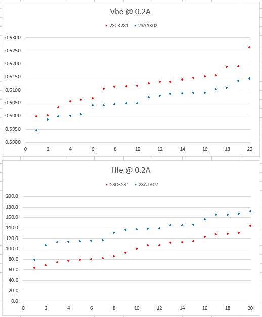

Thanks Zung so I took a similar approach as yours, so far I measured the Toshiba 2SA1986-R PNPs and got Hfe and Vbe curves at an average 601mA @ 36VE which is the Max Voltage my little Curve tracer can handle, and; out of a lot of 60 I got 2 groups of 11 matched to 3.91% Hfe and 0.4% Vbe between them and 5% Hfe and 0.6% Vbe across them. I think this would be good enough, not that I have more transistors anyway...
I will do the NPNs next...

Expect a lower yield matching P & N for Hfe.
Getting opposite sex to get along is more difficult. 🙂

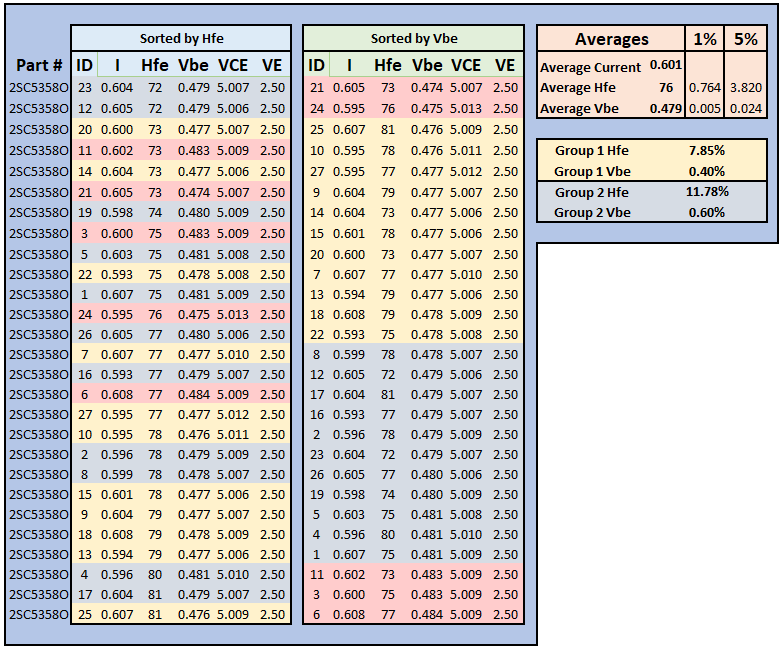

Yeap, as predicted I measured the Toshiba 2SC5358-O NPNs and got same curves at same average 601mA and again out of a lot of 60 I got 2 groups of 11 matched to a much higher 7.85% and 11.78% Hfe and similar 0.4% Vbe between them and 11.78% Hfe and 0.5% Vbe across them.
Definitely Hfe difference between PNP and NPN is big 102 vs 76 average but Vce is practically the same.
At Threshold we measured output transistors for current gain, choosing the higher ones for better performance. Betas of 80+ were chosen, and we found other uses for lower gain ones.
Thanks Mr. Pass, yes I basically choose the ones with highest Beta on the lot and then started removing the ones with the lowest Beta or that were very out of the bunch until I came up with the groups, unfortunately the NPNs I got are in the lowest side of their Range for the O classification.
But if I build another set of Output Boards I will definitely choose BJTs with higher Beta.

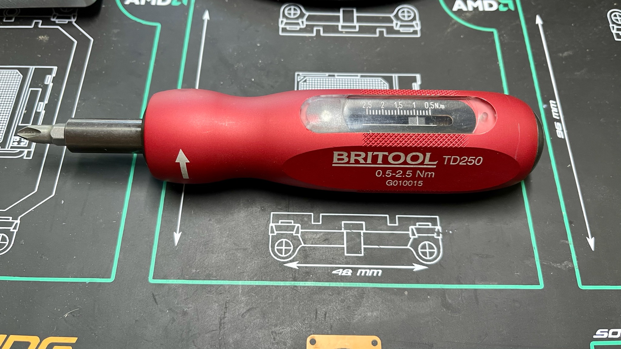

Trying to finish the Boards and mount them on the heathsinks today, while choosing the washer I found something interesting, see the picture so I’m debating between 16mm and 20mm, what do you think?
They were all tightened up to 9nm.
Adding a second picture, in this one you can see the damage that the pads took with the different washers, clearly the biggest the washer the least the damage.
