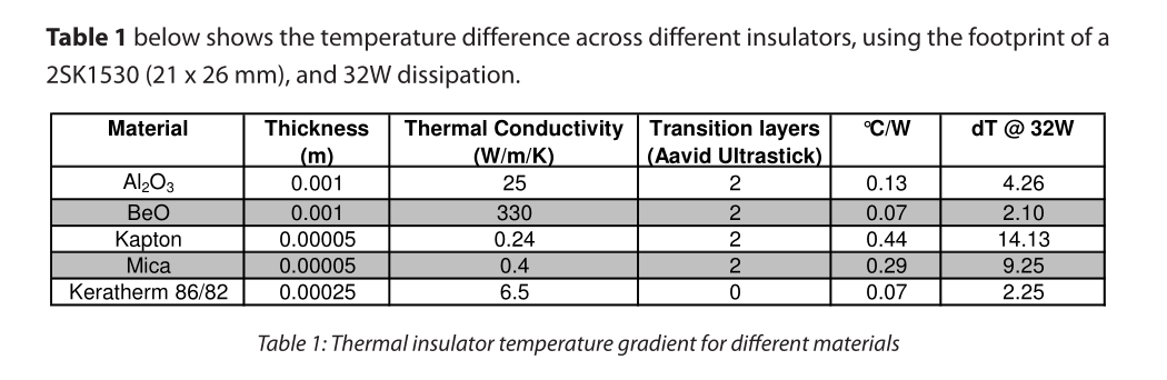

... costs nearly as much as the power transistors. Any other alternatives?
Zung,
By cutting them myself I save a ton, I paid $25 USD for a 210x148x0.25mm sheet that when cut I get from 58 to 72 TO-3P sized pads so that's cheaper, attached are the cut list options if anyone is interested.

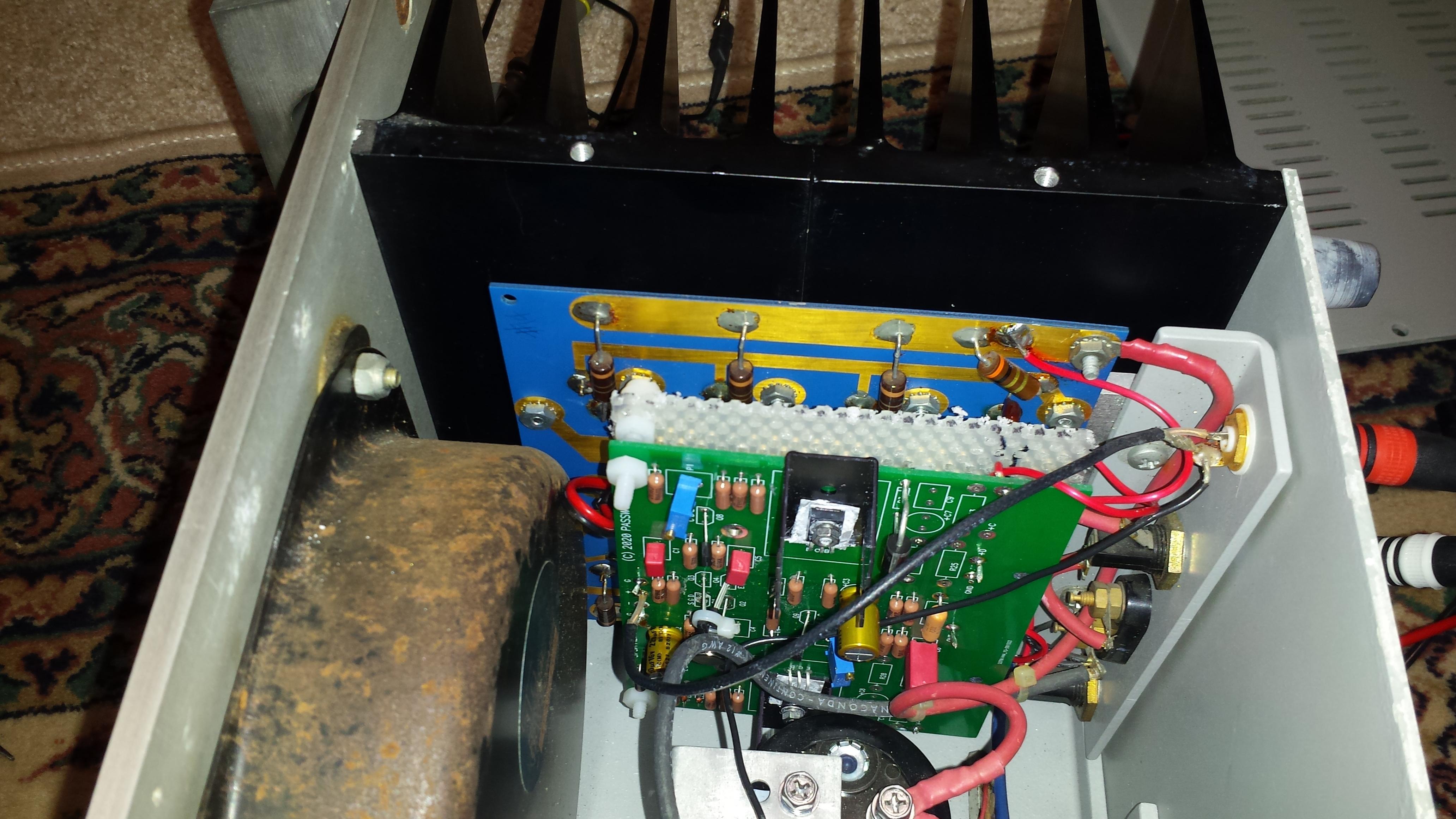

FE board in and tested
Finally finished one side of the s150. did some preliminary testing with no load (looked very clean in the scope.) Bias and dc offset was very sensitive even that I used a 25 turn pot. Bias were adjusted to about 160 mv cold. After one hour they were at 300 mv and the heatsink was at 45 degrees. Will do further tunning and finish the other channel.
thermistor on heatsink?
top lid closed ?
Yes, t is embed in a hold inside the heat sink (stock original from the Treshold amp). Thermistor is in the surface of the os board touching the bold that holds the board to the heatsink.
Top lid semiclosed just resting in the top of the amp as i have the meter cables hook the emiter in order to take the readings.
Any suggestion?

I believe Pa made it in same manner as ole Treshold amps, regarding biasing

FE boards in, preliminary audition
Got everything square out. Critical and final dc offset and bias still to be performed. Im to desperate wanted to listen to some tunes. But here it is bias adjusted to final temp of 42/43 degrees. Dc offset both channel to -5 mv. More critical adjustment can be done but need more patient.
Preliminary listing, harshness is gone (previously I have equalized the speakers to tolerate the harshness). Soundstage is more and I mean much larger (Horizontal). Deep also improved, more 3d. OOOO the mid are sweet!!!!! It brougth tears to my eyes, wanted to hear more and more of my music collection. But fine tuning needs to be done.
However, I cant compare to a good working s150 since my was not working properly. I dont know but the new FE it is worth the effort.
I will like to thanks all does that help me throughout this little project, (special to ZM) Thanks!!!!

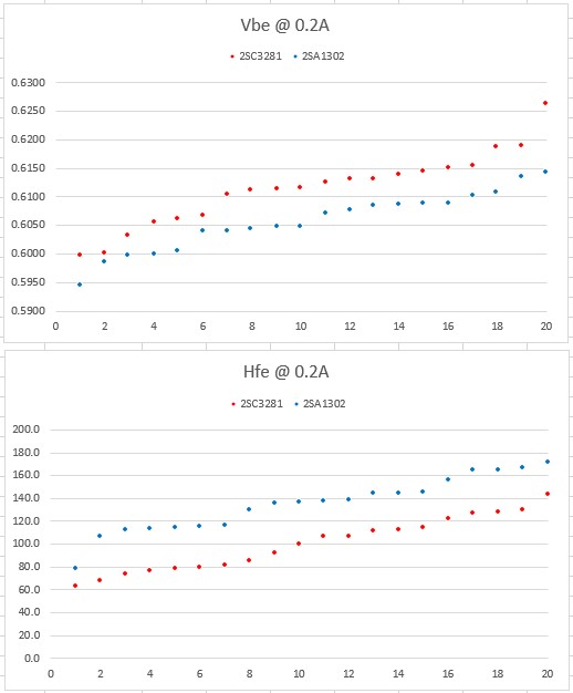

Slightly different topic: while shopping for output transistors, I bump into some "Used Old Stock" Toshiba 2SA1302/2SC3281 for a buck a piece that measure quite nicely.
