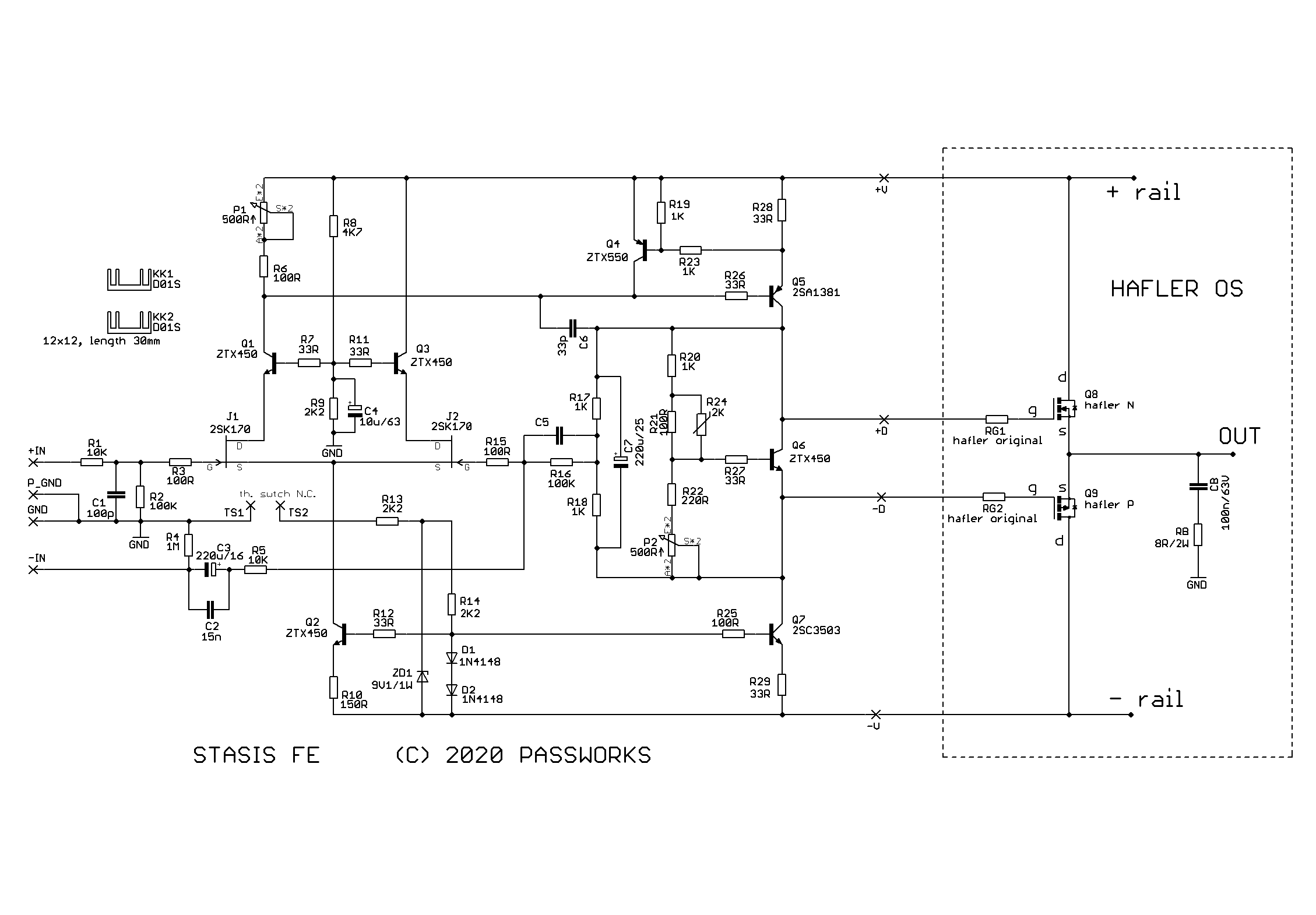

The switch T. I saw the answer that it is a Thermostat, but could someone point me on Mouser what one of these looks like please?
Also, I was confused about the TH1 being either a NTC or PTC, which one is it supposed to be? I assume like the one in the F5T which needs to rest on the heatsink. Again, I would be very grateful if someone could point me at a Mouser part please.

take care that here is "small signal" NTC, not inrush current limiter

here it is
little creativity with wiring (rails first to mosfet cases with fat wires, then tiny wires to FE), it is as this (attached pic)
few things worth trying :
- moving NFB takeout point from R17/R18 node , to output ...... maybe that would squeeze some more damping factor from puny verticals
-NTC could stay mounted on pcb, counting on friendly TempCo of puny verticals
usual disclaimer - blame Pa for everything, which includes each and every stupidity I make in public

I would rather check for NTC of 2K, than 4R7
just in case ........
in case you can't get Iq of your choice (without source resistors either observe at R in CRC PSU filter, or with DC current clamp ditto on rail wire to drain) , just increase R20 to some bigger standard value
ref. to schm in post #670, say that 1K2 for R20 should give 4V47 , while original (1K) value should give 3V88 between mosfet gates
loading of FE with OS shouldn't change much, or anything

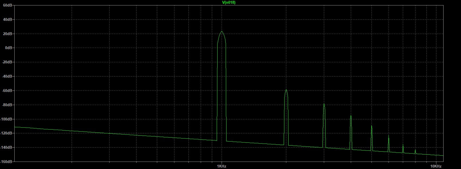

A remarquable FE it is: THD is <0.0006% with a resistive load from infinity down to 2K, with a beautiful harmonic spectrum. Adding 1nF in parallel with the load doesn't change the THD value, but the odd harmonics are a bit higher. At 1K load the protection kicks in.
Of course this is from LTspice; but even if it were an order of magnitude worse in real life, I'd still be happy.
