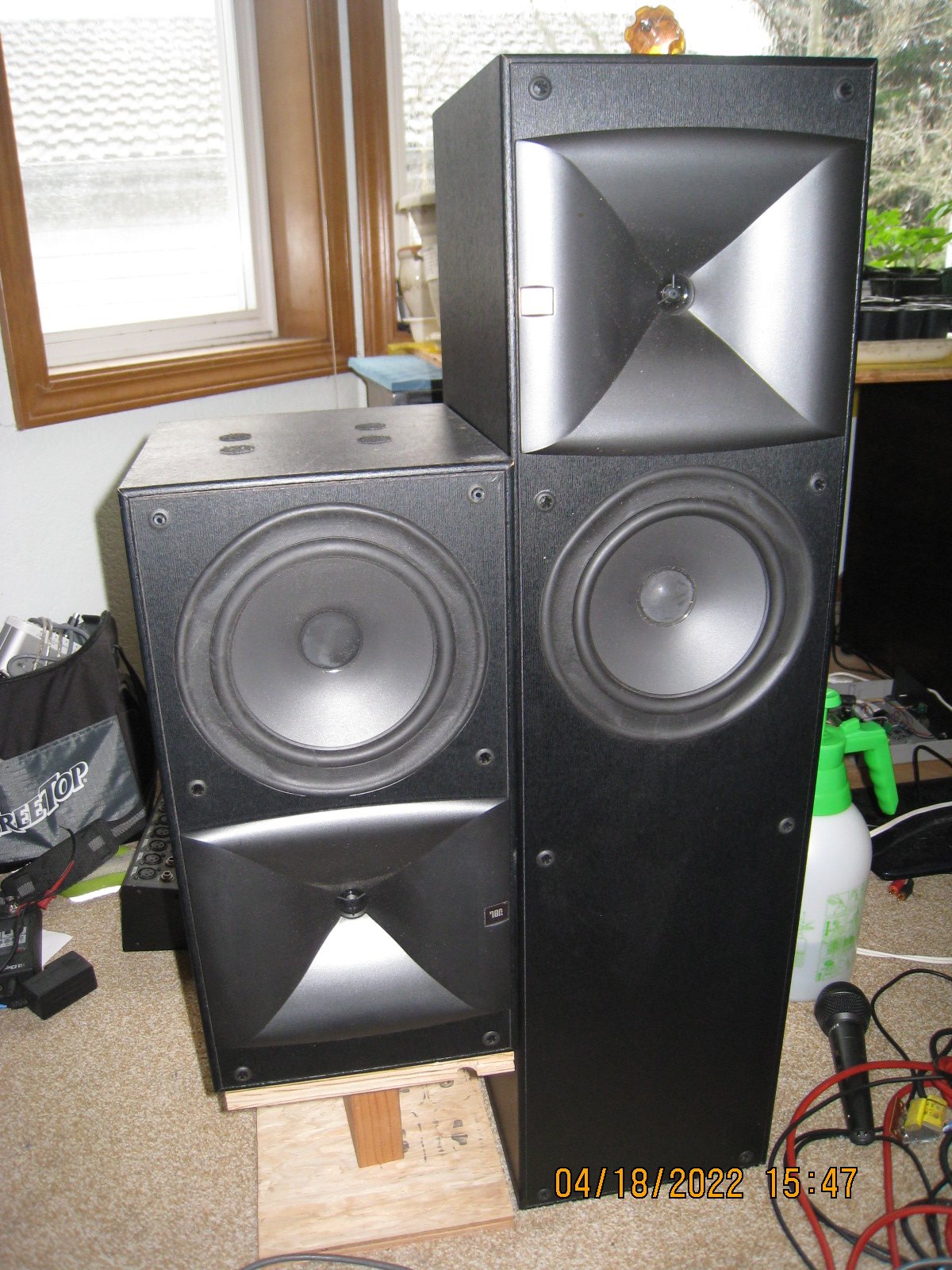

I'm experimenting right now with trying to recreate the Polks "SDA" effect, using two sets of speakers placed adjacent to one another.and violins to give up the SBA tweeter just to get a bigger sound stage. That’s not a tradeoff I’m interested in making.
Short story; it works, but I knew that; I just wanted to see (it's been 25-30 years since I owned a pair of real SDAs...) for myself. The tweeter on the "SDA" pair is actually disconnected and only the woofer and its low-pass crossover is contributing to the effect.
Being boxes placed adjacent means I can slide the SDA pair forward / back, which changes the time alignment and effects the imaging sweet spot, relative to the arbitrary distance from the speakers to where I'm sitting.
It's pretty much the same as the Carver Sonic Hologram box I mentioned at the beginning. Some recordings the instruments are far and away from the outside edge of the main speakers and certainly not confined to the area between them. Overall sounds pretty nice.
Setup is "taking candy from a baby" easy to do.
