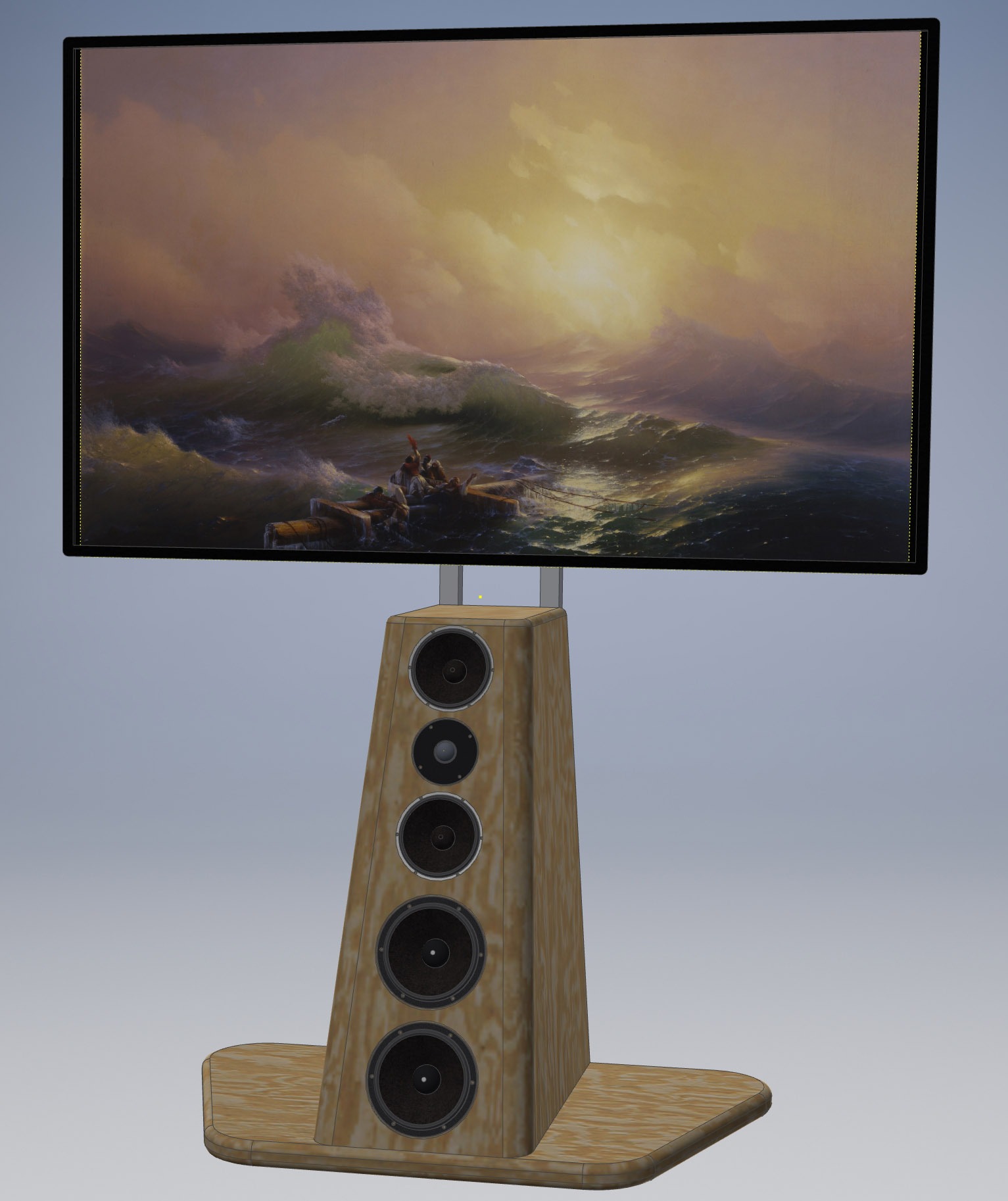

thanks mate. cool looking speakers. sometimes having a table is a good thing as it adds body (100-400hz bump) to the music hahah
IME, for better acoustics, symmetry and same type of acoustics diffuser and absorber (if using any) is critical.
Yes, I hope to make a couple of acoustic diffusers some day. I have this idea to make a narrow more vertical center channel speaker that functions as a TV stand and then apply some kind of acoustic treatment to the sides. Something kind of like this. The lower walls near the right hand speaker could sure use something. And maybe a rug on the floor. But I hate rugs.
