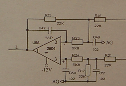

hi Kevin,
Are your mods referencing to this schematic?
http://img153.imageshack.us/img153/9063/dsc6604.jpg
thanks,
Piersma
Yes, that's right. It doesn't match what's on my board, for the final stage, at least.
Kevin

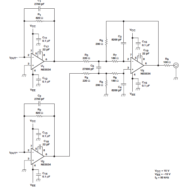

You don’t need to put resistors on the output to improve the sound. Better is to put + -15 vol analog power supply.
When using originally + -12 Vol the Op Amp. U11 and U12 saturate when the DAC signal is above -10 dB. In that case replace 820 Oh. resistor by a 300 Oh. or put 470 Oh. in parallel with R29 and R30 R28 R27. A important reduction of even and odd harmonic distortion. Best S/N + -15 Vol.
There is a slight improvement if replace U11 and U12 (two AD827) for two OPA2134. And also a slight improvement by replacing U9 (AD827) for OPA2406.

my DAC-board has the same part-values, which are totally different from those mentioned in their own schematic.Just looked in more detail at mine and it's worse than I thought. All resistors in the output filter apart from R15 and R18 were 1k ohms on mine. R15 and R18 are 1k5 (meaning there's a large DC offset at the output).

15 vol is recommended in the Burr Brown aplication note. Would have to change the transformer and regulators to 7815 and 7915 instead of 7812 and 7912.
Firts I'm seeing if we can up the voltage because I dont know if the electrolyte capacitors have 15 V. I think it's best to put new capacitors.
With the OPA2604 OPA 2124 could up to 18 V. even better, ¡¡no AD827!! ¿Value R I/V circuit?
You can get a high-end DAC with 2 x GigaWorks DAC 3xOPA2604 power suply + -24 Vol.
Mono. Balanced output. It's easy to put Mono and balanced.

How to calculate optimal V and R do not know. I have insufficient data or graphs. Distortion, noise and maximum (0 dB DAC, 4 mA) to the operational output depends: R in V / R, output, power suply, temperature, etc. .. But it is easy measuring.
Manufacturer recommends: 15 820 Oh. Vol. (Vs = 3.28 = 0.004 X820)
Tests good for the 3 measured Op. Amp. 12 Vol 300 Oh. (Vs = 1.2 x300 = 0.004).
Example: (LME49720 for me optimal 15 vol. 500 Oh. (Vs = 2 = 0,004 x500).
Op Amp Data all have many graphs specifications:
Graphic LME49710 similar LME49720 to be understood the example.
Choose the maximum output voltage before clipping begin. Where the Op Amp is linear. Remember we want to High End Sound.
