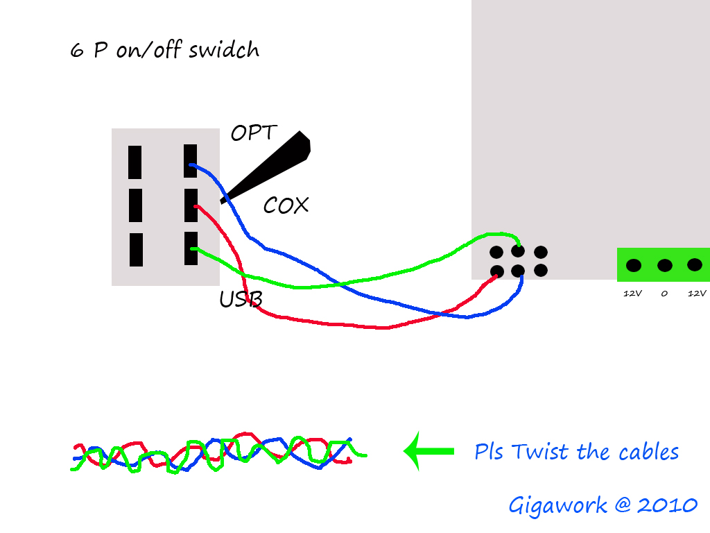

Just got a gigawork up and running. It works when feeding a signal through the coaxial input but I am not having luck with the USB Port. CAN ANYONE HELP ME. Does those switches need to be changed that are on the cs4398 dac board to get sound out of the USB port????????? HELP WOULD BE APPRECIATED. Thank you in advance.
No, you don't need to change the switches on the CS4398 board. You do need to change the digital input selection jumpers though. The are on the corner of the board by the AC power inputs.
I haven't had any trouble getting USB audio to work.
I have to say and am a little embarrassed that right now, I can not find that disc. Darn it. You don't suppose you could let me know where to put those jumpers to make the usb work, there are 6 pins and or jumper positions. I would count from the back of the board closest to the pins. Once again I want to thank everyone for their help. I have got to find that disc that would make this easy.
Mine didn't even come with the disc. The jumper positions are silk screened on the board though, so it's not too difficult to figure out.
There are really only two jumper positions that are used. There are some pull-down resistors on the bottom of the board that pull SDA SDB to 0 when you remove the jumpers.
Orient the board so the power supply section is on your right and input/output section is on your left. Now looking at the jumpers, the bottom left vertical pair needs jumpered for USB. Remove that jumper and place it on the right hand vertical pair for OPT. Remove all jumpers for COAX.
If you still have trouble, I will take a picture for you later.
Try this switch circuit, better than fiddling with jumpers.
