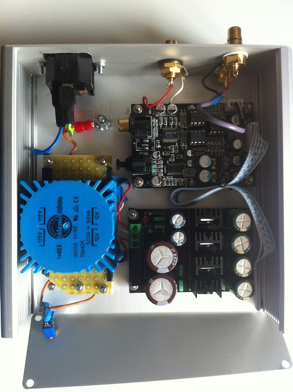

I am a happy user of this kit (see mine in the attached picture). I modified the original kit by changing the original AD op-amps with LM4562. The only singular behavior, compared with the other dac I have (DAC 707 Superpro), is the higher output level of signal also reported by other people in this thread. I am using the coaxial PSDIF input connected asyncrhonous to a Mac via a M2tech usb interface.
However, since I switched to a chip amp I noted that the chip-amp was getting very warm even without playing music (not with the other dac or CD player I have). Then I measured at the new Gigawork dac 750mV DC at signal out when the dac is connected to the Mac on both channels. If the dac is disconnected from the Mac I measure 2mV.
Connected to the Mac, the Superpro dac gives 9mV out.
I can hear a very high hum noise from the speakers when the amp volume is at maximum level.
Is there something wrong?
Thank you for your feedback
Renato

Sounds very good if you rebuild the analogic part on a separate (new) board. The included I\U and buffer are built with wrong components and is almost imposible to change the smd resistors/capacitors.
board resistor components!
I have to agree with Atupi, i own 2 of these DAC boards and both of them have components around the I/V an buffer stage with incorrect component values!
In my case even the two boards have both wrong component values but there are also differences between the two boards.
I use a seperate I/V stage to overcome these problems.
with reference to my post #245, I solved my problem by inserting an AC couplig cap at output (my amplifier is a DC coupled chipamp). Unlikely, I did not believe how much important was the influence of a cap on the audio signal: the cap added a veil to the music.
There is not sufficient space in the chassis to put a polypropilene cap, so I used a an electrolytic 4.7microF/35V Rubycon ZA.
Have you a suggestion for a better choice (forgetting BG N that I cannot find)?
Thank you
Renato
