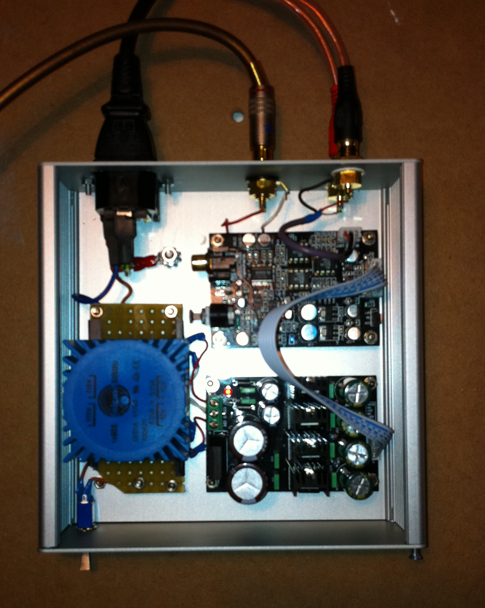

Bad ground?
I've got some wonderfull sound coming out of this unit, still using stock op amp but changed lots of the capacitors.
However...
Whenever I change the volume control (stepped attenuator on a Audible illusions pre-amp) there is a thump coming thru the speakers at each detente.
It also happens when I change the selector switch to CD or from CD.
The thump is not loud, but is unaffected by volume control position.
Using the dac with a recently made shigaclone
Thanks,
Paul

Did you run any of the suggested tests to figure out if your problem is related to grounding? Connected the ground of all your devices together? Got the option of running optical?I've got some wonderfull sound coming out of this unit, still using stock op amp but changed lots of the capacitors.
However...
It's possible the ground of the DAC and pre-amp are at different levels and that thump is your speakers jumping from one DC level to another.
I am using the stock power supply. This isn't grounded. Should I connect a ground wire from the ground lug (phono) on the preamp to a ground spot on the curcuit board of the DAC?
DAC and Shigaclone are mounted together on a granite slab with wood cover. So I didn't do any grounding to either. They are both two prong polarized plugs.
