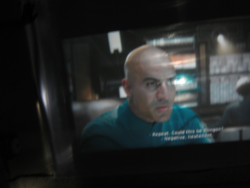

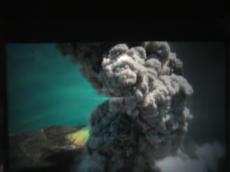

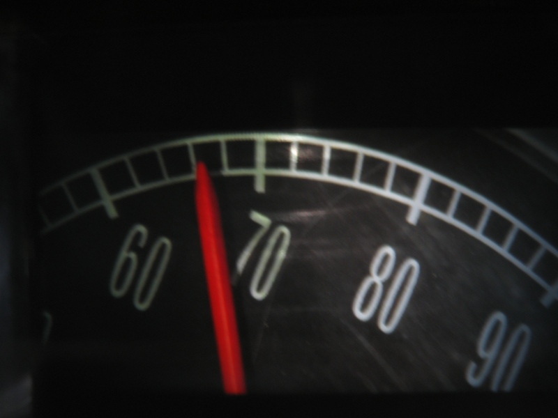

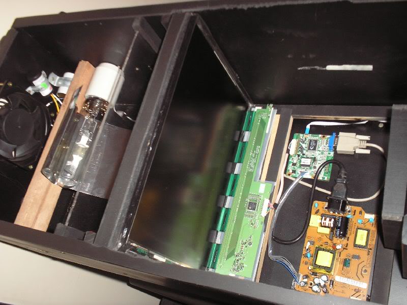

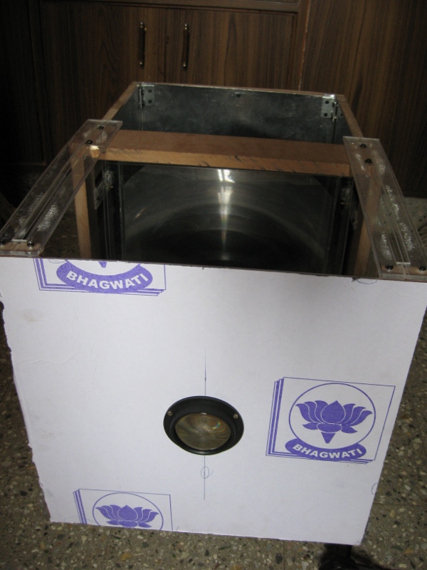

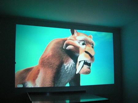

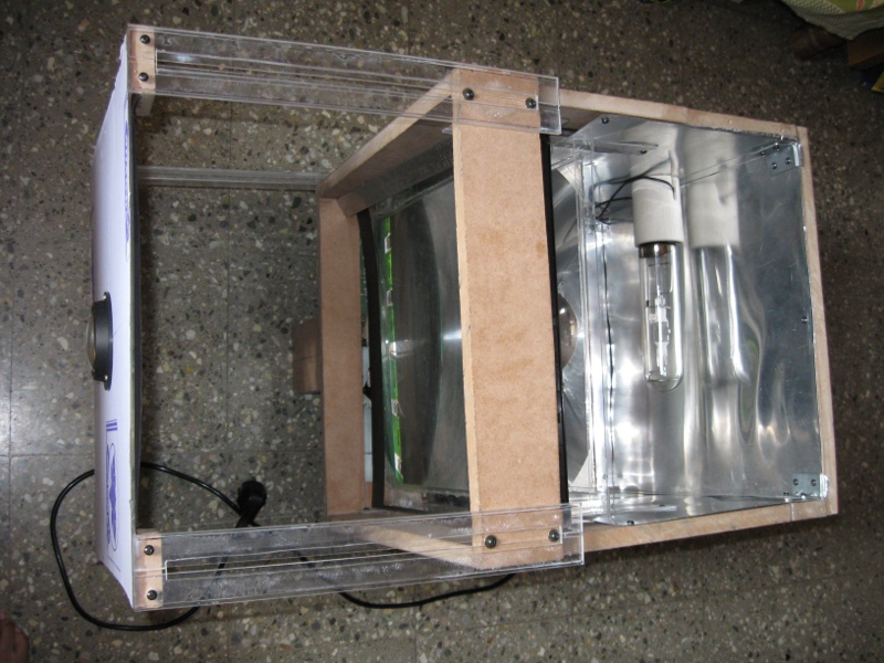

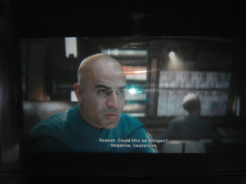

Hi all, I just powered my projector yesterday. and got some decent results still some tweaking is going on. the brightness ok. but very poor at the corners. same with the focus. its better at the center and very bad at the corners. but it didn't affect while watching movies. Here are a few pics i managed to capture.
Thanks, but there's still alot of tweaking to be done and i'm not happy with the focus and brightness. u can have look at it when u have time i stay near Mekhri Circle. may be u'll get better ideas.Nice buddy... congrats...Very innovative design
Since i'm using 17" panel i'm thinking of upgrading to bigger fresnels and a lumenlab pro triplet sometime in the future. but before that i want to do all the experimentation with this one.
So if anyone is interested in importing bigger fresnel lens and triplet, pl let me know so that way we can share some shipping cost.

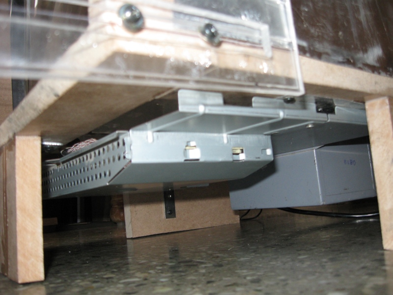

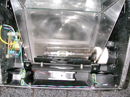

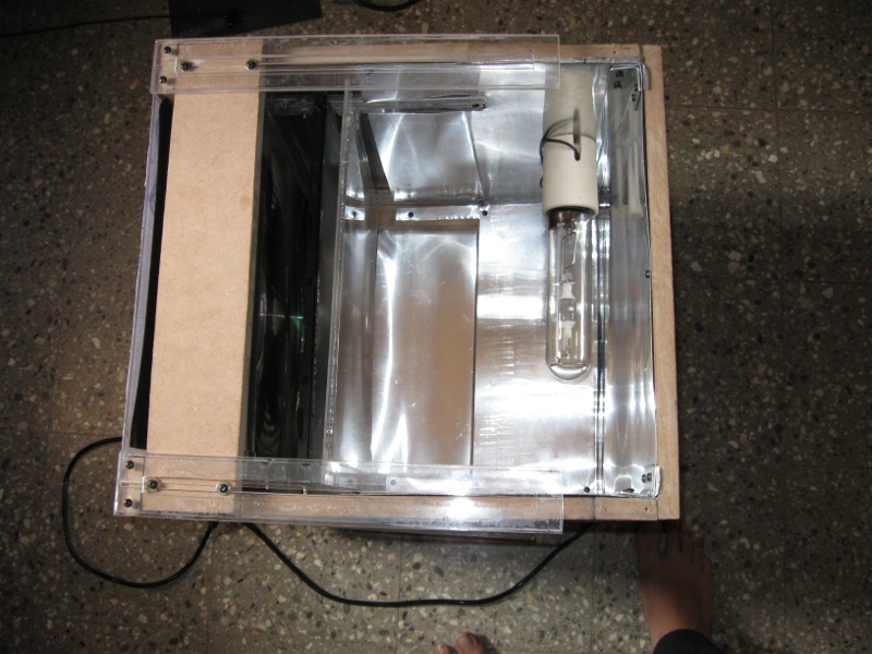

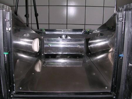

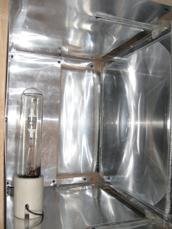

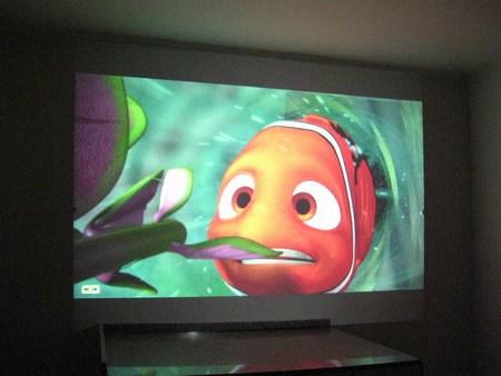

Don't worry much friends. Brightness is certainly an issue without a reflector. Try any damn reflector or i have noticed that guys who have tried putting a semi cylinder shaped reflector behind the lamp have got better image then the spherical ones.Trust me adding a reflector will double your pleasure.
I am attaching more images to illustrate my point.
Wow those are very nice pictures... ru using a 400W or a 250W MH bulb? Also how big is that projection on the pictures?
