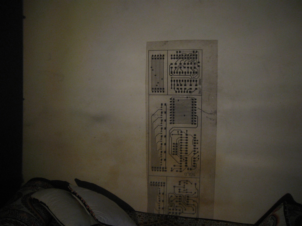

hey guys,
i am back as you people know that i have already made a projector but i am not satisfy with my projector because lot of consuption of electricity last month my electricity bill is about Rs.12000/- i am using osram MH 400watt. but now in this forum some of people are talking about LED. I want know about LED BULB every thing. any one in this forum help me ?

I'm yet to start building the box. I'm planning to start this weekend. I have all the part required except the triplet. I'm using a 17" samsung lcd donated by my cousin. can you give details about the triplet u got from optics allied? how much did u pay?
The fresnels from lensel is good. but will get a better idea when i use them with the lcd panel.

Also i'm attaching a pic of the projection i got last week with a 60W bulb and transparency.

With 60W incandescent bulb the result is OK type. I think 150W-200W MH will make a good PJ with lesser power consumption. what do you say? Also did you ever try with LED array?
This is a great thing that you have found out.Really if it is not costly, we can go for it.
The 60 W bulb had a very good contrast ratio as u can see. I tried with fluorescent lamp but the contrast as very bad. This is because CFLs are not point sources. I dont have an LED array so haven't tried that. If we have access to led array we can give it a try. Basically it should be a matrix of focused leds with a beam angle of 5-10 degrees. and the back fresnel is not required. The problem with it as of now is high intensity leds are expensive and do not produce a parallel beam of rays behind the lcd as well as a MH lamp and fresnel. Hence the they are not widely used as of now. how ever i did find post on lumenlab, someone from china had used an led array and got quite good results. I'll post the link here if i find it.
Also remember the transparency i used is nearly 90% transparent. where as the lcd is only 5-10% transparent. So i suspect the final result with MH lamp and LCD would only be as good as or slightly better than the transparency.
