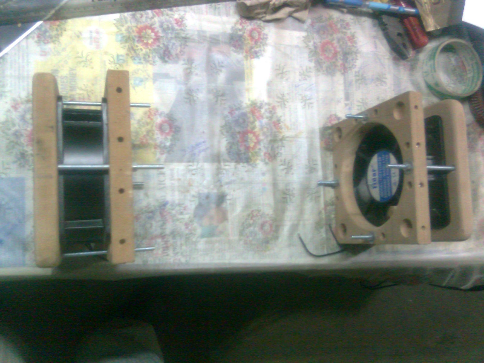

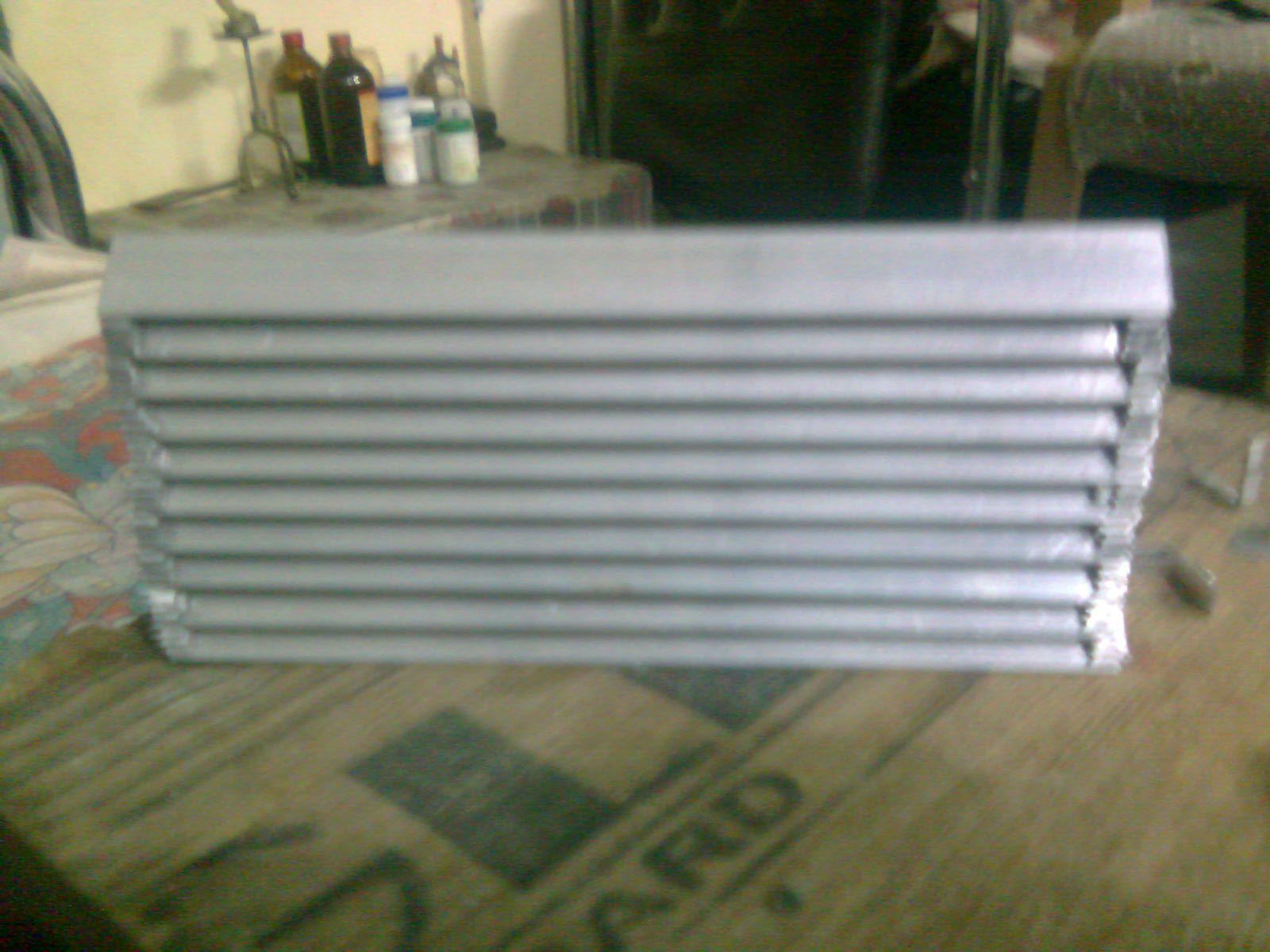

Yea i've seen this design from drtsolutions.com but i feel this is possible only if the lcd is a small one. The one in the image is about 7" i think. but mine is a 17" lcd also we'd have search for front surface mirrors.ya then we can go for it...One more thing...you can have a separate enclosure with fans and heatsinks installed esp for the bulb...this way you can reduce the size of the projector...
or we can go for a mirror (reflection) based projector in which the lower compartment contains the bulb and other electical circuitary and the upper portion contains the lens setup....see the attached image

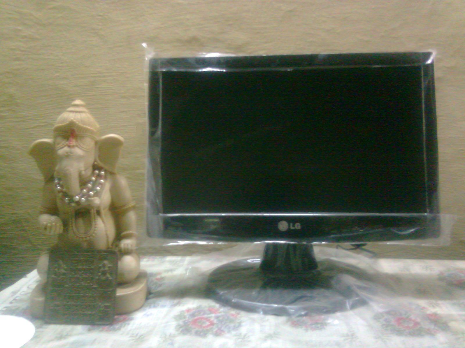

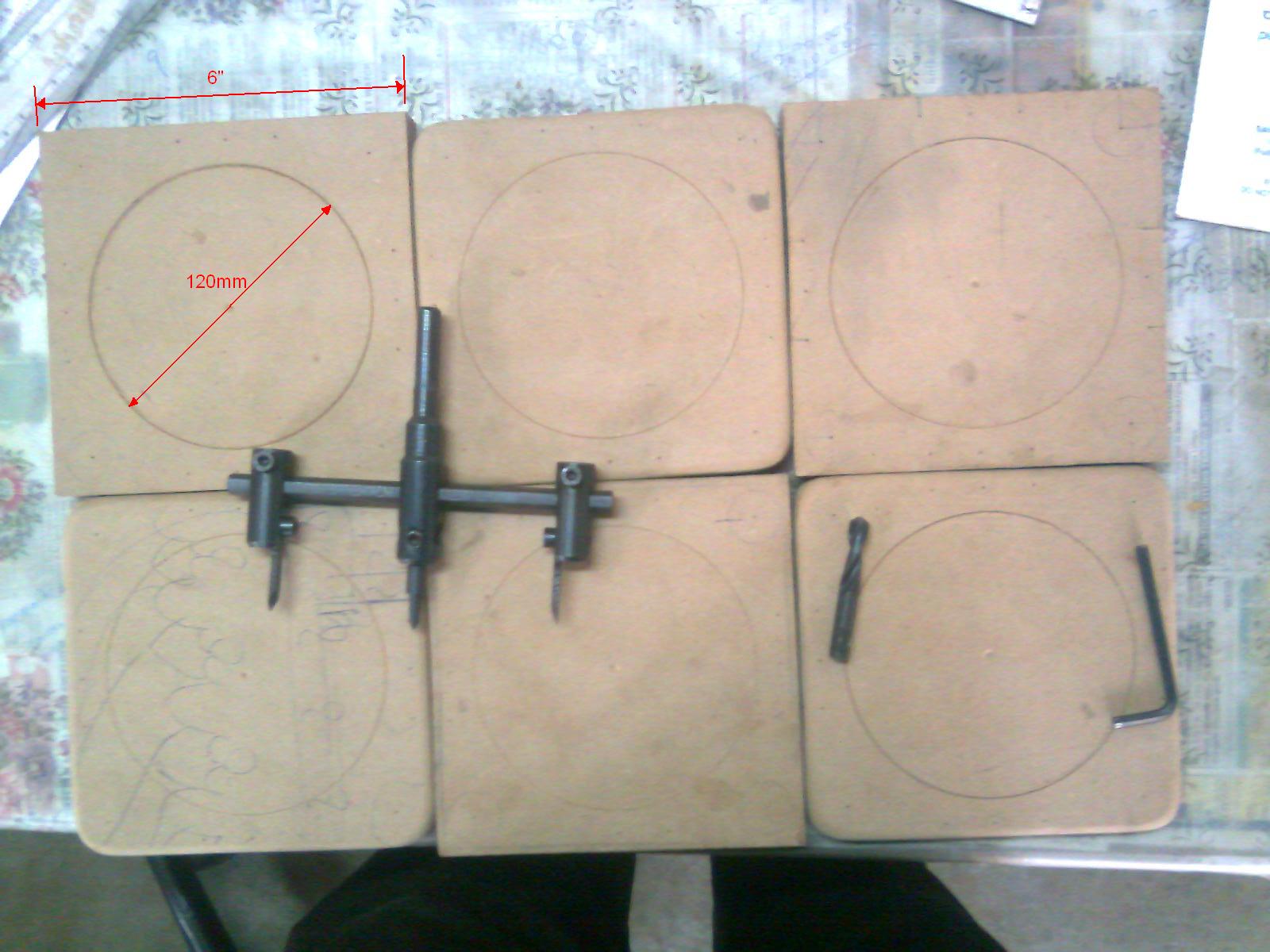

I am also making a pj using
1. 15.6" LG lcd Model No. W1643c
2. 400 watt osram metal halide lamp
3. 74mm dia reflector.
4. 74mm dia condensor lens focal length 200mm.
5. 450mm focal length Quad element lens
now searching for the fresnel lenses 500mm & 220mm

Thanks again bishnu. just received a quotation from lensel. it says 1103 for the 2 fls 310x310mm fresnels.
Just one more query, what monitor have u guys got ?? I am unable to get a decent one here. if someone can share model names/number ect that will be great. I tried those car roof mounts/head rests as well as proper computer monitors here..monitors seem too big and the car ones seem too small !! i am getting fresnels 310x310 since I don plan to import bigger ones !
Infact, I have also ordered the same size lenses from Lensel.I havn't bought any monitors till now....Most probably I will go for a chinese made 9.5 inch LCD TV(around 4500 here)...the reason being...15 inch new LCD monitor+TV tuner card will cost me aroungd 5.5K...
