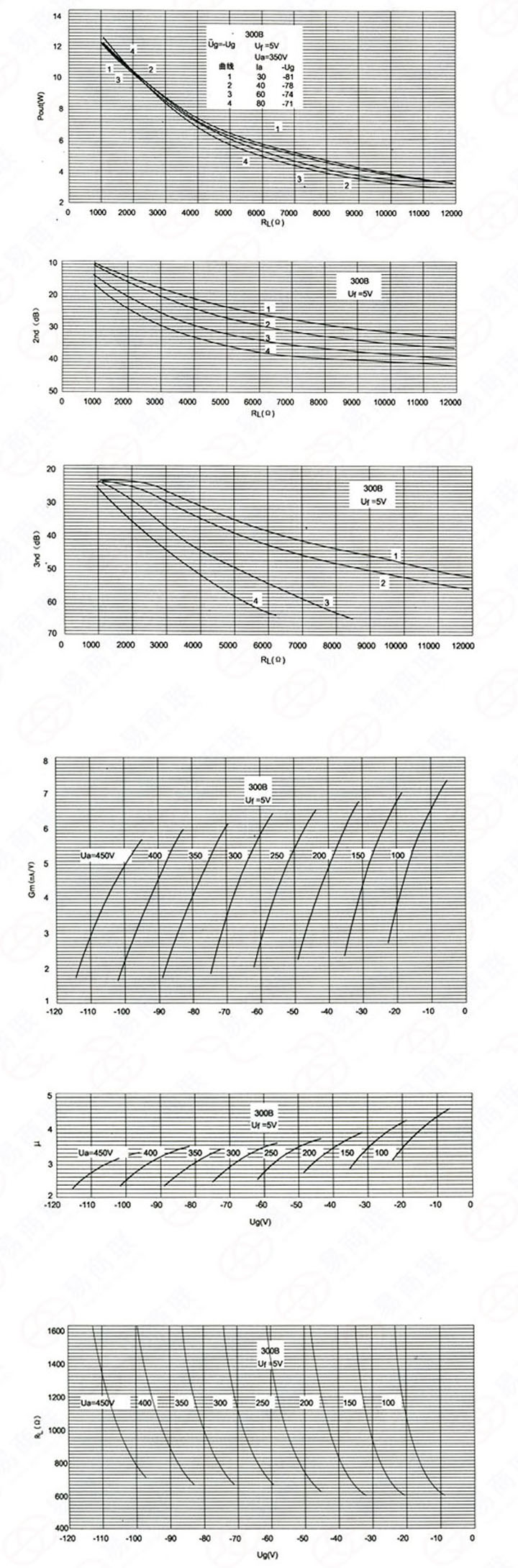

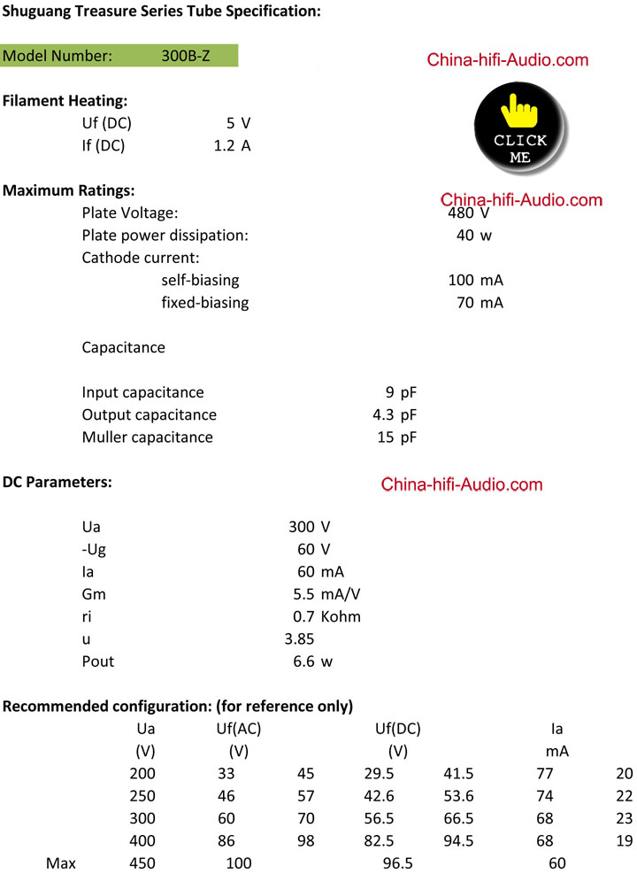

First time I have come over papers about my Shuguang Treasure 300b-Z tubes was now in the weekend searching the internet and since I have no clue at all how to interpret those papers, maybe I could get some professional help understanding what they say.
shuguang treasure tube spec 300B-Z-vacuum tube-0010.jpg shuguang treasure tube spec 300B-Z-vacuum tube-008.jpg

The B+ should be 400 V not 410 V. I doubt that makes a dramatic difference, but it could impact your ability to adjust to the correct bias point. I'm able to get down near 55-60 mA in my builds and consider that plenty of margin for an 85 mA target. I use JJ tubes.
The Shugang tube data sheet says "70 mA max for fixed bias", so stay below 70 mA. I would dial the B+ down as far as it goes and set the tube at 65 mA to start. That won't give you much output power, but you should at least get 4-5 W before clipping. I would expect it to sound good at low volume settings.
Many bias the 300B at 360 V, 60 mA for a low power option. I'd do that for older 300B tubes. The more modern ones can handle higher voltages.

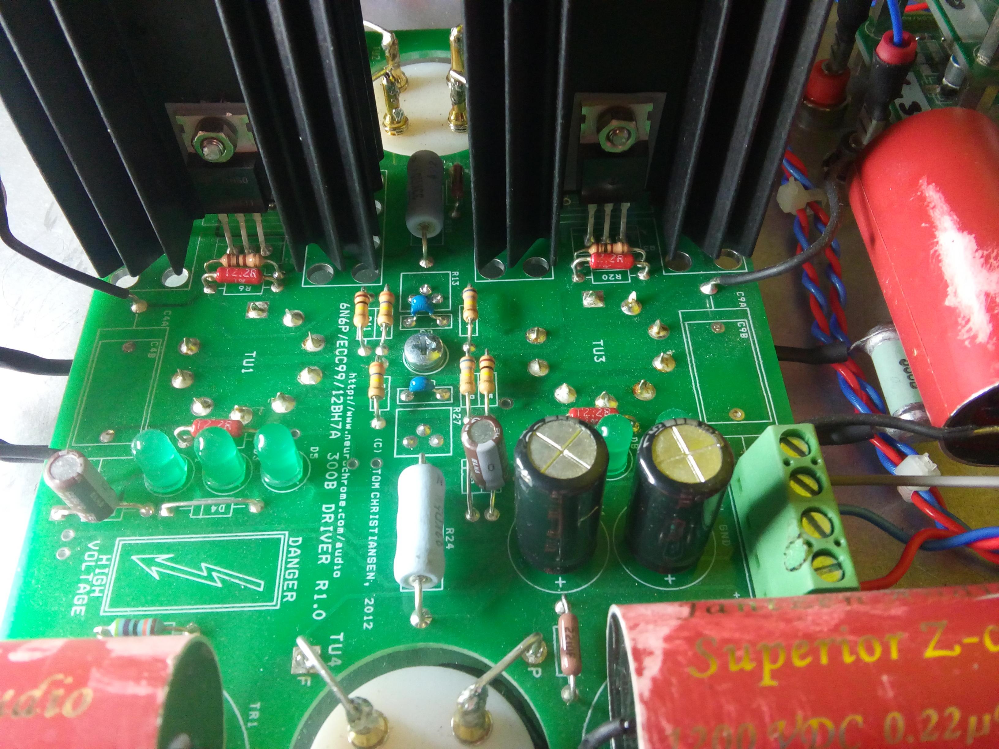

Since I have picked up a some info here on the forum about being thorough and careful when it come to high voltage I did some preparing by sharpening the points on my DMM and I also applied some shrink tube on them to be on the safe side.
Ok, after some little pause with my Damn Good 300B I have finally been making the asked measuring.
R8 and R22 are 470 kOhms, Check
Pin 8 is measuring 6.33 Volts
Pin 3 is measuring -74.8 Volts
Pin 6 is measuring 168.8 and 170.4 Volts
So far, so good but, and here come the big but(t)
Pin1 is measuring -4.85 Volts.....???:eek::eek:
well only 90 volts wrong in the wrong direction so what now....???:confused:
By the way Tom, you have mail with some extra pictures
Those are all normal.
In your email you mentioned that R17 (100 Ω) measures 100 Ω. Good. Do you have 90-91 V on each end of R17? If not, your issue is around D11, R29, and D12.
If you do have 90-91 V on each end of R17, measure the drain voltage on Q3. That's the centre pin (which is also connected to the metal back of the device). Be very careful here as a probe slip can be fatal (both for you and the amp). You should see 400 V at the drain of Q3. Then measure the source voltage of Q3. That's pin 3 (pin 1 is marked with a square pad; the pad for pin 3 is round). You should have 85 V.
If all this checks out but you don't have 85 V at pin one of the driver tube socket, you have a bad connection on the board.
If you have 90 V on the gate (pin 1) of Q3 but not 85 V on the source, Q3 is dead.
I'd reflow the solder joints to pin 1 on the driver tubes and to Q1/Q3.
The symptoms you describe would occur if D12 is reversed. I'd double-check that you have it installed correctly. If D12 is reversed, you'll have around 0.7-1 V on the gate of Q3.
Tom
Done and I am happy!
After some.... no, a few or...... rather, some many emails between Tom and me things are done.:cool:
Turned out to be a diode that was wrongly delivered from Digi Key and with my lack of experience in this kind of builds (at the time, I have learned a lot after that but apperantly not enough to resolve this problem) that had killed the Mosfets feeding the anode of the input tubes so they have never worked as intended.
Now the diode and the Mosfets are swapped for new, good ones and the Damn Good 300B is nowdays sounding...... Damn Good!!!
