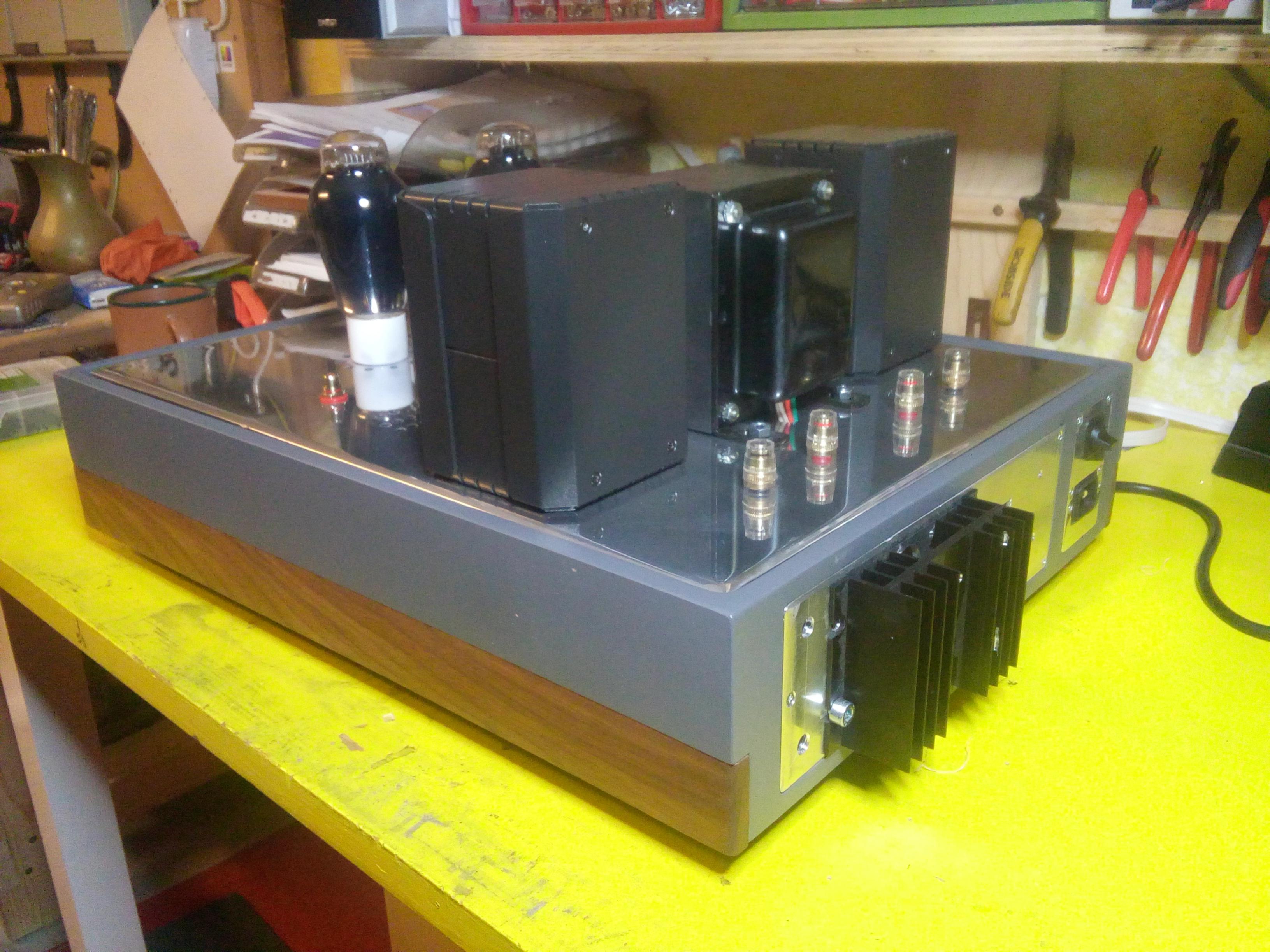

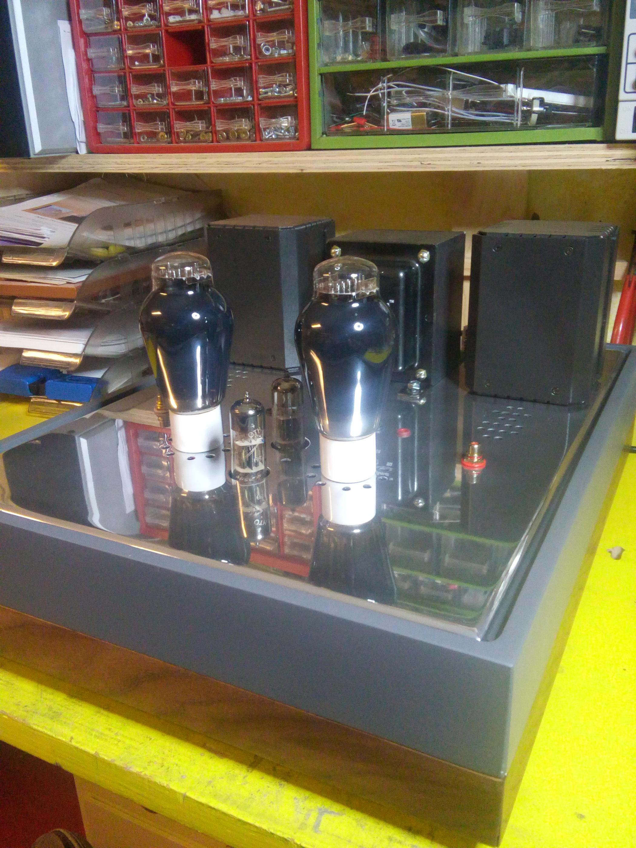

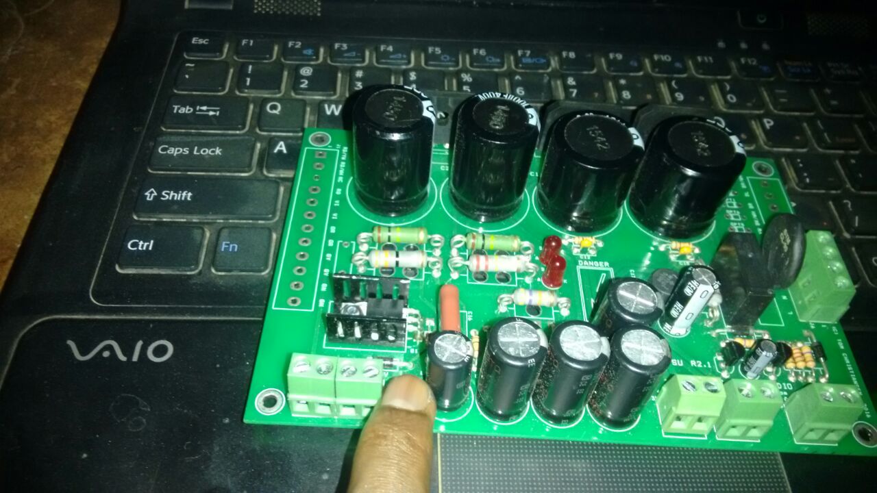

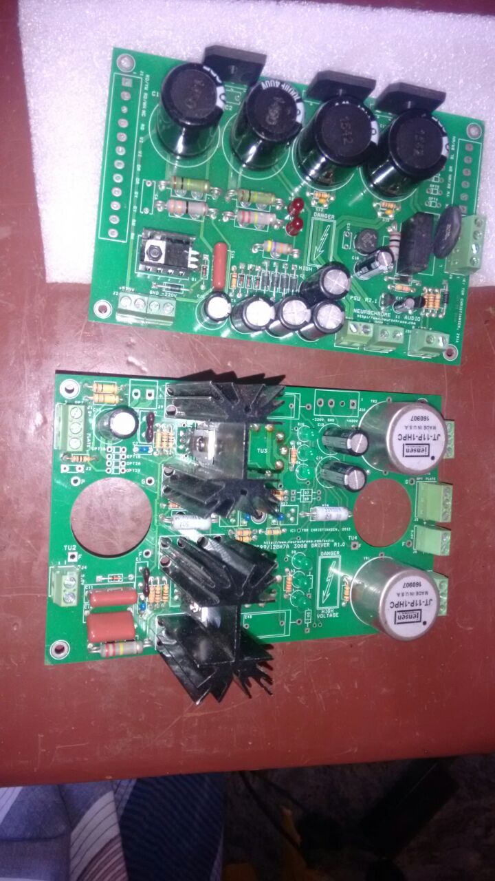

I've also started on a DG 300B build, using James OPTs, local power tranny, parts from Digikey,300B tubes are JJ and 6N6P option. It's been a long time since I got the PCBs, now I'm in the final stages.
Attached are some images of the populated PCBs. The chassis is going to be a teak wood frame with a copper top plate. This build is not a simple build, getting all the components from Digikey, SMD soldering and now the final stages has taken time. I look forward to the final result,and will post photos once it's done and working.

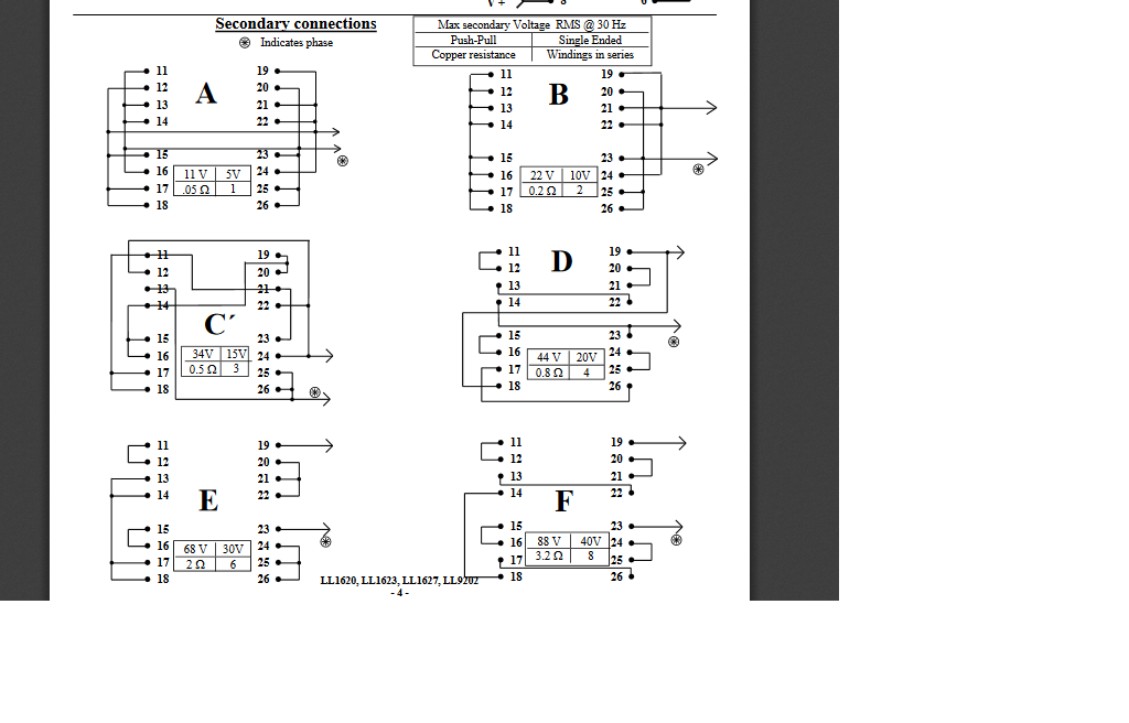

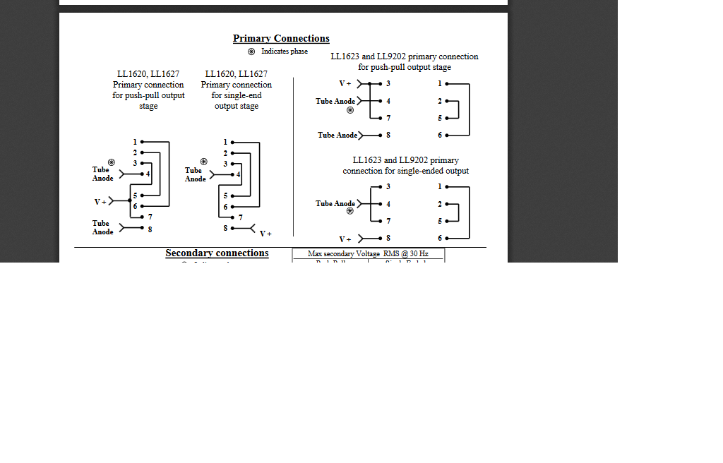

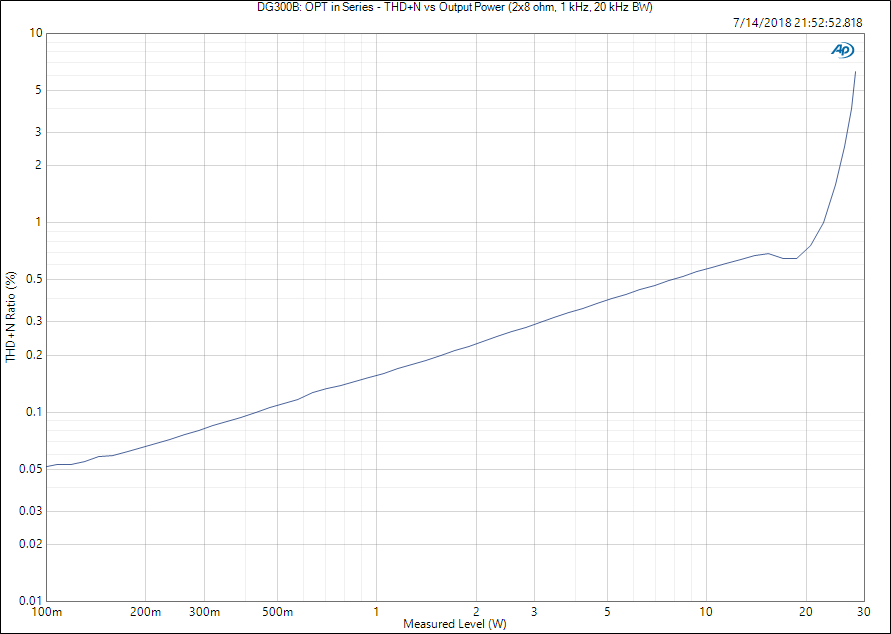

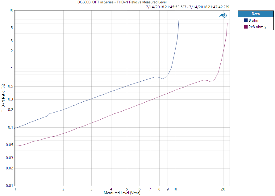

How about 25 W from the DG300B?
Those wanting more power than the 10-12 W the DG300B provides by default may be interested in the following trick:
Connect the two secondaries in series and drive the inputs with the same signal. Now, for this to work you'll need OPTs with 4 Ω taps and use two 4 Ω taps in series to power an 8 Ω speaker (or two 2 Ω taps in series for a 4 Ω speaker). This doubles the output power.
I tried this with a pair of Edcor CXSE25-5K. It works rather well (see attached).
Tom
Tom

The primary side is straight forward, not very much that can go wrong but the secondary side....
I have been using the "C" set up but as you notice in single end set up the "C" configuration only allow 15 V on the secondary side and I started wondering, is that enough??
I take out appr. 11 W from the amplifier and that would indicate that maybe the OPT go into saturation just when things are peaking.... approximately when I experience the distortion, listening to music. Now I don't know what saturation sound like but I can imagine that it will distort in a kind of way, mayby the way it does here.
Is it so that I should have wired the OPT for lets say 30 V instead?
I am rather convinced that the error is mine and this could very well be it!
I would be more inclined to wire the output transformer for 10 volts. If your speakers are ~6 ohm 11 watts into 6 ohm load is just 8.12 volts.

What I noticed in the description, on the uppermost line it says Maximum voltage at 30 Hz for either PP or SE so I suspect that if I am anywhere near these 15 volt then the OPT go into saturation which would also support the fact that the distortion is noticable at dynamic peaks.
