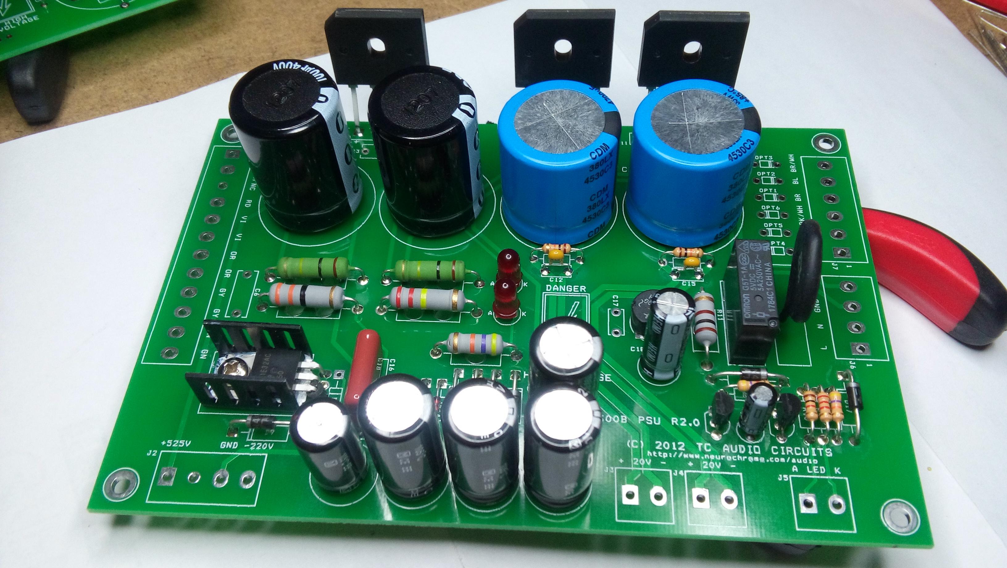

New project, Damn Good 300B amp.
Turned out to be a diode that was wrongly delivered from Digi Key
Luckily it doesn't happen too often.
I built up 4 amps and the first one didn't work. Turned out a resistor from Farnell was wrong despite packet having right resistance on it. Farnell didn't want to know, they just said they would inspect the bin and fix it if wrong. So all 4 amps were wrong and dneeded the resistor de-soldering and replacing in each.
I haven never had a wrong component from RS Components in 15 years although I have had missing components from the order from them.

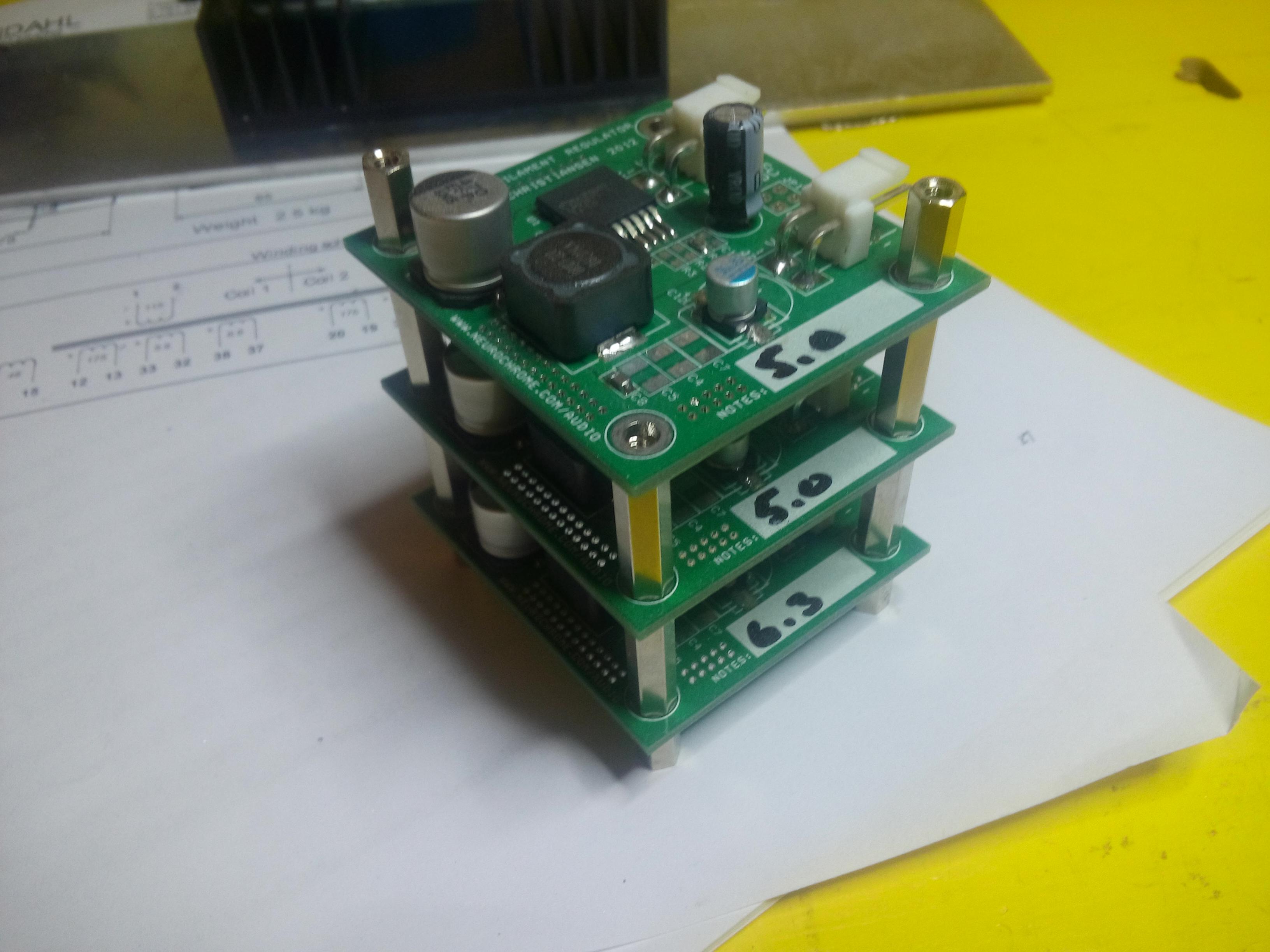

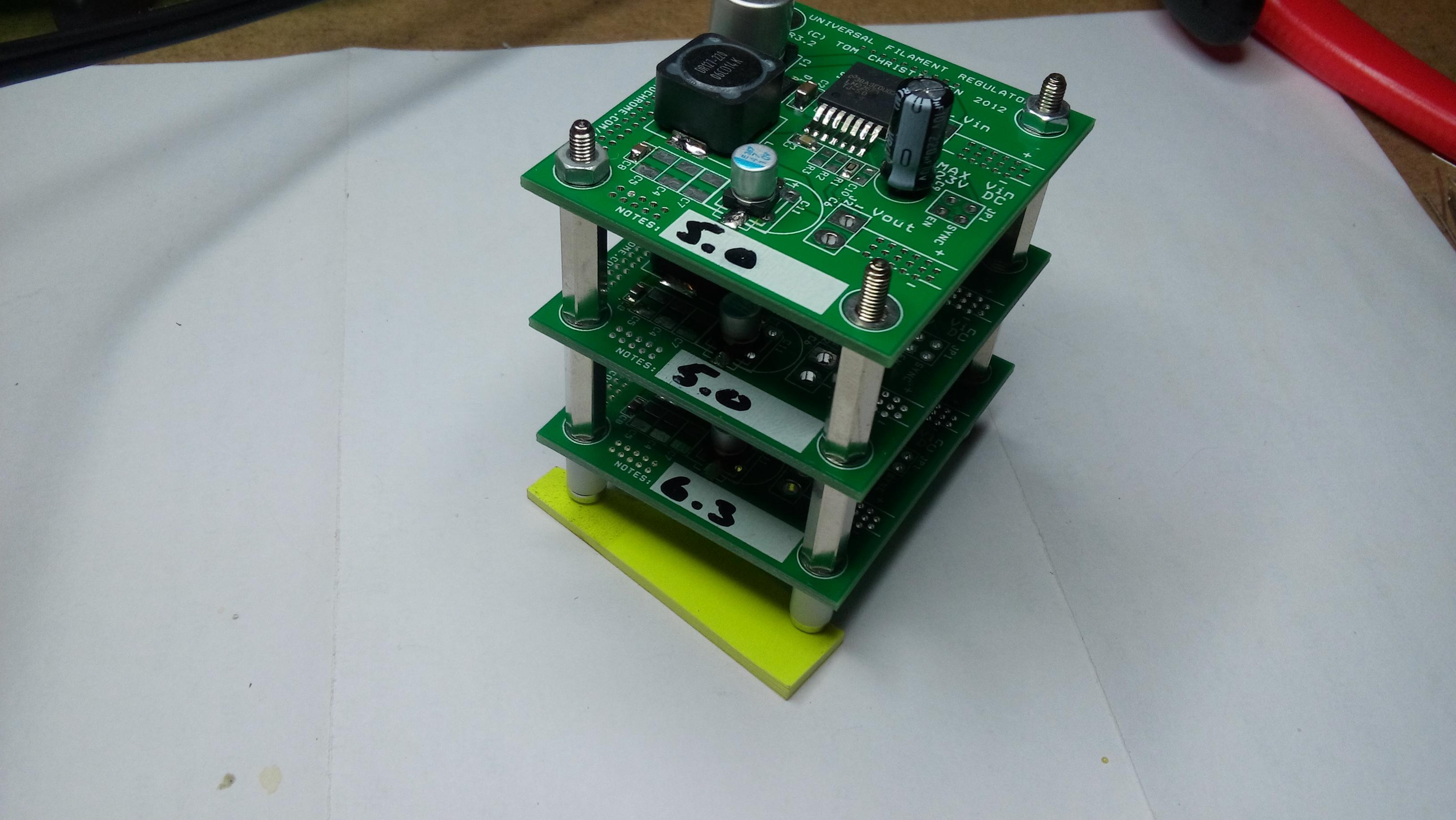

I hav went back to the build document and started all over, going through voltages, regulators and everything I could think of (bad connections and so on). Everything is just spot on and I can't find anything that deviate from the documents so my conclusion is that the tubes are behaving, not the way I want to!!
Is there anyway that i can check the tubes without special tools (tester)??
I have driver tubes in spare but not any 300B tubes so I am stuck! And out of ideas (to little experience with electronics)!
As both channels show the same problem something must be wrong with the power supply. Even if one of the electrolytics (assuming there are more than one) has failed you may still get correct voltages but with a severe hum. It's unlikely the problem is with the 300B's then you would expect only one channel
not functioning well and not both.
Ok, after the last fixing and messing around inside the Damn Good 300B it is behaving normally again, playing music without disturbing noise BUT, and this is a big BUTT, I don't really know what has changed.
Or, somewhere I have definitely had a bad connection, most likely in the power distribution but I can not tell exactly where. When I checked the filament regulators I disconnected the cables entirely so it can be there but I am not really shure cause I have gone through all cables and screws seeing so that I had secured full tension on all screws. Some screws I have been able to tighten upp a 1/64 to a 1/32 turn but nothing more but it appear that somewhere it has helped. Sorry for bothering all of you, but big thanks that you have been willing to help.
