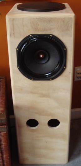

Two new pics to show you guys/gals. The last two pics on my web album are new.
http://picasaweb.google.com/udailey/AudioNirvanaSuper12Build
I built a speaker stand and a speaker cover. Stand gets it to the correct listening position and looks neat. Think I will house Nelson Pass F5 amps in the stands.
RiGuy
RiGuy

Dismount the driver, lay it on top of some adhesive backed cork (available at Michaels Hobby Stores, as well as other sources) and X-acto around the frame. Do 2 layers if necessary.
Viola, flush mount for difficult frame!
