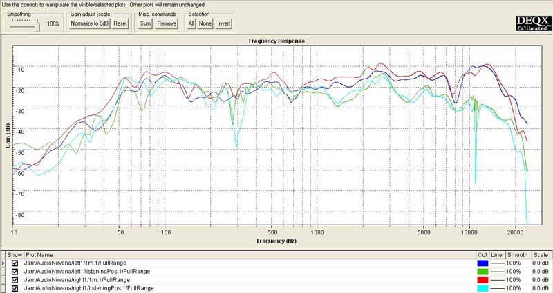

Please take a look at the measurements of these speakers at:
http://www.diyaudio.com/forums/showthread.php?s=&postid=1325093#post1325093

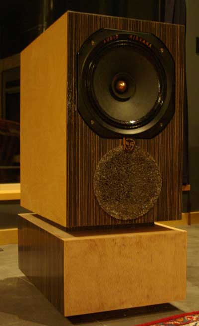

I did inverse the top drivers. The sound became a bit more subdued, or a tad darker. I didn't like it as much, but I guess to each their preference. I will say this though, these are in a large room with high ceilings, so perhaps in a smaller room the reflections will cause more trouble.

I agree, if you can find a way to flush mount those drivers, it will certainly take your project to the next level aesthetically at least. It does by the way, look very nicely executed. You could play around with that bass hump by stuffing the port with something. The sock method works extremely well for quick experimentation! This will be playing around with the vent Q and mimicking an acoustic resistance system.

Not too bad actually. LF extension's about what I'd expected, & you can clearly see the lift at Fc, and the dip back down to the nominal above this. However, as from about 750Hz the response trend of the drivers is tilted upward, the overall FR is relatively flat up to about 15KHz where the drivers begin to roll off. For a couple of units in cabinets basically far too small for them, this is about as good as you're likely to get. Glad you're enjoying them!

Thanks for your suggestions. There is a bit of a problem in flush mounting them. They have a bit of an edge, say around 3/8in. I am worried that if I push them in by that much the two magnets would be too close together.
I'll probably end up building an L shape dust cover so that it wouldn't matter anyways.
I'm also considering expanding into the base. It's there anyways not being used. I could cut a hole at the bottom, and make them sort of fit together. Or pass a wide pipe from one to the other. But these are later tweaks. I want to get well used to their sound first. I put on some classical records the other night (specially the opening of tristan), and it was so overwhelming. The strings filled up the space just like water.

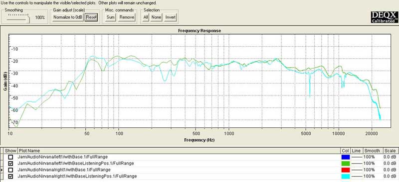

A couple of changes to the speakers. First I flush-mounted the front drivers and I have to tell you I was cursing the whole time the people who suggested this and gullible me! The ANs are not circular! And to do this after the formica and glue have solidified to a hardness approaching diamond is not a fun way to spend the weekend!

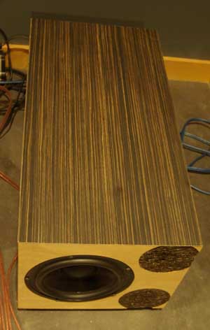

I also joined the base, making a square hole in the base and the speaker of 10in a side. The Inner dimensions of the base are: 26in x 25in x 12in. Plus where they meet there is an additional 3in x 10in x 10in.

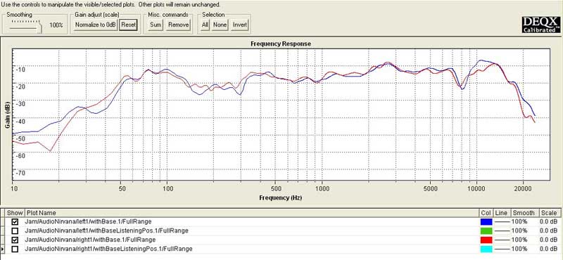

The result was positive. The bass now extends to 38Hz and the curve is more linear. So, definitely worth the effort.

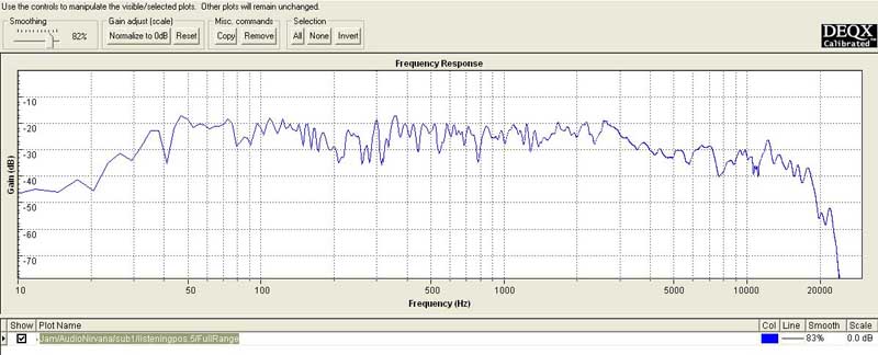

Since the lows were not extending too deep, I got busy and made myself a simple ported amp based on partsexpress stuff, nothing that special, dayton 10in, 250W subamp, crossover set as low as possible, power 1/4 of the way, horn loaded to the 2 ports you see. Here is a picture of the thing:
Jamh said:horn loaded to the 2 ports you see. Here is a picture of the thing:
Horn loaded?
But measurments looks fine now, eh!
I like the look of your Nirvana's!
BRGDS
Peter
