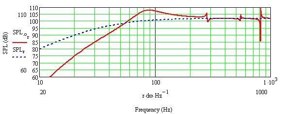

There's an easy way to find out exactly what it's doing. If you can give me the exact HxWxD dimensions of the enclosure, the port size & length, I'll run it through MathCad. Cabinet volume alone isn't especially accurate as it doesn't take into account the standing waves of the box.
Scottmoose said:There's an easy way to find out exactly what it's doing. If you can give me the exact HxWxD dimensions of the enclosure, the port size & length, I'll run it through MathCad. Cabinet volume alone isn't especially accurate as it doesn't take into account the standing waves of the box.
Sure. I was going to wait until I measure them, but it would be interesting to see your results and then compare them. The exact dimensions of the enclosures are: 25 3/4 depth by 15.25 wide by 24.5 high. The size of the port is 7 1/4.
Can MathCad deal with dual drivers?
Oh yes, that's no problem. How have you wired them -series or parallel? I'm assuming parallel? Couple of other questions. Are those internal dimensions? How long is the port? How far up is it centre of the vent from the internal bottom? How far down from the internal top is the centre of the forward-firing driver?
Assuming the dimensions given above are internal, paralleled drivers, a 3/4in vent length & approximate positions for drivers & vent, this is a 1st pass, quasi-anechoic farfield prediction (I didn't add any damping for this particular sim). The room & the above criteria will considerably modify this of course. With the additional information we can be much more accurate of course. I
Scottmoose said:Oh yes, that's no problem. How have you wired them -series or parallel? I'm assuming parallel? Couple of other questions. Are those internal dimensions? How long is the port? How far up is it centre of the vent from the internal bottom? How far down from the internal top is the centre of the forward-firing driver?
Thanks! Some answers to your questions:
+ internal dimensions.
+ parallel drivers.
+ 3/4 in vent length (The port is just a hole). Center of vent is about 4.5 inches from the bottom. From the internal top, the center of the driver is around 8.5in.
+ The internals are heavily damped, there is drywall and 3in of hard foam.

I find it rather amusing how close my calculator sealed box predictions are for this vented system. Not too shabby for a few minutes worth of number crunching.
You say the vent is 3/4" deep, so I assume there is no drywall around the vent area ?
Your vent looks like it is covered with something. What is it?
If the vent is obstructed by the bedding foam and if the grey material on the front is thick (wool or felt) , then I would say this leans more toward an Aperiodic system than a vented one.
If the vent is unobstructed except for the grey material , then I would say it is a vented system.
Reasonable bass to 50hz.
What does the Blue line symbolise in the CPU response graph,
in-room response ?
..........................Blake

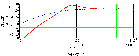

Turns out I wasn't far out -those dimensions are almost exactly what I'd SWAG'd for the above sim. Refining it slightly to use your exact dimensions, and taking the damping into account gives the attached. Is this a commonsenseaudio cabinet by any chance?
In-room, I suspect you'd get down to about 40Hz with room-gain. On the positive side, with those two 12in drivers, sensitivity is extremely high, but that big peak at Fc is going to make for, er, a pretty powerful midbass, to put it mildly. That's probably why it doesn't sound 'cramped.' If you like some grunt, this is going to give it -most of the energy in rock music for example is around this point, so it's going to sound extremely dynamic & quite vivid.
