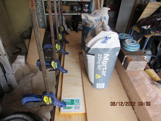

After waiting all night for the glue to dry I've just tried a tap test over all of the box.
Interestingly the only section of the box that doesn't go "tonk" or "clunk" is the bottom panel which has 2 layers of 12mm chipboard glued together.
And this is before I layer the MDF panel over the sides.
It's always been my belief and experience that layering two dissimilar materials together helps damp vibration and I've layered 3 different materials together at times but this is the first time I've done that combined with so much extra stiffening.
Another lesson in box building.
Now I have to figure out how to add some internal damping to the walls with all these battens and sticks in the way and whether of not to add some damping to the port to try and reduce the tuning a few Hertz if that was possible.

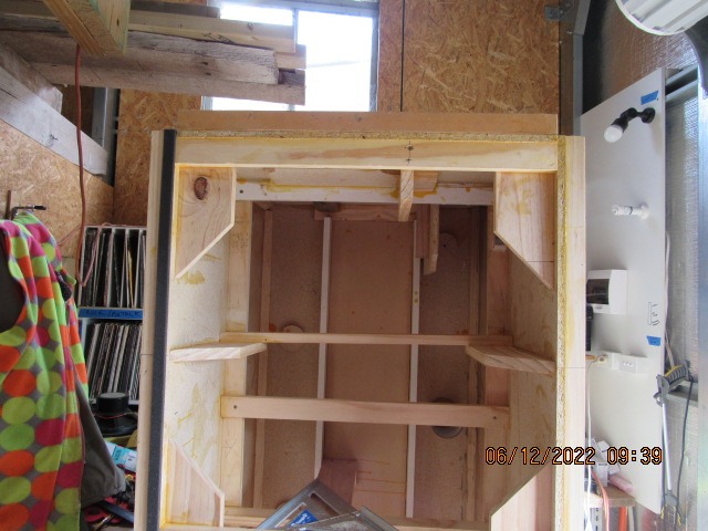

Yeah, the goal is to either stiffen it sufficiently to raise box Fs well above its intended pass-band (upper mass corner) or mass load it to push it well below its lower mass corner, which typically means concrete construction for a sub, but you're trying to do both, essentially 'robbing Peter to pay Paul'
, so maybe better not to add any more mass to the panels.
It will roll it off a little, but mostly just over damps the system, so better to shrink its CSA to suit.
Well I can shrink the CSA by 38mm if I use a short bit of the same 19mm*140mm batten and it wouldn't be too far from the equivalent of a 12" pipe.

You did GM, but I sized that shelf port based on the use of a 12" pipe in Box Modeller and got the arithmetic wrong.
In Box Modeller the difference in length between a 12" pipe or tube and a 12.5" tube is more than a few millimetres.
So yes I'll add side inserts to reduce the width

Damping not necessary in a sub.Now I have to figure out how to add some internal damping to the walls with all these battens and sticks in the way
We usually see some damping stuck or stapled to the walls tho.
Not using any would make finishing this a bit easier but on the other hand I have a few old polyester doonas and pillows sitting unloved in the stash I could insert easily enough
Damping a speaker is not about dumping some trash inside of it. It has to serve a purpose. In the past, with passive x-overs, often too much high frequency exited Bass cabinets. Today we cross deeper, active. At these low frequency's the usual stuffing- stuff does not work significantly.
At the walls it does not help at all.
Just try it empty and if you think you find a reason, adress the problems you really have. Usually with a DSP instead of an old pillow.

More time waiting for glue to dry.

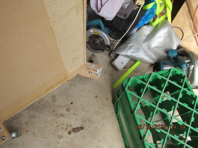

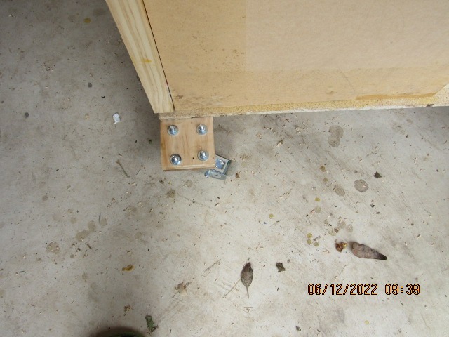

I don't think that 12mm ply is stiff enough for a woofer this size so I'm glue laminating two 12mm panels together. Only where the driver is tho and not the full 1800 depth. Added some cantilevered feet and wheels so I can move it around and the top now has that 32mm thick bit of MDF glued on.
It will be interesting trying it out but never again will I do a box this large [ well unless we win the lottery and we buy an old church for a music and banqueting room] it's been less that perfect fun with such a small shed to work in.
Just in case people think that the 89*19 pine is a bit weak to support the box; they are reinforced underneath with some offcuts of 12mm hardwood marine ply and the cantilever is only 95mm. Each wheel is rated at 50kilos so a safety factor there but I have no idea what this box actually masses but I can't lift it.
