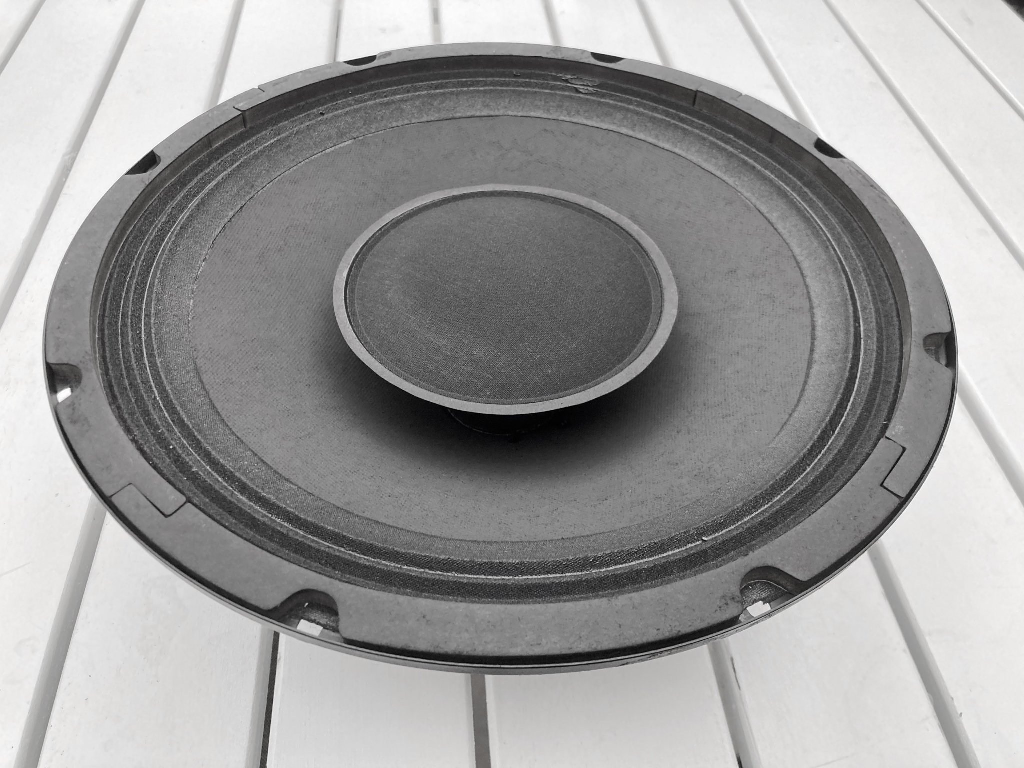

Nice woofer but probably outside my budget and definitely no WAF with that one.
I've been told I can go to a 15' on each side and no larger for the stereo

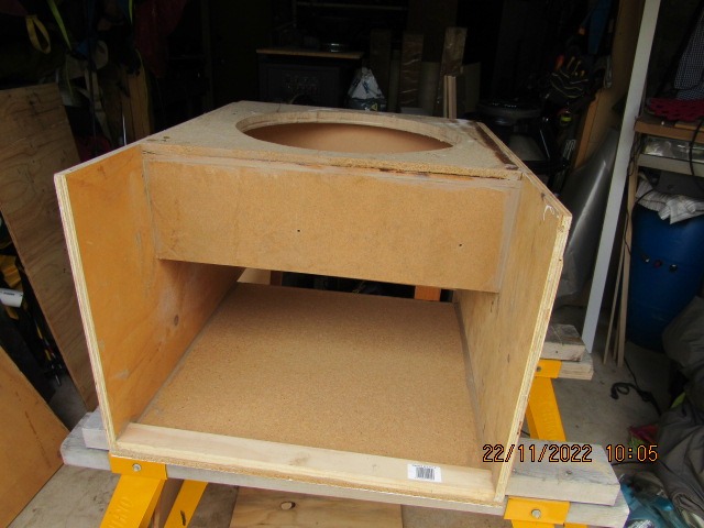

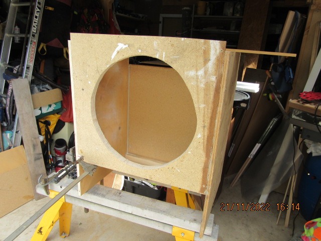

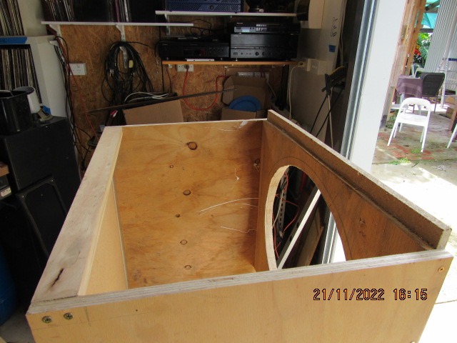

It's a dogs breakfast of a box.
I should have waited and simply bought some new sheets of chipboard instead of trying to use up all the scraps and off-cuts.
I have two 12" drivers here and I may as well use the one I got at the garage sale for the top as it's a high Q driver and I'll just mount it in a baffle; no box.

They know 3” as 6 +…. We enforce this math already 😆So what’s an 18” over a 15” (she’ll never know)Nice woofer but probably outside my budget and definitely no WAF with that one.

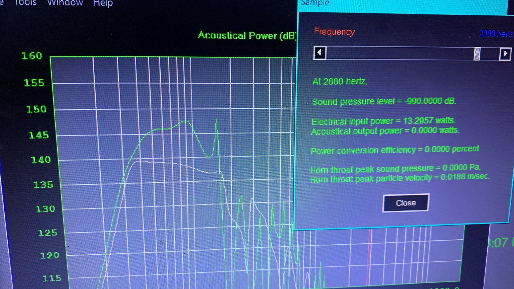

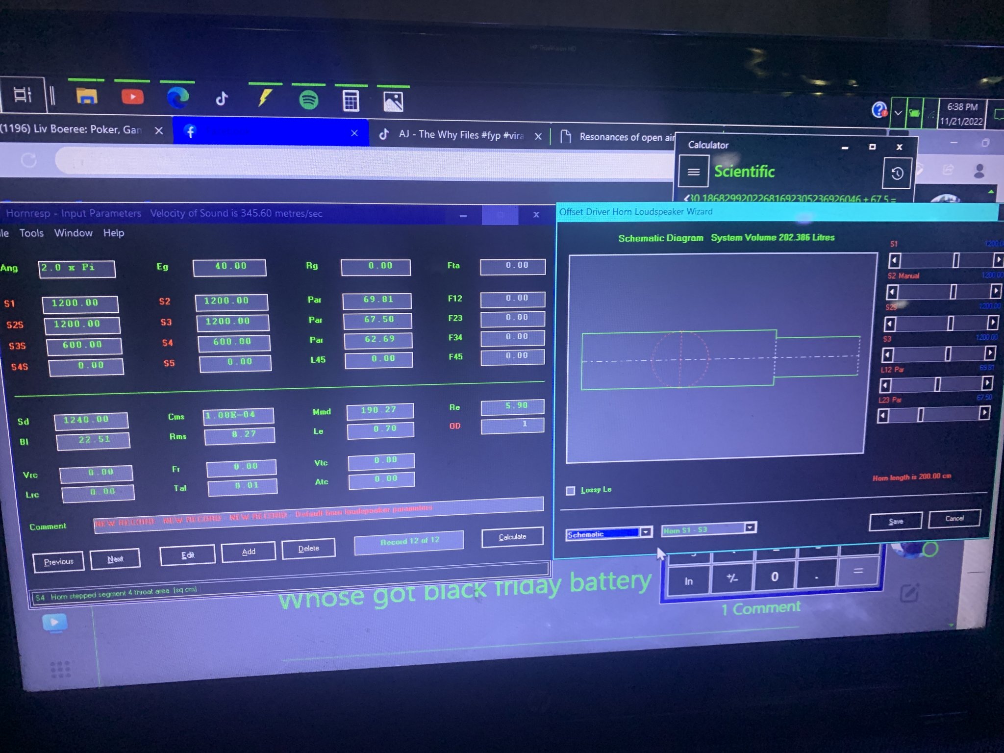

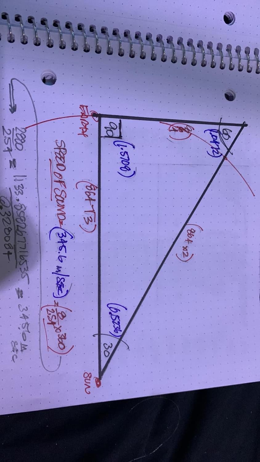

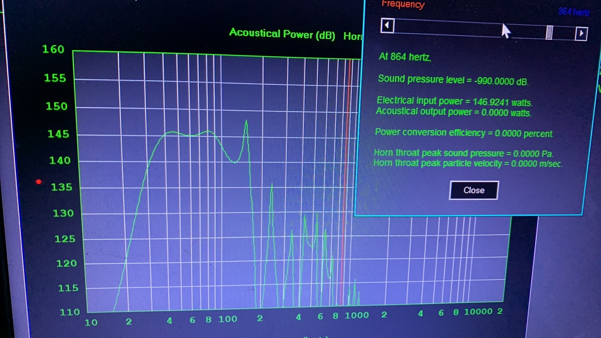

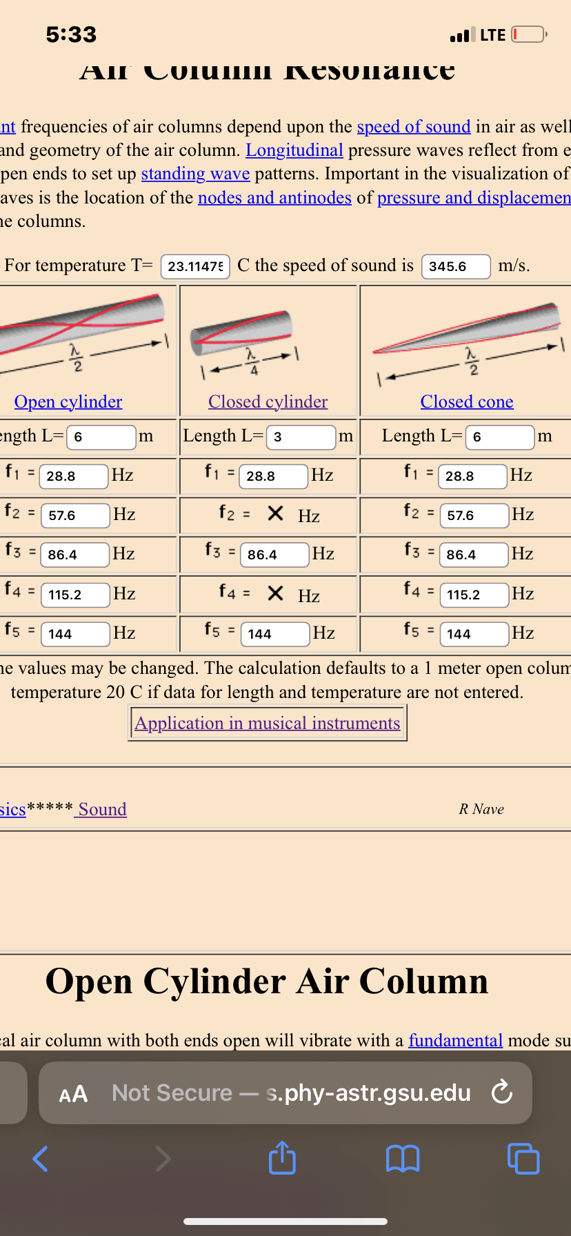

Odd harmonics, in higher order modes, reveal a perfect alignment to a set of numbers and thus frequencies (and subsequently pressure and velocity nodes ) in an endless cycle that represents the entire fabric of the universe(or at least the solar system, and up to the Kuiper belt, and all of nature, including DNA, the carbon atom etc.). Once you put those into perfect rectangles that create it as sound bandwith and outta bandwidth ‘coded’ info as qwresonators.then she will know fibernacci/golden ratio and this: And 💚 it! Make it fun and make it incredibly interesting
it doesn’t just have to be a subwoofer. It can be a tool to understanding so much more, and the details of horn response expose this very very well.

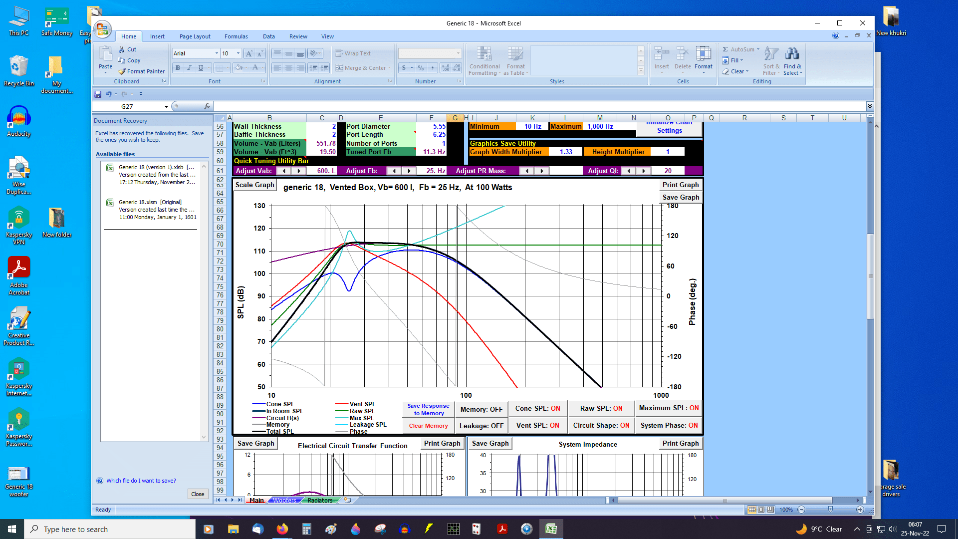

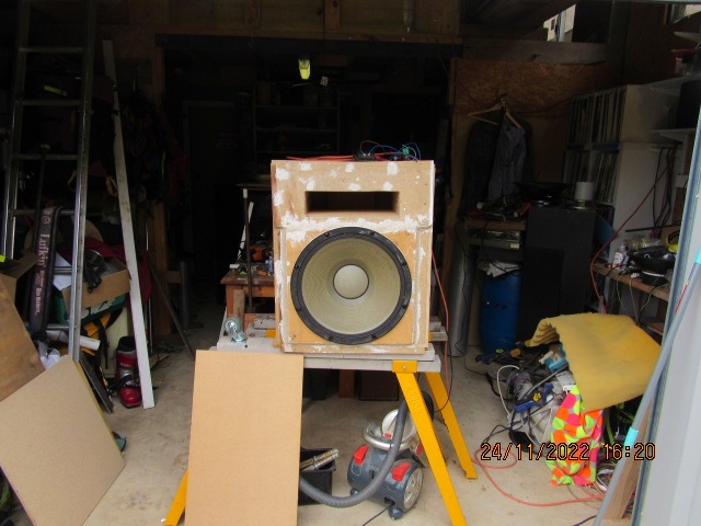

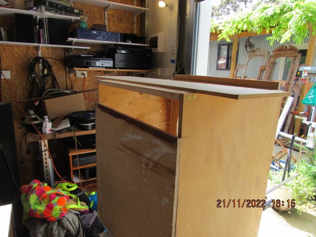

Without a doubt these have to be the worst speaker I have ever built.
Serves me right for buying S/H from a Pro audio feller.
I think "Used until close to dead" might describe them best.
Box is no where near dead enuf and vibrates badly and the driver is not really much good.
Seems to have improved a bit as it warmed up but that may just be me getting used to it.
It is loud but not at all clean and even with the sub25Hz filter on too much subsonic is making the driver do awful things.
Still it was a learning process, I've never worked with a woofer this big before.
I'm wondering if gluing some extra MDF scraps to the chipboard would help much?

SWMBO has commented that it's a DOOF-DOOF speaker and she's right.

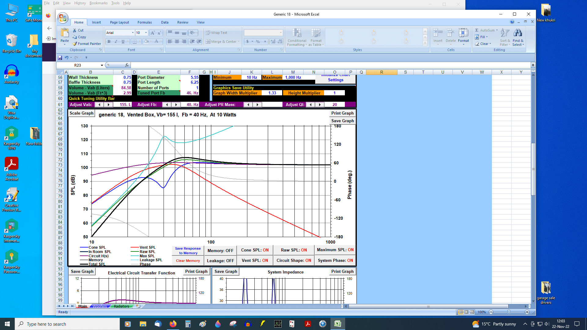

It performs as modeled with that peak in response, one note bass.
But modeled in a really big box tuned low it looks much better so I might just buy some new sheets of chipboard and make a refrigerator sized box and see what happens.
I won't waste the box tho.
I might just cut a lot of holes in it and put a driver in each face and see what happens, an excuse to get rid of all the singletons and orphans.
Might take me a few weeks tho so please don't hold your breath

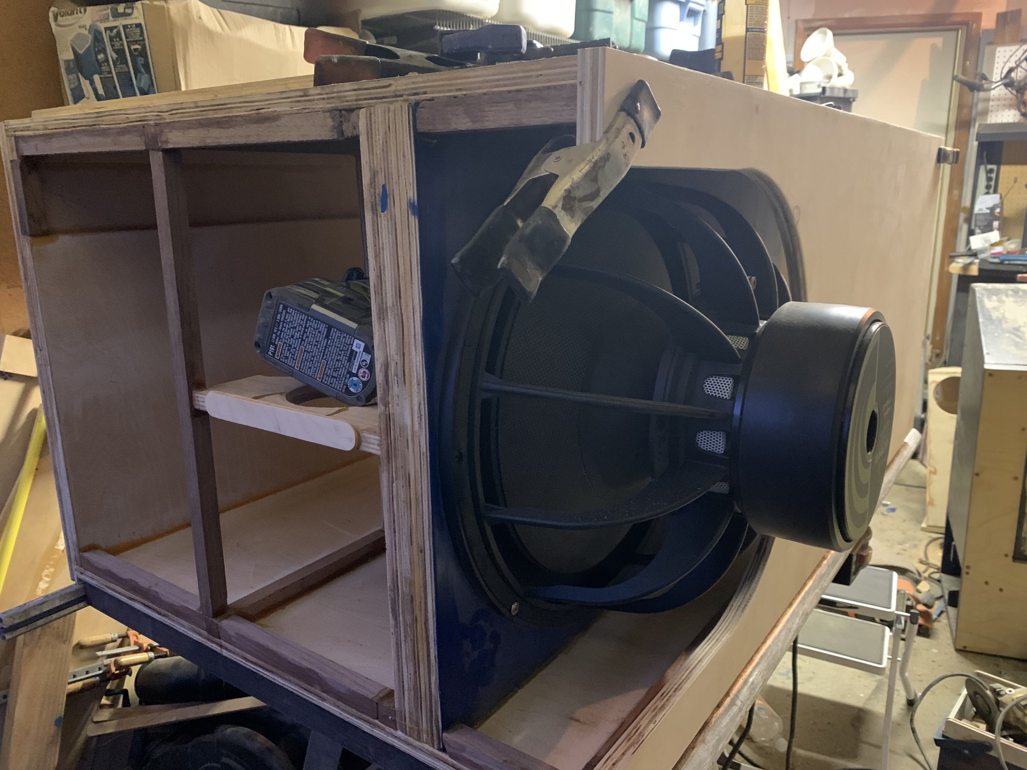

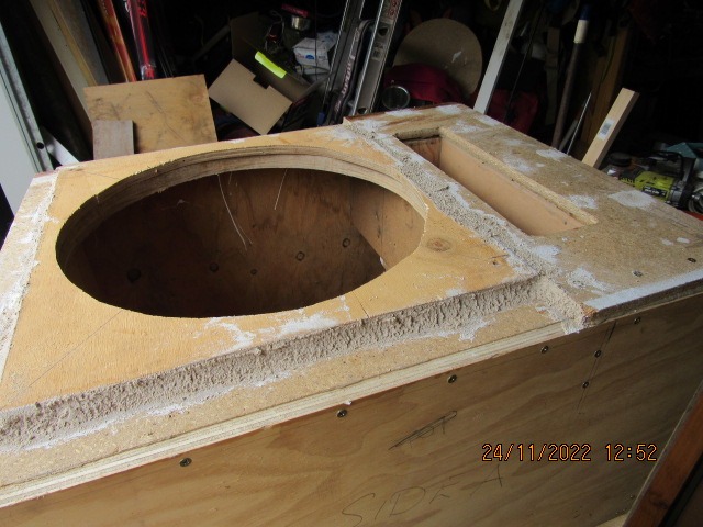

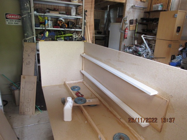

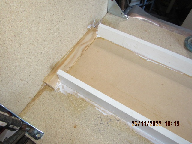

Modeling has persuaded me to go with the much larger box.
I've just started making up a cheap 600 litre box which will be tuned to approximately 25 Hz.
I say approximately as I'm not experienced enough with porting and especially shelf ports to know in advance what the results will be

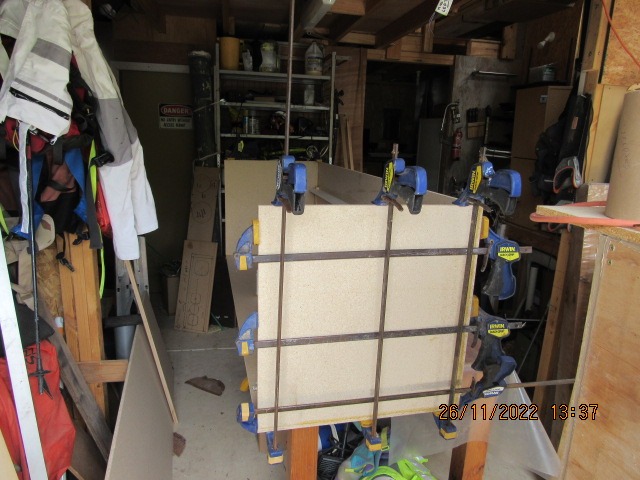

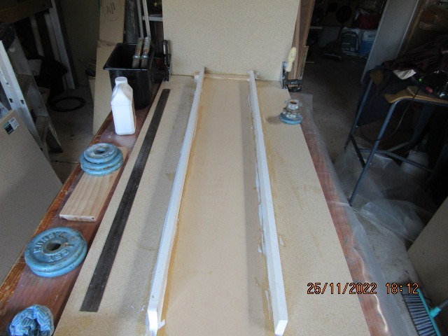

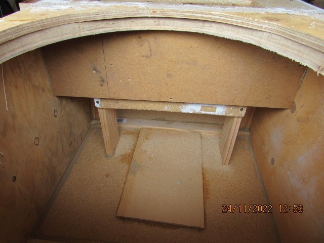

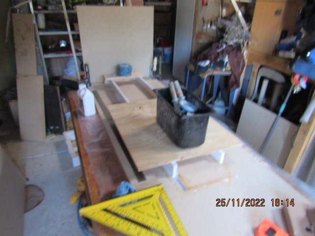

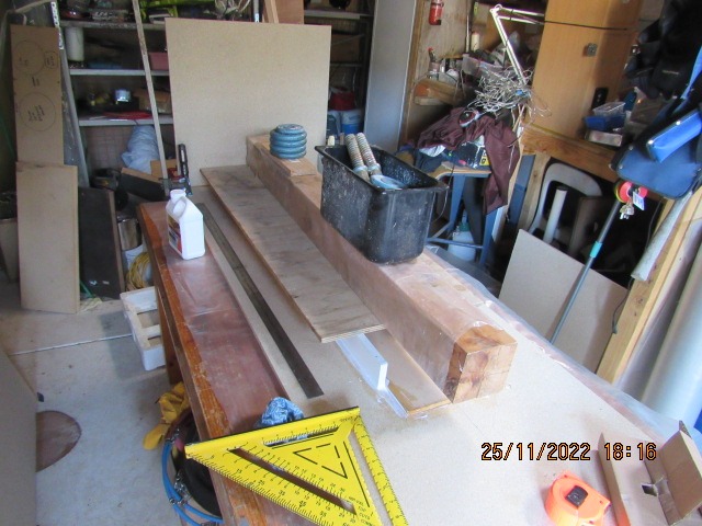

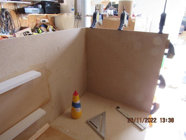

I've made a start on the 600litre box. Will be approximately 550 after all the deductions for vent and woofer
I need to buy more clamps, I can only glue one face at a time. Also I need to go and buy even more battens and I'll need some wheels so I will be able to move it around

Box is 600 wide by 588 deep and 1800 tall

Mate came over to borrow a cup of lawnmower for an hour or two. Got to discussing this box build [ he is a qualified carpenter and cabinet maker] and I called it a "Monkey Coffin" at which he laughed and told me I could bury a gorilla in this box so I think I've just named it that.
Magilla Maxi???
Magilla Maxi???
